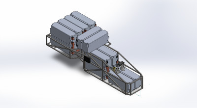

1990 MX5 to tesla power (battery box design)
Post by ScythianNite »
Thanks to Chris at Fellten for the file, I was able to use a 3d scan + my own measurements to tetris in the battery design
i have 3mm x 25mm flat copper bar to start building my busbars with, as well as the overall busbar designs which I will likely 3d print first to confirm fitment. I am looking into nickel plating options locally but may end up sending an order out to get the files i made done up by professionals lest I do something poorly or wrong.
