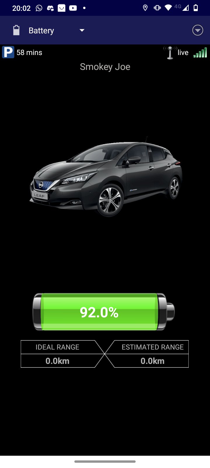

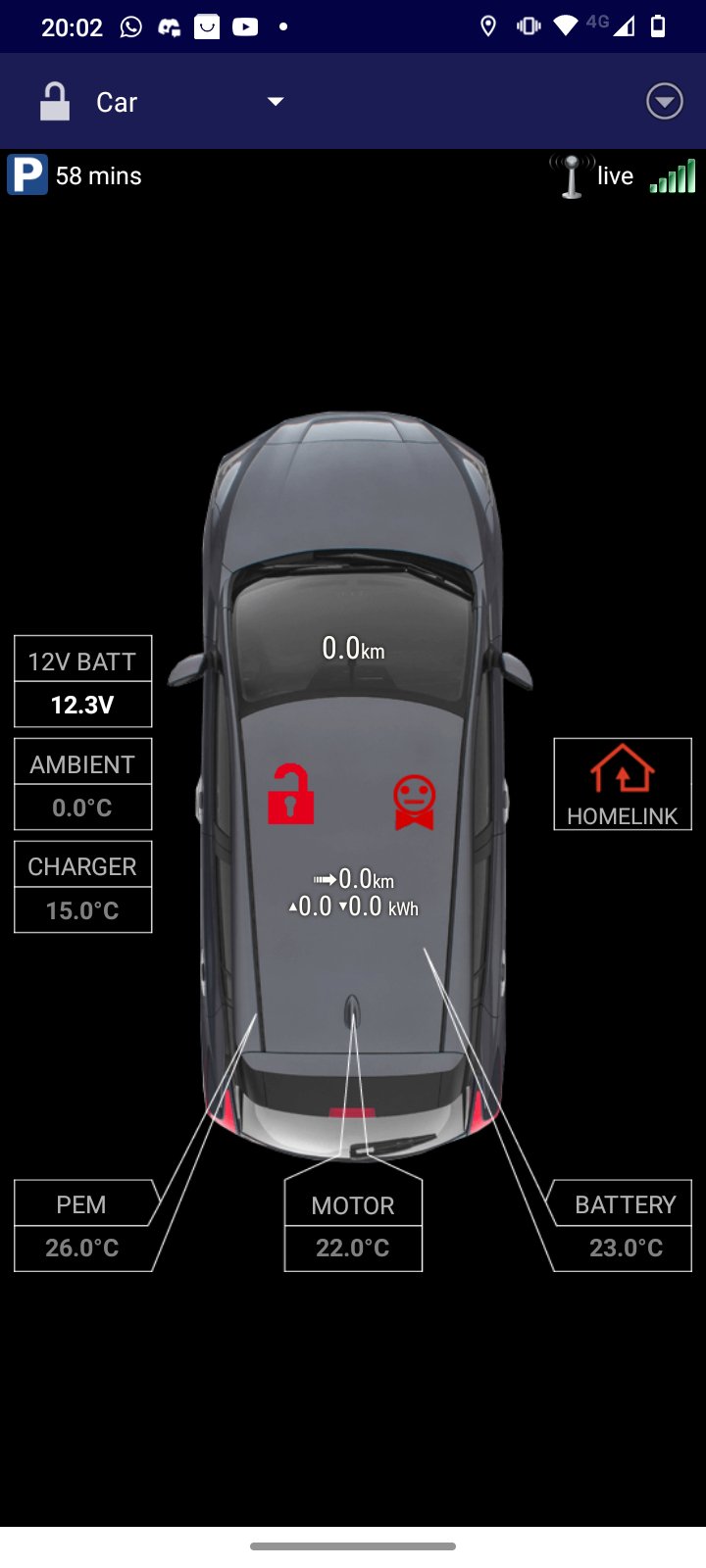

I've written a basic integration for Zomberveter for OVMS, I've done a PR to get it integrated in to the official firmware but for now, if it's of use to anyone else, my fork is here https://github.com/jamiejones85/Open-Ve ... eVerterVCU
I can now remotely monitor my car on the mobile app, OEM style.
Just put OVMS on the same can selected for the ODB2 Can parameter in zombie and away it goes.
Mobile app doesn't yet allow custom vehicle images.
Zombie + OVMS
