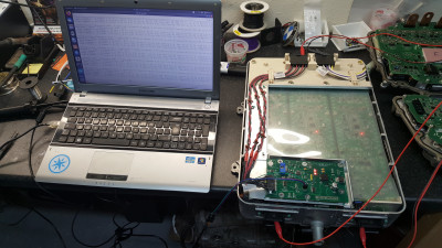

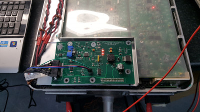

Posts: 3642
Has thanked: 9 times
Been thanked: 284 times
Pleased to announce the new charger boards are working well on the bench. Next up testing under actual charge conditions in the Panzer. I'll make boards available in the shop soon for beta testers.
