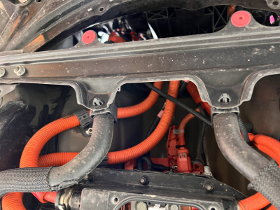

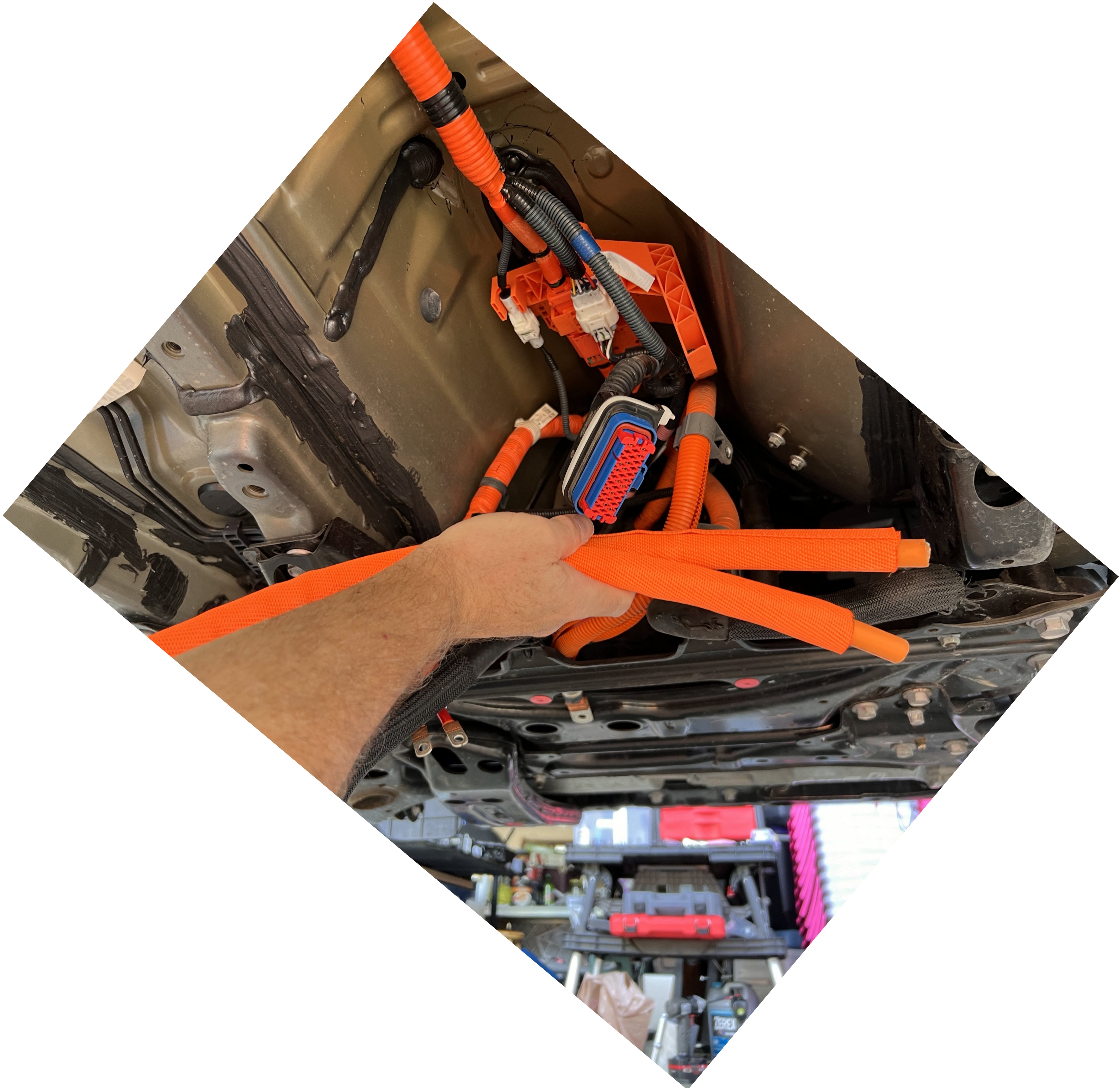

asavage wrote: Mon Jul 24, 2023 1:19 am
Install new DCFC leads (charge port to new HVJB)
  • Install new HVDC leads from charge port's leads to HVJB location
    • May involve dropping the HV battery (840 lbs) a few inches
    • Possibly, the leads may be run down the unused trans/driveshaft tunnel
I had the nearly-ubiquitous HV contactor failure to which so many early Tesla Model S/X and RAV4 EVs have succumbed, so I was forced to drop the battery pack to replace both of them, and my HV battery dehumidifier (yes, it has one) had a failed air pump only a couple of months before. Since the pack had to come down anyway, it was a good time to run the 50mm² shielded cabling from the area in front of the battery pack, to the rear bumper (storage for the excess, until the charge inlet is installed).
There's a cavernous space in the Gen2 RAV4 EV, in front of the HV battery and behind the LDU, above the steering rack, it's huge, so I'm leaving a couple slack feet of cable there, with sealed ends.
Looking rearward at the top of the HV battery:
Looking to the rear, HV battery installed
Looking straight up, HV battery at bottom of pic, plastic LDU wiring support at top of pic:
Looking straight up, in front of the HV battery
With the battery removed, looking forward:
Looking forward from where the HV ends, battery removed
That's bad lighting, but the space for a HVJB is there.
