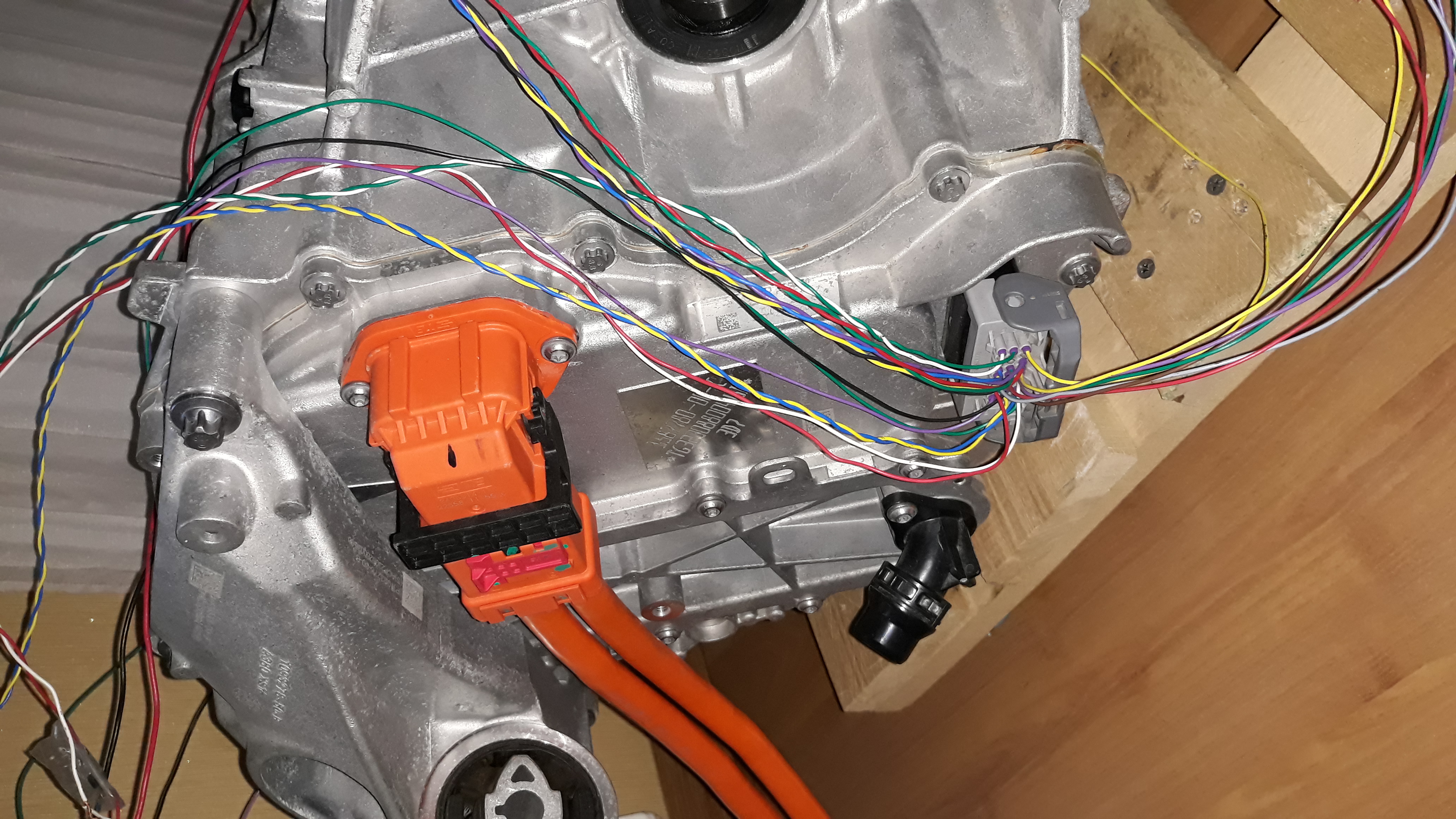

davefiddes wrote: Fri Aug 30, 2024 10:05 am Do you have an intact HVIL loop with a 20mA current running through it? Without that the HV bus discharge circuit on the inverter will not deactivate.
I haven't connected HVIL. Can you tell me how to emulate it? What voltage is there? Is PWM used?
davefiddes
Posts: 294
Has thanked: 77 times
Been thanked: 96 times
Post by davefiddes »
It's quite simple to emulate on the bench. It is a simple 20mA current loop and you can use the same 12VDC supply you use for the main inverter (it is optically isolated from the main inverter electronics).
I use the following circuit with an LM317L regulator:
The HV DC connector is part of the loop. I see you have the official cable so you should be good. If anyone wants to jumper it out you need to do this:
The HV discharge circuitry is completely automatic but the HVIL current is monitored by the main inverter MCU.

So the immobilizer is unlocked, the inverter shows signs of life with a 10 kHz beep for a split second during power on and shows that it is in the IDLE state, the HVIL circuit is on.
I switch to D, the inverter shows N and the IDLE state doesn't change. That is, in order for D to be ENABLE, you first need to achieve STANDBY in P.
Does the motor need cell voltages? I think the problem lies somewhere in the messages from the BMS. What do you think?

After playing with the motor for a while, I realized why the inverter doesn't switch into STANDBY mode.
Active errors: DIR_a144_configMismatch, DIR_a062_systemLimpMode, DIR_a092_bmsMIA.

I noticed that DIR_a144_configMismatch is triggered by two messages 0×392 (info about battery) and 0×7FF (car config)
We can say that this is a fundamental error and because of it the motor will not spin.
AMP3R
Posts: 125
Been thanked: 53 times
Post by AMP3R »
I figured out the 0×392 BMS_packConfig message, which triggers the DIR_a144_configMismatch error.
Just corrected the maximum voltage to 387 and the error disappeared.
