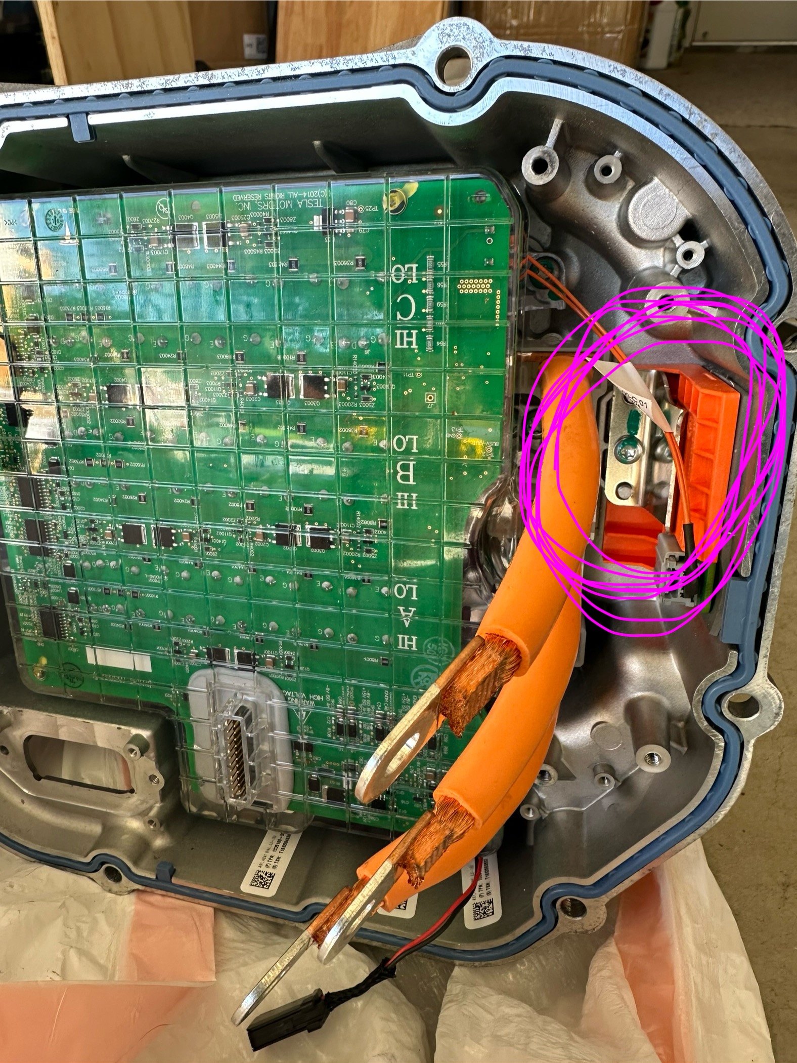

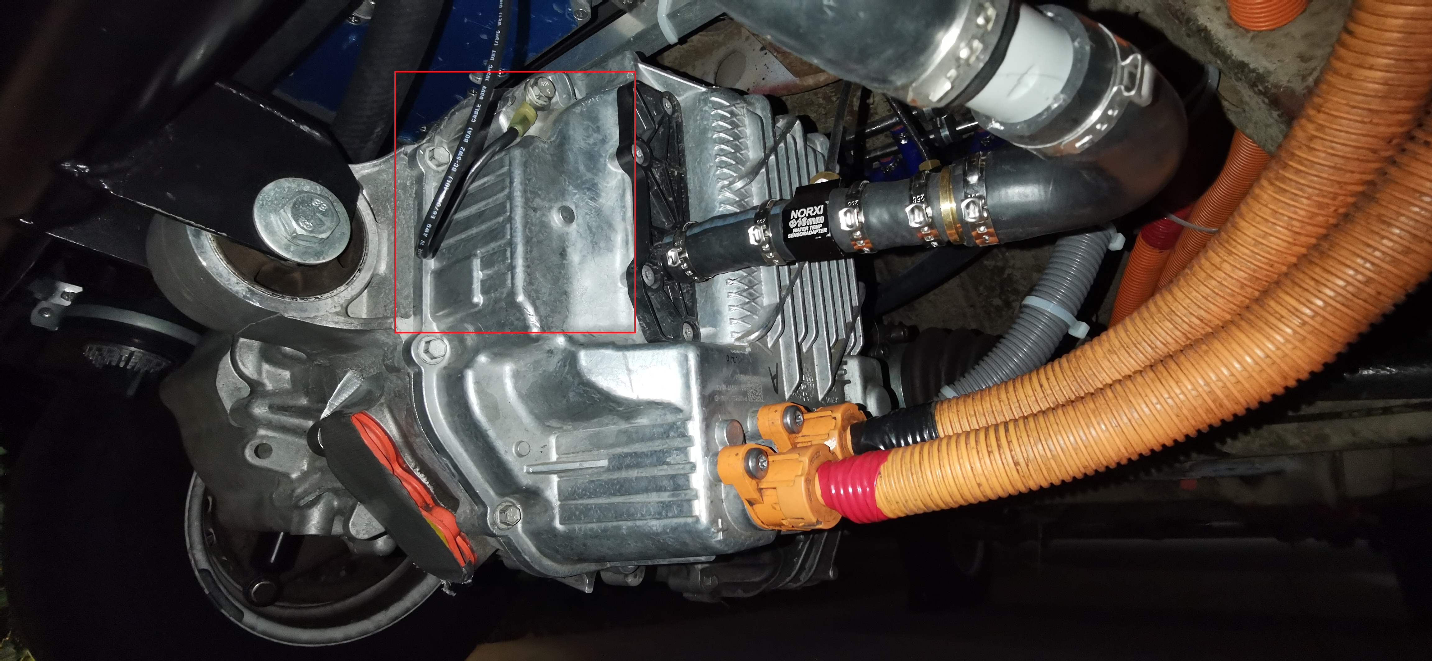

Also I notice the case of the inverter becomes very warm to touch in this area (within red rectangle, lower is cool too), but the area where the igbts are is cool to touch. Is that how it suppose to be?

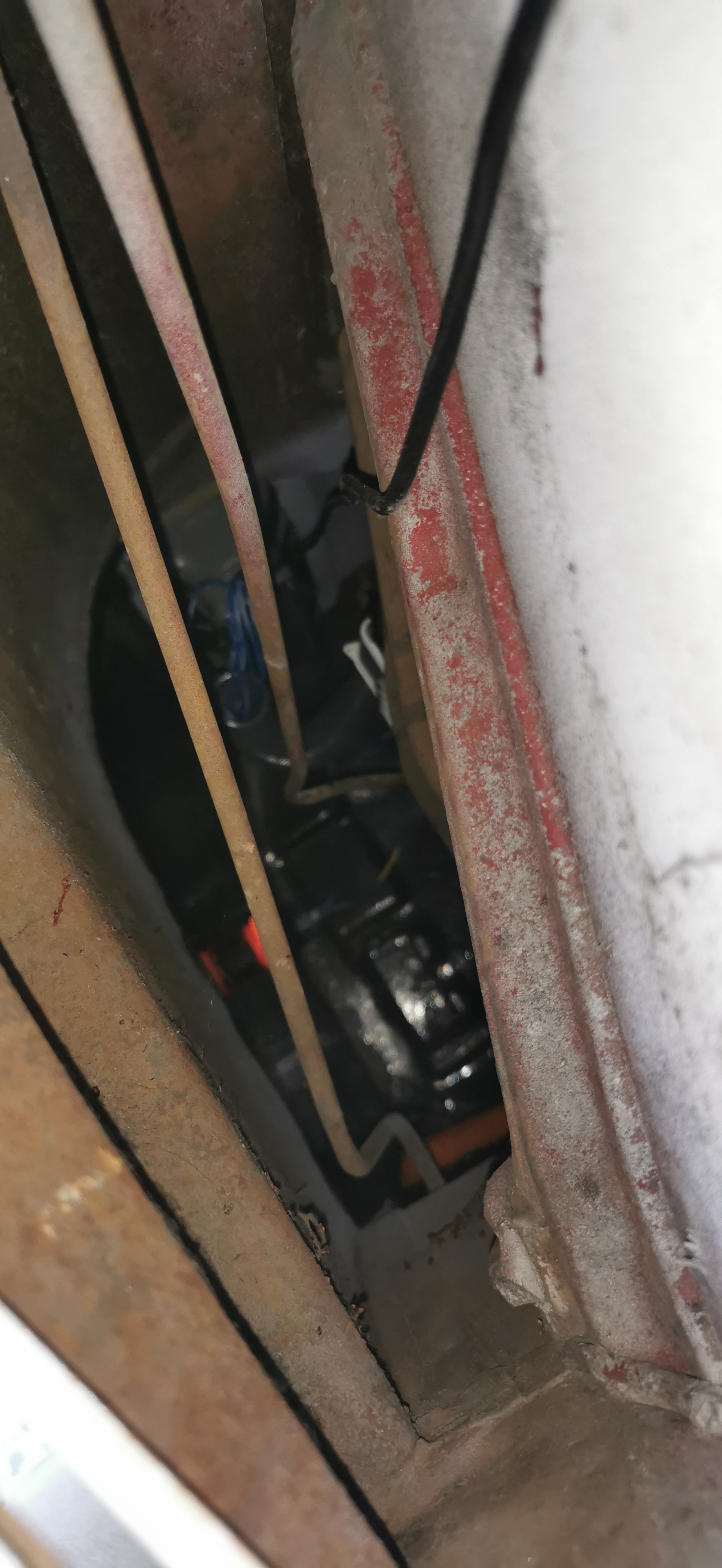

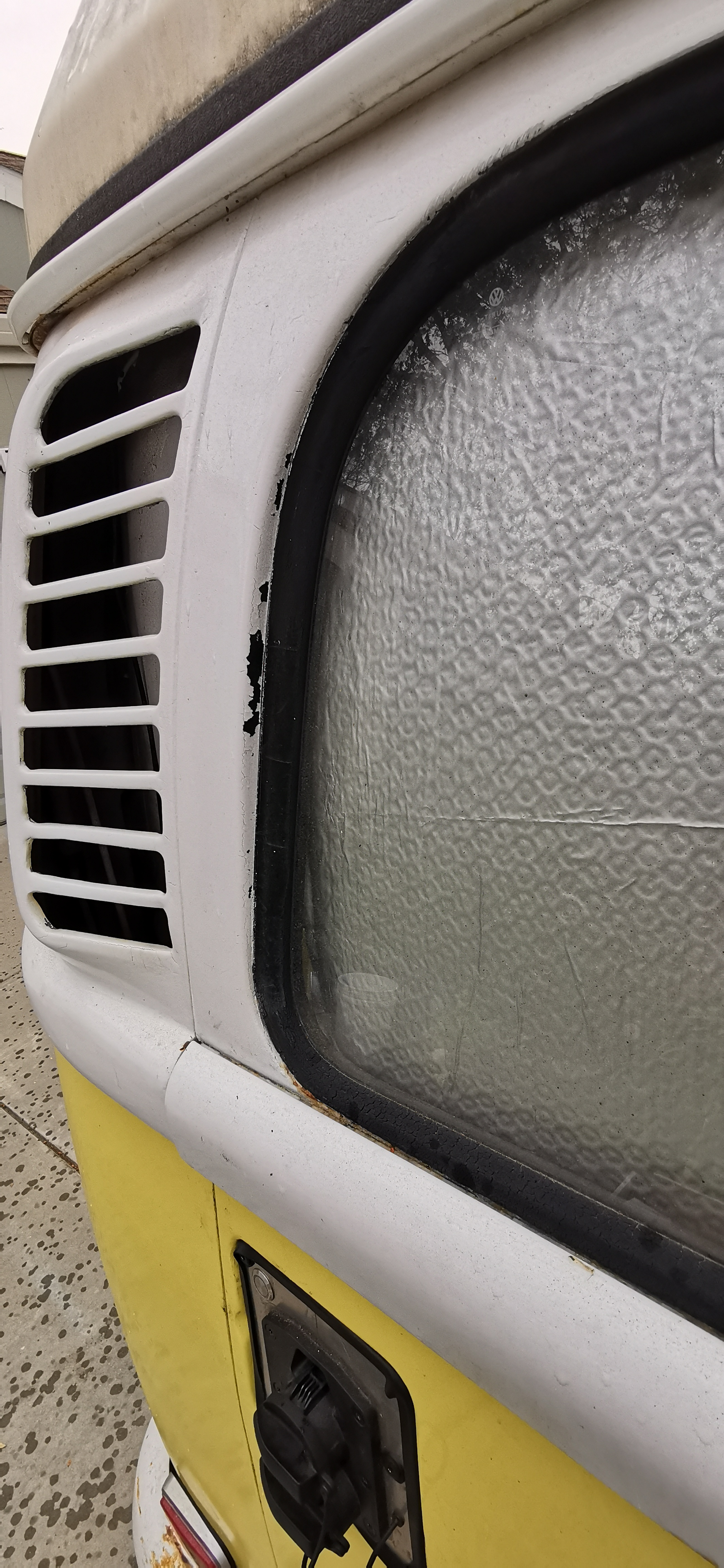

So originally vw t2 had no radiator at the front of the vehicle. It has these side ears that guide airflow into the engine compartment. I used that as the guide for mounting the radiator. The fan is meant to pull that air to assists air entering through those side ears. My thinking was that there would be enough airflow when driving at speeds >20mps, so do not need to run the fan.
I will add temp probes on the radiator to measure the temp.
Side ears and the air channel where the air is meant to travel down the engine bay..
Radiator and the bottom of the air chambers coming from the ears at the top...
This is how the radiator is positioned looking from under the car...

Really buddy, you every look at an "aircooled" engine. They are forced cooling. http://www.volksbolts.com/faq/cooling.htm

alexbeatle wrote: Wed Oct 16, 2024 6:16 am image.png
I believe this is the area that I refer to here that gets warm. Looking from the inside is that some kind of isolation monitor? Suppose to be warm?
I can see now why the inverter needs to be vacuum filled, there’s a section for the coolant that’s above the outlet port.
I can also see why the inverter would limit the coolant flow. Those are some hard turns inside past the inlet/outlet ports.
I’d be curious to know if anybody actually had luck with SDU coolant flow inverter -> gearbox exchanger, as opposed to to the way Tesla did it by splitting the flow.

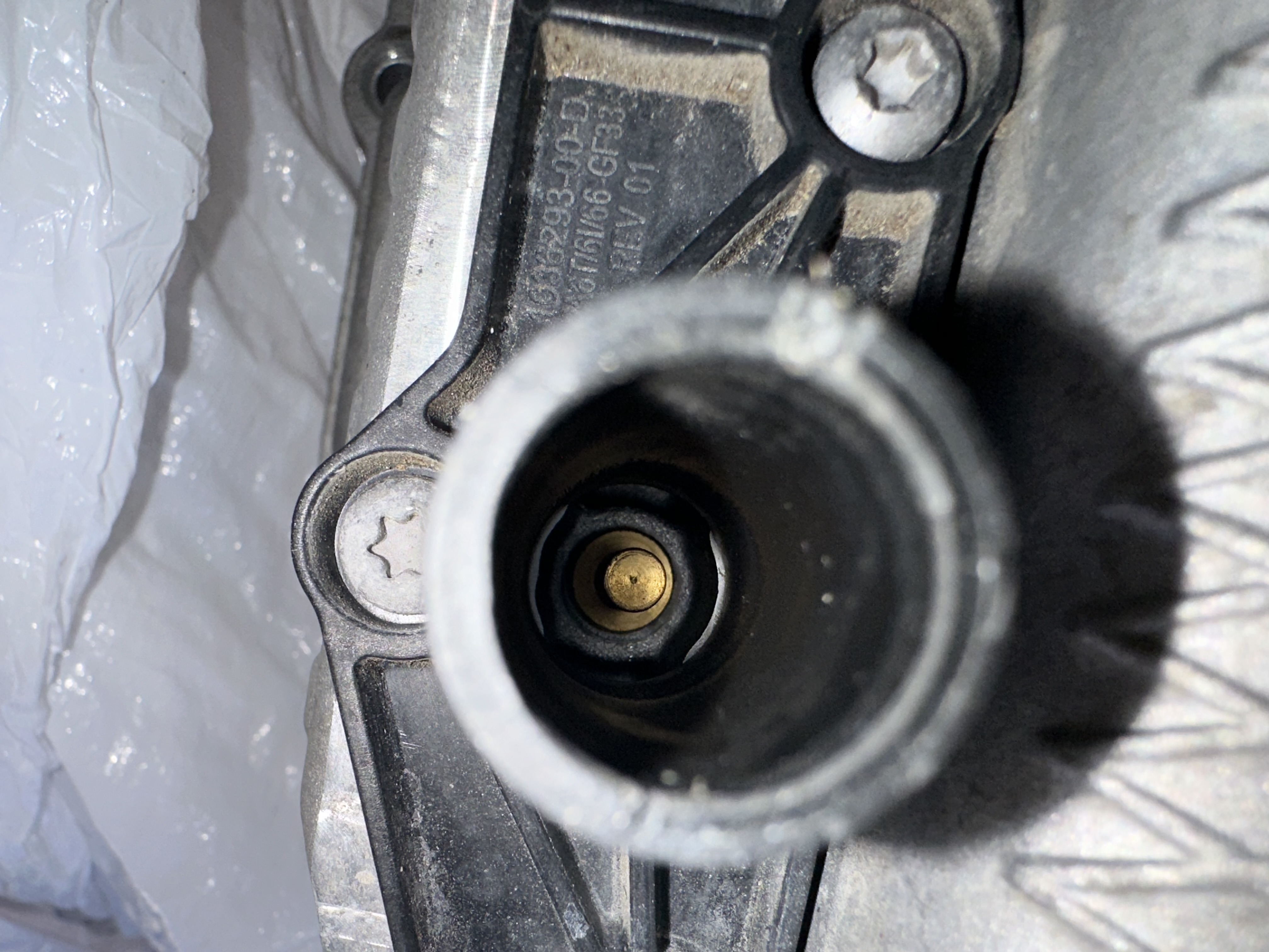

The outlet holds the coolant sensor? I thought tmpm was reading the igbt temp, but actually this temp probe.

alexbeatle wrote: Thu Oct 24, 2024 6:19 pm The outlet holds the coolant sensor? I thought tmpm was reading the igbt temp, but actually this temp probe.
There are 3 IGBT sensors which we display the maximum of (tmphs). Then there is a fluid and a stator temperature on the SDU and we only display stator temperature (tmpm). So the fluid sensor is ignored.
