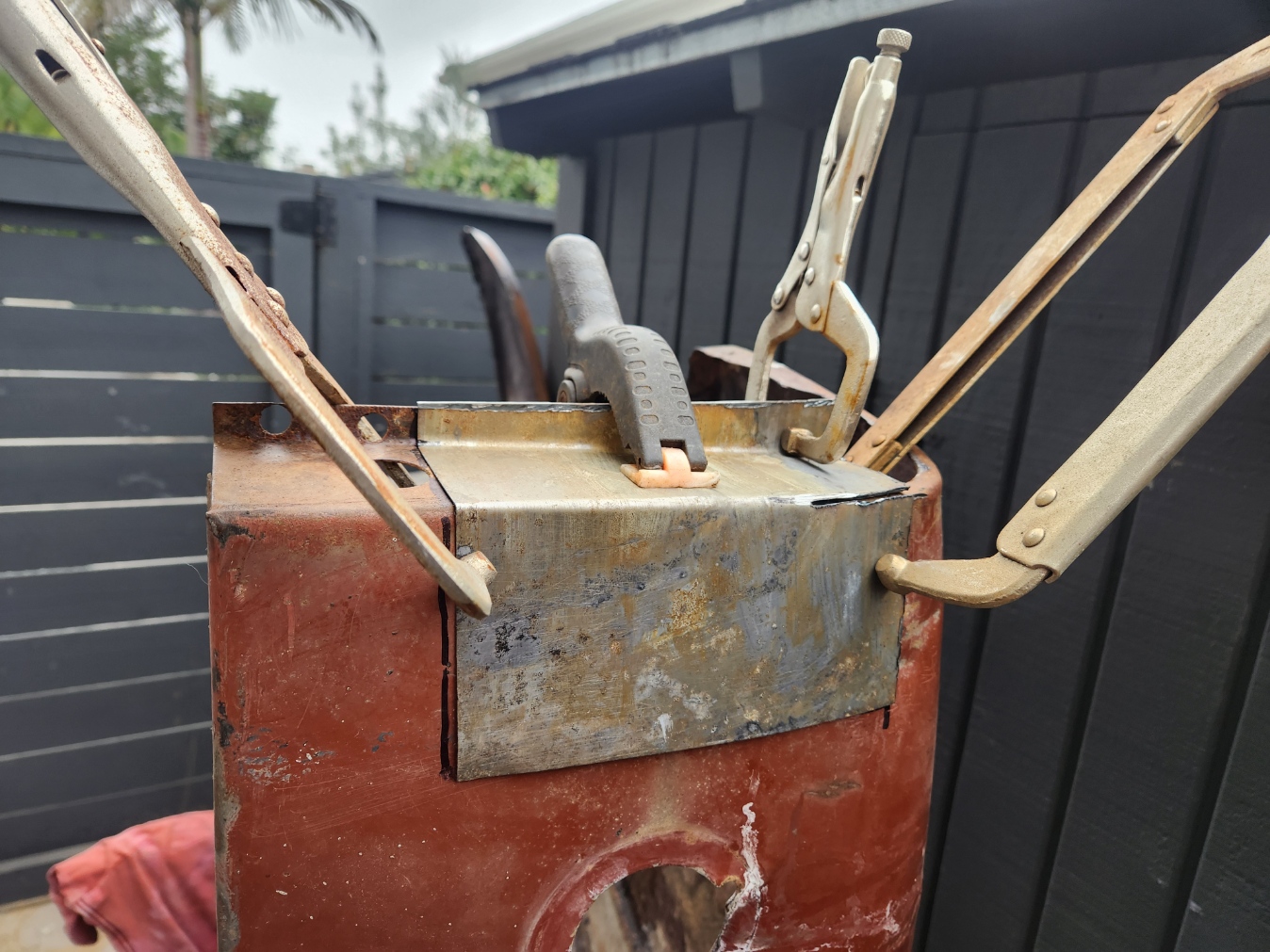

Time for some bodywork. This is the rear quarter end cap.
New replacements not available, and used parts seem ridiculous:
We will have to roll our own on this repair.
Knocked this piece together using all sorts of contraptions
This is how I ended tonight. Luckily I can weld both sides, so I can leave weld buildup on the other side. Have a couple of blow throughs I'm not happy with. Need to find a piece of copper to clamp against the joint while welding them solid. I'm also MIG'ing with straight CO2 because I have a large bottle here from homebrewing, argon mix would be better on this. Will take another pass tomorrow and clean things up
This whole panel is from another Scout, it runs from back of door and wraps around to tailgate. My original had severe damage. It had to be removed from the body tub by drilling out spot welds, so next steps will be to plug weld this guy back in. I'm going to need every clamp I have, and then some. I have a Cleco set I haven't used in years, may bust that out to help keep things straight
robertwa

The new panel has holes for side markers and the other side of the Scout does not, so this hole has to go too
Rear quarter finished, ready to be spot welded back on

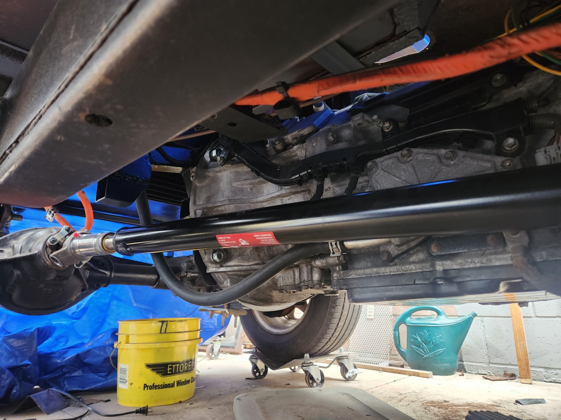

Got my rear adapter 3D printed, and received the flange yoke, all fits well. I've now ordered my driveshafts from my local driveline shop. Much cheaper at $900 total for front and back driveshafts. They also machined down my front flange to 94mm and advised me not to worry about needing an adapter, so that saves me some. Need to get the rear adapter quoted and CNC'd.

Waiting on delivery of the rear adapter flange, but got the driveshafts test fitted for now with the printed adapter on rear
Rear
Front
