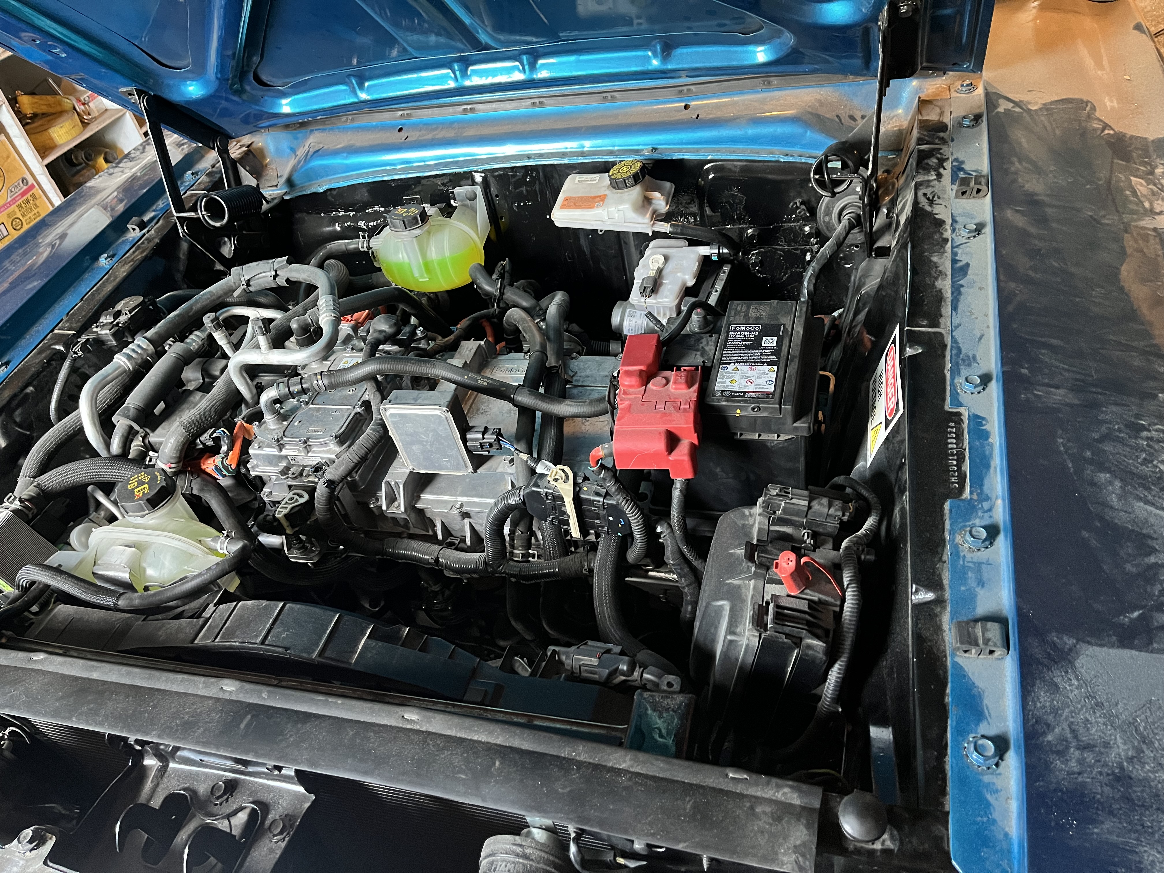

I have seen more hopeless candidates here. At least he seems to have cleared the mechanical hurdles without any problems. With the procedures suggested here, the rest should also be manageable with sufficient willpower. I would also like to see a few more photos of the car, especially of course the installation of the mach-e components.

Here’ under the hood
