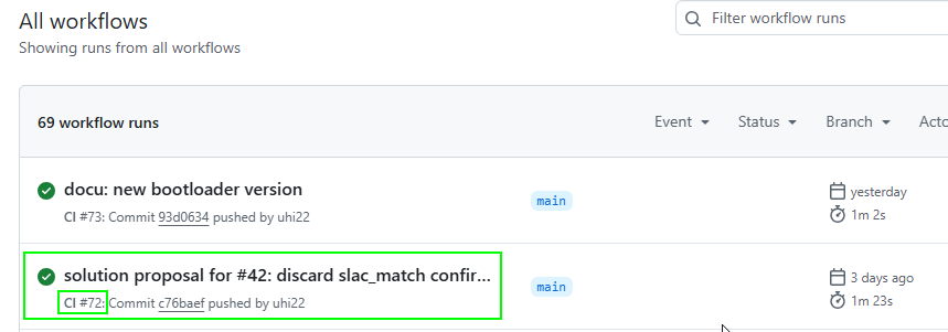

We have a confusion regarding the Clara version. On the github continuous integration page (on the "actions" tab) https://github.com/uhi22/ccs32clara/actions, there are the binaries available for each official version. The latest version is on the top of the list, with the highest run number. In this case, the #72 contains the fix:
In the "Artifacts" section of this run there are the zipped bin and hex files for flashing. After flashing, e.g. with STlink command line utility
ST-LINK_CLI -P stm32_canloader.hex -P CI_72.hex -V
the serial log of Clara should show the version:
This is Clara version 4=0.42.72.B
githubRunNumber 72
The 72 in the version and the githubRunNumber 72 are referring to the continuous integration build 72.

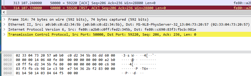

More interesting details: After the TCP gave up during CableCheck
the charger later sends again data
and the ping pong continues
And after Foccci sent again a CableCheck request, we get from the charger
and ignore these messages completely.
So two things to be done:
* The TCP timeout could be a bit longer than the currently implemented 10*100ms, because obviously sometimes the charger needs longer (~2s in this log).
* Analyze what messages does the charger send as last two, and why Foccci does not react on them.

Clarified: The last two messages from the charger are just a TCP ack and reset:
So let's increase the TCP timeout and see how this improves the situation. Issue created: https://github.com/uhi22/ccs32clara/issues/43
[Edit] Done: https://github.com/uhi22/ccs32clara/com ... 21ef3d3ec4
This indicates that the charger does not want to further talk on this TCP connection (socket was closed).So let's increase the TCP timeout and see how this improves the situation. Issue created: https://github.com/uhi22/ccs32clara/issues/43
