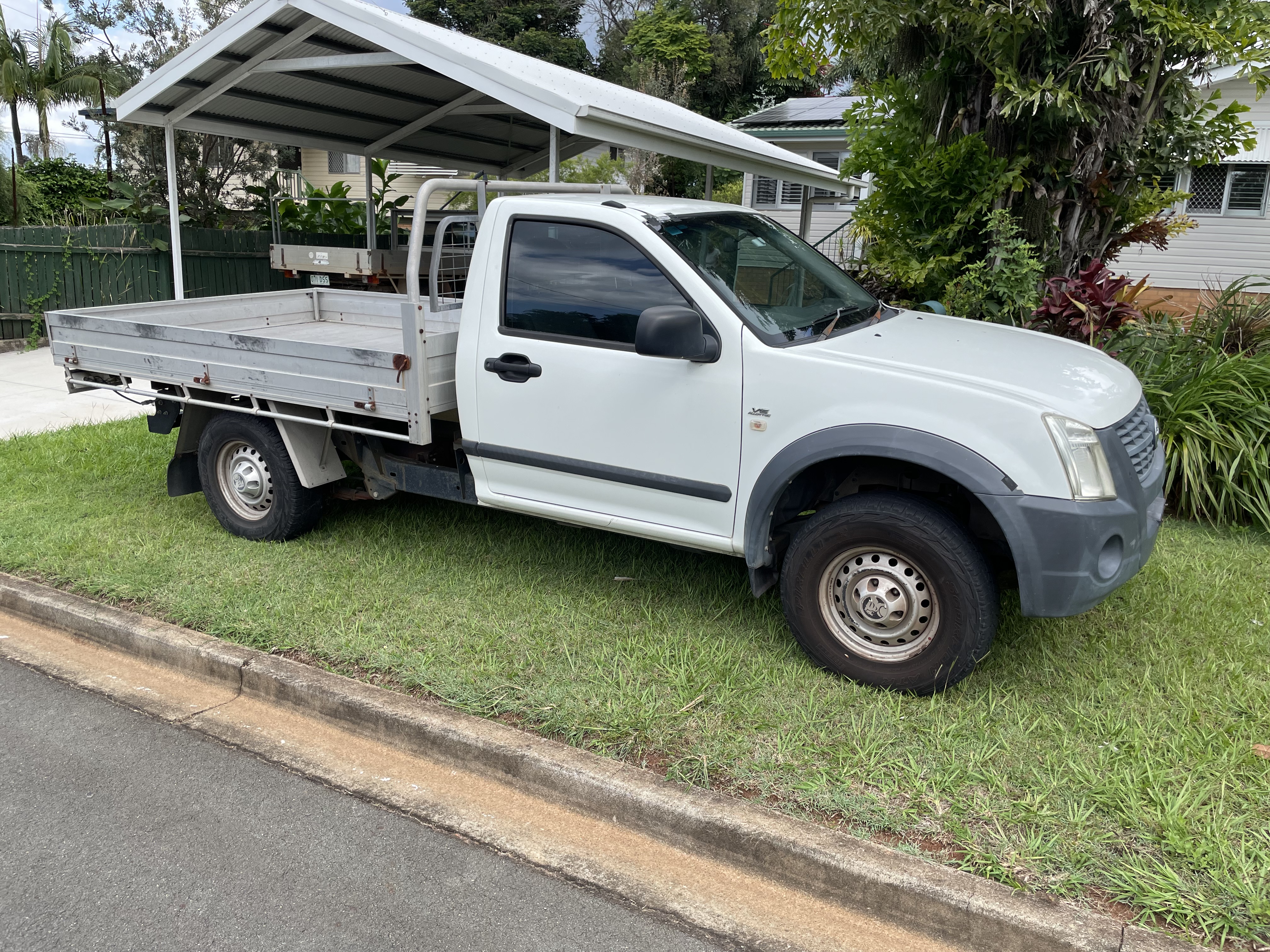

After 4 months of looking at potential cars, eventually one came along that met my requirements. So the car I am converting is a 2006 Holden Rodeo 2wd Hi-Rider, with an aluminium dropside tray. It has a 3.6 litre V6 Petrol engine, with a 5 speed manual gearbox. The car has done 182000 klms, and is in overall good condition, and drives well. The motor runs well too which is a bonus, so that will get sold to help fund the project. It was right on my maximum for cost at $2K, but I figured it was worth it, as it was in good condition and it met all of my requirements, and I will recoup some of the cost when I sell the V6 engine.

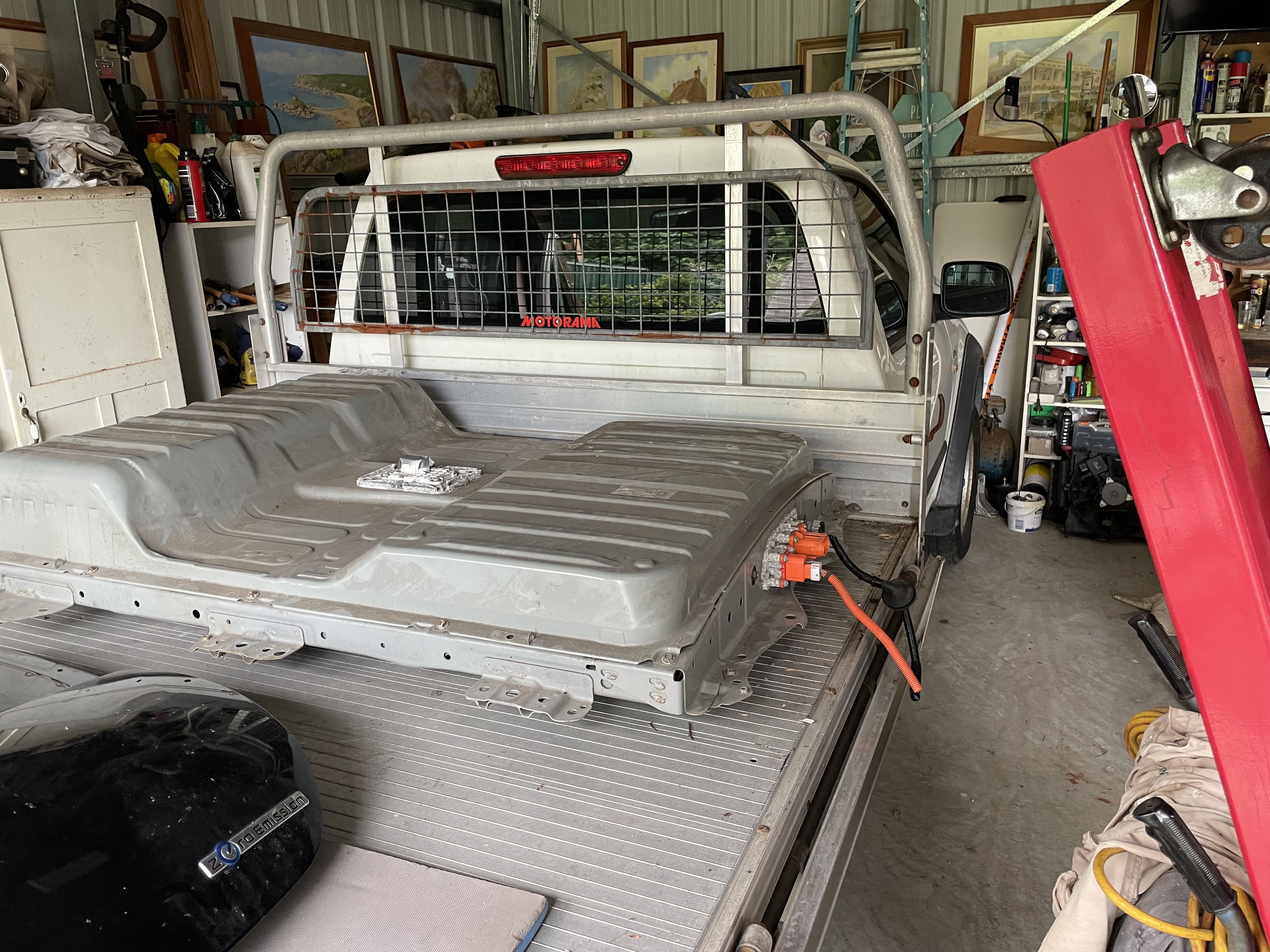

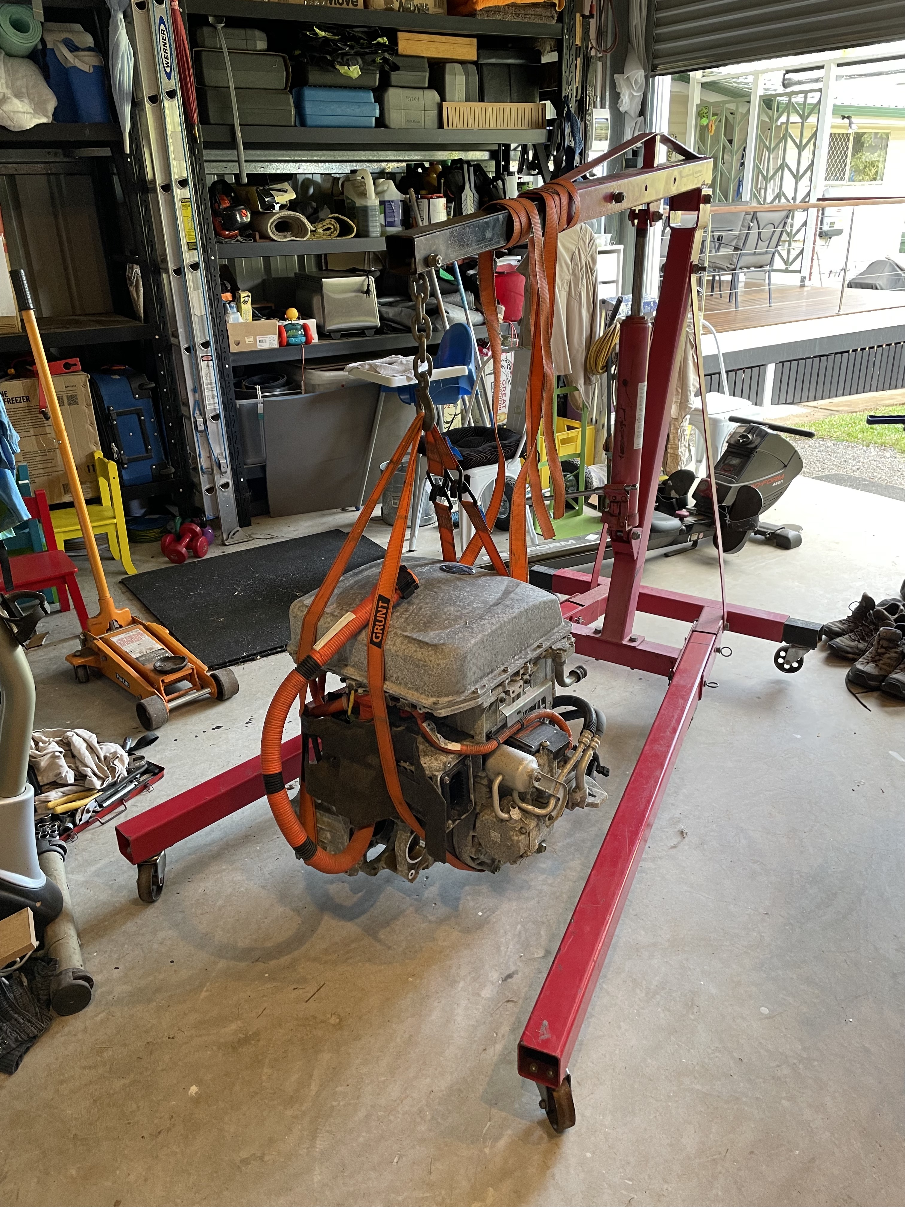

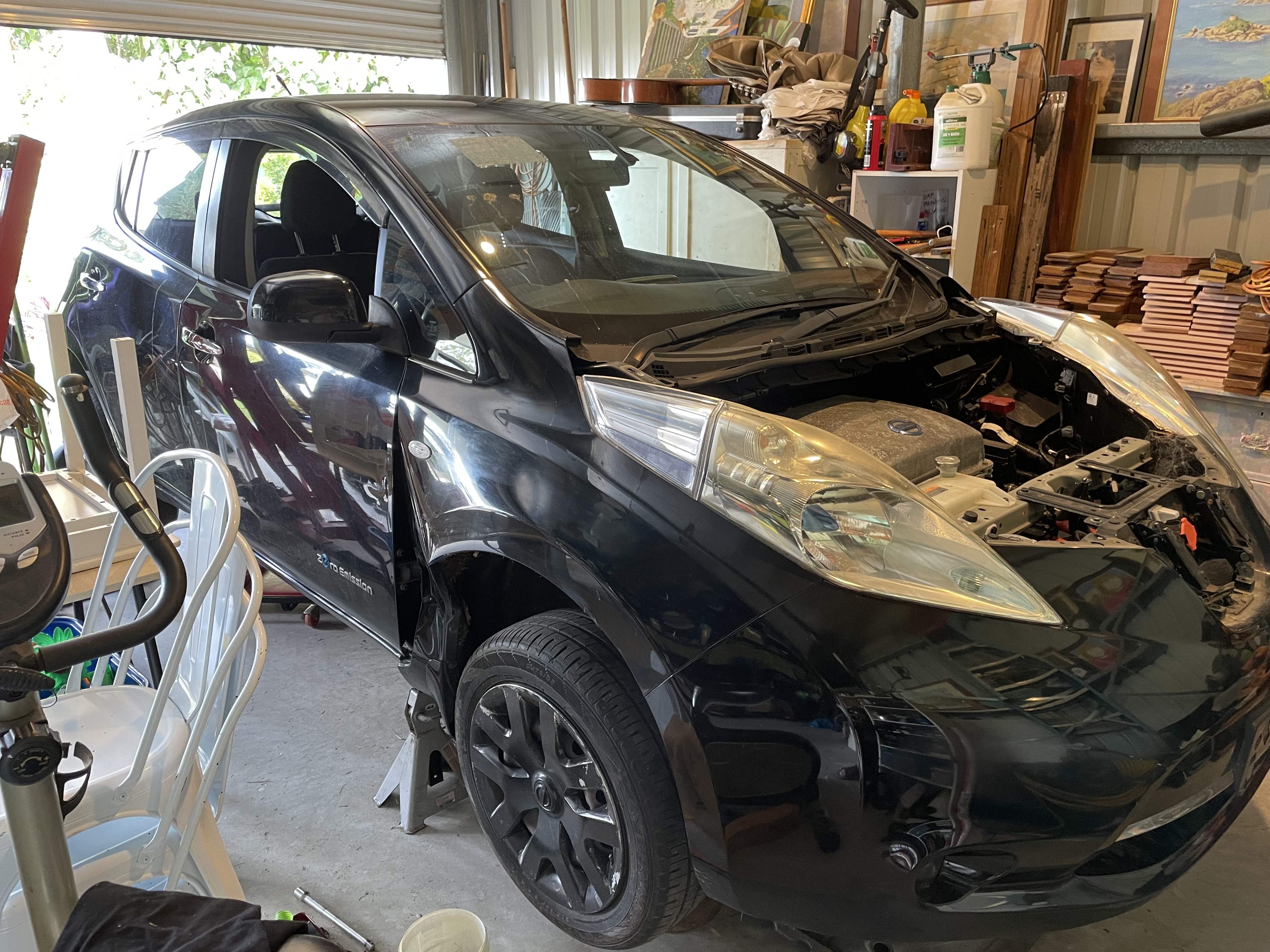

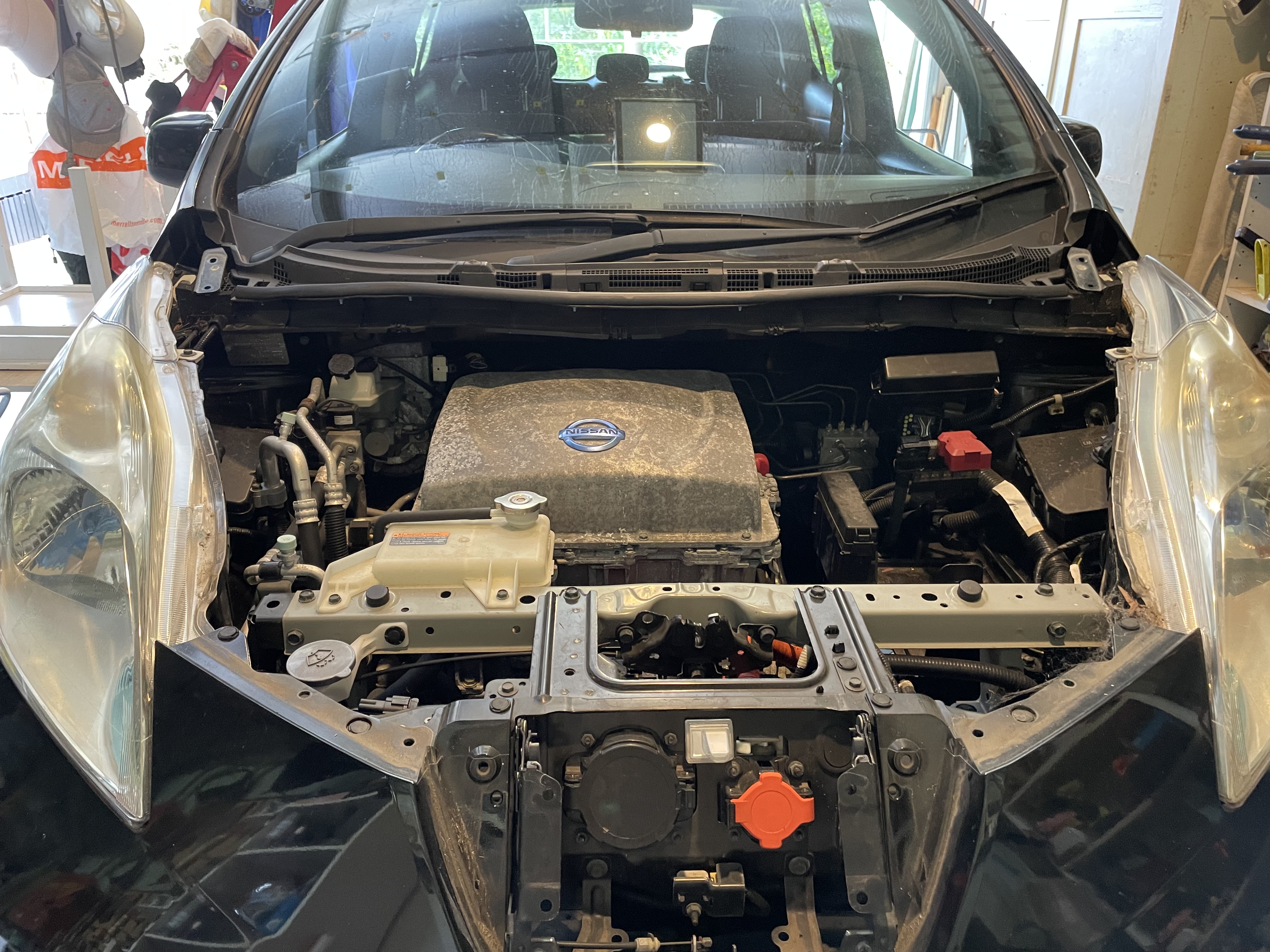

Episode 2 - Leaf Stripped
Hi Everyone - I had a productive first week, having successfully removed all the parts I needed from the Donor Leaf, as well as removing a lot of other parts I hope to sell in the future. I have watched quite a few youtube videos of people removing the Leaf drivetrain , and thought it was going to be a lot harder than it was! I Saw people using sabre saws and angle grinders to cut drive shafts etc, but luckily I didn’t need to do any of that. I reckon it only took about 1 hour to get both driveshafts out, and then the motor stack and transaxle came out without a problem. Similarly the main HV battery came out fairly easy. I Got the car up nice and high on stands and then just lowered the battery on my floor jack before rolling it out from under the car on that. Far and away the longest and hardest job was stripping the interior of the car ( seats, dash etc.).

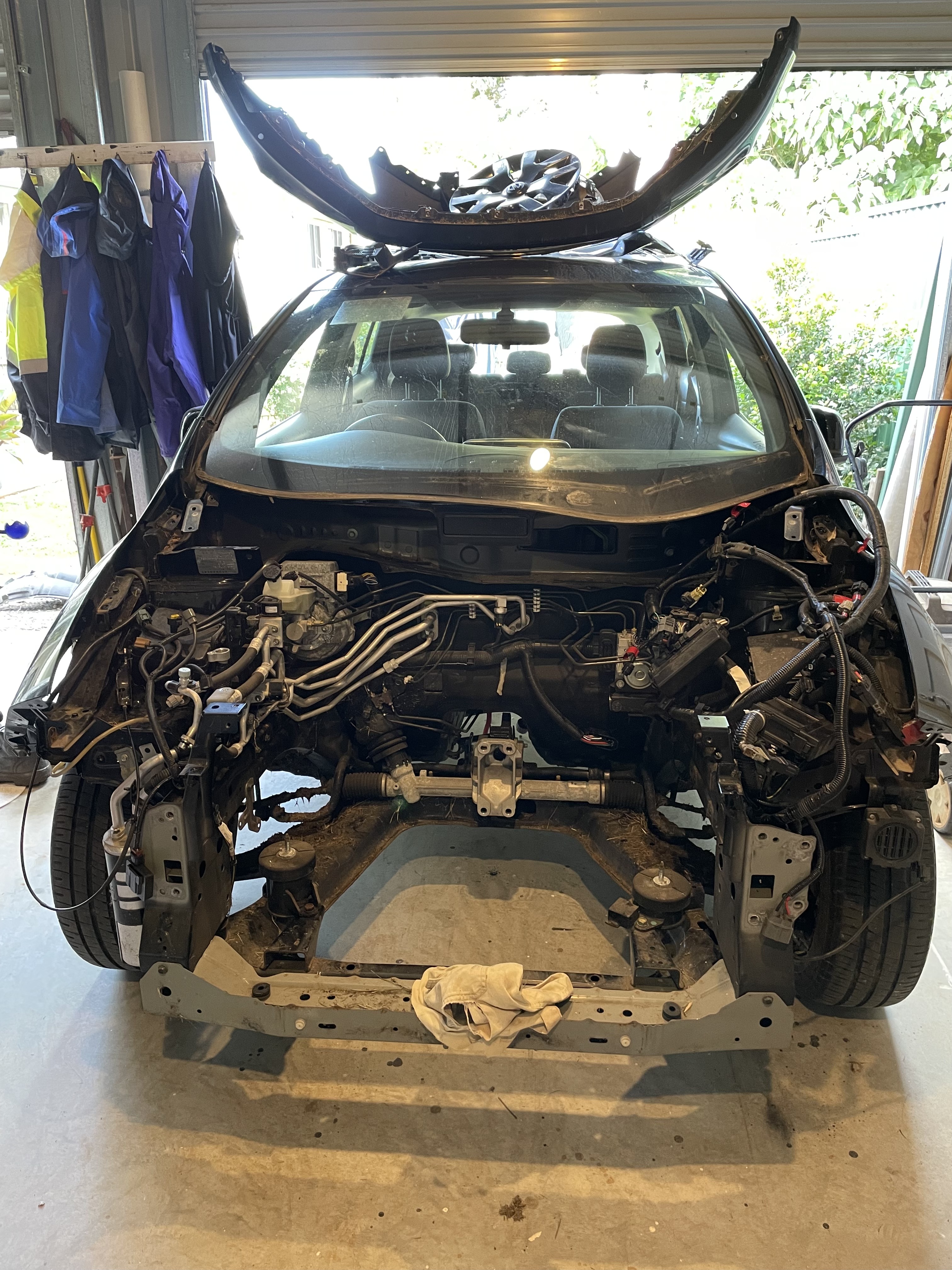

The bonnet is off and we begin!

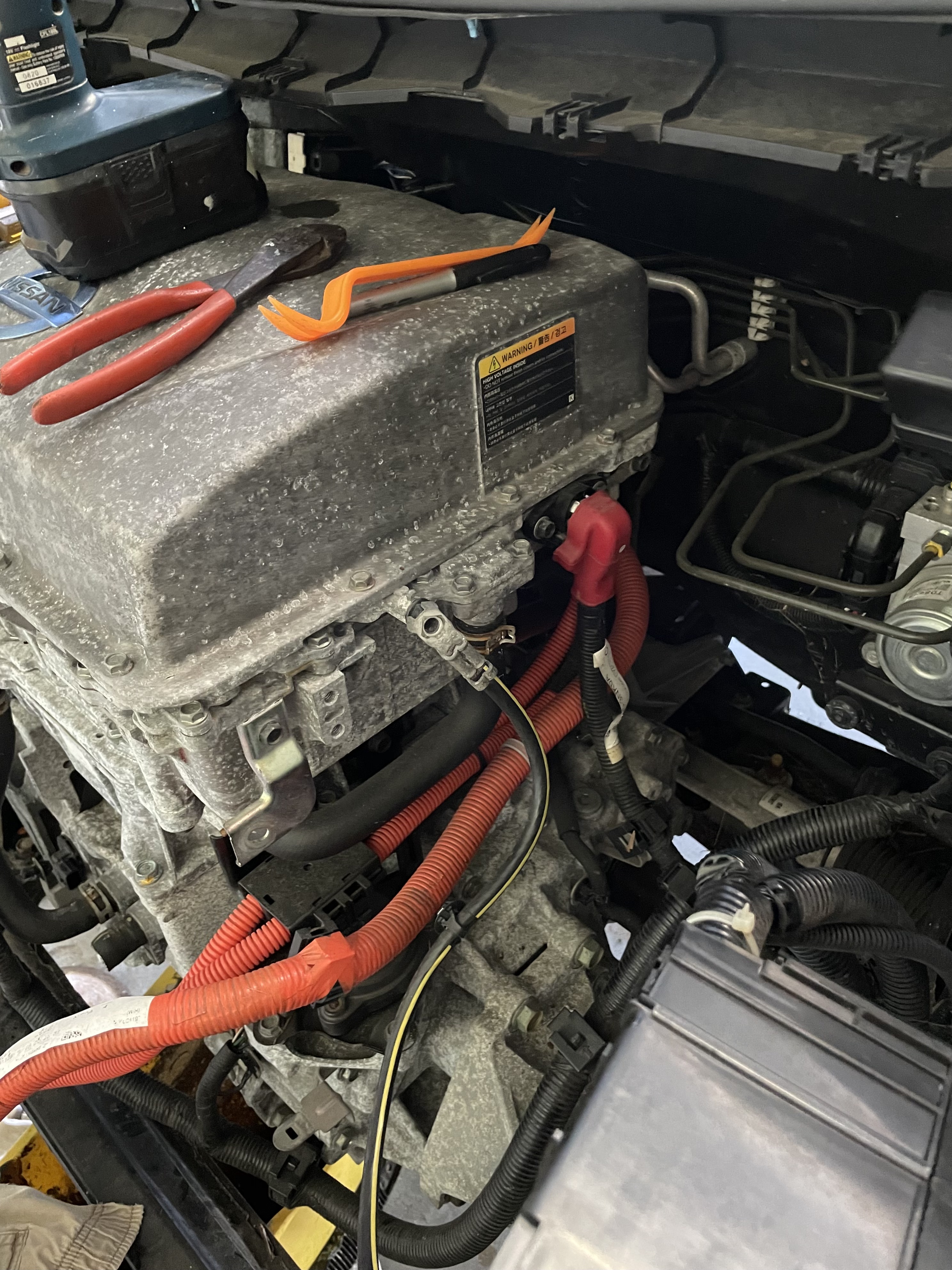

Lots of cables to label
And its out!
And its out!

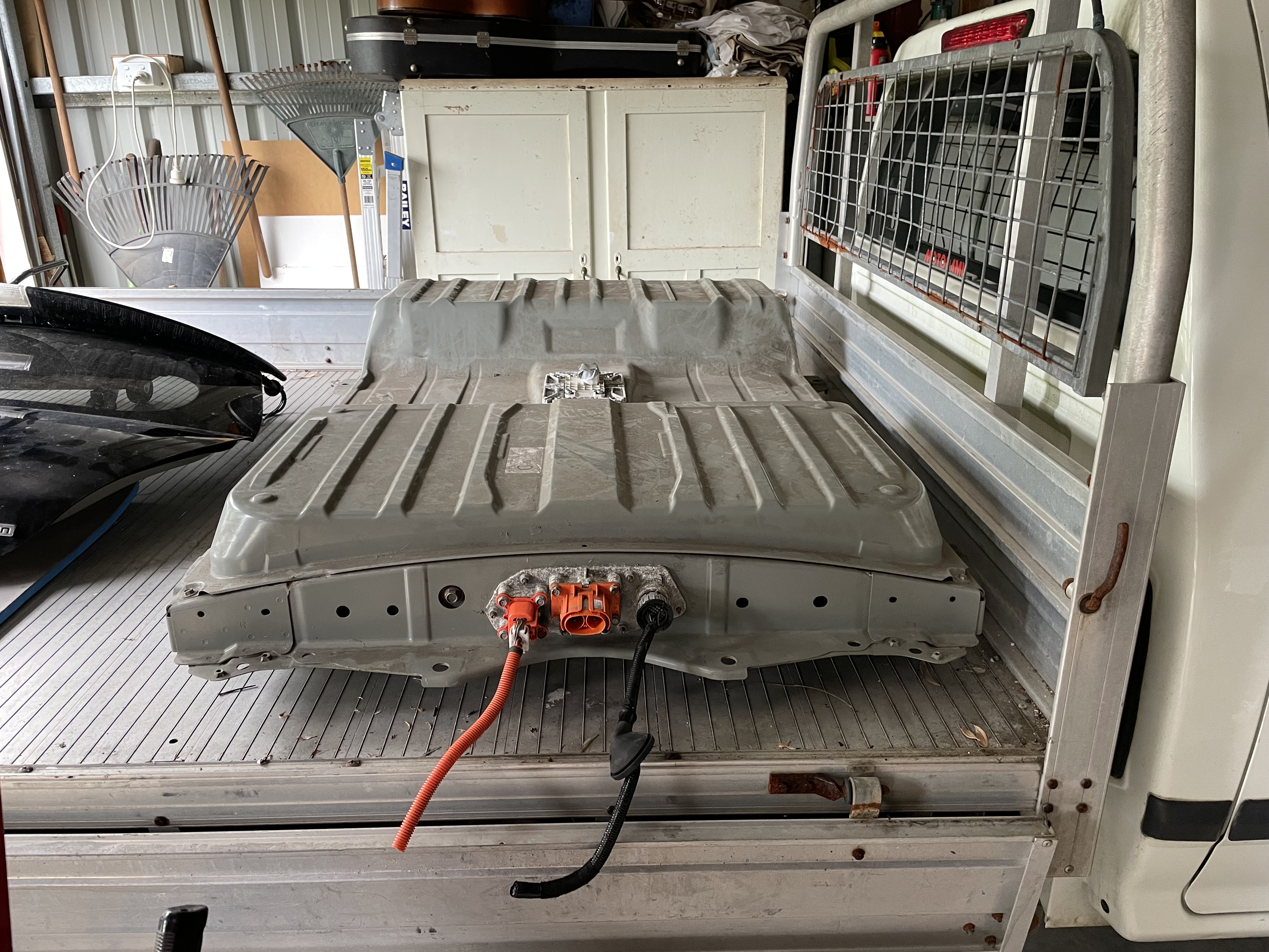

Have to find somewhere for this now

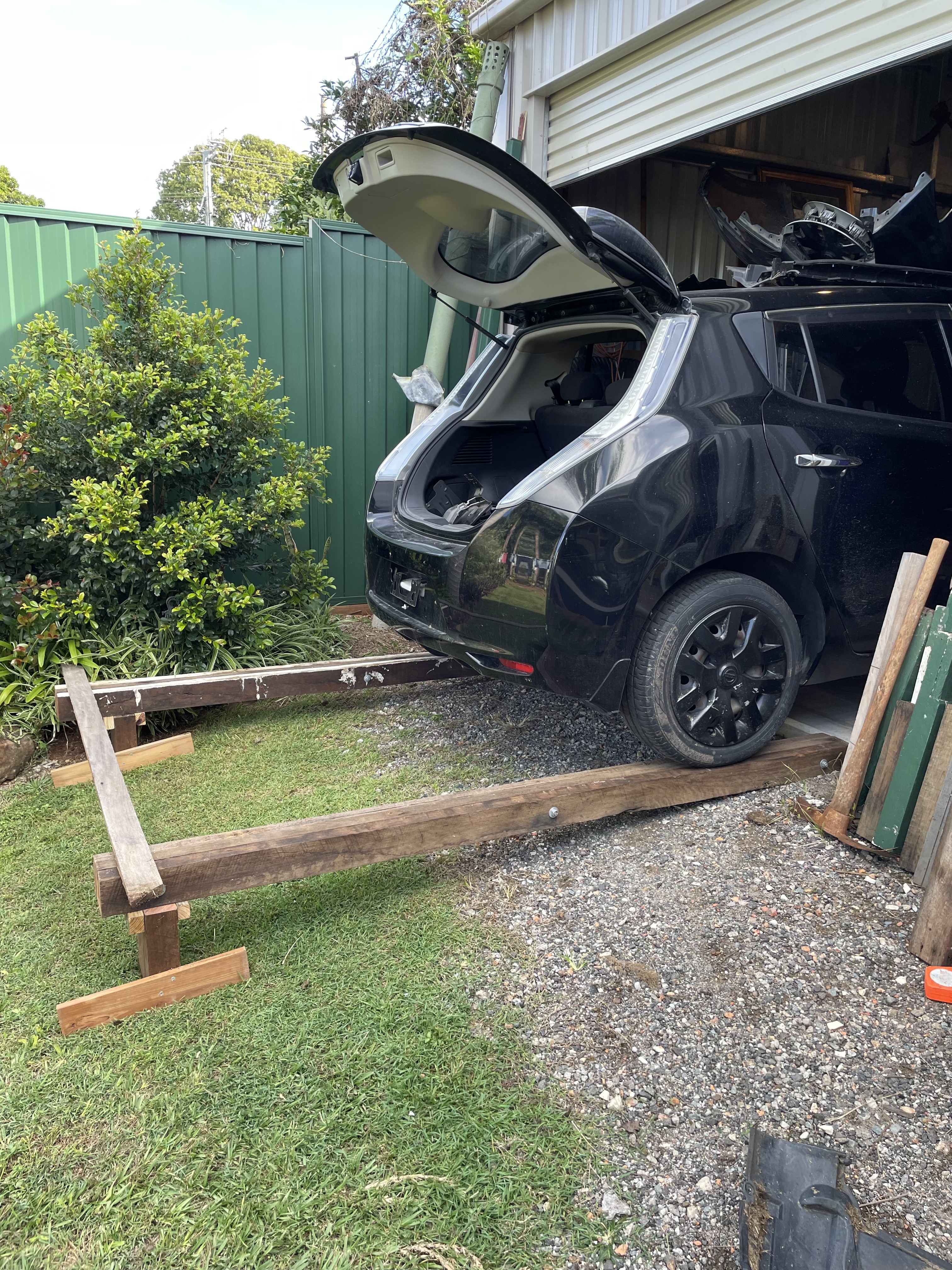

These temporary ramps let me push the car out by myself to make room for the engine crane.  They are built this long to also suit the Rodeo

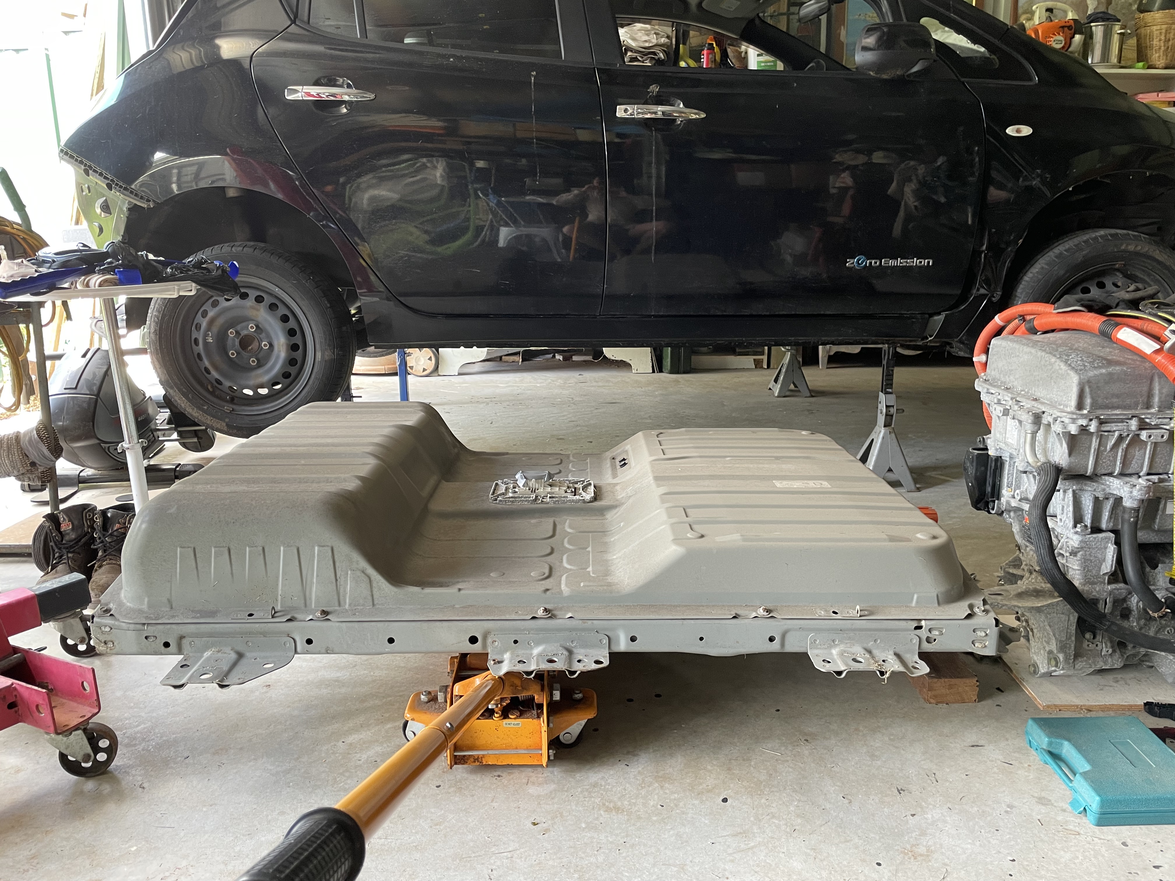

Battery came out easy on the floor jack - having a nice smooth floor helped!
So with all of the parts removed the next job is to dispose of the Leaf body, and then move the Rodeo in to begin de-icing it.

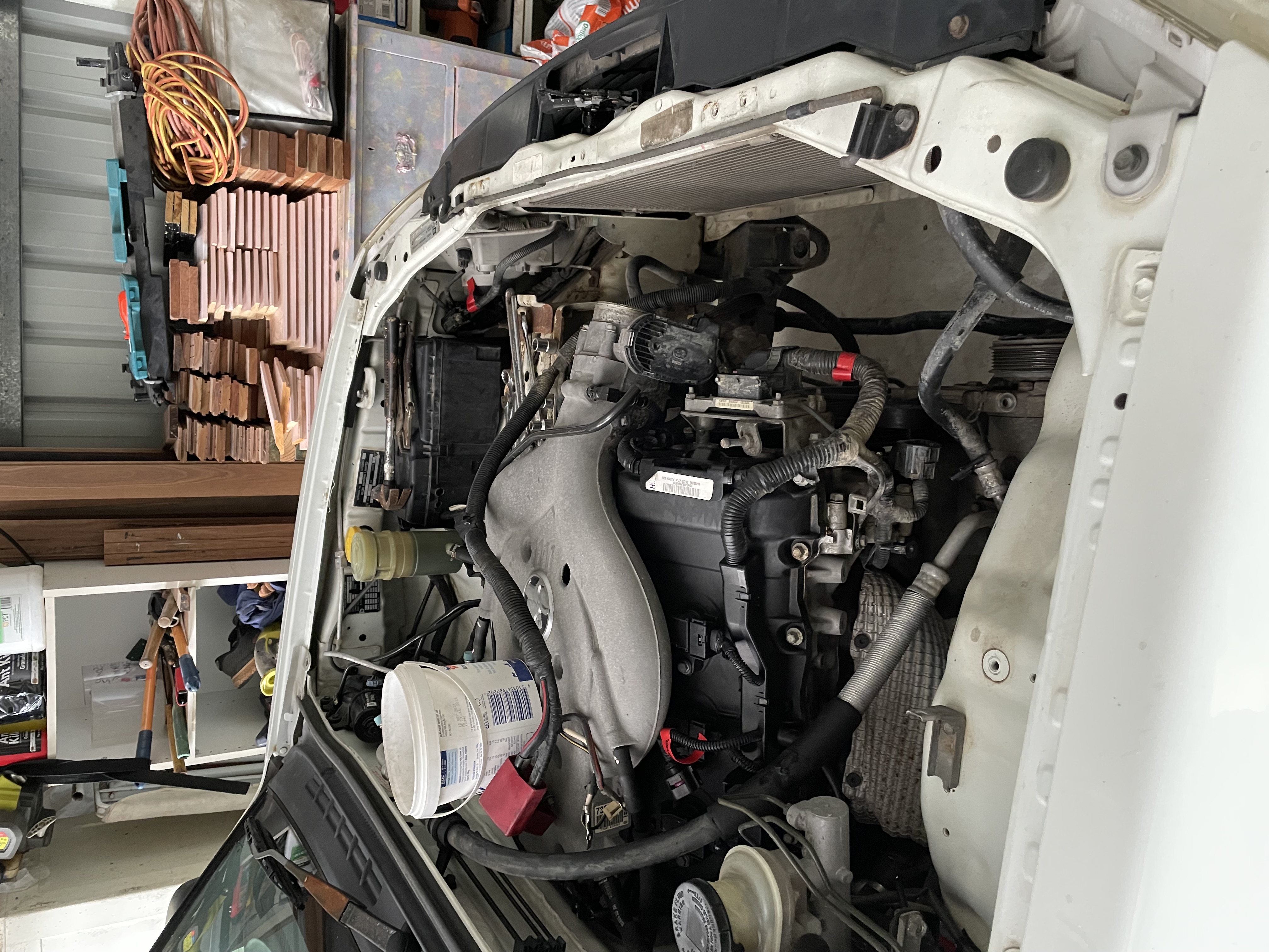

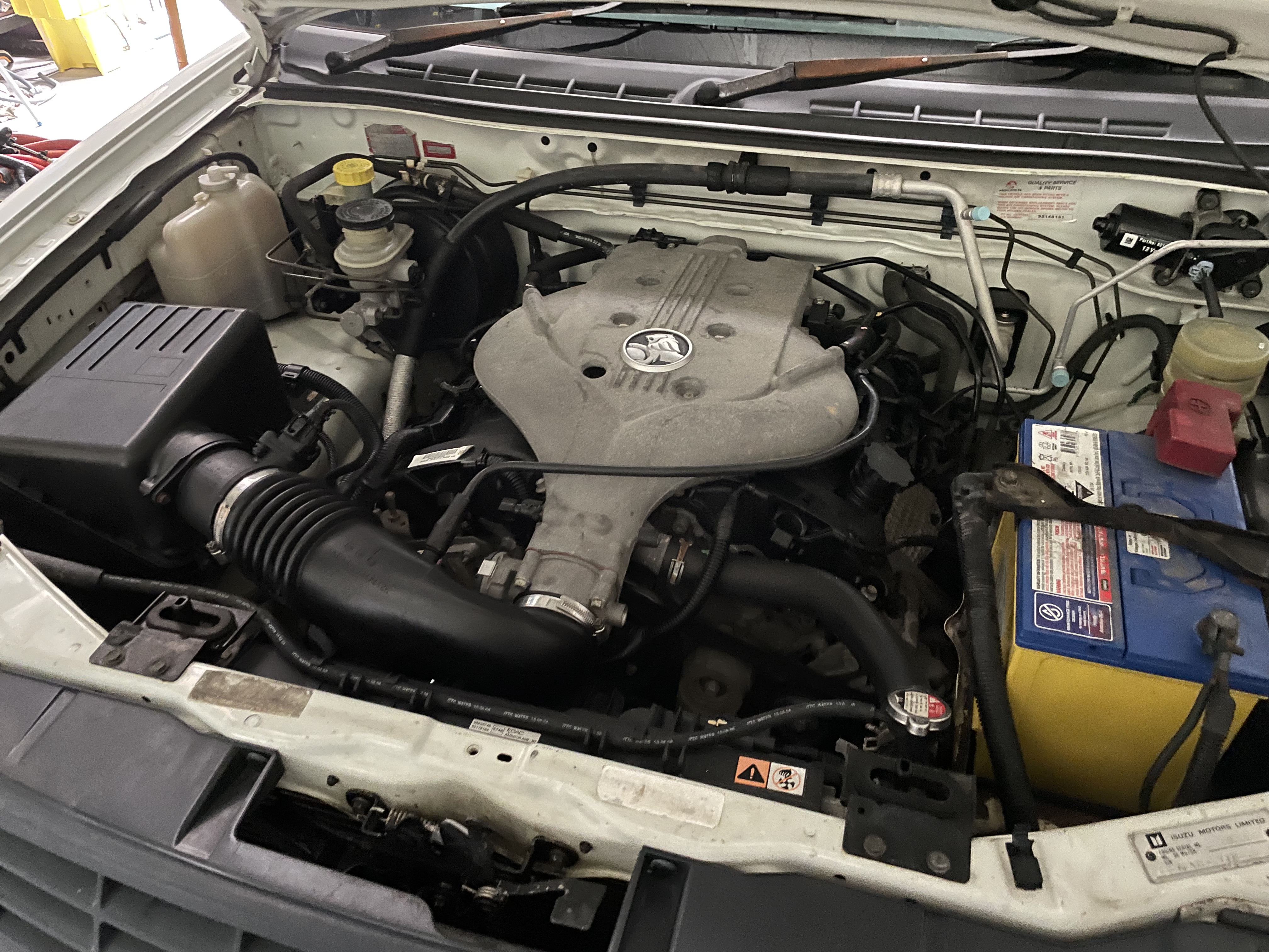

I have the Rodeo in the shed now and after taking some CAN logs for reference I have started work on removing the engine. I have pre-sold the engine, so am being very careful in how I go about it to make sure that no damage is done to it. It has been a very slow process as the V6 engine is a very tight fit in the Rodeo engine bay. It took me half a day just to get the Alternator off! and I am having the usual problems with seized bolts on the exhaust system. But I am getting there bit by bit, and hope to have the motor and gearbox out by the end of the week.
Space is tight in the workshop so luckily the ute tray makes a good storage area
Not a lot of room to work around the engine
