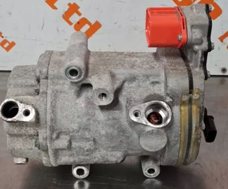

This topic is to track the reverse engineering of the Nissan Leaf ZE1 AC compressor. This is the one from vehicles with a Heatpump.
From Leaf model year 2017-2023
It is label Denso S1 ESB27C
The pinout is as follows:
Left most pin 12V ign, middle is ground, right is LIN

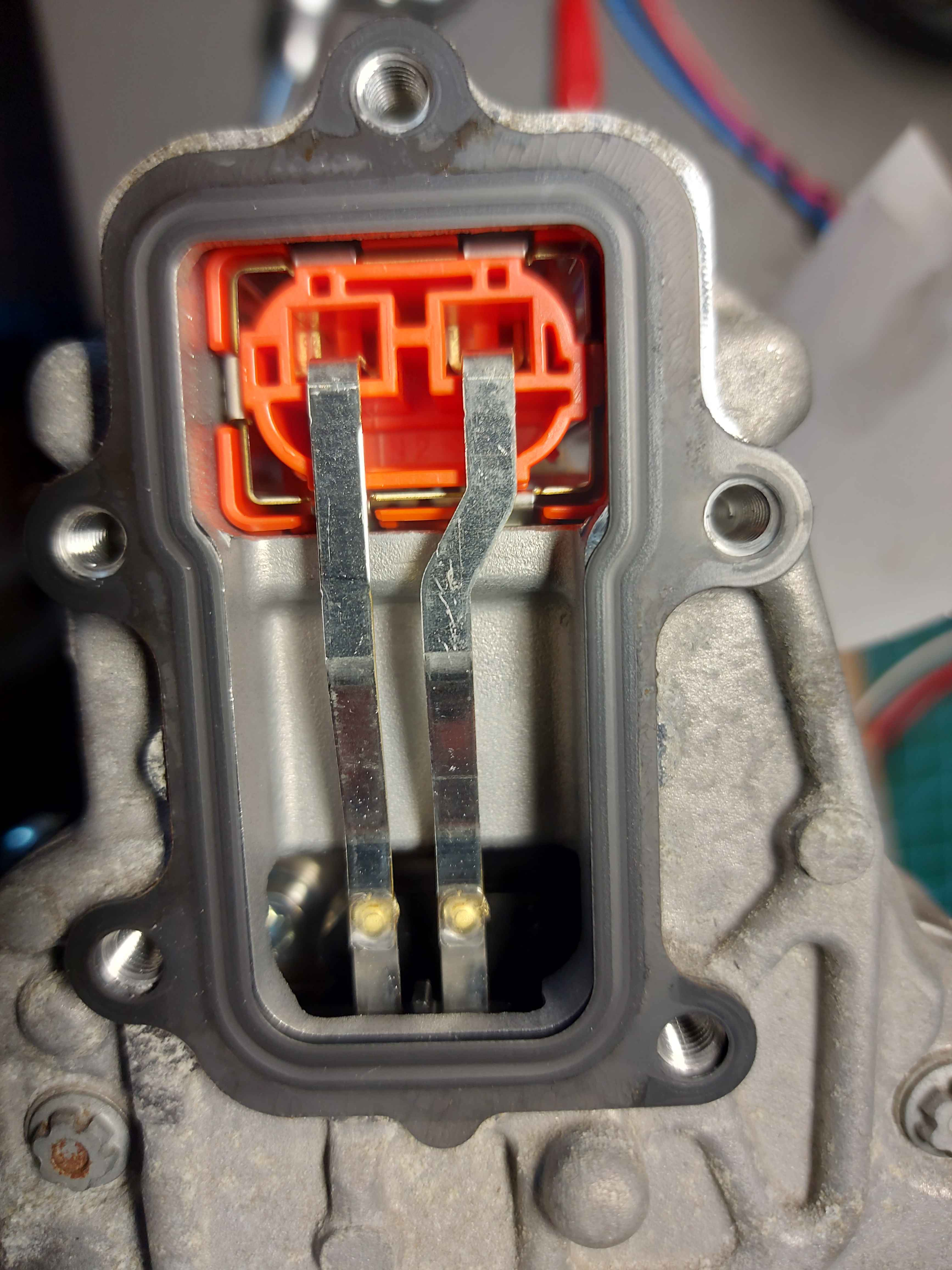

HV, Red is positive Blue is negative
It will not communicate unless it has HV voltage going in, the logic must be HV powered.

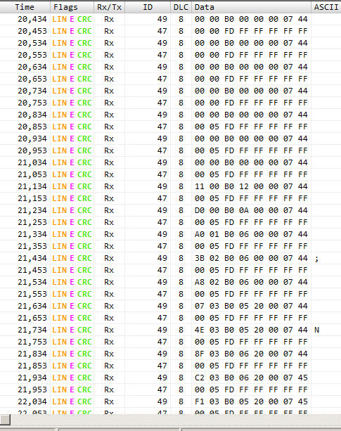

char RX_BUF[80];
//char data[11] = {0x55,0x47,0x00,0x00,0xFD,0xFF,0xFF,0xFF,0xFF,0xFF,0x00};//COMPR-ZE1
//char data[11] = {0x55,0xFB,0xB3,0x05,0x00,0x90,0xFF,0x00,0x00,0x00,0x00};
//char data[11] = {0x55,0x3B,0x00,0x00,0x00,0xC0,0xFF,0x00,0x00,0x00,0x00};//HEAT-ZE0
char data[11] = {0x55,0xFB,0x00,0x00,0x63,0xC0,0xFF,0x00,0x00,0x00,0x00};//HEAT-AZE0
char dataRX[8];

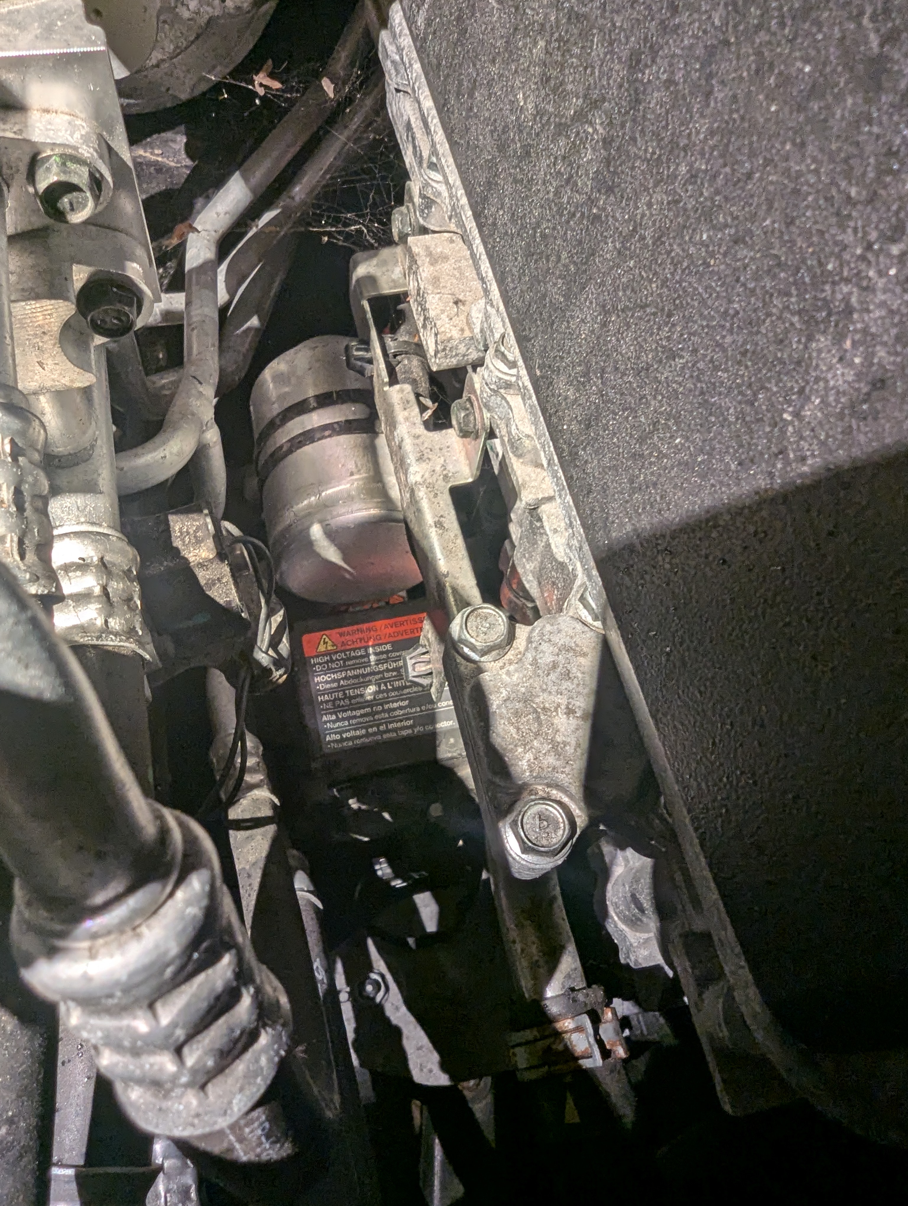

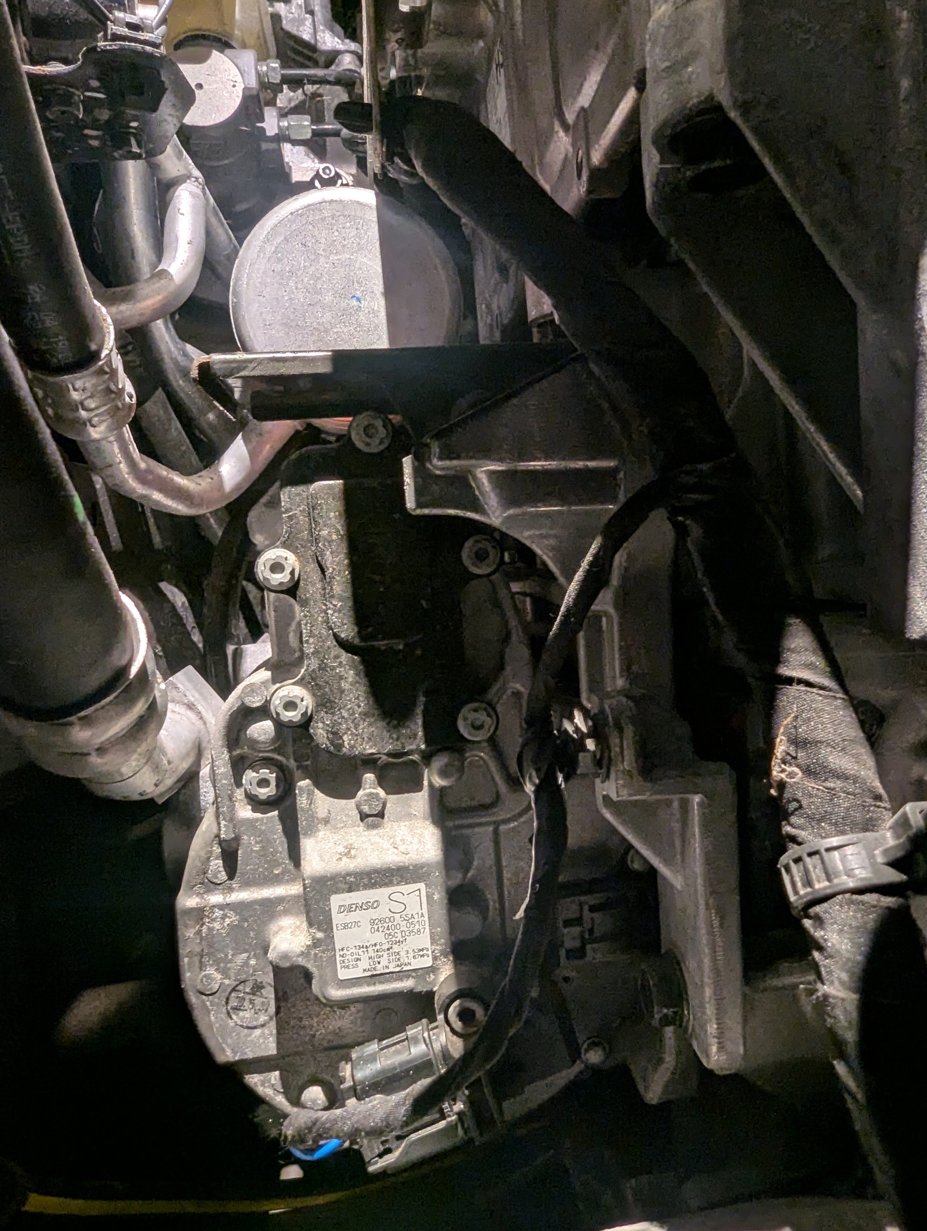

Can you take a picture of you AC pump on your leaf you logged?
Posts: 2443
Location: Bristol
Has thanked: 213 times
Been thanked: 599 times
Re: Nissan Leaf ZE1 AC compressor LIN
Trying to use the supplied info to get it working but I am having no luck on the bench.
Maybe the compressor needs to see pressures before it will spin up, some compressor do not care about this.
aot93
Posts: 212
Location: UK, West Sussex
Has thanked: 8 times
Been thanked: 48 times
Post by aot93 »
[/quote]
[/quote]
Here you go;

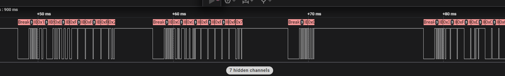

aot93 wrote: Sun Oct 27, 2024 8:27 pm Bit hard to get the pump to cycle on and off in these temps, but I did a max heating, Max Cooling and off.
Surprisingly I do see ID 0x07 (PID 0x47) which is indicated as the command from the info above.
However the response from the compressor, which should be ID 0x09 (PID 0x49) seems to be missing and very poor. How did you make the connection for logging? As I would not expect this on the bench it is very stable for me.
aot93 wrote: Tue Oct 29, 2024 2:24 pm I can grab some more logs tonight to be sure.
That be super, I have no clue why ID 0x09 is so random and inconsistent in nature. It varies in length and even has times where it not responds, all of which is very much unlike LIN bus.
aot93 wrote: Tue Oct 29, 2024 3:01 pm What sample rate do you use / recommend for lin bus?
Could be the Amazon box is getting a little overwhelmed?
Nope all other IDs and the waveforms match, this is why it is wierd.
The one with just the data request and id 0x09 us the short burst

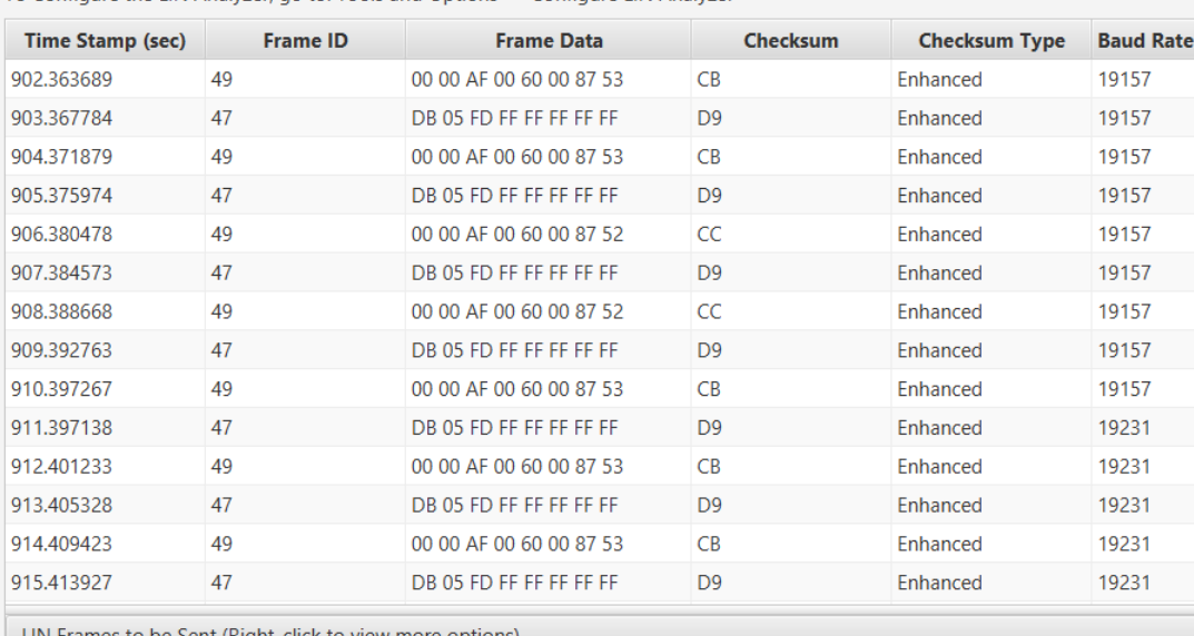

Marat wrote: Sat Oct 26, 2024 8:30 pm "screenshot"
My AC compress shows the following:
|ID: 49- Data 0:0:C1:0:60:0:87:54:- Check: B8
Where C1 is the voltage of 386V, your screenshot shows mostly zeros except the end. Is this an indication there might be an issue with my AC compressor?
Mind sharing any more information you have on this?
