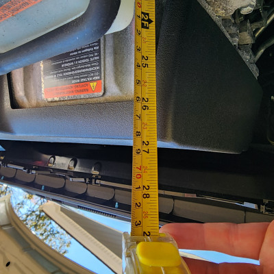

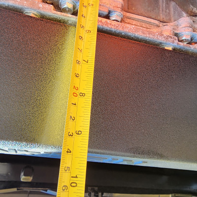

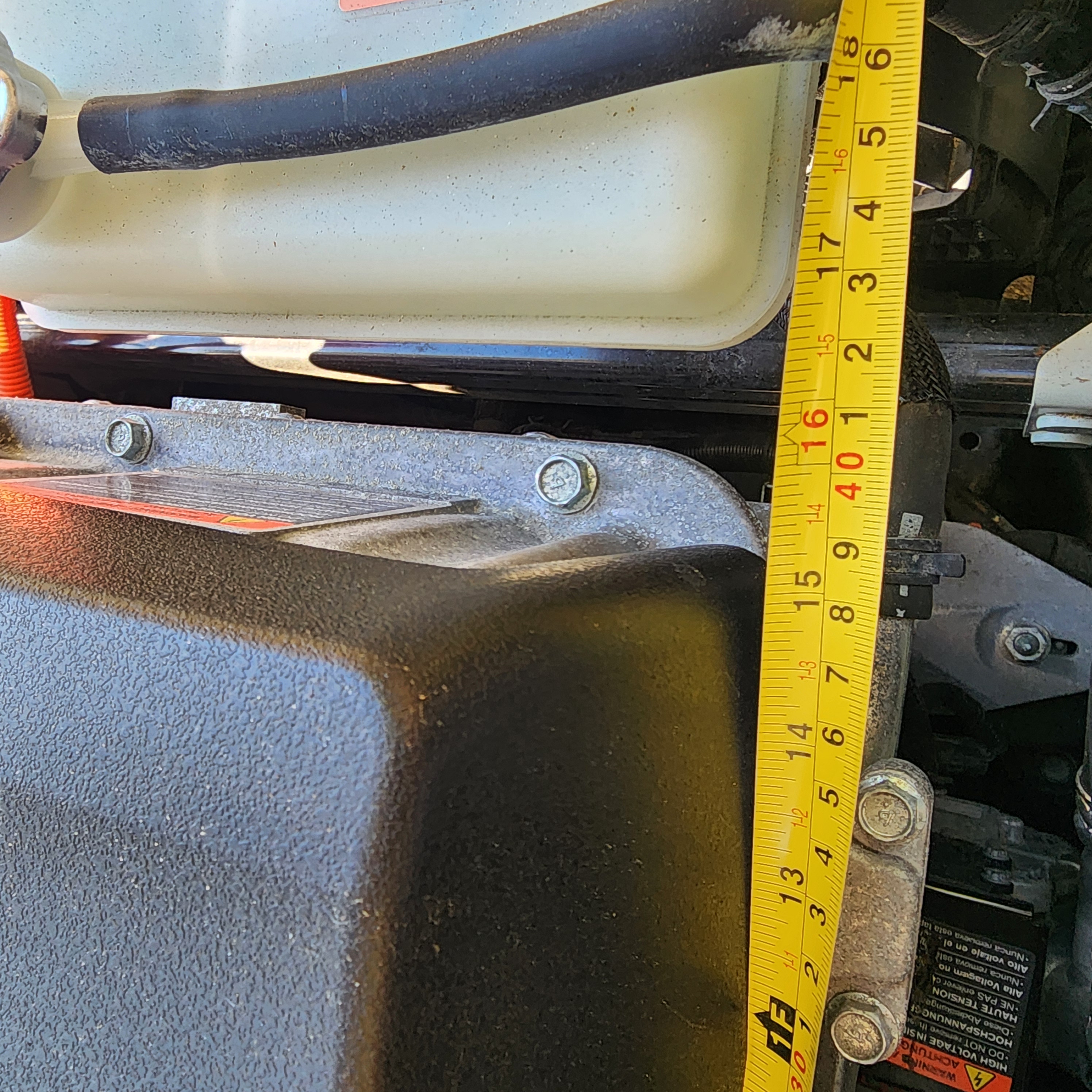

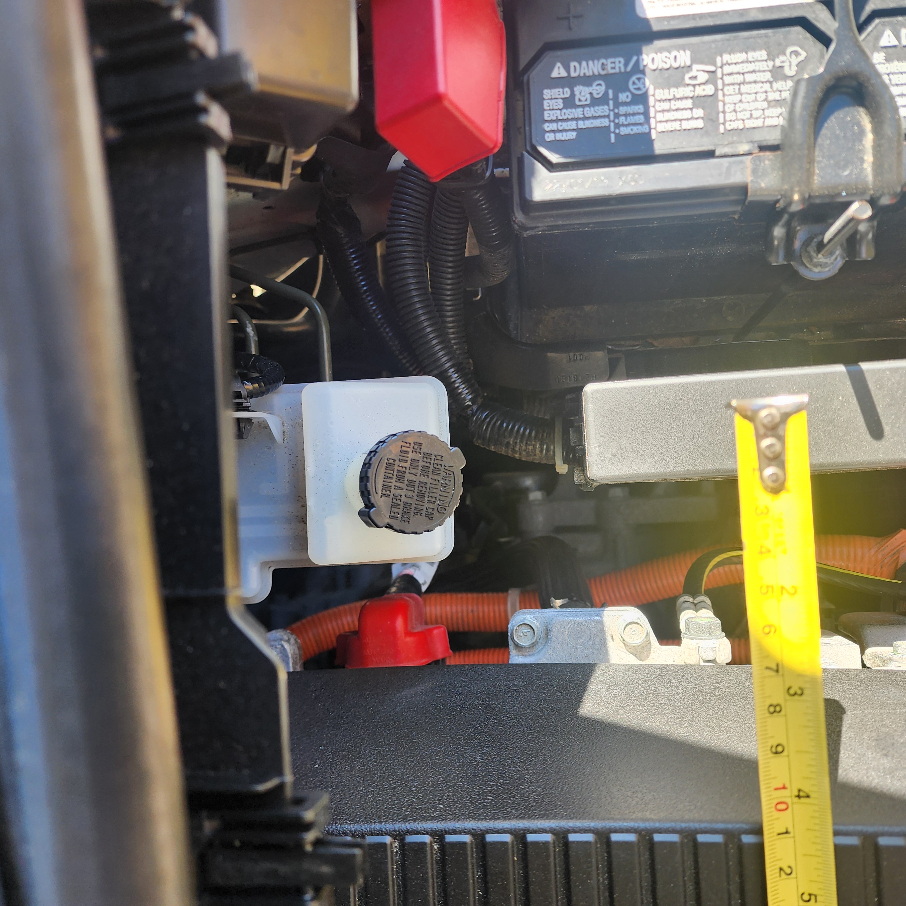

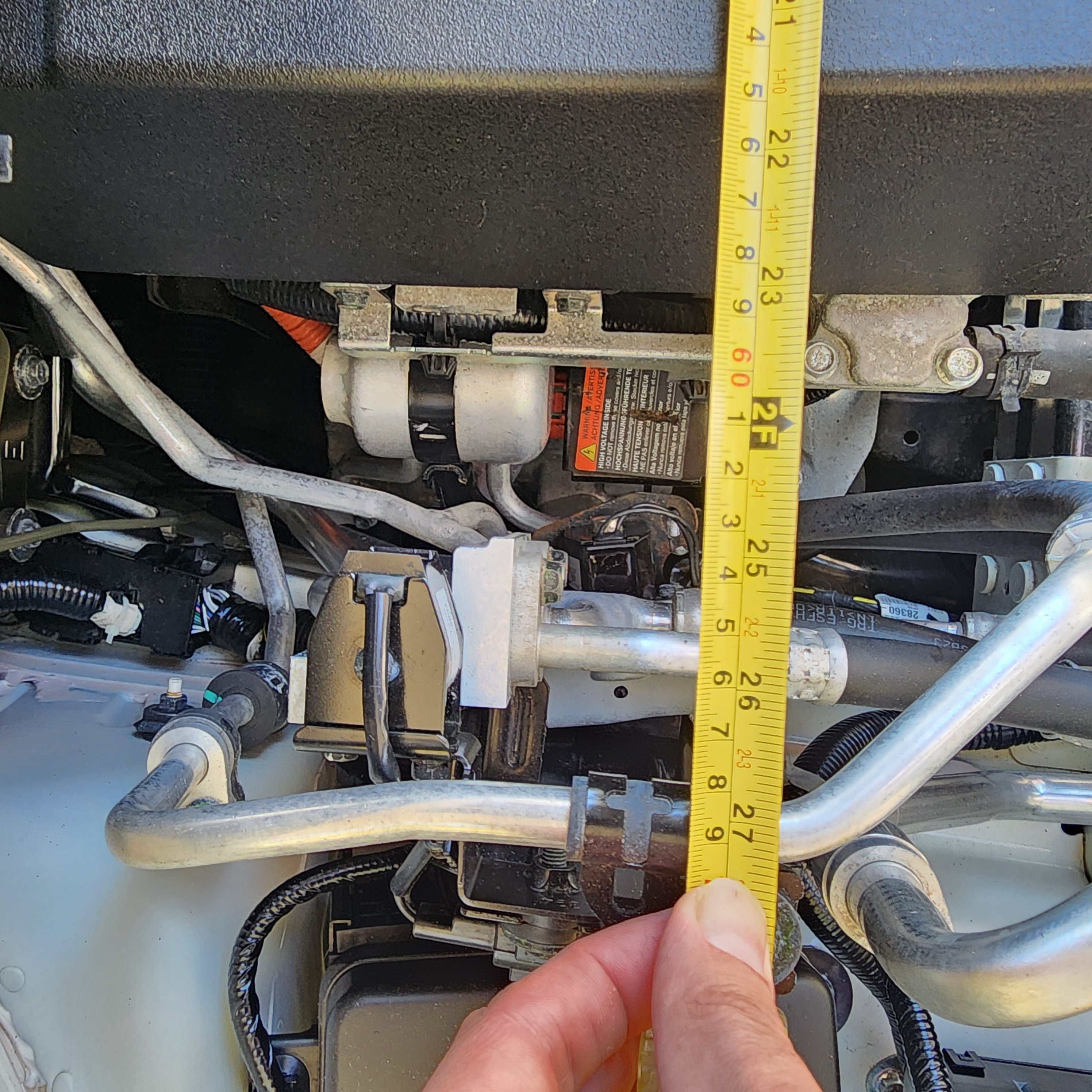

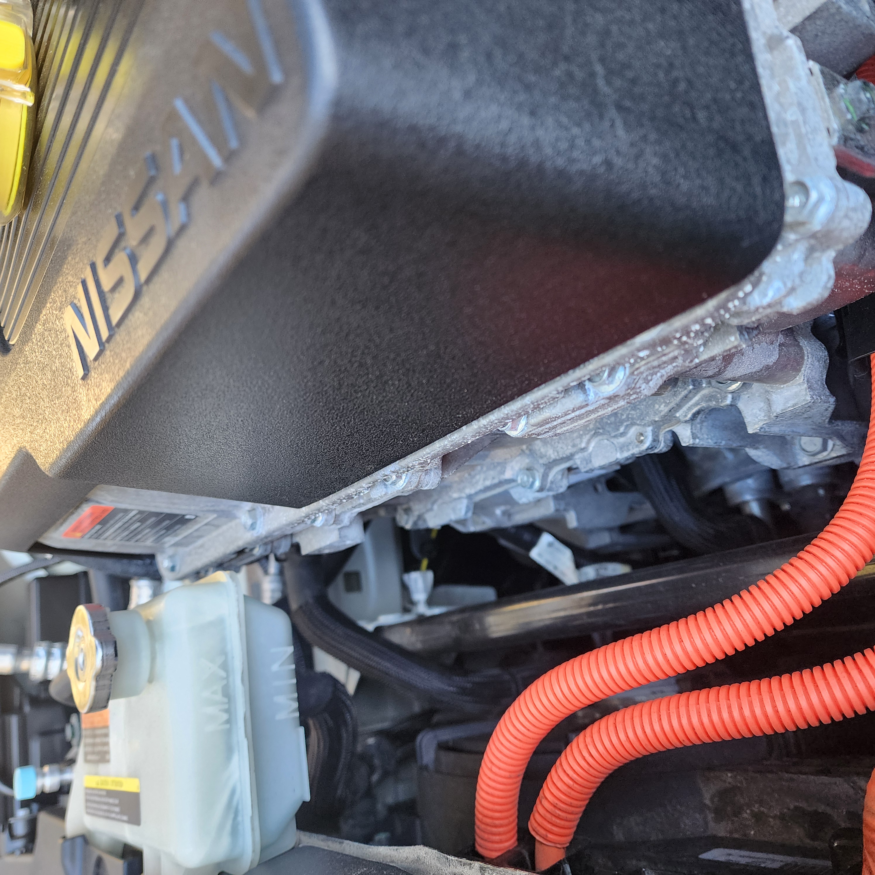

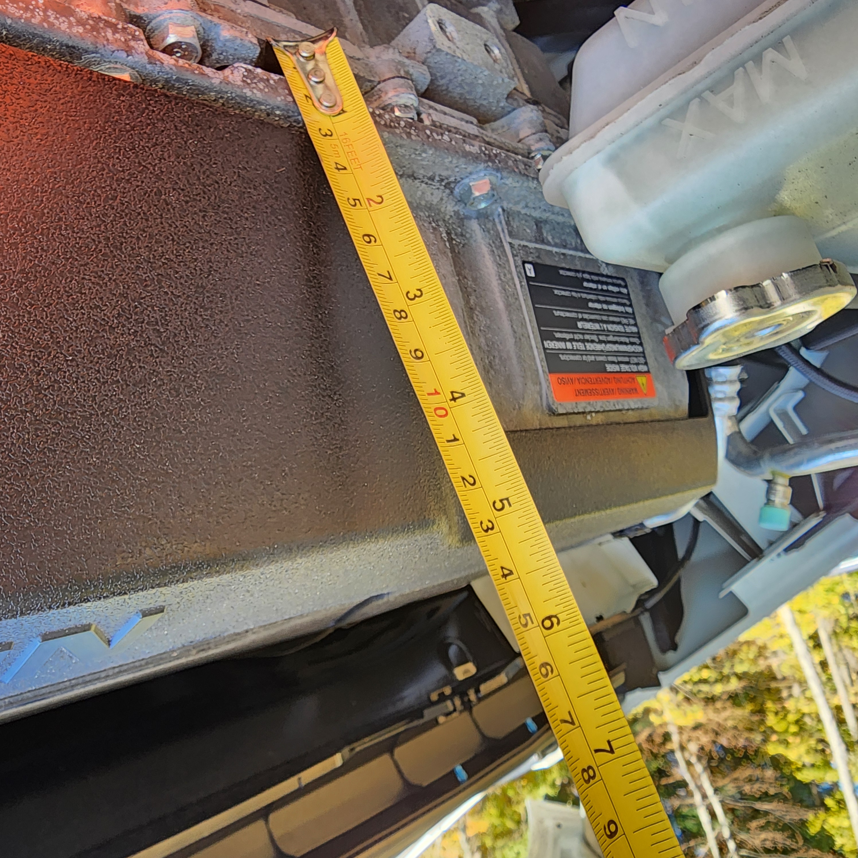

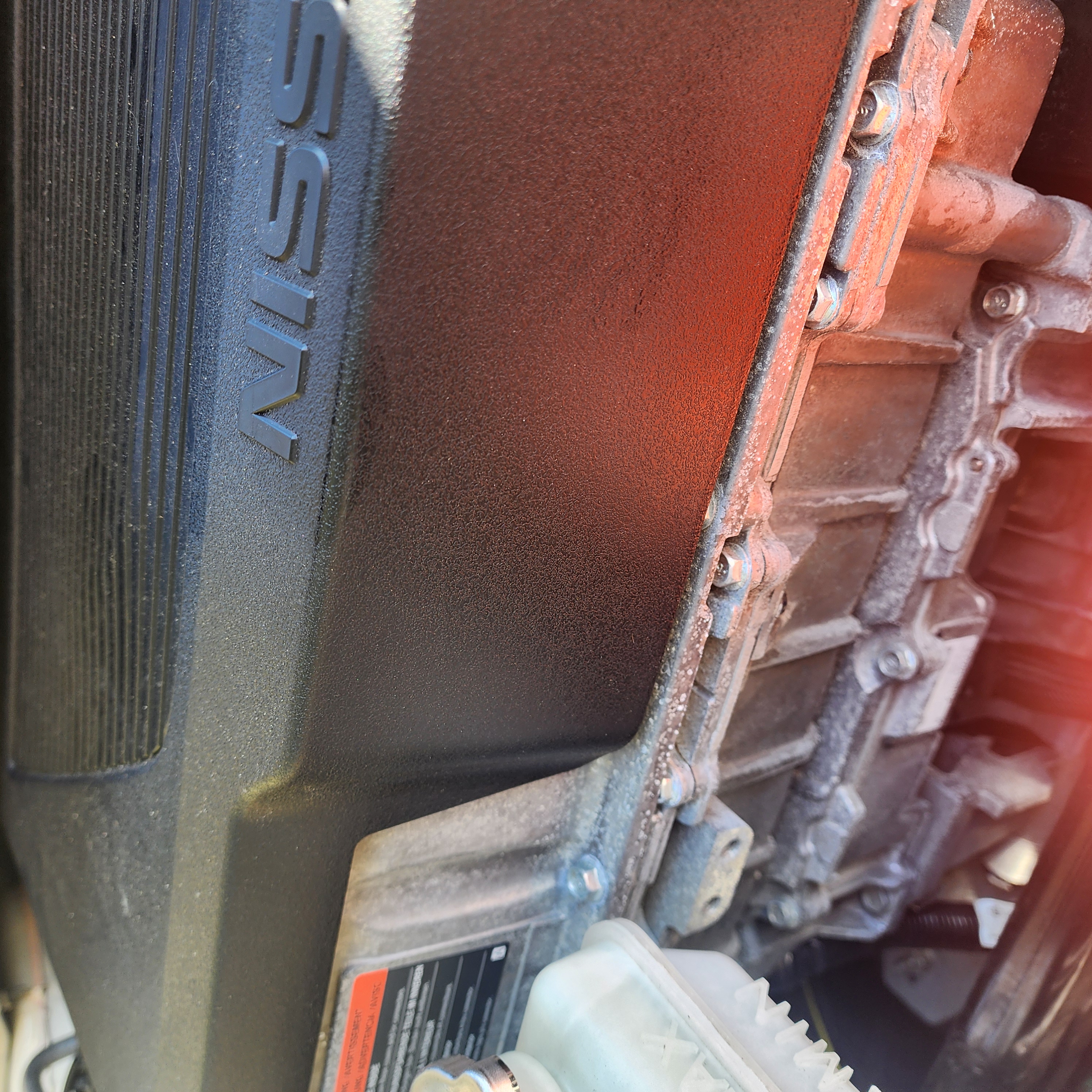

Re: Nissan leaf stack dimensions?
From another thread. Receiving this and dragging it here to try to keep it a bit cleaner.
Not sure why these flipped...
The top width is from the parking actuator? to the right side motor mount.
The tall 69cm / 27" height is to the belly pan.
My wife bought a 2019 160kw / 62kwh Leaf (gen 3 inverter.) it's staying stock.ianlighting wrote: ↑Sun Oct 20, 2024 5:34 pm Does anyone know the height of the later Leaf PDM? I know the lid looks a little different to the earlier domed ones. I am height constrained so may consider swapping the PDM, but I can’t find dimensions anywhere.

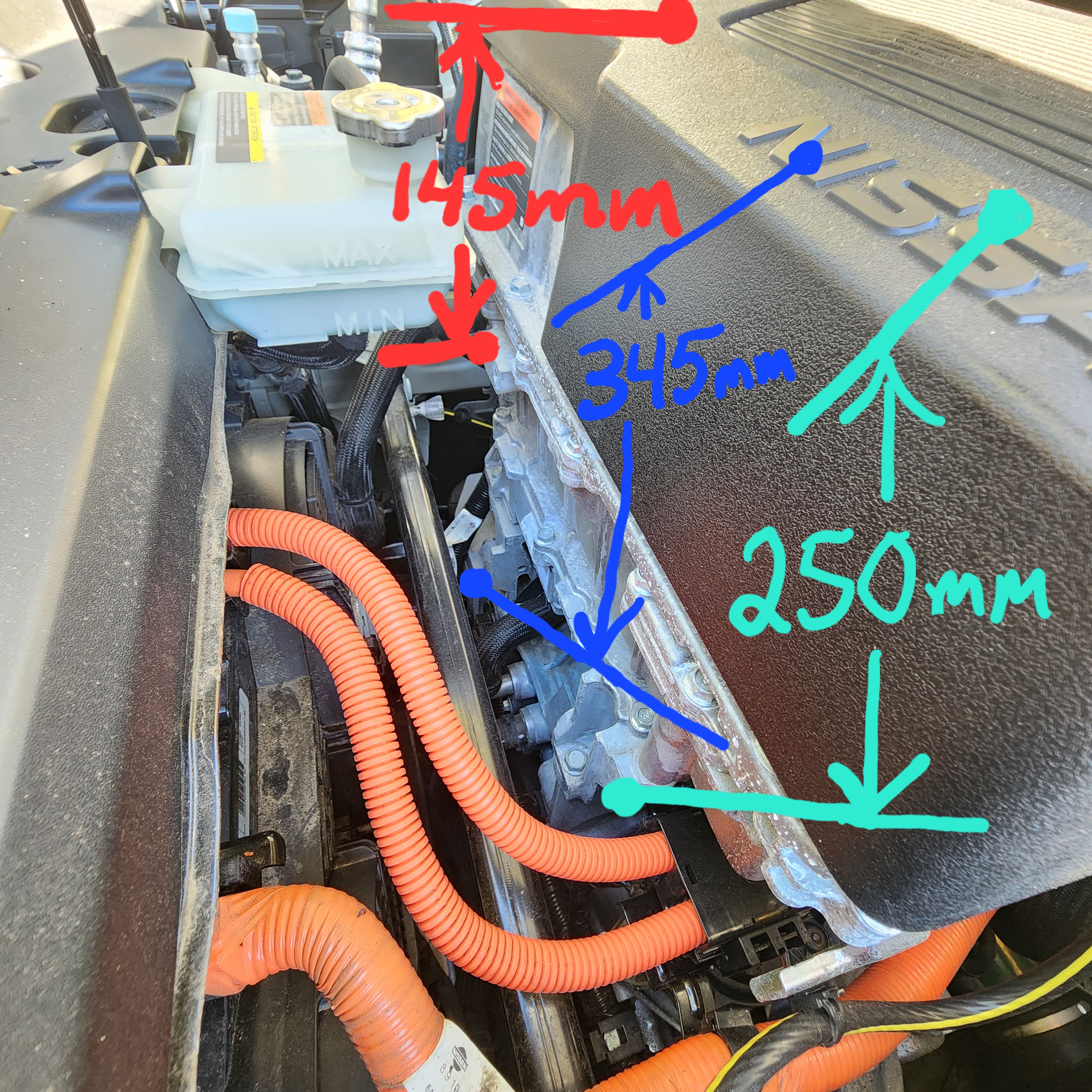

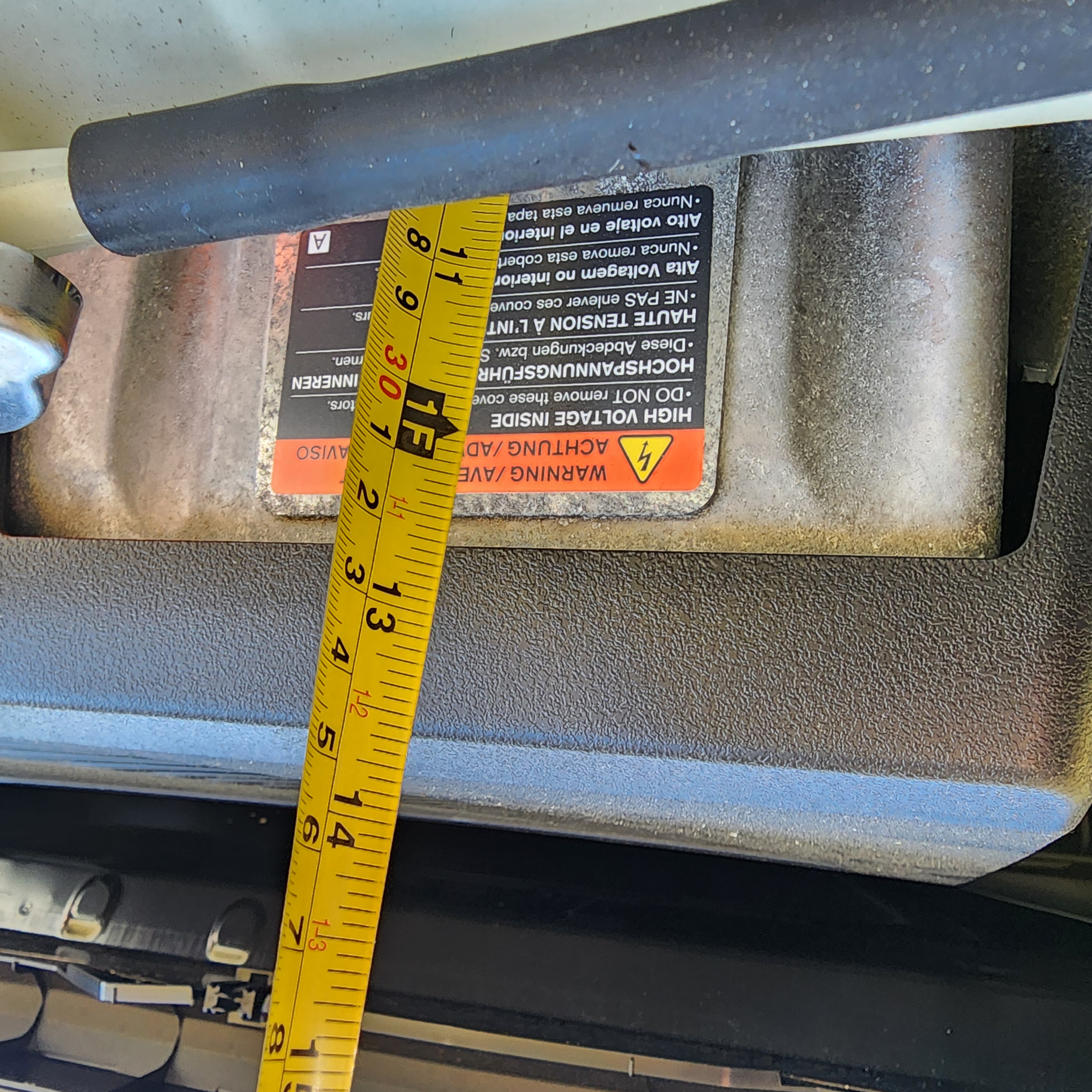

Thanks JRBE!
It’s not completely clear to me but appreciate you sharing. It looks to me like I might expect later gen PDM to be 245mm high. Although yours is in situ in the vehicle from what I can tell. So hard to be 100% sure where the measuring point is starting. But it’s a good start.
Thank you.
Yeah it's in the car, makes it tough to get a good picture. Measurements are from the dots of each layer (bosses to top cover.)
Without scribbles,

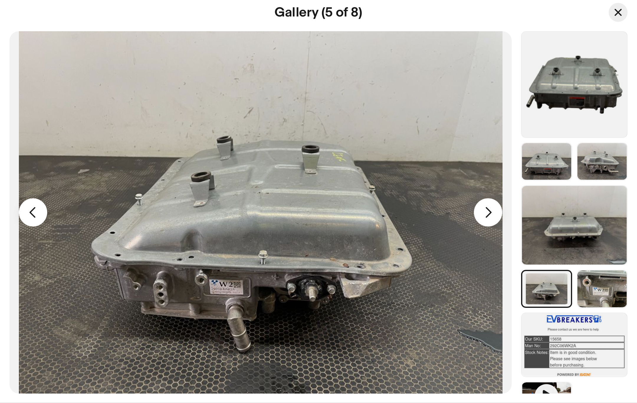

I just asked this question on my own project thread, but am repeating it here aswell. I have this photo from eBay of a Leaf PDM, but I dont recognise the shape.
But it has just occurred to me that perhaps this is what is hidden underneath the black plastic of the later PDM?
Please can someone confirm or deny? Looking at the various connections it seems to have what you’d expect on a Leaf PDM.
If anyone is familiar with this thing and can measure accurately the height that would be useful.
EBay link to EV Breakers. They actually have posted 3 of these.
https://www.ebay.co.uk/itm/256610955705 ... 0e1ce0966d
Yes this is what's underneath the black plastic but this is the latest what I call a gen4 unit. I have those for sale too, they come from 2023 and onwards Nissan Leafs and are made by Toyota. They are the smallest so far but I have tested them and found them not working with ZombieVCU. So the controlls are different. The inverter itself also did not work. I have posted CAN logs on the forum for somebody to take a look. Your best bet is to have a gen3 PDM for now.ianlighting wrote: ↑Fri Oct 25, 2024 1:49 pm But it has just occurred to me that perhaps this is what is hidden underneath the black plastic of the later PDM?
Gen3 PDM height (not the one in the photo) is ~21cm without the black plastic cover.ianlighting wrote: ↑Fri Oct 25, 2024 1:49 pm and can measure accurately the height that would be useful.
