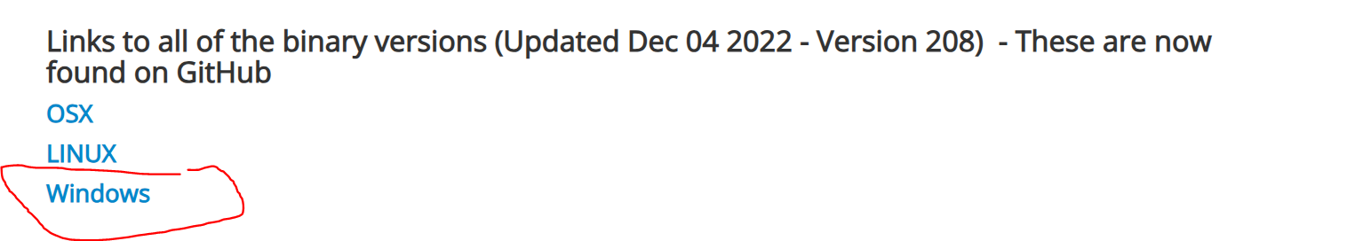

I have tried to post pictures but, I cannot. I have also tried to download SavvyCAN but, I have yet to find where to down load the program . All the sites I look at seem to be for computer experts that know their way around computer systems

Let me help you out.Falcemach1 wrote: ↑Wed Nov 06, 2024 5:35 am sites I look at seem to be for computer experts that know their way around computer systems
If you fall at this hurdle buckle up, the learning curve is STEEP
