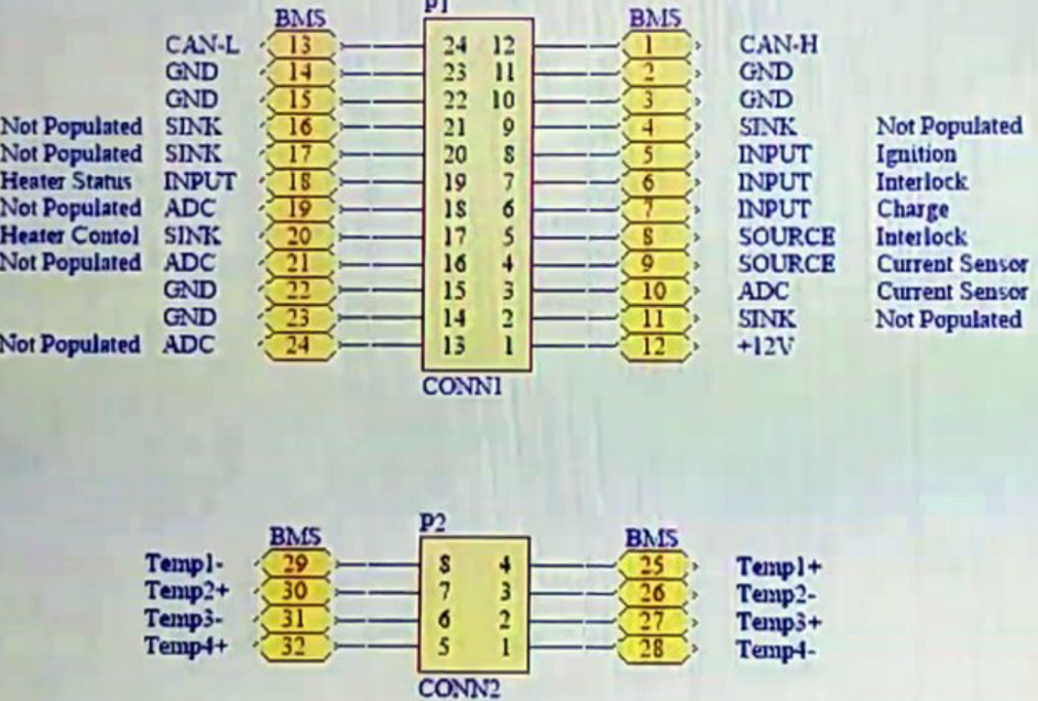

I have connected a gray Nissan Leaf BMS to the OBD scanner. The OBD connects to the phone but the leaf spy app fails to connect and displays this error ERR94
Have followed this pinout diagram
https://openinverter.org/wiki/File:Niss ... 1_LB12.png
Have not connected interlock pin 6 and pin 8, could this be the problem ? I am kidly requesting for your assistance

changing OBD fixed it for me
