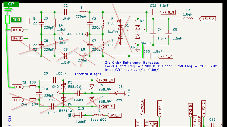

Indeed a good point. From the RF "academical" point of view, coupling an asymmetric line (CP is ground based) to a symmetrical line (QCA RX and TX have + and - which are symmetrical to their reference point) without a transformer is a baaaad design. But well, we want to charge cars, not win the RF design award. Anyway, from RF expert point of view, the PLC/CCS is a funny concept:
The symmetrical approach of the QCA is perfect for immunity and "clean" design. It avoids unwanted radiation, it is best for situation where every dB of signal-to-noise counts. It's a good RF design. And then comes the CCS. Unshielded lines and contacts, multiple volts on a single unshielded line against ground, perfect antenna, radiation pure, no immunity at all.
Thinking this to the end means: Yes, there is no need for a perfect coupler. Just using an L to ground to have high-pass filter should be fine. And then just connect one leg of the RX and one leg of the TX to a common unsymmetrical point.

Just checked mine, 1.7ohms. Convenient place to test seems to be the two resistors directly beside it!
Although, I suppose it's possible they could bridge any of the 4 corners during production, eh? Have you only seen it on those 2 pins?

Made some measurements to compare the original Foccci V5 (including transformer) and a transformerless patch of it.
As expected, the transmit power lowers a little bit, which can be partly compensated by decreasing R25 from 150 ohms to 100ohms. The receiver sensitivity does not show significant difference.
The only concern is, that the transformer was also a "first line of defense" against low frequency high power disturbances. The remaining protection with the diodes is good, but is only the second line of defence. Maybe we should add additional diodes at the front end.

That's promising!
A (bidirectional?) TVS would be an easy addition.

This makes sense. But the currently used TVS SMAJ18A has a capacitance of some hundred pF, which would kill a lot of RF. How to find a TVS with lower capacitance, I think below 50pF would good, because 50pF have already ~100ohms at 30MHz. If available, I would prefer the 10 to 20pF range.
Been thanked: 1913 times
Re: Develop a QCA7000 board?
Just digikeyed a bit and these exist and are called dataline TVS. Example ESD150B1W0201E6327XTSA1 0,15pF @ 10GHz
JLC has 10 of them so the challenge is to find one that they have plenty
EDIT: here is one https://jlcpcb.com/partdetail/DiodesInc ... 7B/C500765
It is only 5A but I reckon behind the 100 Ohm resistor that will suffice?

I just went through this hunt in a design I'm doing. Capacitance isn't always listed in datasheets and isn't listed in parametric searches that I know of. Makes it a tough find.
I used www.claude.ai to find options. Tell Claude you're searching for ultra low capacitance tvs, with specs you're looking for. And that you're sourcing them from lcsc and it will add their part number references to the options it finds.
Claude can't give you web links and can't see inventory so it's still a bit of a hunt. It was last updated a few months ago. There are other options too for ai
I filtered for "Capacitance @ Frequency" https://www.digikey.com/en/products/fil ... 0jBxUS0sgA
this brought up the dataline types. The data sheet then lists 10 pF. So doesn't resemble the parametric search but still fit for our PLC application.
But yes, AI is probably quicker, thanks for pointing it out

The 10pF is impressive, and the 5A should be fine with the serial 100ohms and 1nF.
Quite small housing, no chance of hand-soldering ;-)
