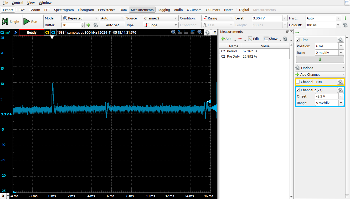

I'm currently working on the Zoe inverter, more specifically on the rotor exciter controller. While testing I noticed a strange, periodic sound from my little test inductor. Scoping the PWM showed it dropping out every second
To cut it short it turned out to be caused by the SDO bursts from the wifi module. The CAN transceiver pulls so much power from the 3.3V rail that the ADC reference voltage dips and thus all ADC readings are off:
Regular periodic CAN messages have the same effect, just not as pronounced:
I also checked the 5V rail but it is not or hardly at all affected.
I think the problem never showed because nobody used oic or ESP for periodic data polls. Also the other channels use more of the ADC dynamic range. The 50 mV/A from the exciter current feedback completely vanish in the noise floor and the P controller diligently tries to counter the seemingly excessive current by shutting down the PWM.

Added 110 uF of decoupling, still 30 mV
It could be the 3.3V LDO is just too weak

Ok, decoupling doesn't really help. What yields much better results is installing a separate LDO for the CAN transceiver:

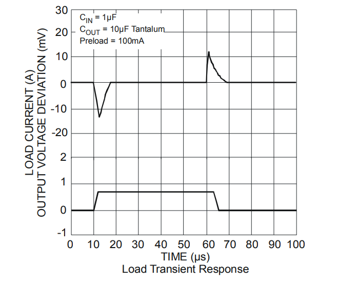

It is not the current handling abillitie of the regulator but the load transient response.
Had a look at the XC6206 datasheet cant realy beleave what it shows but.
For a load increase from 1mA to 40mA the voltage sags 0,5V
The 1117 on the other hand specs the drop in mV
With a load jump from 100mA to 800mA voltage sags 13mV

Oh wow, that's a huge difference. So will go back to the 1117 then.
Fortunately on the mini mainboard there is no wifi module. Actually that was the reason to go for the smaller regulator. Never knew there could be such differences in transient response. Something new learnedrstevens81 wrote: ↑Tue Nov 05, 2024 8:15 pm this problem would also probably made worse by the esp8266? although its obsoleted by the lillgo tcan now.
