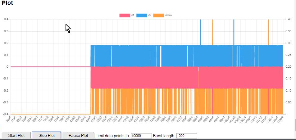

johu wrote: Fri Mar 06, 2020 9:53 am Can you try setting iacmax to 1000A? Maybe there is some integer overflow involved.
Tried that no change.
Have hooked up a current meter with max/min, and there is no current spike at ignition switch on.
Also did a plot:
BTW: is the ilmax max current for hole trip, until reset?
Been thanked: 1913 times
Re: Update from 4.12 to 4.76R, give HICUROFS1
ilmax is calculated on each PWM interrupt, MAX(ABS(il1), ABS(il2), ABS(il3))
Strange... is power still reduced?
