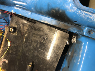

Yesterday was a bit of a bad day. I was excited to finally get the motor spinning with HV after a successful run on 40v-(this was a while back). I tested the voltage at the motor contacts and the correct on/start sequence all seemed good to go. plugged it in and switching the IGN on was fine, but then when I hit the start button it was like I was firing off a bomb. I started testing stuff after I successfully put the fire out. The main contactor seems to be welded together, and I have continuity also at the inverter/motor connections. There aren't any errors when I hook it up, but I'm pretty sure this is back to the drawing board. I can't get the minus connection off the motor yet-it seems to be welded too.

Re: Continuity at the Inverter
What settings did you have in it?!?
did you change your UDCsw to the battery voltage one?
Post you parameters.
Failing to precharge would cause your issue or reverse connected voltage
Which kind of fuses have been in the circuit? Did they trip?
No the fuses didn’t trip. EV west 600a (website is down so can’t get a link). I’ll post parameters when I get home.
Here you go buddy. No precharge, big inrush Blow up the capacitors and weld the contactors."udcsw": 0
You probally superheated some bits under your plate.
600A fuse, why the heck did you pick that size?!? Even for a tesla LDU a 600A fuse is huge.
Cables would have to be like 120mm2 to handle 600A for anything near what the fuse is rated to.
UDCsw is precharge end voltage. At this voltage the contactor closes, by having it zero (which you do when you manually precharge for testing) it closes right away no precharge. This is covered many many times in posts and videos.
SDU is rated to 600a peak for 10 sec or so. The fuse is rated for continuous of this, it is rated for 1000s of amps for 10s, you cables and other components are not. This is why you had a fire.
Would be interesting to see, which components show which kind of damage, to understand what was happening. Cannot imagine that the IGBTs go short just by a "microseconds-super-fast-precharge-event". Reverse polarity is excluded?
That's right, super fast precharge primarily welds contactors and might damage capacitors, not IGBTs. I've suscepted my Leaf inverter to multiple such events and it still runs fine. I suspect reverse polarity.
This does feel like the polarity was reversed at the inverter, or maybe you . Are you able to trace things through and determine if that's the case? If the current stopped, then presumably something in the circuit opened. If it wasn't the contactor, and it wasn't the fuse, then I can only assume the IGBTs are exploded. The purpose of UDCsw is to prevent the main contactor from closing before the precharge has finished successfully, and would have saved you here, but too late for anything but learning on that front.
Another possibility is that you accidentally crimped the shield of the high voltage cables. The shield of both cables in the SDU is connected to the chassis ground, so if you crimp them into the HV, things will explode, but I guess you'd have noticed this during the low voltage test.
Another possibility is that you just got extremely unlucky and got a bad SDU with multiple failed short-circuit IGBTs (they only go short circuit when high voltage is applied for the first time, I don't know why). I've never heard of this causing a catastropic failure but it's technically possible.
(feeling defeated). I don't know how polarity could be reversed. I checked, double checked. If it is that one wrong setting that sucks.
The negative at the inverter is welded. also, the negative at the battery is too.
It's not a setting, it's how you hook it up or crimp it
If you have continuity between phase outputs of the inverter (while the motor is disconnected) there are shortcuts in the IGBTs. It will not spin.
This would be an issue. Maybe one of the many mistakes made.phillipschip wrote: ↑Wed Nov 20, 2024 5:58 am Ok so the udcsw set to zero wasn’t necessarily the issue?
Do you have pictures of what burned? And pictures of your HV contactor setup before?
No it is the finishing point of Precharge, it is the followingphillipschip wrote: ↑Wed Nov 20, 2024 9:03 pm udcsw was that it was the minimum voltage the main contactor would be allowed to close “after precharge”.
If UDC > UDCsw close main contactor
So your UDCsw of 0 meant it immediately closed the main contactor, this is also why you have to change this to allow manual precharging for testing.
