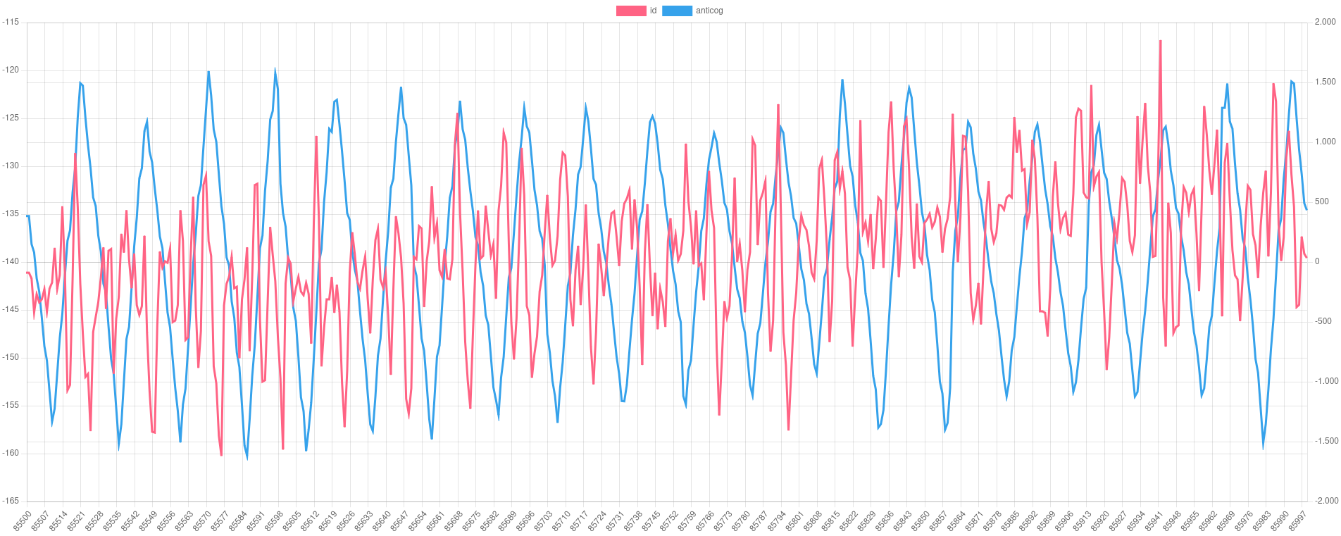

I want to split this topic off the simulator thread.
So in steady state there is a very strong oscillation of id which likely causes torque ripple and thereby audible noise.
I am running a Nissan Leaf EM57 motor with its accompanying inverter.
My spouse meanwhile protests against longer trips because of the noise which is audible at different frequencies across all gears (I run a 6-speed gearbox). This means: the problem must be solved!
The oscillation runs at 2x the electrical motor speed:
It happens on positive and negative torque and at any speed. I've taken the measurements by engaging cruise control and driving uphill or downhill.

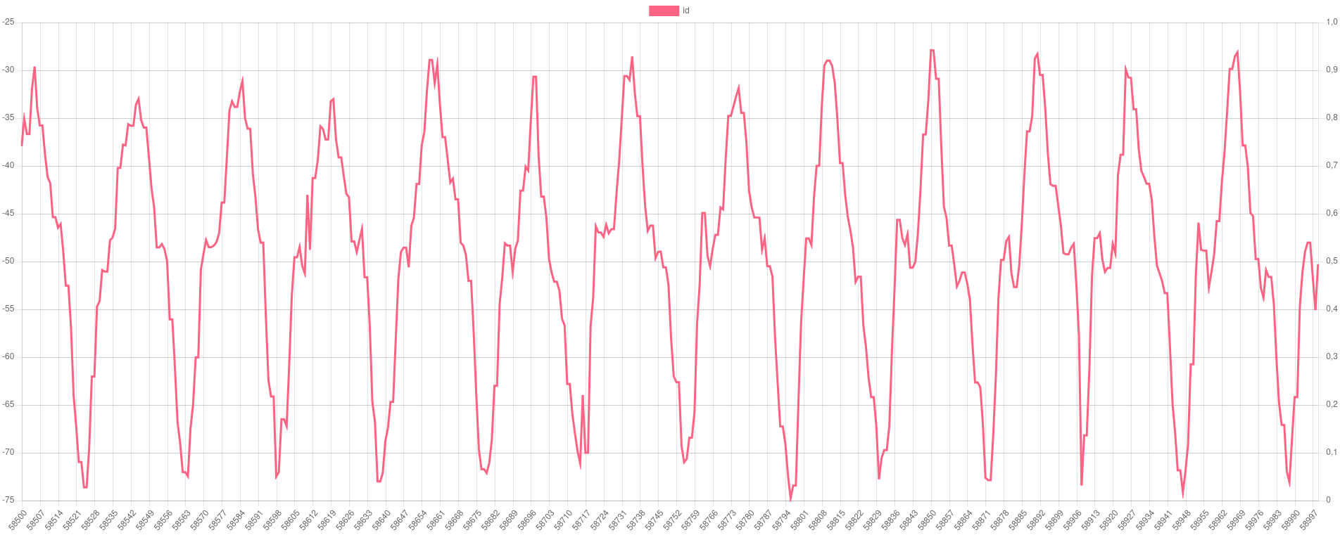

2000 rpm regen:
4000 rpm regen:

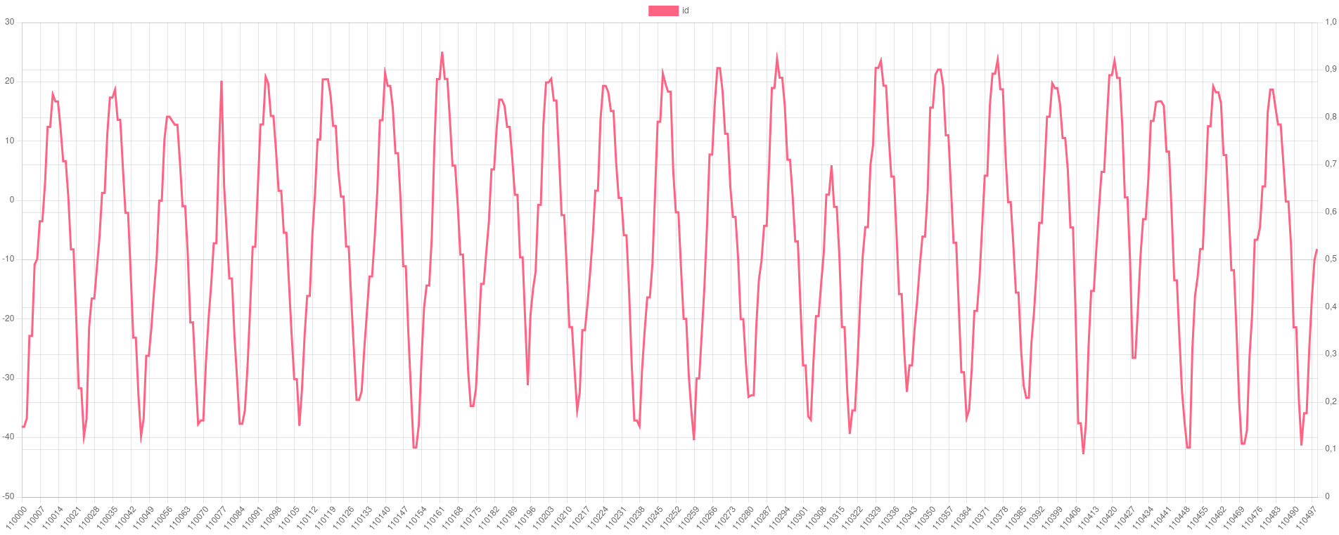

2000 rpm uphill
4000 rpm uphill
The 4000 rpm plots even show a zero crossing. I remember at higher load this goes away

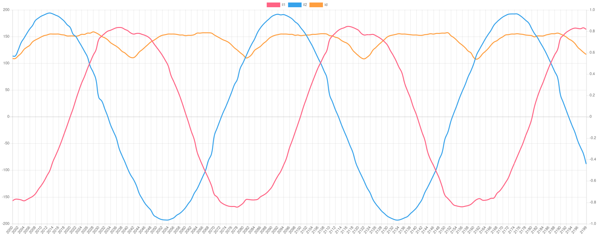

Here I plotted against il1
And here we see the P-controller tries very hard to counteract, using 15% voltage swings
I also plotted with fwcurmax=0 and syncadv=0 but that didn't change anything.
I'd like to implement some feed-forward compensation for this but the magnitude is really quite scary. If you have any ideas what else to plot or would even like to plot yourself, please chime in. I'm using 500/500 plot settings

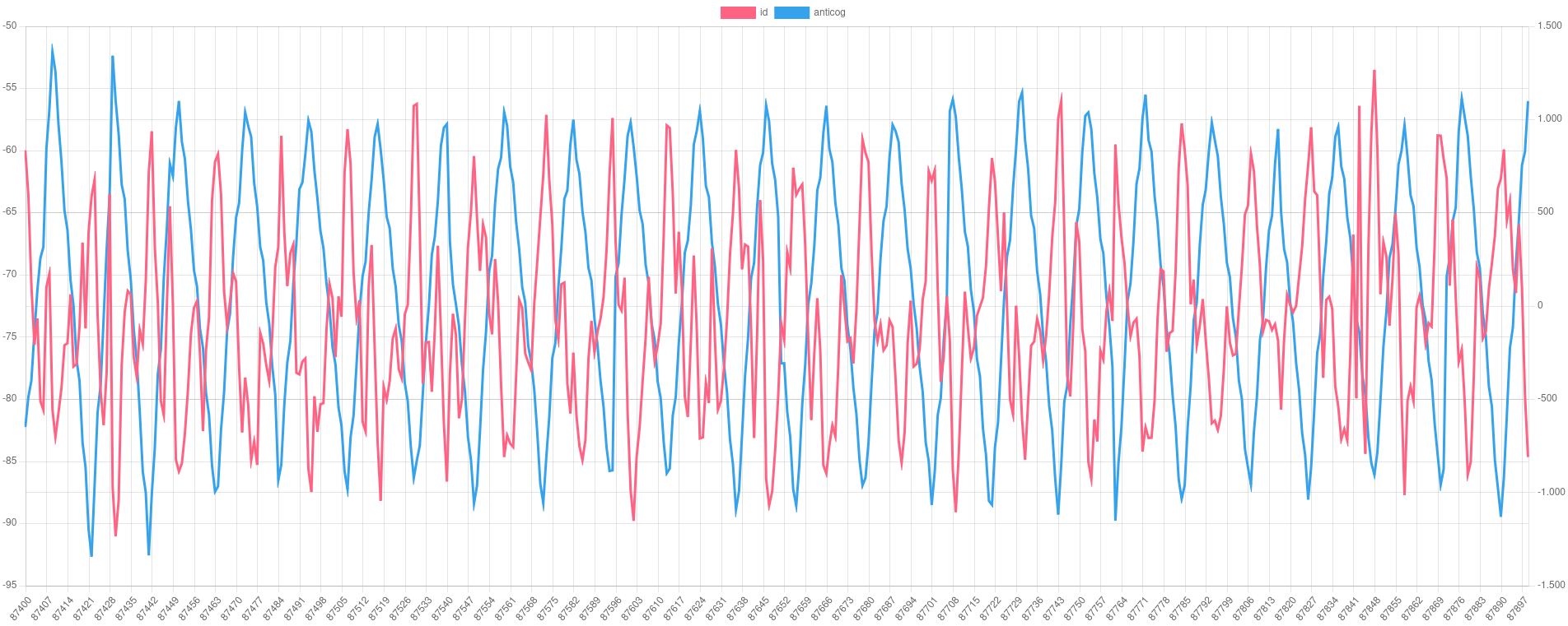

So plot at 500/500, ID, IL1 and angle? I can try to get a plot from mine this weekend.
Been thanked: 1914 times
Re: Chasing down id oscillation
It's a tradeoff. Sample rate drops the more items you plot. Just id is ok or id and il1

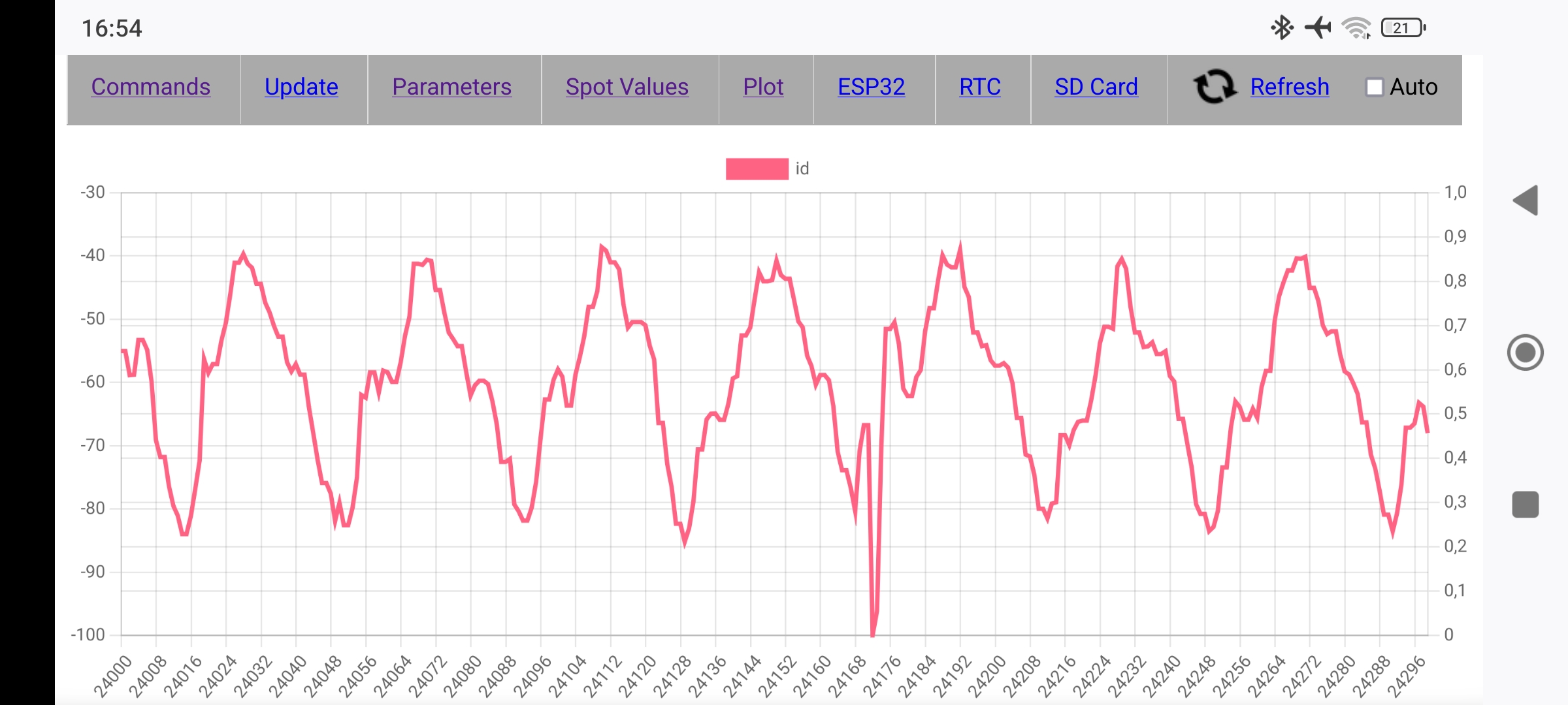

Okay, here's what I got. No cruise control so I was just trying to maintain a steady input to hold speed. Roughly 4700 rpm. This should be id on the left and il1 on the right. I see now that I probably should have plotted both of them on the left, sorry about that. I might be able to take a quick trip out again tomorrow with my laptop and try again if it would help.
I take it that blue is id and red is il1? (Include the labels in your screenshot)
So same situation like mine, unsurprisingly. Are you running the EM57 as well?

Yeah, EM57 and blue is id. The legend got covered when I zoomed in for the screenshot, sorry. I'll be able to bring my laptop next time.
Cogging torque would make sense given what I've read, though I'll also note that I don't hear much of an audible whine while driving. Nothing that seems out of the ordinary, at least, and I've got the motor rigidly bolted directly to the frame of the car.

I did a first cut of the firmware: https://github.com/jsphuebner/stm32-sin ... nticogging
I'm not yet happy with the result:
You can see it creates a good correction value but the oscillation is still there. Not sure if the code is correct or if it's just a matter of tuning.
If you want to test please compile yourself. There are two new parameters
- cogkp - the gain between cogging current and correction value
- cogph - the phase between cogging current and electrical rotor angle
The way I tuned it was setting cogkp=5 and then adjusting cogph until anticog is opposite of the cogging current as shown above. To arrive at that I had my test driver (thanks Markus) drive 30 kph on CC while I was plotting id and anticog in a 500/500 plot. I arrived at roughly 12000 dig (65°C) for my EM57

uhi22 wrote: Tue Oct 01, 2024 10:32 am Is this noise issue just new or was it ever present or did it become worse over the time?
It has always been there. The first time I saw it was on the trip to London. Janosch was driving and I was plotting random quantities. The ultimate test is whether the noise that my wife complains about is now diminished
uhi22 wrote: Tue Oct 01, 2024 10:32 am The id is a calculated value, based on two measured phase currents, right?
Yes. But so is iq and that shows less ripple. I think the little ripple it does show could be carried over from the d-axis because it changes the flux strength.
If I feed a perfect speed signal and sinusoidal currents with my signal generator the ripple is not present. Of course these currents are no longer the result of the PWM. When I do an AM modulation with a triangle signal I can trigger the ripple on the desk as well.
So like said, the issue is known so I think it is actually a physical phenomenon in the motor. Also Ziegs plot is identical.
I tested with the compensation enabled and you can see the ripple is now less pronounced:
It was 45A before and is now 25
With some more tuning I arrived at this
Before tuning:
So it's not perfect yet but going in the right direction I think. Wife test drive coming up
EDIT: cogkp=90, cogph=14000, cogmax=3000

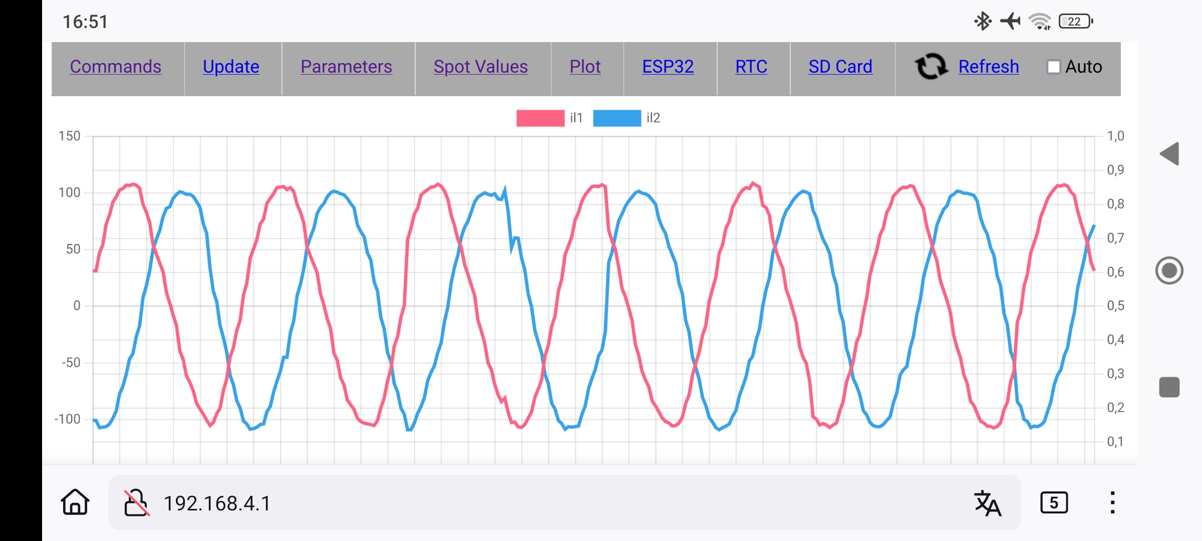

So I'm doing some experiments on this.
Here we have the amplitude of il2 about 20% lower than il1.
This also creates a 2nd order harmonic but it is sinusoidal. Same result when il1 has lower amplitude than il2.
Here we have a periodic disturbance on just il1:
This causes dips in id but no rises. In between the disturbance id stays calm.
Now we put that same disturbance on il2:
Still no symmetric triangle pattern
It's only when we change the phase of the disturbance such that il1 becomes greater il2 (or vice versa) that we see the triangle pattern

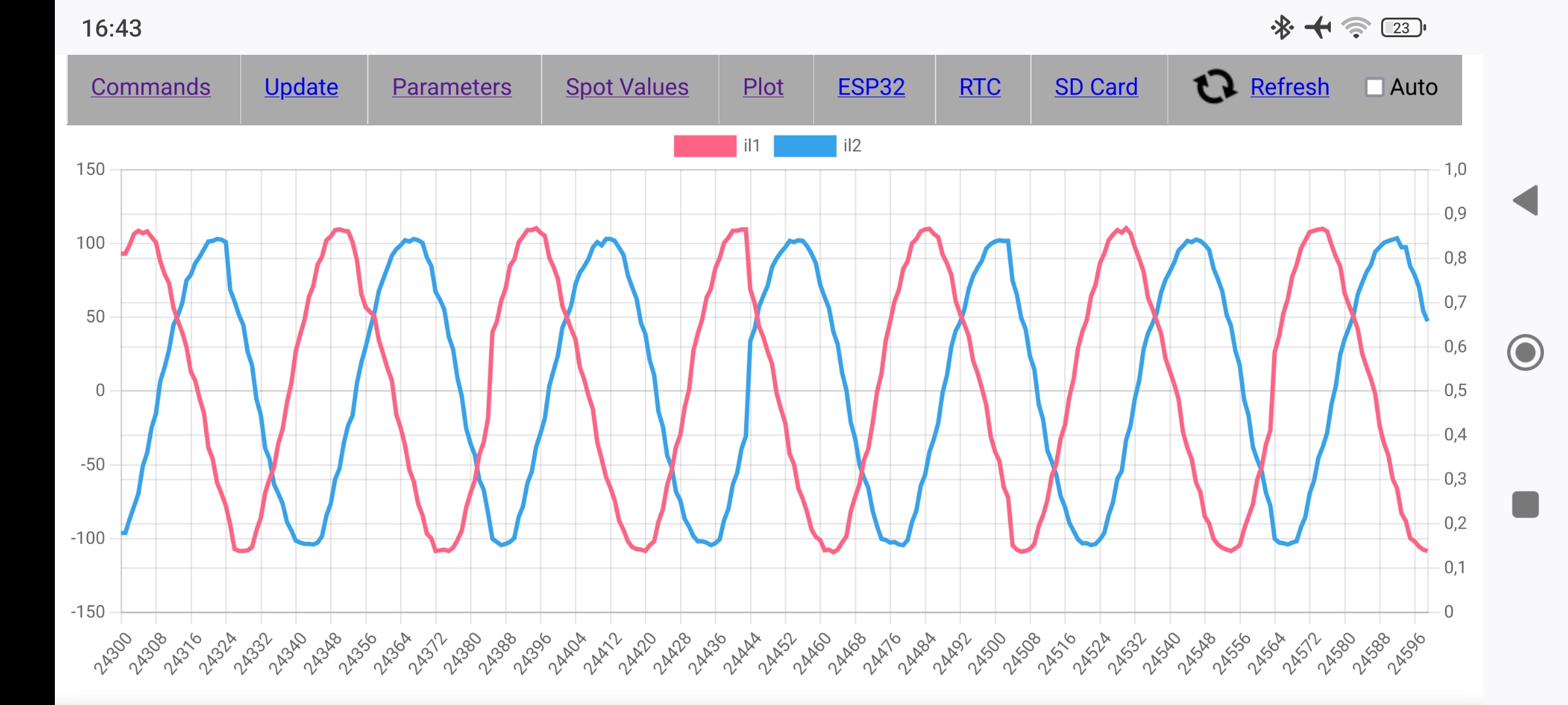

Ok. Lets plot with the actual motor. First we disable anti cogging
Indeed il2<il1
Now with anti cogging
Oh wow, that makes il2>il1 and changes the shape of both slightly away from sinusoidal
Ok, lets turn off anti cogging and instead change the gain of il2 so that it has the same magnitude as il1
OK, that kind of worked but it looks like the 0-point of the two is skewed (keep in mind we do an offset calibration at standstill, so its not that)
Now hows the id oscillation?
Like 45A peak-to-peak.
Let turn anti-cogging back on
Ok, diminished to 25A peak-to peak and the triangle shape is disturbed.
In the paper I linked above the anti-cogging signal saturates, so has a flat top. cogmax gives me a parameter to achieve that. Worth a try as well.
Anyway, what do we conclude now?

On your last image, it looks like it might be resonating with something. Starts with a high and low peak, then lessens the peaks in the middle, then starts increasing amplitude up again. Or I might be reading into it. Does a pattern show up with a longer log?
I don't know, I'm thinking it's because the anti-pattern doesn't fit perfectly so there is still some of the original oscillation left. Or do you mean there is a hull curve around the HF pattern?
