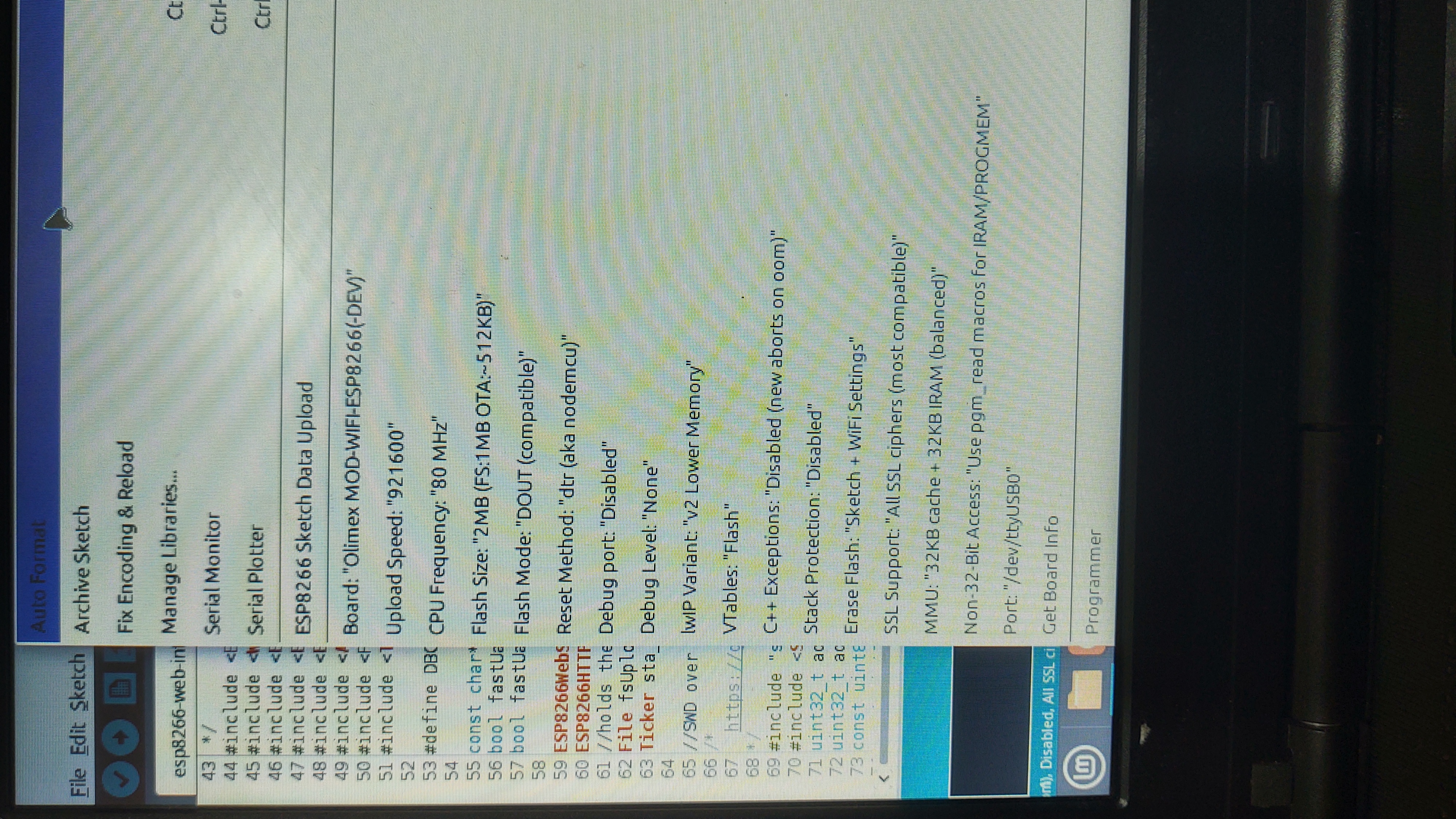

For anybody else out there struggling to setup an Olimex ESP8266 I finally managed to get somewhere today.
It turns out this is a two stage process. First upload the sketch to your ESP8266, then upload the sketch data.
After an embarrassing number of hours I have the default gauges displaying in my car with a new Olimex ESP8266 and have documented it here partly as a reminder to me as well as a help for anyone struggling like I was.
As you might suspect everything you need is in the Wiki but it's a little hard to follow and my requirements were very specific, so while the default instructions worked they didn't give me what I needed. Anyway hopefully this might help.
Some of this is copied and pasted from Johannes page linked below.
I am using a FTDI board to connect to the Olimex RevB, you can see how it is connected here.
I have a couple of versions of FTDI board and they both worked but double check you have set them to 3.3V. While trying to figure this out I had them set to 5V a couple of times and didn't appear to kill the Olimex boards but they did get a little hot. Also the PDF I used to check the Olimex pin positions showed a picture of the socket not the plug so at one stage I had the connections mirrored and everything got a little hot!!!
Steps to follow
1. Go to the Wiki here https://openinverter.org/wiki/Olimex_MOD-WIFI-ESP8266
2. Inside Arduino IDE open the Preferences window - enter 'https://arduino.esp8266.com/stable/pack ... index.json' into the Additional Board Manager URLs. Note I was using Arduino IDE 1.8.19
3. Reboot the Arduino IDE and open Boards Manager from Tools > Board menu and install esp8266 platform.
4. Select your version of ESP8266 from 'Tools - Boards - ESP8266 - Olimex-MOD-WIFI-ESP8266' and the correct port.
5. Download https://github.com/esp8266/arduino-esp8 ... n/releases python support files - extract file to Arduino IDE tools folder like you see here https://randomnerdtutorials.com/install ... duino-ide/ - restart Arduino for changes to come into effect
You will probably need to create the tools folder as I didn't have one. For me the path was <home_dir>/Arduino/tools/ESP8266FS/tool/esp8266fs.jar
6. Download Johannes default Arduino code from https://github.com/jsphuebner/esp8266-web-interface and extract to the Arduino folder. You might need to rename the folder by removing "-master". (In my case I skipped this as I was using Damiens code for a Nissen Leaf VCU)
7. Open the code in the Ardunio IDE by double clicking the 'esp8266-web-interface.ino' file.
The following edit may be needed:- at about line 14 of the code (not the comments) there’s a line that should read "bool fastuartavailable = false;" if the value is set to true change it to false
8. Add the following libraries, ESPAsyncWEBServer and ESPAsyncTCP (a quick Google search should find them or use Johannes link https://github.com/damienmaguire/Lexus- ... /Libraries
9. Ensure you have set the FTDI board to 3.3V
10. Connect it as shown above then select Olimex MOD-WIFI-ESP8266(DEV) from the Tools/Boards menu and select the correct port.
11. Ensure the settings are as shown below - the Flash memory seems to be most important.
12. Use the Upload option to install the firmware in the Olimex and wait for the board to reset.
Note with the RevB board you need to hold the button down as you power it up to put it into programming mode.
if you used a new board you have to select "erase flash: sketch + wifi settings" from the Tools menu so the board will erase its password
13. Repower it with the button held down and select Tools - "ESP8266 sketch data upload" and wait for the board to reset.
14. Reboot the Olimex and connect to the wifi as usual. Open a browser and enter 192.168.4.1. This will give you Johannes ESP8266 WiFi page when you connect to the Olimex WIFI.
Note for this step I used the Nissan Leaf WiFi.ino from Damiens Github to give me the gauges when I used the IP above. A file seems to be missing from the leaf_wifi\data folder in Damiens Github which I found in his Lexus-GS450H guthub. It is solid-gauge.js. Please correct me if I'm wrong about this.
I Used a laptop with a fresh install of Linux Mint and installed Arduino from the Mint App installer which seems to default to Arduino 1.8.19. I can't comment on any other version.
Reasons it might fail.
It looks like you need an older IDE like Arduino 1.8.19. I tried using the current version and didn't get the option to "ESP8266 Sketch Data Upload" under 'Tools'. Linux Mint installs version 1.8.19 if you use the Software Manager and this works fine.
You need to set the Flash memory correctly for your ESP8266 under Tools.
You need to reboot the ESP8266 with the button held down each time you want to upload or do a Sketch data upload as it will reset itself to normal mode after every update.
In my case I was downloading files from Damiens Github and some of the folders needed renamed, like the data folder that holds the html stuff needs to be named in lower case, the Leaf wifi data folder was called Data so the Arduino IDE didn't see any files. This may not be an issue in Windows. Also a file was missing which I found in the Lexus GS450 github. The VCU I have was only sold for a short time before Damien designed the Zombieverter so is not widely used.
