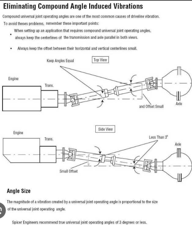

Re: Project RX-8 w/ GS450h Drivetrain
Ok so UJs are not a constant velocity joint and if the gearbox flange and diff flange aren’t square to each other, so that the angle of each uj cancels the other out you can create a vibration, also can’t see your entire prop shaft there but is it correctly phased? the yokes at each end of the prop should align, being 90degrees out causes issues
I think if I were doing this swap I’d build a solid aluminium doughnut and include a slip joint between UJs something like
An odd number of u joints isn't a great idea as they are not constant velocity when angled.
Worth a watch before you decide,
I understand the issue but there are a few mitigating circumstances, the main one being that the u-joint will almost never be at a different angle from its set angle as the diff angle doesn't change (much) in relation to the transmission owing to the PPF holding it in place.
Plus there will only be 2 u-joints in the setup. One in the middle section of the prop and the other at the diff end.
The illustration show in the video above assumes the diff angle will change drastically in relation to the transmission which in an rx-8 doesn't happen.

Kelju
- Posts: 171
- Has thanked: 13 times
- Been thanked: 18 times
Probably your issues are originating from these (which have already been pointed out):
1. Improper fixing of the diff (this however is propably not the source of vibration)
2. Universal joint fixed onto a rubber bushing (U-joints should always be used in pairs and the alignment of the input and output angle is critical. Some misalingment along with one of the U-joints connected to the rubber bushing might cause the vibration)
3. When swapping in the GS450h tranny, did the length of the shaft prohaps increase? You should check the critical speed of your shaft with your dimensions:
https://spicerparts.com/calculators/cri ... calculator
I would higly recommend using CV-joints in conversion projects. As the name implies, the joint provides the output speed according to the input speed, regardless of the angle. This has the benefit that perfect angular alignment is not needed. Also, you should try to keep the input and output angle as close as possibly to each other but still have the input and output shaft on adjacent planes to have some angle in the joints. This way the bearings of the joint will wear more evenly.
