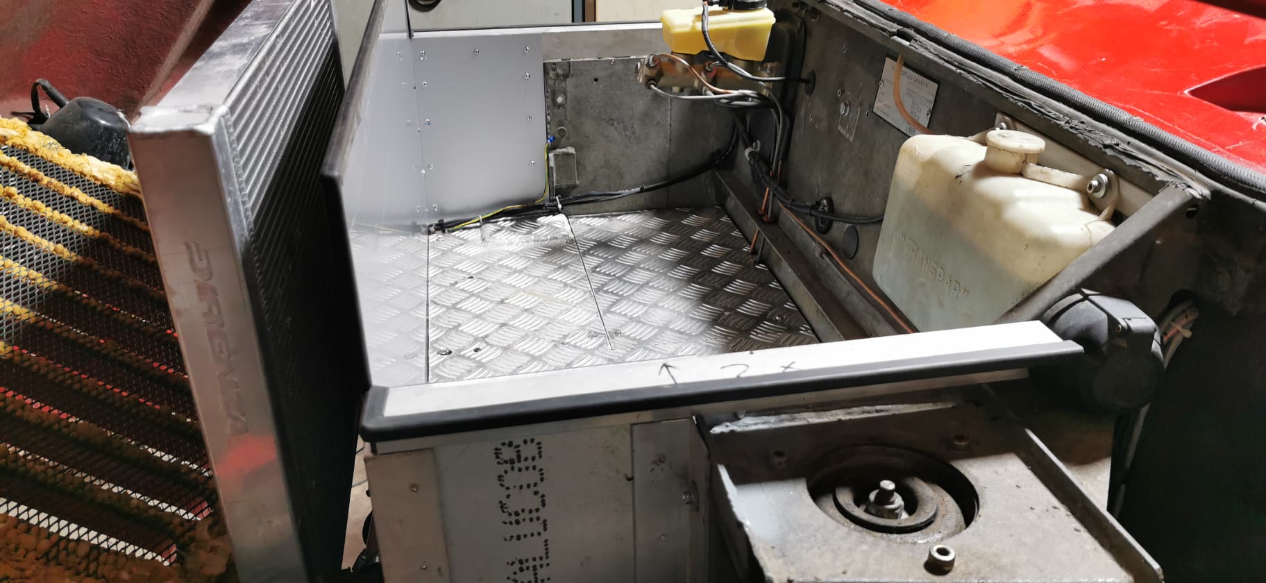

this is the parts i used
over size radiator for summer temps passive no fan, 3 way bypast and heated in winter.
temp controlled using a PLC

I would recommend you use Fiat 500 Siecento radiator. It is much smaller in height and size and is plentiful for summer.
I recognized the greatest source of heat is actually charger when car is stationary. This is the only reason to keep a cooling fan.
