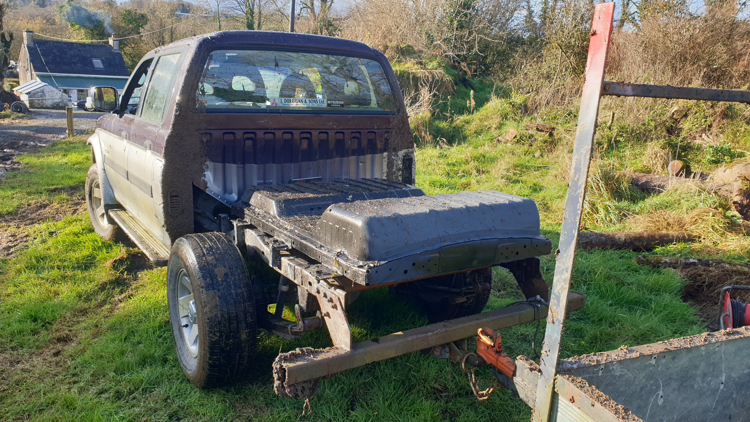

Getting some good work done hauling trailers of logs so I splurged on a new pair of rear all terrain tyres. Also working out some rear lights.

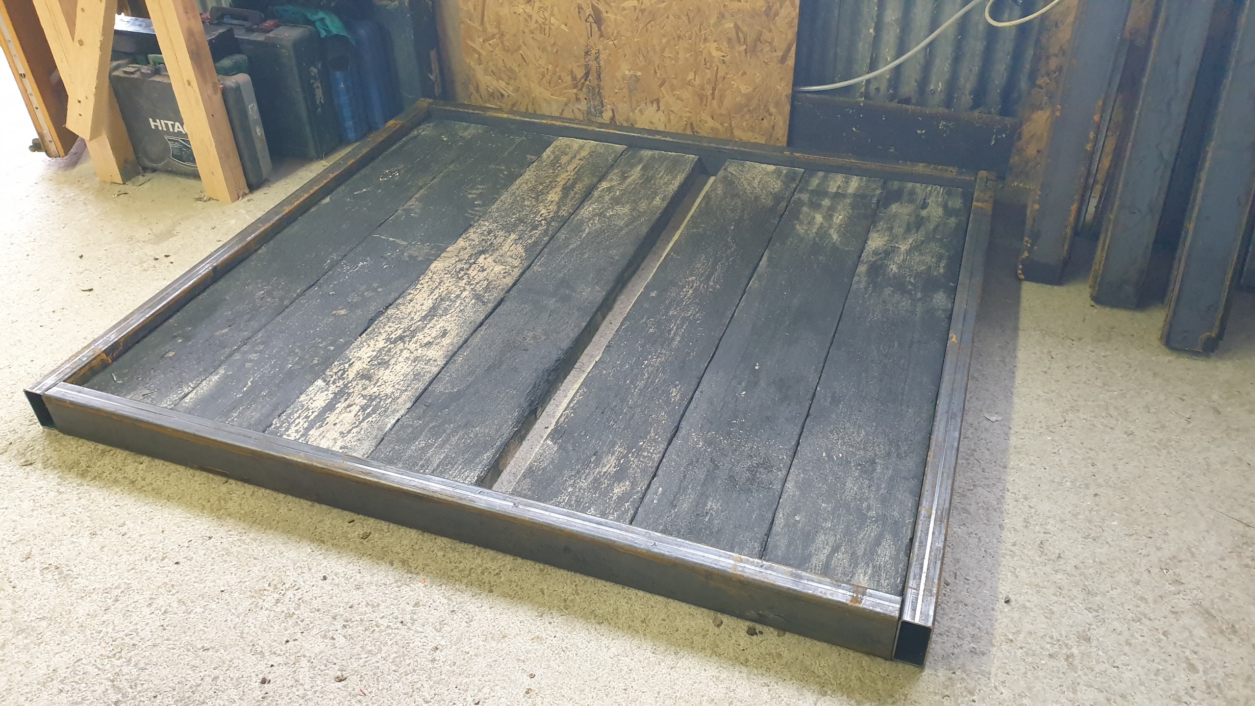

New flatbed bed under construction using a frame of 100x50x3 steel and end of life scaffold planks.

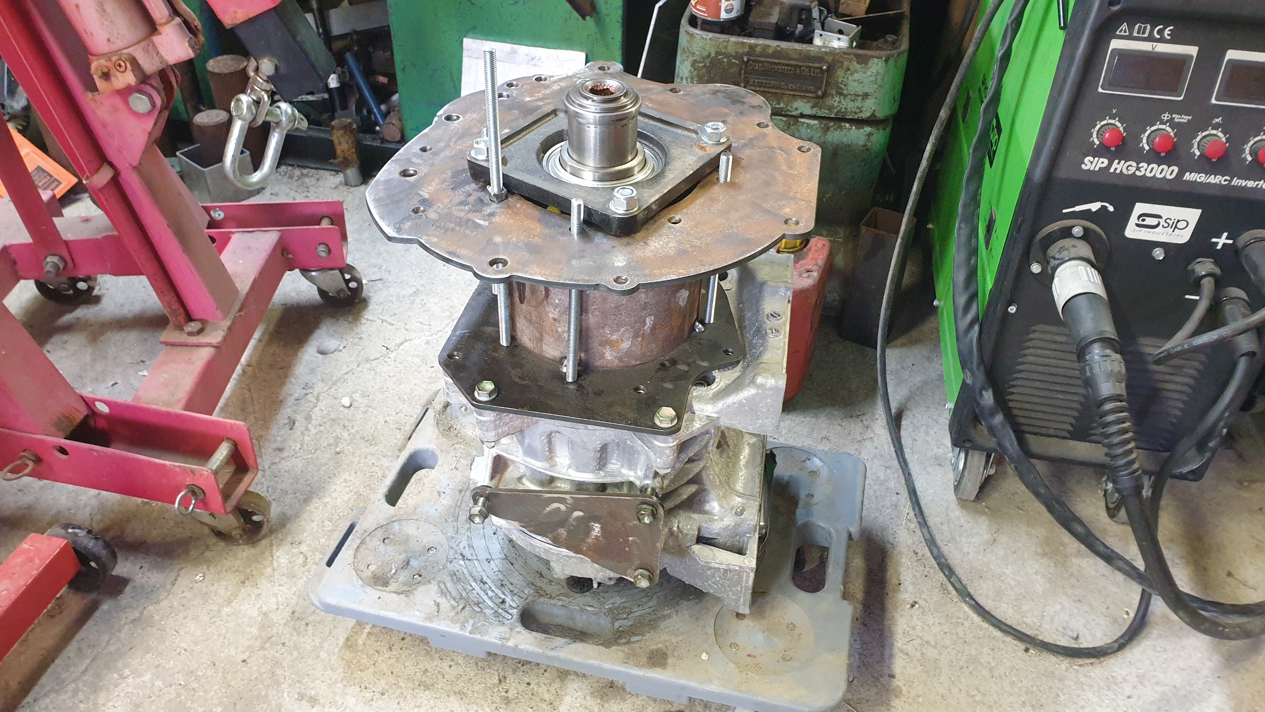

I've been learning Freecad slowly thanks to having a 3d printer and also trying my hand at some sheet metal design as I have someone with a cnc plasma cutter nearby. My first attempt at a bracket for the power steering pump. Dont laugh too much:)
