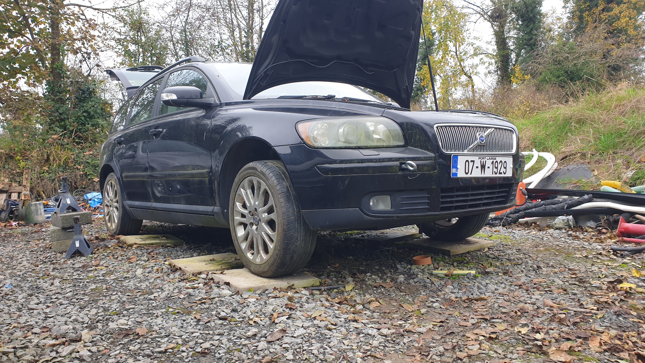

The T3RD (nut TURD) is my 2007 Volvo V50 with a Tesla Model 3 drive unit. Current status is the drive unit is fitted in the front using a custom subframe. Driveshafts are mocked up using a 3d printed coupler. Early '25 I'll get these made in steel, weld and install properly. Then this vehicle will be used as the test bed for the new OpenInverter Model 3 drive unit pcb.

Great project. I can't wait to see it driving with this motor.
I had my driveshafts made here in the Netherlands, let me know if you need an address.
