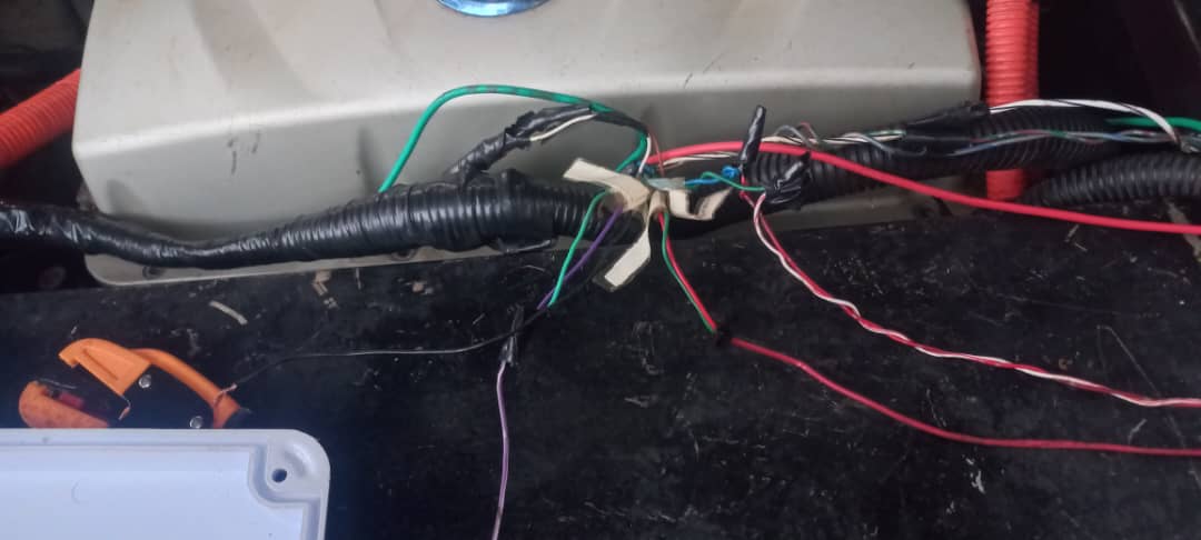

Hello,
I am using a Zombiverter with a Leaf drivetrain. I have provided both 12V and switched 12V power to the PDM and Inverter and other connections as explained by Damienm, but the DC-DC converter is not charging the car's 12V battery as expected. When I start the car, it moves, but the PDM is not sending voltage to the 12V battery. What could be the problem? Below are my params

Re: Leaf DCDC Failed With Zombiverter
Please provide pictures of your installation.
What version of Zombie firmware.
Also it is NOT failed, it just is not working... Please use accurate thread titles.

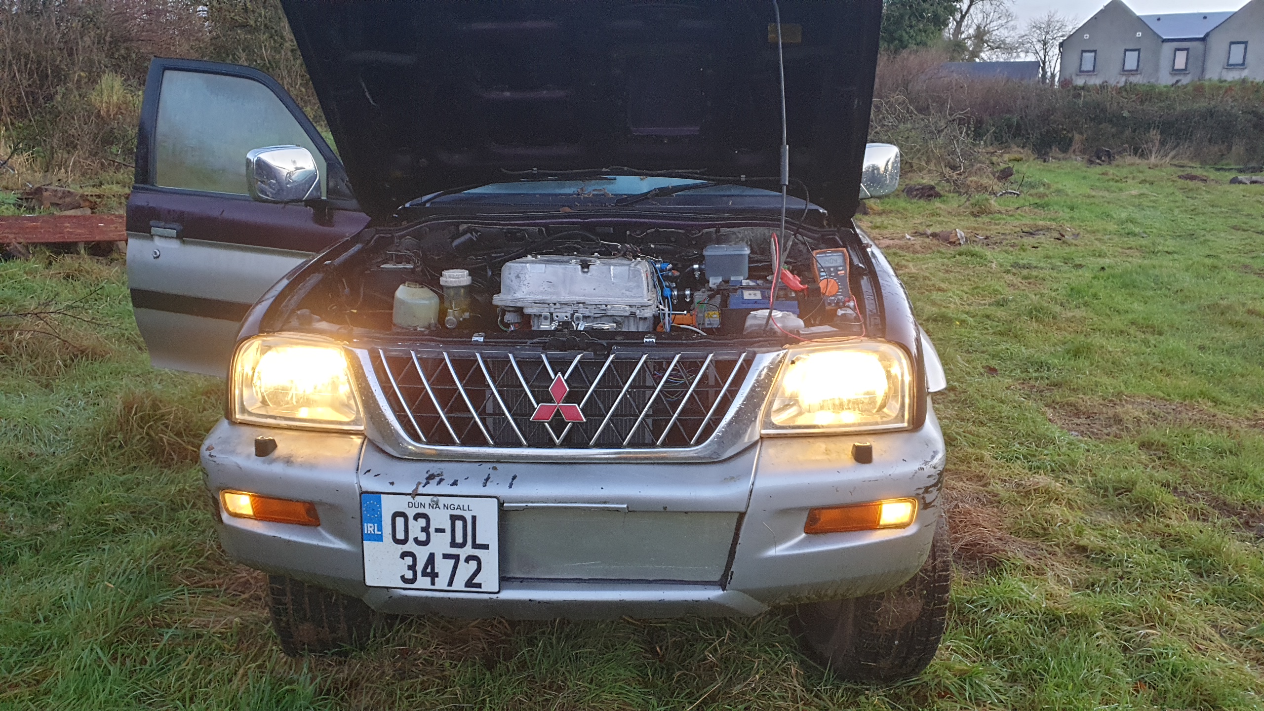

Been thanked: 356 times
Re: Leaf DC-DC Not Working with Zombiverter
V2.20A
Headlights, heater blower and rear window heater on.

I have spent the entire day trying to fix it but still it has not worked, i opened the pdm top cover to confirm if 12v is reaching
Here are my connection details
Connection Details:
CAN Bus Connections:
PDM and Inverter VCU can connection:
Green wire (CAN H) → VCU CAN Ext 2 H
Blue wire (CAN L) → VCU CAN Ext 2 L
ISA Shunt CAN connection to VCU:
CAN H→VCU CAN Ext 2 H
CAN L→ VCU CAN Ext 2 L
ISA Shunt to VCU:
Power Supply Connections:
Permanent +12V:
Red wire from leaf harness → Connected to permanent +12V
Dark Green wire from leaf harness → Connected to permanent +12V
Switched +12V:
Purple wire from leaf harness → Connected to switched +12V
Light Green wire from leaf harness → Connected to switched +12V
EV Relay Connections (4-pin relay):
Pin 1 → Connected to permanent +12V
Pin 2 → Connected to permanent +12V
Pin 3 → Connected to VCU's Inverter Power LS switch (for control)
Pin 4 → Provides switched +12V

DC-DC Solution: Upon reviewing the CAN messages, I discovered that the PDM wasn't receiving any signals. Upon opening the unit, I identified that low voltage was not reaching the PDM via connectors F18/F23. To resolve this, I implemented a bypass, and the system started functioning correctly.
AC Charging Solution
: I connected the PDM's permanent 12V (pin 18 on the F18/F23 connector) to the permanent 12V supply. Then, I routed the PDM's switched 12V (pin 16 on the F18/F23 connector) to the EV relay( controlled by the VCU switched 12V). Additionally, I established the CP and PP connections.

maiks wrote: Fri Dec 27, 2024 4:34 am
A
Can you provide ore details and photos
Is the connector pinout wrong?
was there a damaged connector?
maiks
Posts: 81
Joined: Thu May 11, 2023 9:20 am
Has thanked: 7 times
Post by maiks »
Bratitude wrote: Fri Dec 27, 2024 4:16 pm Can you provide ore details and photos
Yes my f18 connector was damaged.
The pinout is correct and l followed it to trace wires inside the pdm, cut them and made a bypass .
