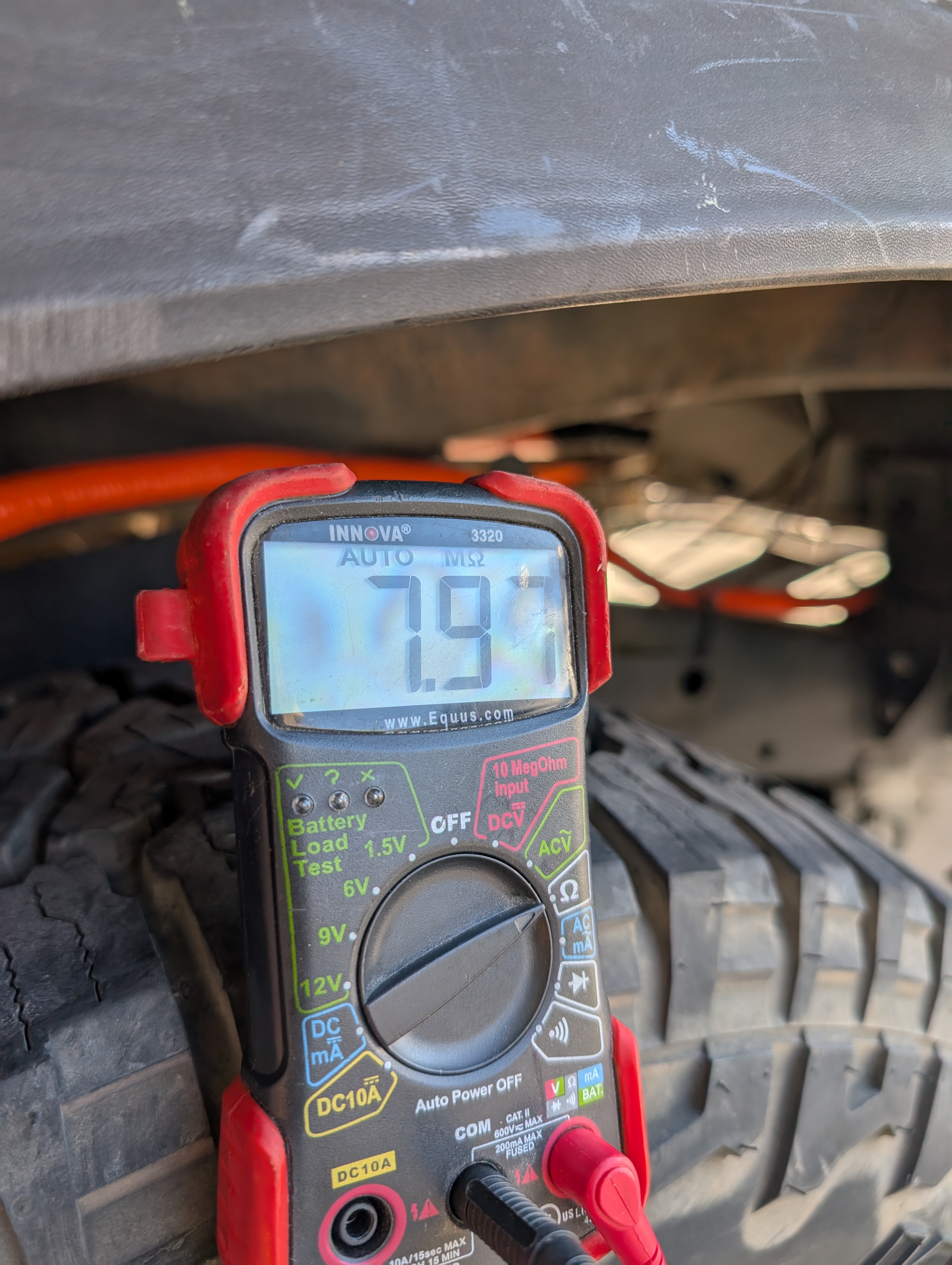

What is the resistance of your charge port, proximity to ground?

tom91 wrote: Sat Jan 18, 2025 9:02 pm I can see byte 5 of 00x390 going to 0x8C at end of log which is an error state. It does show 0x88 when plugged in which is good.

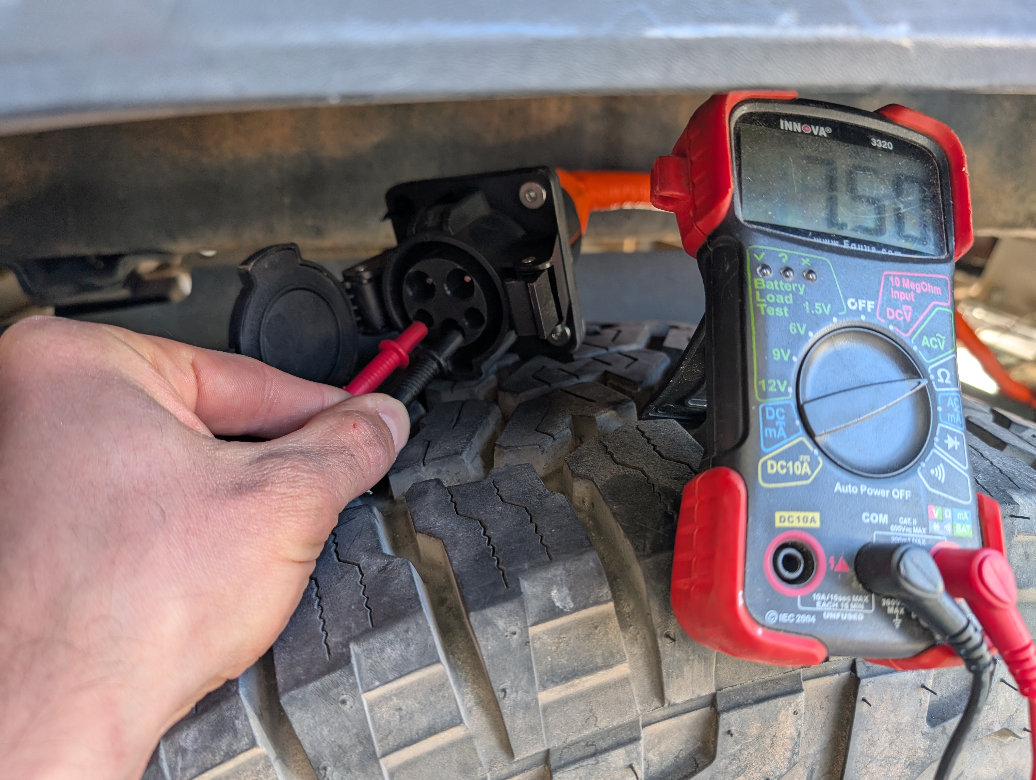

tom91 wrote: Sat Jan 18, 2025 10:44 pm What does that say? Kohm? You disconnect it from the pdm?

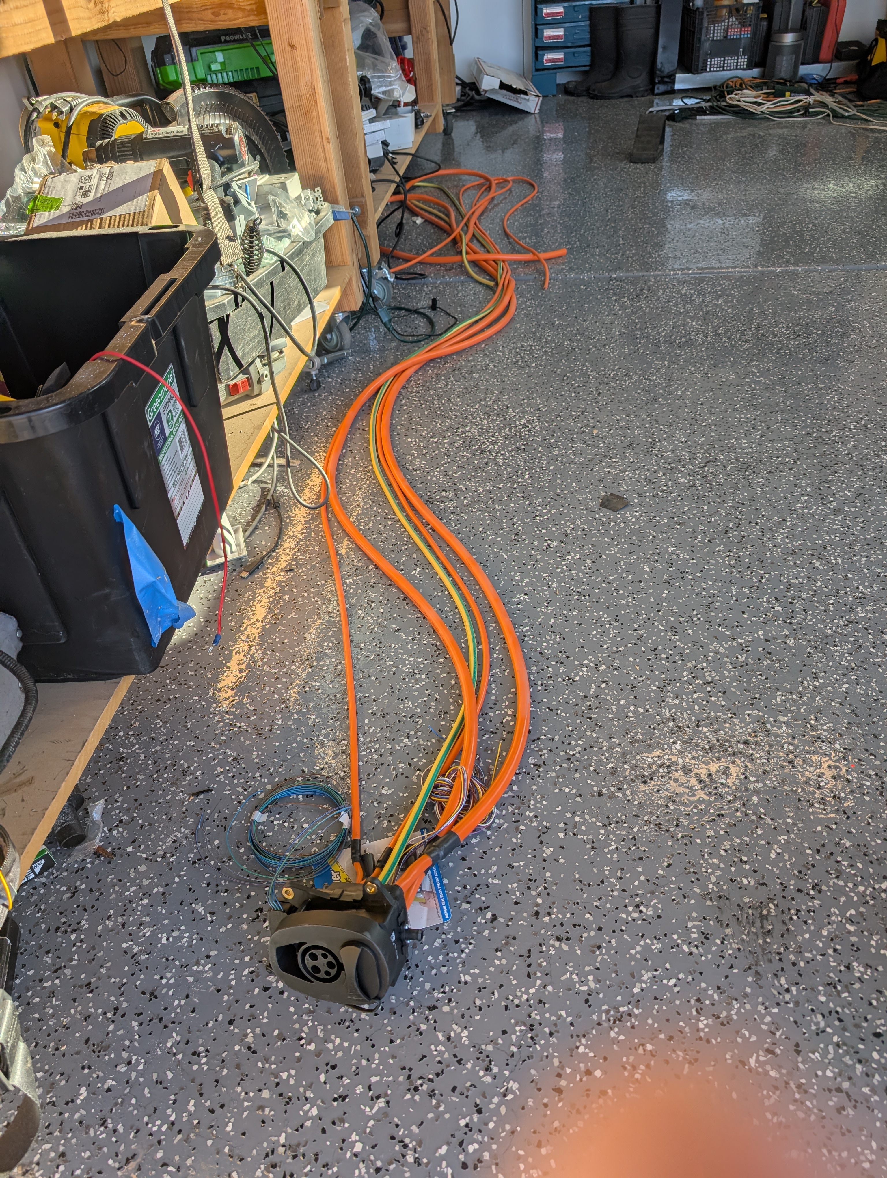

I did extend the charging connection from the PDM to that gas port but didn't permanently mount it yet since I was going to replace it. I just received a new CCS1 port that I'm going to use to add the Foccci in the future.
Here is a better picture of the multimeter which is reading 7.97 mohm now:
Posts: 2963
Has thanked: 330 times
Been thanked: 848 times
Re: [Driving] 1996 Nissan D21 Hardbody 4x4 Leaf Swap
The OE Nissan has 2.7Kohm between Proximity and group

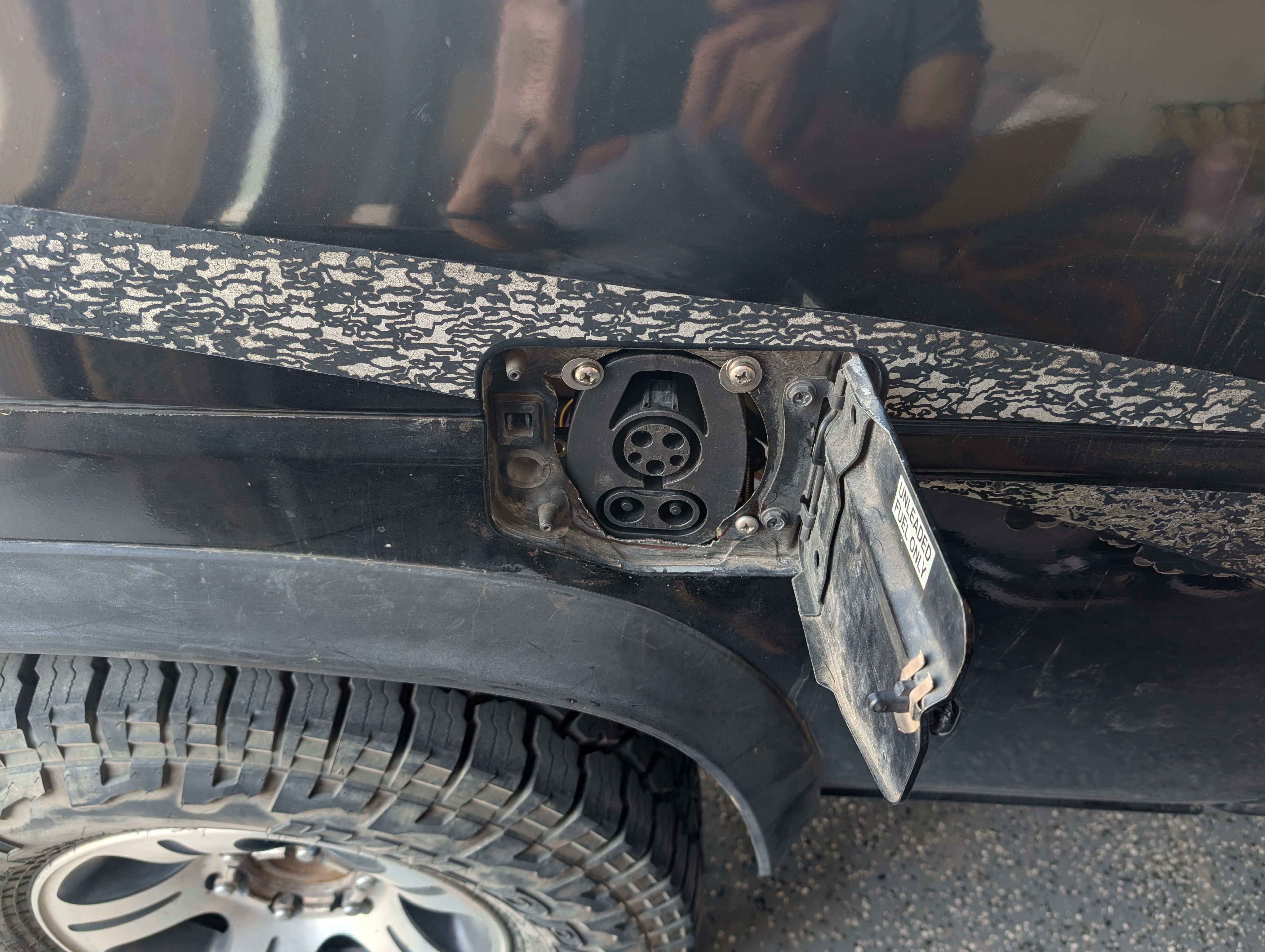

tom91 wrote: Sat Jan 18, 2025 11:55 pm The OE Nissan has 2.7Kohm between Proximity and group

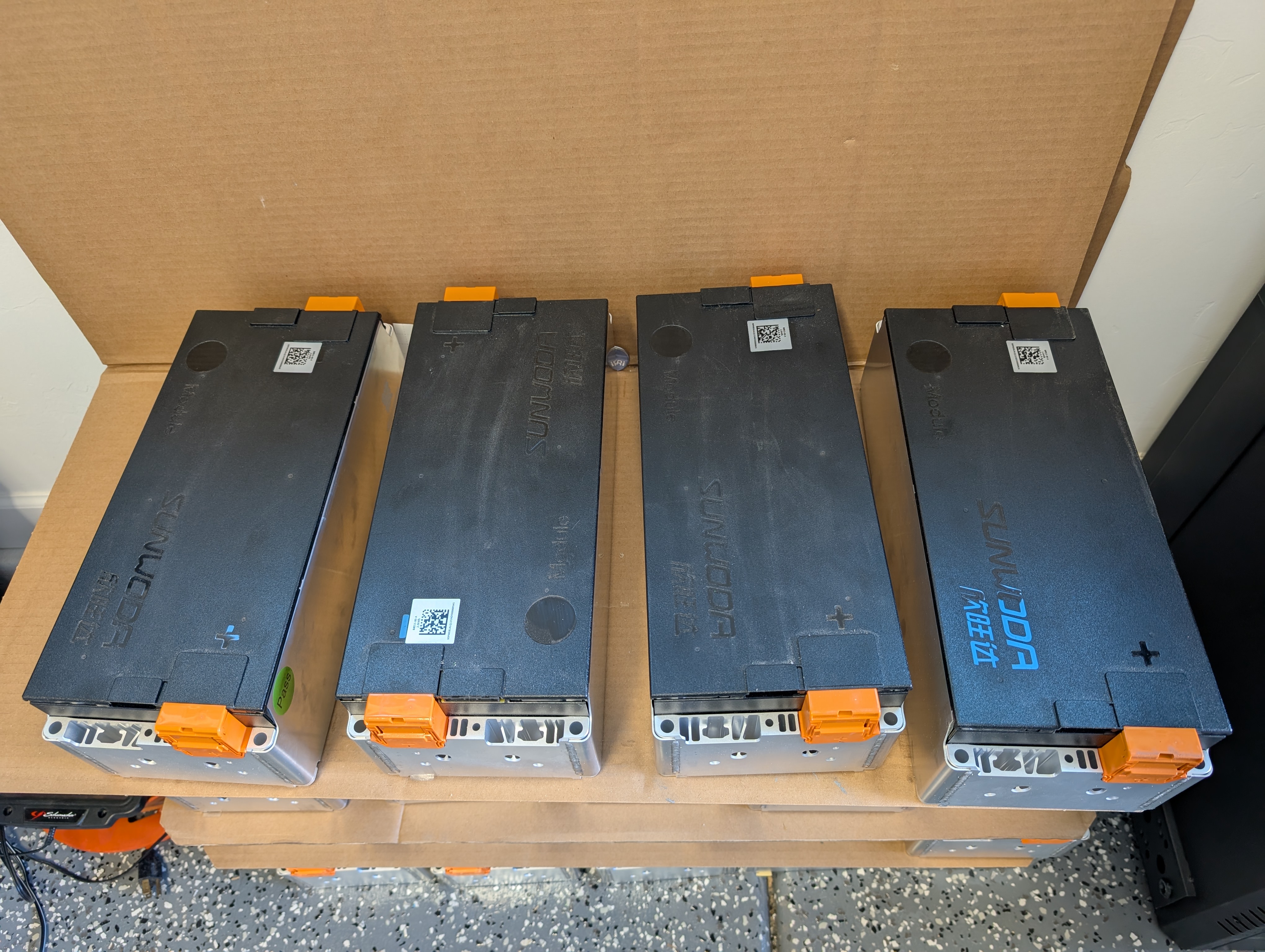

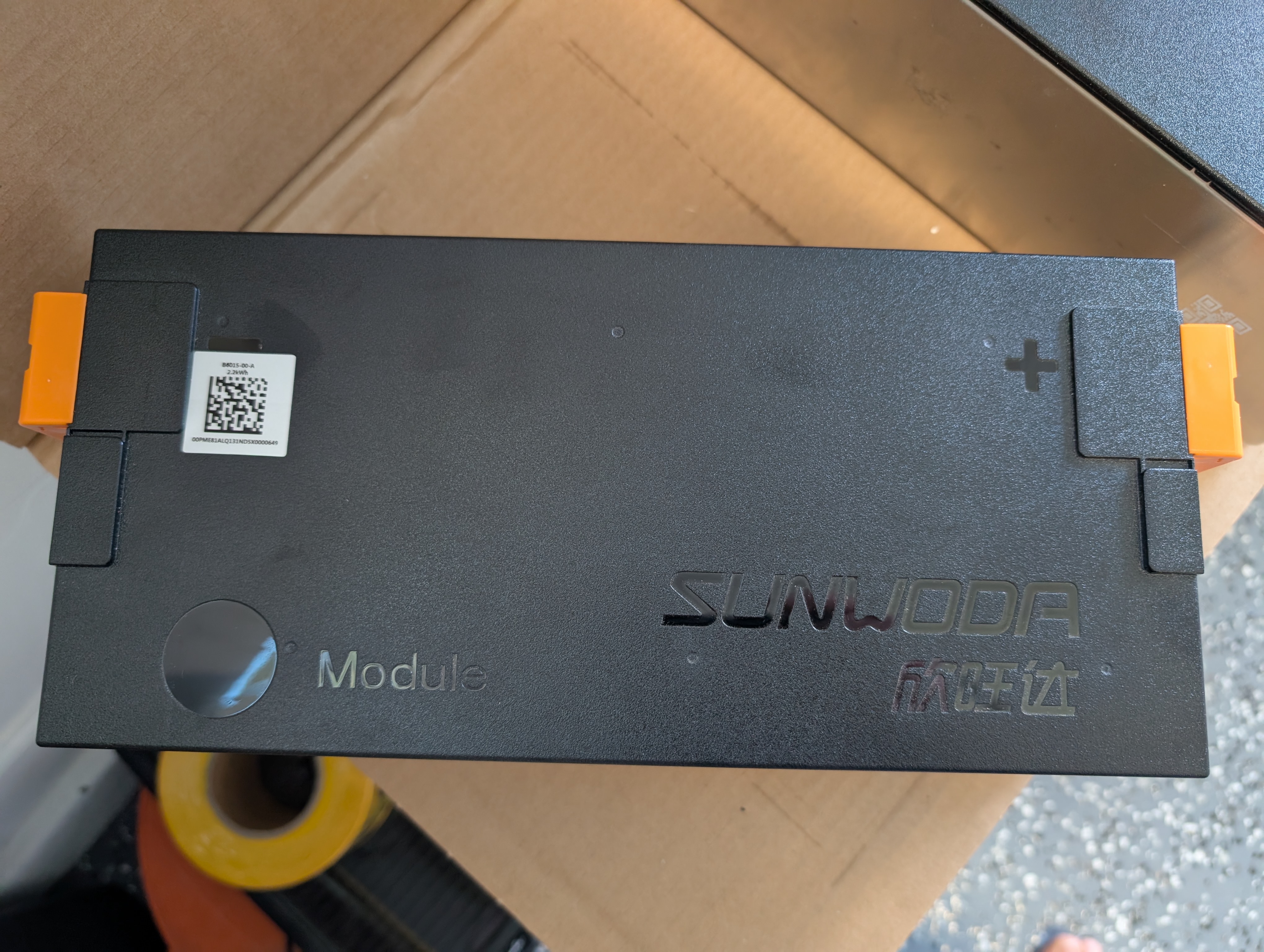

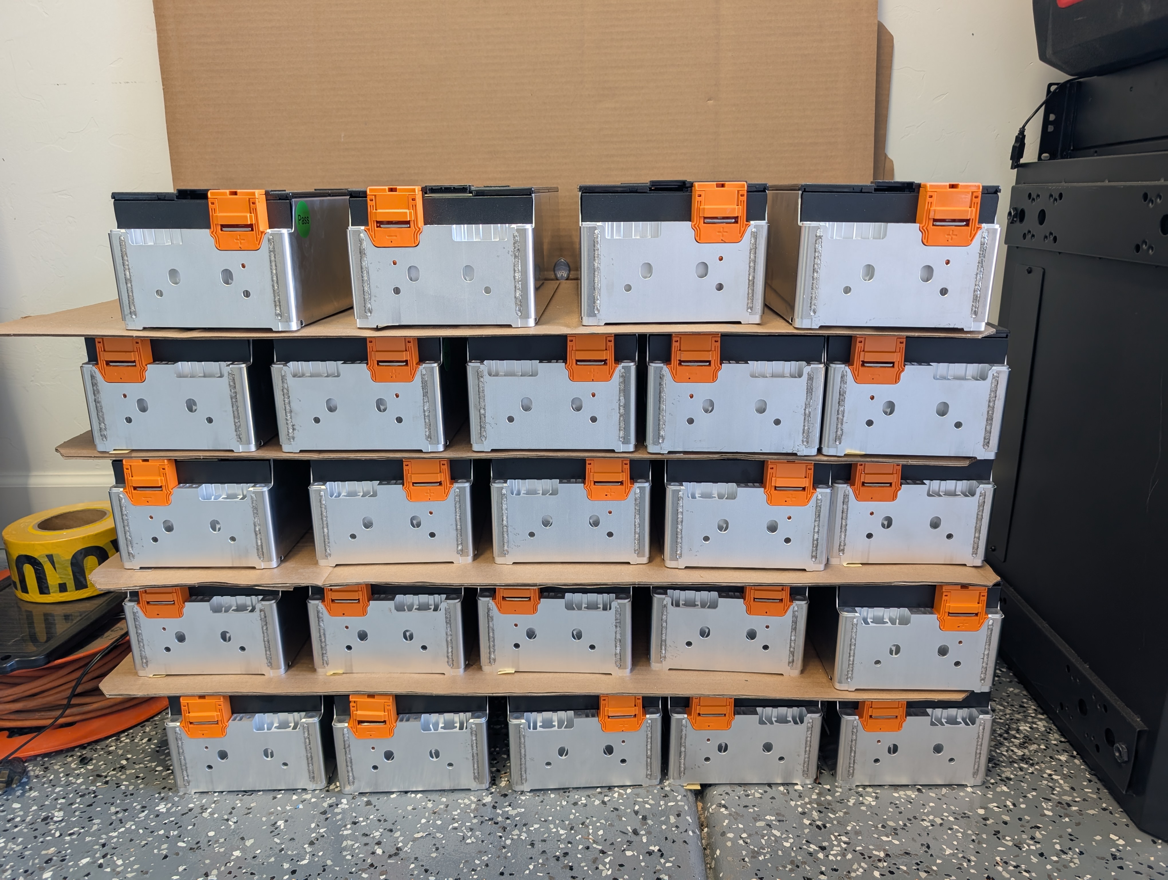

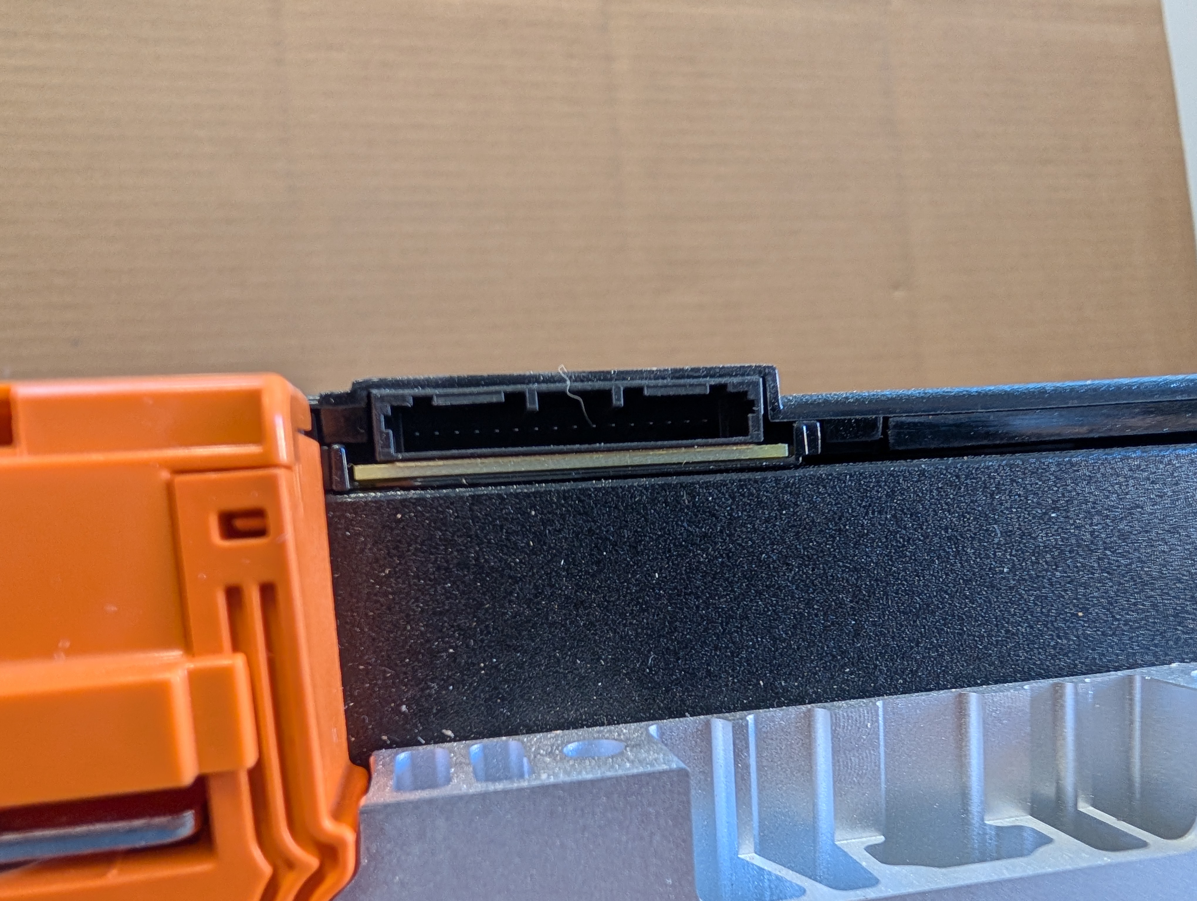

I replaced the old extended j1772 port with a Phoenix Contact CCS1 port at the gas fuel door. This fixed the charging issue, which seemed to be a bad pp line.
I got 24 4s1p Sunwoda 2.2kwh vda355 modules for a new battery pack. I'll use the OpenInverter BMS in the new pack.
Does anyone know where to get this connector?

Sector7e wrote: Sat Feb 08, 2025 6:22 pm
Are these from battery hookup?
From my memory they don’t have a very high c rate

Bratitude wrote: Fri Feb 14, 2025 4:10 pm Are these from battery hookup?
Yes, they are from Battery Hookup. The site claims 150 amps continuous and 450 amps 10 second pulses. That is about 1C continuous and 3.4C pulse. Will that be ok for general use?
