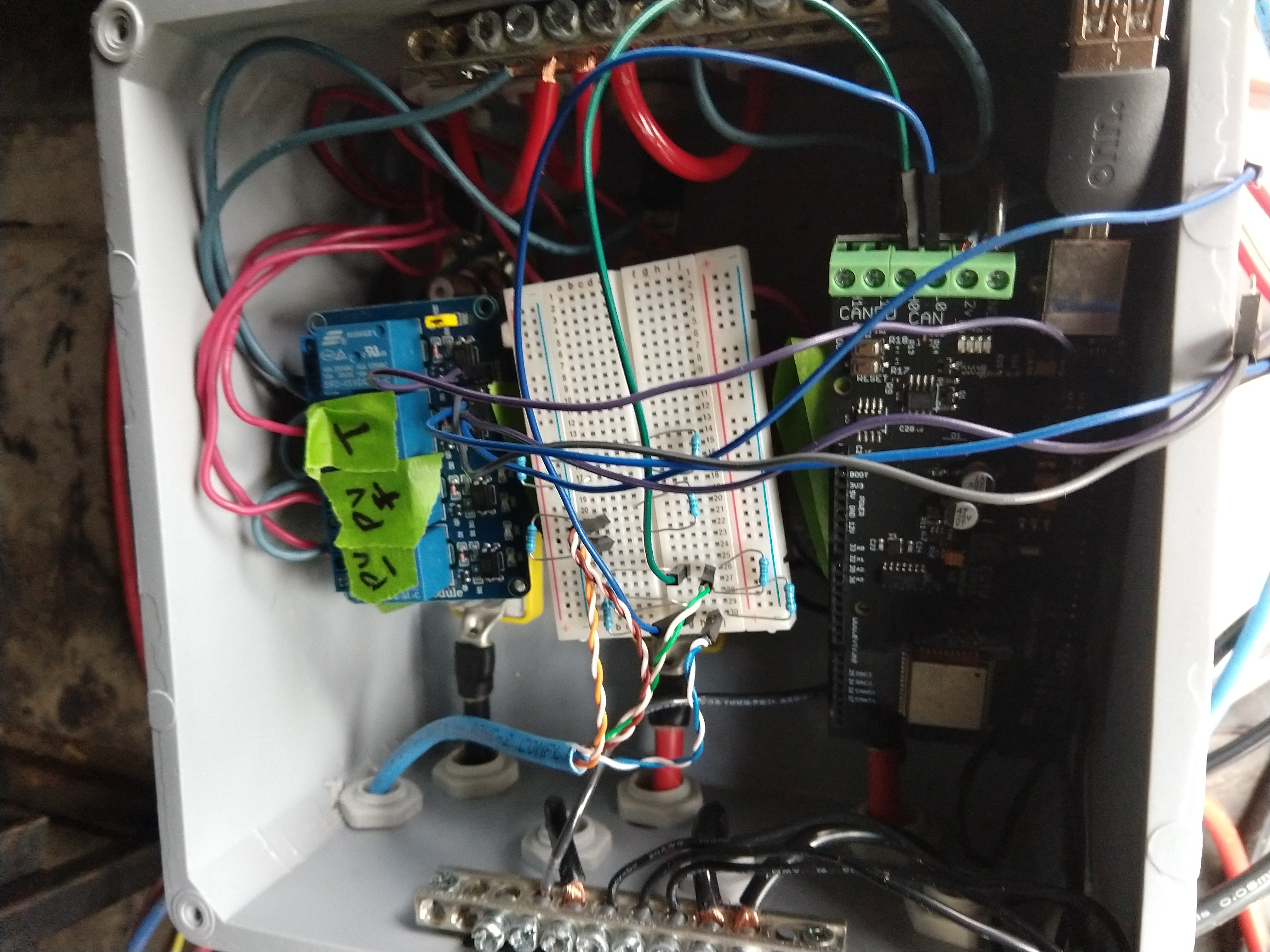

Hello,
Any experience with HVIL (High Voltage Interlock Loop) issues on model 3 battery pack?
I have a full tesla model 3 battery pack from a salvaged car. Besides replacing pyro fuse, no internal modifications.
I've used raspberry pi zero and evtv candue to send and read messages from battery.
We also own a model y and have used logs from it and from older model 3 logs found online to compare CAN messages from the battery. The below messages are unique to my battery vs other logs and the model y logs I captured.
I'm pretty sure my battery has an issue with the HVIL. The 2 CAN messages I'm getting below are what make be believe it's an HVIL issue:
0x20A HVP_contactorState C9 11 09 92 10 00
HVP_hvilStatus: UNKNOWN
0x232 BMS_contactorRequest 52 00 00 00 FF FF 00 00
BMS_internalHvilSenseV: 0V
I get no resistance and no voltage across the HVIL pins even when everything else is plugged in properly and I'm getting CAN messages out of the battery.
I've connected the HVIL pins on the battery connector with various resistors from 20ohms to 120 ohms.
When I log from the working Model y and disconnect the HVIL pins, I do not get CAN messages similar to the above messages.
Any advice on fixing this?

EVTV canDue connected to battery with CAN bus terminated with dual 120ohm resistors

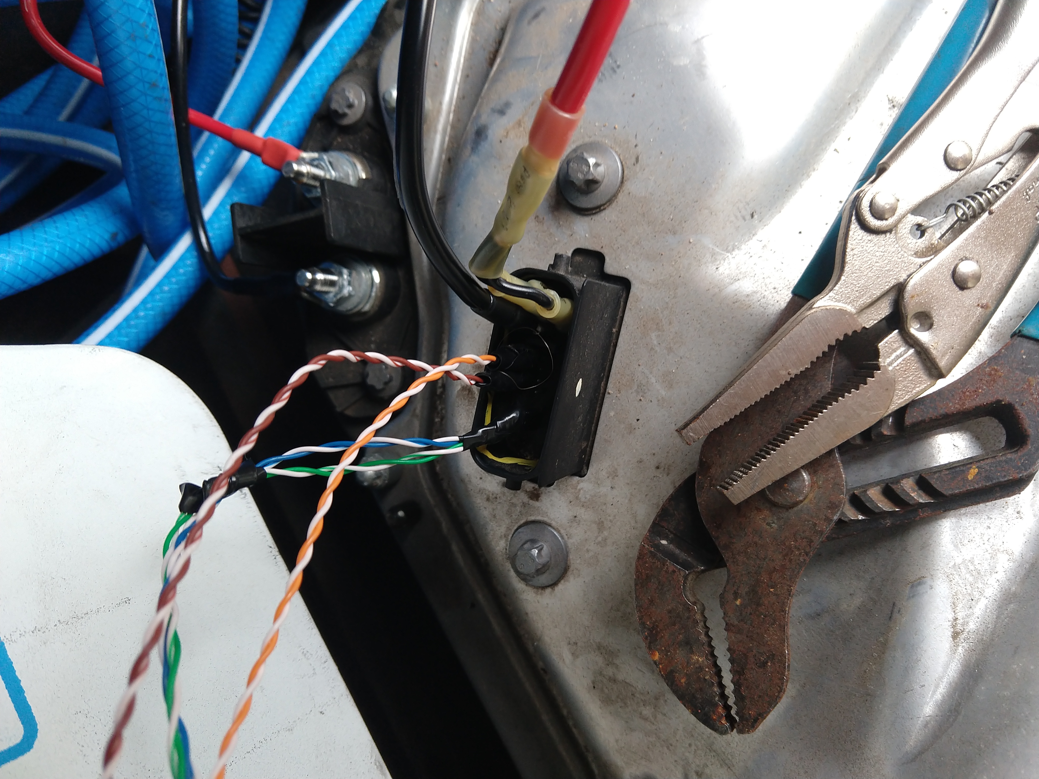

Wires Connected to battery

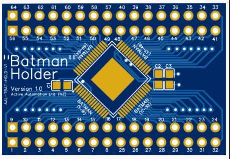

Hi everyone,
I was just trying to harvest a batman chip from the high voltage controller. But I'm having a hard time getting it off without damaging it.
Does anyone have some tips on what equipment to use and what temperatures?
I tried using the hot air soldering station but even when the solder started to melt it wouldn't come off. Does it have a pad underneath?
Thanks, Wim

You need quickchip to add another metal and lower the melting point of the new mix. In that way every molten piece gets lower and lower etc. And then you can get it off. Another option would be a hot oven perhaps?

I would think it is very likely the chip is glued down prior to soldering. So pre heating it to soften the glue would be an excellent plan. Also don't use a cheap hot air gun they just wont deliver the goods like a good professional one will.
Let us know if you manage to free Batman 8-)

Getting this board made up at moment,
And batman chip placed on it, so can swap between porotype boards
Then hopping to look at reading data once I get some hardware

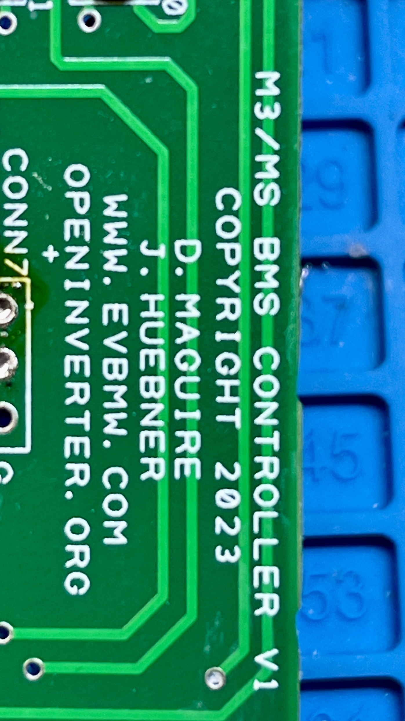

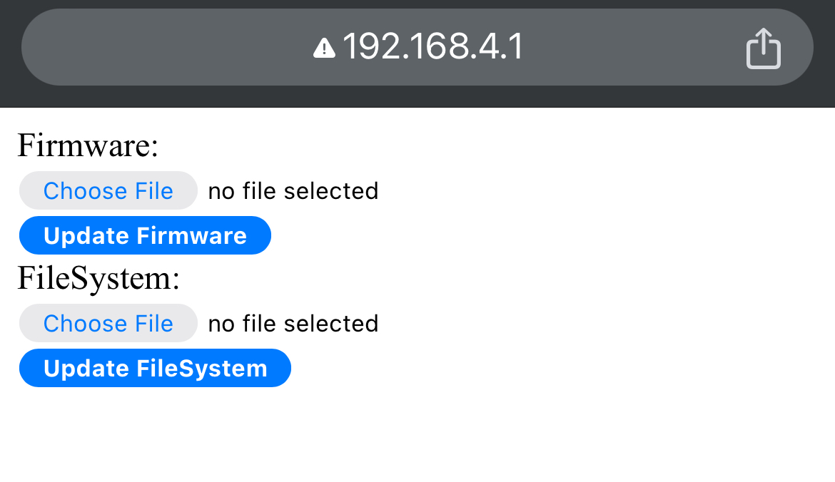

Hi, I have the Batmanboard (aka M3/MS BMS Controller V1) and transplanted the Batman chip from one of the harvested slave boards on it. Build up my test scenario, so have a other Slave Board connected to 23 batterie cells to siulate a block, connected SPI (p/n). But I did not get readings (Web-Interface). I can see that the Slave Board sends data to the batman STM32 board, but the register are not filled, also after SPI p/n swap. Then I did a mistake, thought I just have to use the latest version from Github, uploaded the bin file and now the Batmanboard is not working anymore. asking for a new Firmware or filestructure file (Wifi only). On Github I could not find the default file to fash again the STM32 chip. Where could I find that file to get my batman STM32 board working again?
Thanks for any hint.

I don't quite understand which part you flashed. The ESP Wifi board? Because "asking for a new Firmware or filestructure file " means the file system of the ESP8266 was lost. In this case look here: https://openinverter.org/wiki/Olimex_MO ... bInterface

Wifi Module WEMOS D1 still connected to my infrastructure and when opening the 192.168.4.1 it asks for update Firmware or update Filesystem. Will try your lead, thanks a lot.
Update: Finally I spared some time to get my board up and running again. Now I have connected that with a full pack (4 Slave BMS). Has had anyone else the problem that only 88 cells are present instead of 96? I have made reference measurments, taken the total voltage divided with average V from Cells and came up with 96. But the Board reports only 88 cells. Any idea where I could find an path to get the value from all 96 cells?

johu wrote: Fri Apr 05, 2024 8:49 am I don't quite understand which part you flashed. The ESP Wifi board? Because "asking for a new Firmware or filestructure file " means the file system of the ESP8266 was lost. In this case look here: https://openinverter.org/wiki/Olimex_MO ... bInterface
Thanks for the guides and I found couple of more instruction how to get that up and running again. I am back with a working board and now are scratching my head about the situation that only 88 Cells are reported instead of the 96. The total Batery voltage divided throught the measured average voltage per cell gives me 96. Still only 88 are in the spot values. Anyone who could point me to a direction to get all 96 cell voltage into the spot values?
