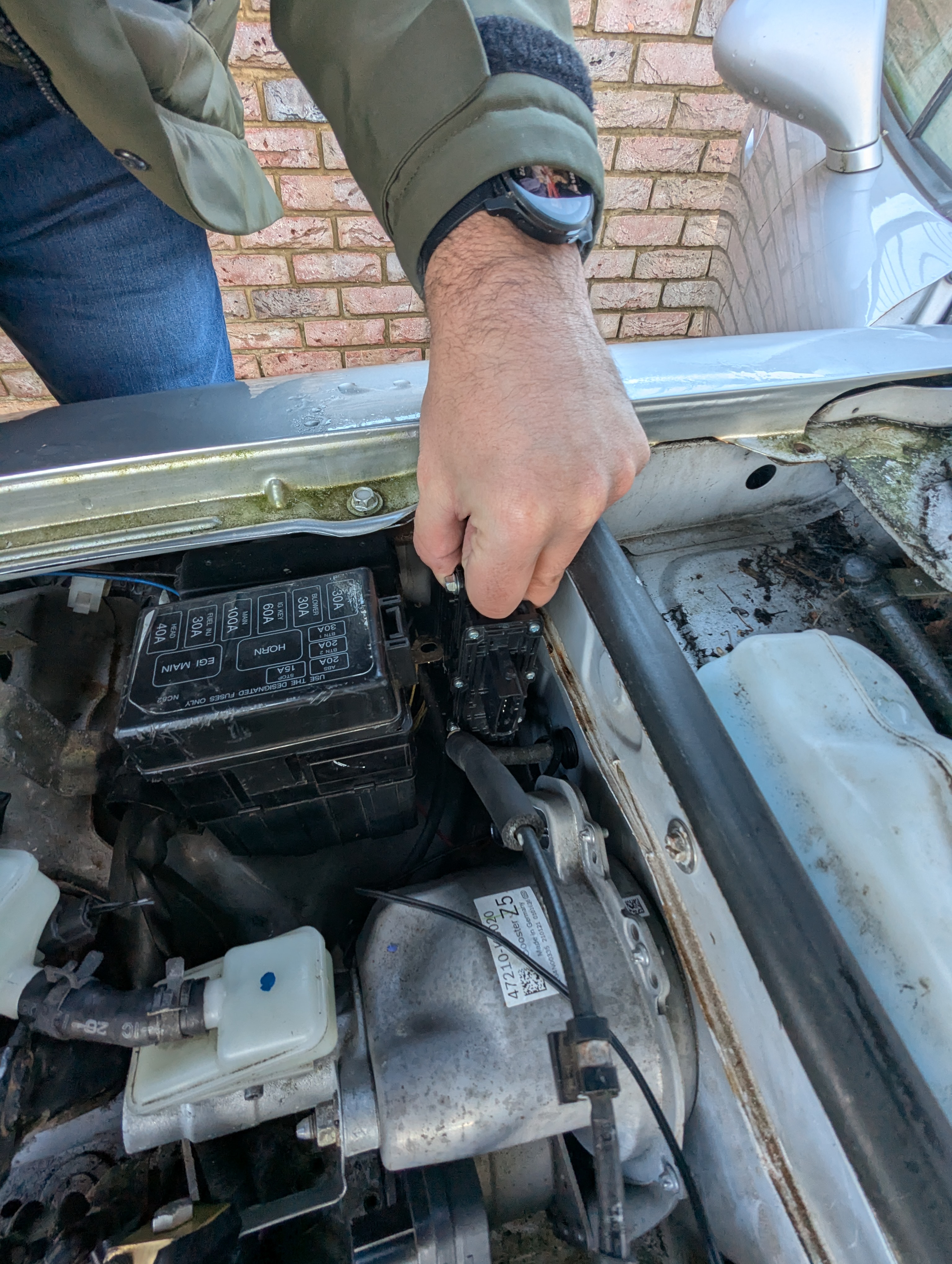

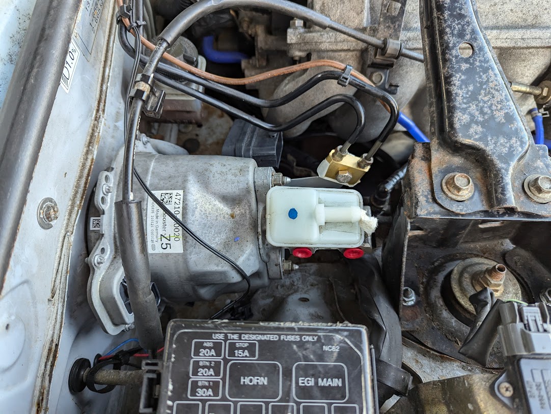

Re: Yaris Gen4 iBooster Gen2
Installed with a temporary remote reservoir (Honda CRV), although unfortunately I can't use a remote reservoir as there is no obvious space to mount one properly. I had to grind a very small amount of flange off the bottom of the iBooster to allow it to fit without fouling the bodywork.
Also you can see the hardline joint, the brass thing next to the master cylinder with the two factory lines connected to its top. The factory joint doesn't quite work in this application, so this brass block is a brake line joint from a Subaru Forester.
Better view of a small bracket used to mount the joint in the hardlines.
The trimmed M8 clevis joint.
Possible reservoir from a Mini R56, but requires an adapter to change the mounting angle. I'm awaiting a mock 3D print to test fit, but of course this would need to be something like machined aluminium to be properly functional.

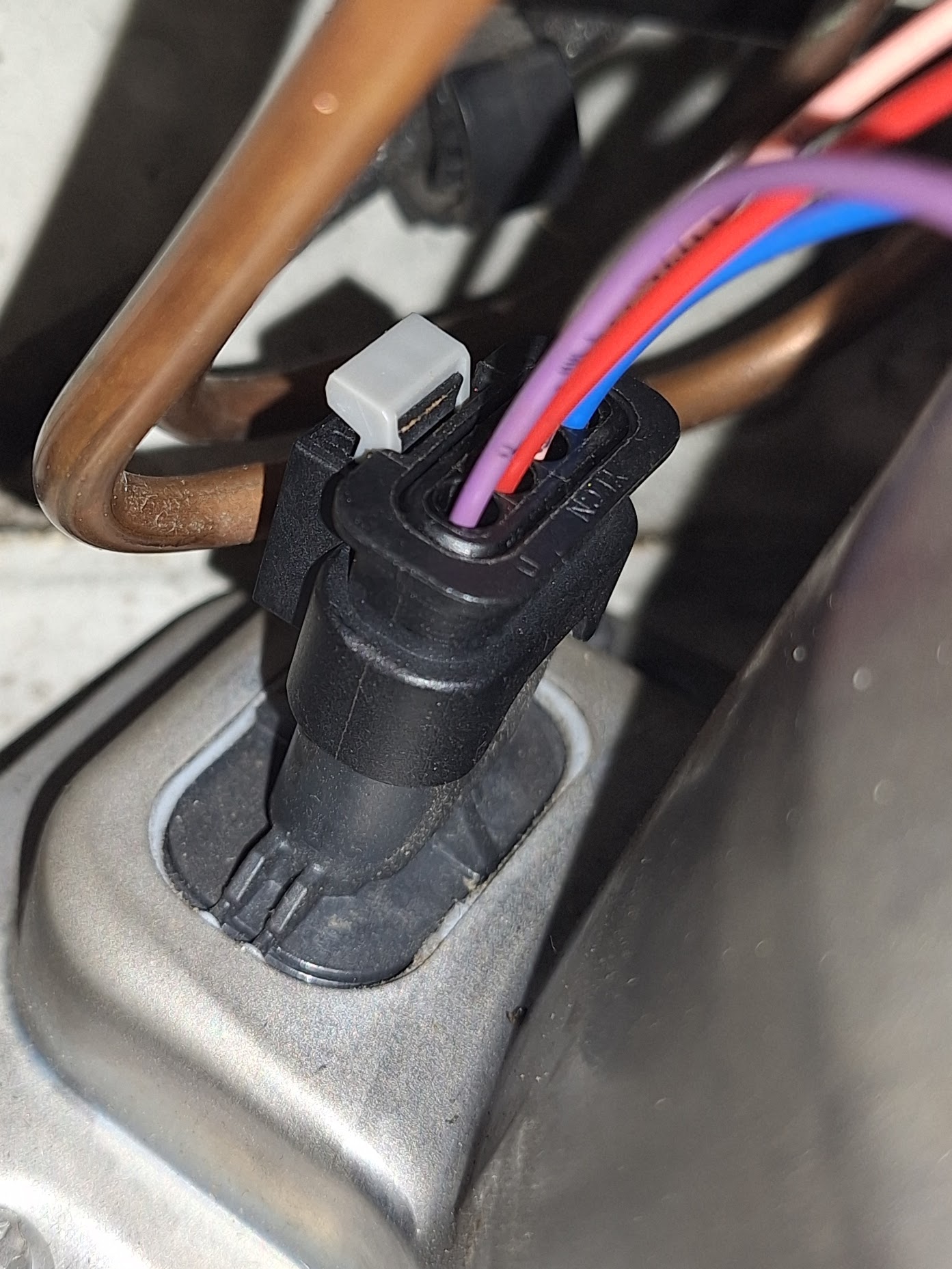

I am using the same ibooster from a yaris in my project. To get is to work in failsafe mode I needed to add 120 Ohm resistors to the CAN busses. And than power, ground and ignition.
Found the connector for the sensor on aliexpress
https://nl.aliexpress.com/item/1005004072725751.html
The connector is still on its way. So I am not a 100% that it will fitt.

I was lucky enough to receive the pedal position sensor connector (and it's mini-loom) with the iBooster when I bought it, but I've had to source the main connector and terminals/seals elsewhere.

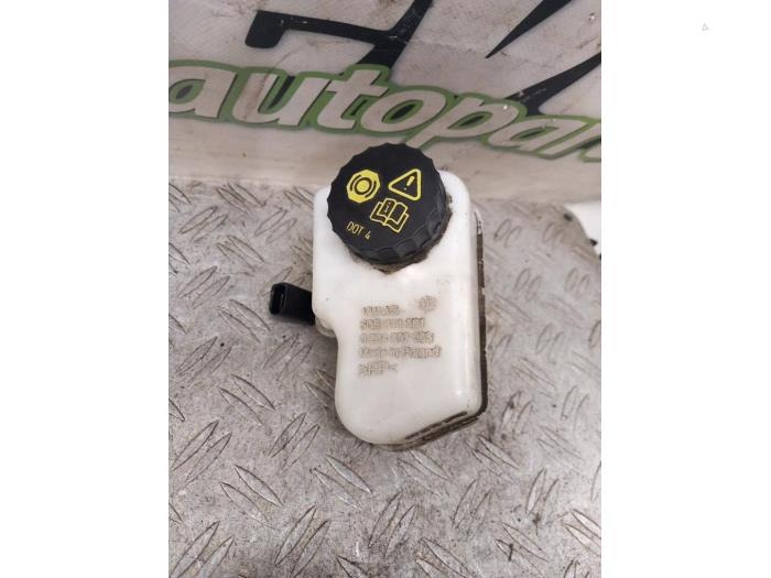

Update on the reservoir - after further browsing and googling, I've found that the reservoir from a VW Golf Mk7 or Passat B8 (LHD version) not only matches the clocking of the Yaris master cylinder, but fits the package space I have and has the fluid level sensor on the convenient side of the reservoir. The part number is 5QE611301.
All I need to do is find one... Since I live in the UK I need to search overseas for this reservoir. I've got leads on a couple but the postage is more than the cost of the item itself. :/ Will have to pull some strings with my EU-based colleagues at work.

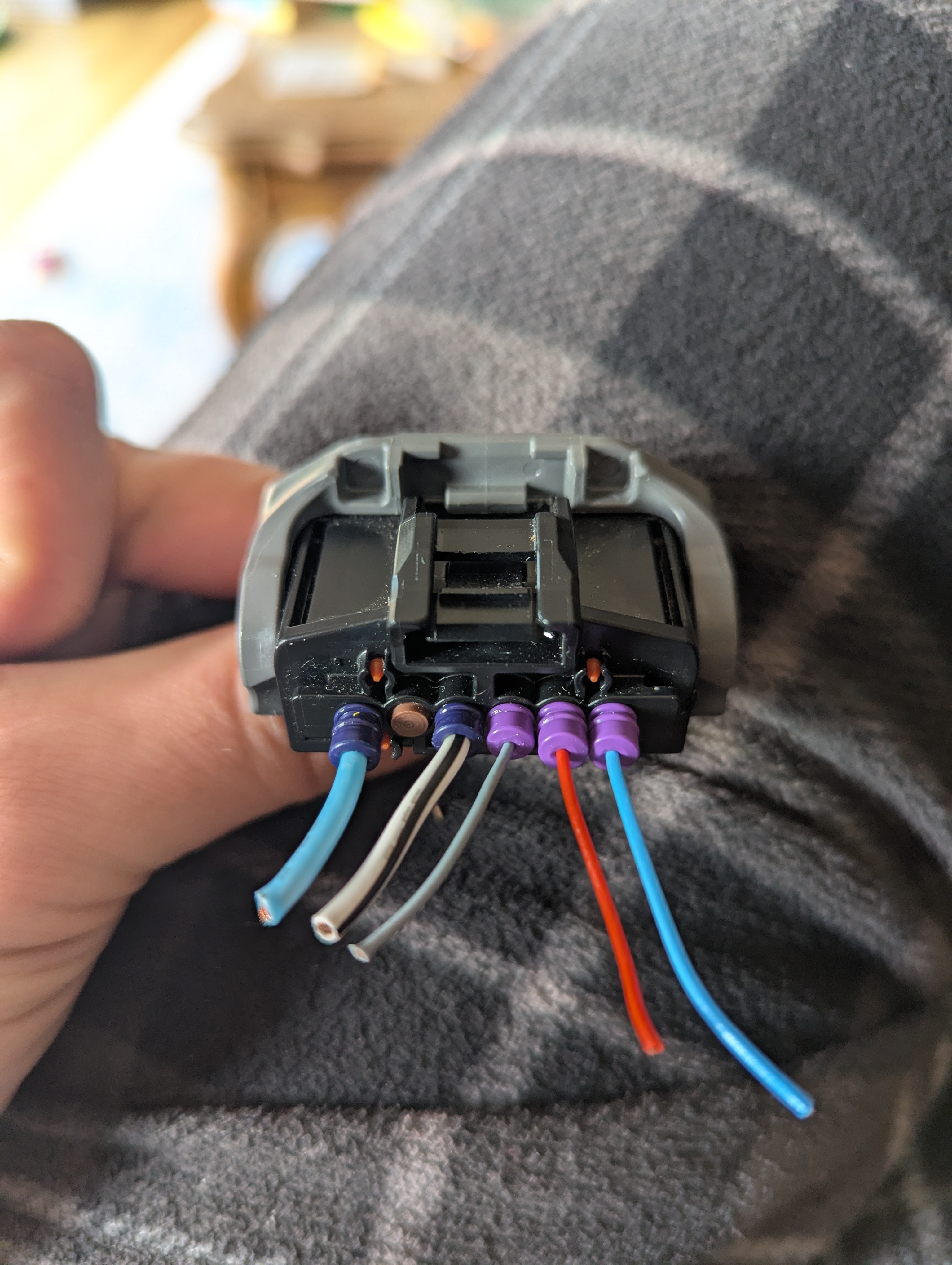

I have received the Brake Control Power Module
cute little thing that it is.
It's roughly 14 x 12 x 5 centimeters.
I've found a convenient place it, right next to the iBooster, tucked under the wing;
There are three less-than-perfect-but-probably-okay existing mounting points nearby, all on the main fusebox bracketry. I'm drafting up a cardboard template for the mounting plate as we speak.
I was careful to order one with the connector, here it is with pins half-way removed;
The connector is as follows;
Connector: 90980-12785
Terminals;
Sumitomo TS sealed series
8100-0461 (0.5-1.25mm²) (3off)
8100-0462 (2mm² max) (2off)
Pinouts;
01: +12V 10A fused permanent live
02: LIN (iBooster pin 4)
03: WKUP (iBooster pin 24)
04: GND
05: -
06: OUT (iBooster pin 17)
I've bought new terminals and am just waiting for some new wiring to come through the post

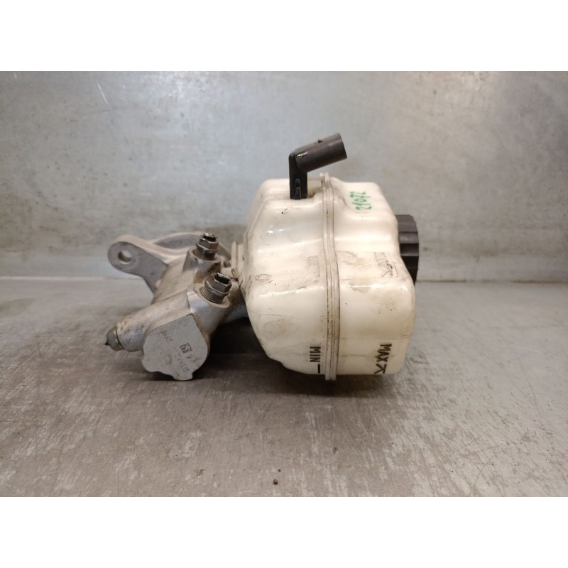

A small amount of "exciting news";
I ended up buying a whole iBooster/master cylinder from Lithuania for ~£110 just for the reservoir
At least I've got it now, and it fits like a glove in the car
. I can also sell off the iBooster and reservoir-less master cylinder on the bay to make the money back.

After 3 weeks of delay my package finally arrived. I can confirm that the connector fits fine.

so just as of today I got the Yaris iBooster up and running in my MX-5.
ATM I am not entirely happy with the brake feel. The brake is stiff for a splitt second, then starts to go down to breaking point - I thought there should be more generic feel to the pedal. The breaking itself is sensational, I can get the NON-ABS car to lockup in a breeze... What bugs me is the artifical break feel.
Greets
Sven
Greets
Sven
