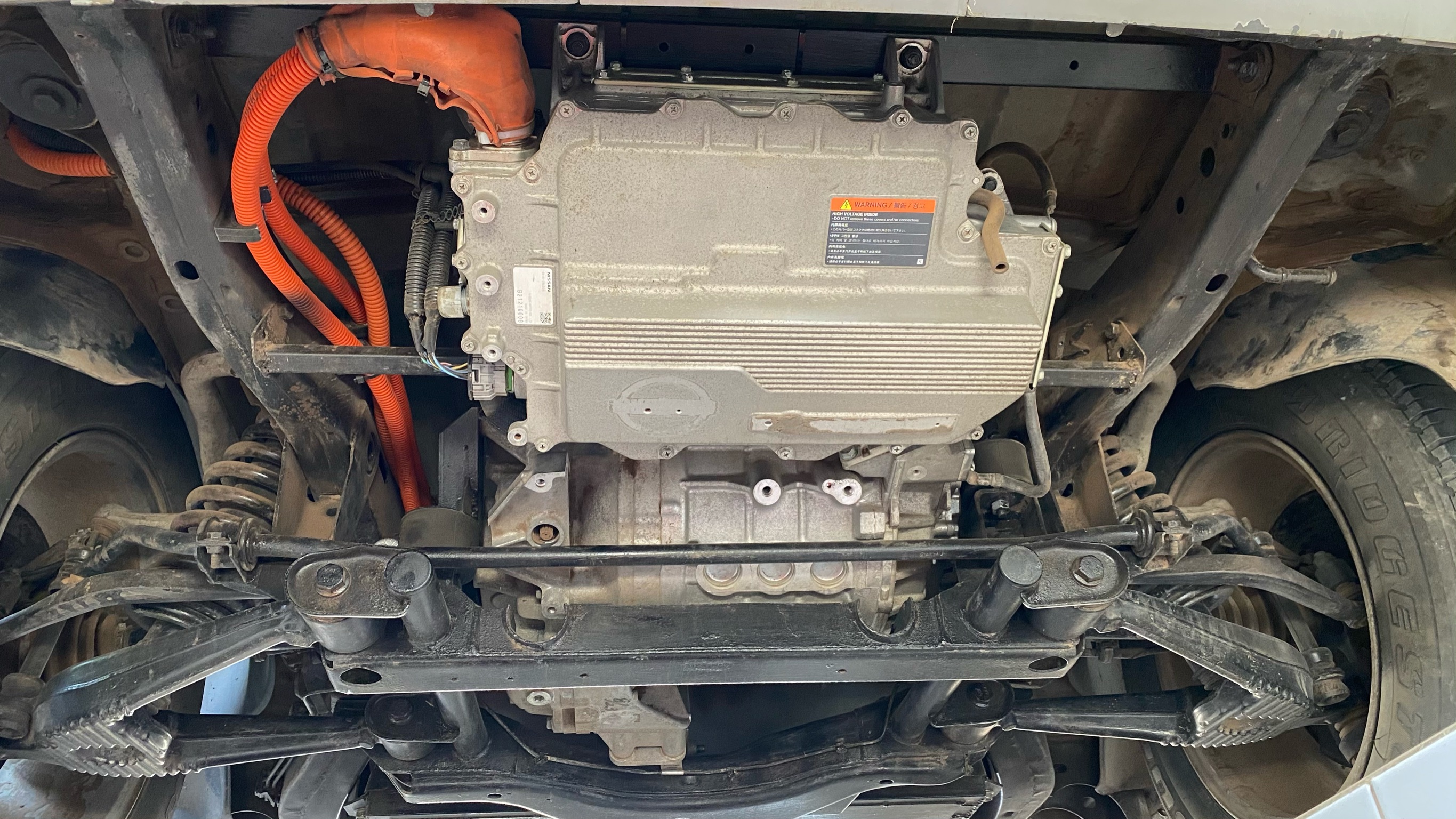

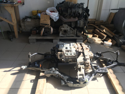

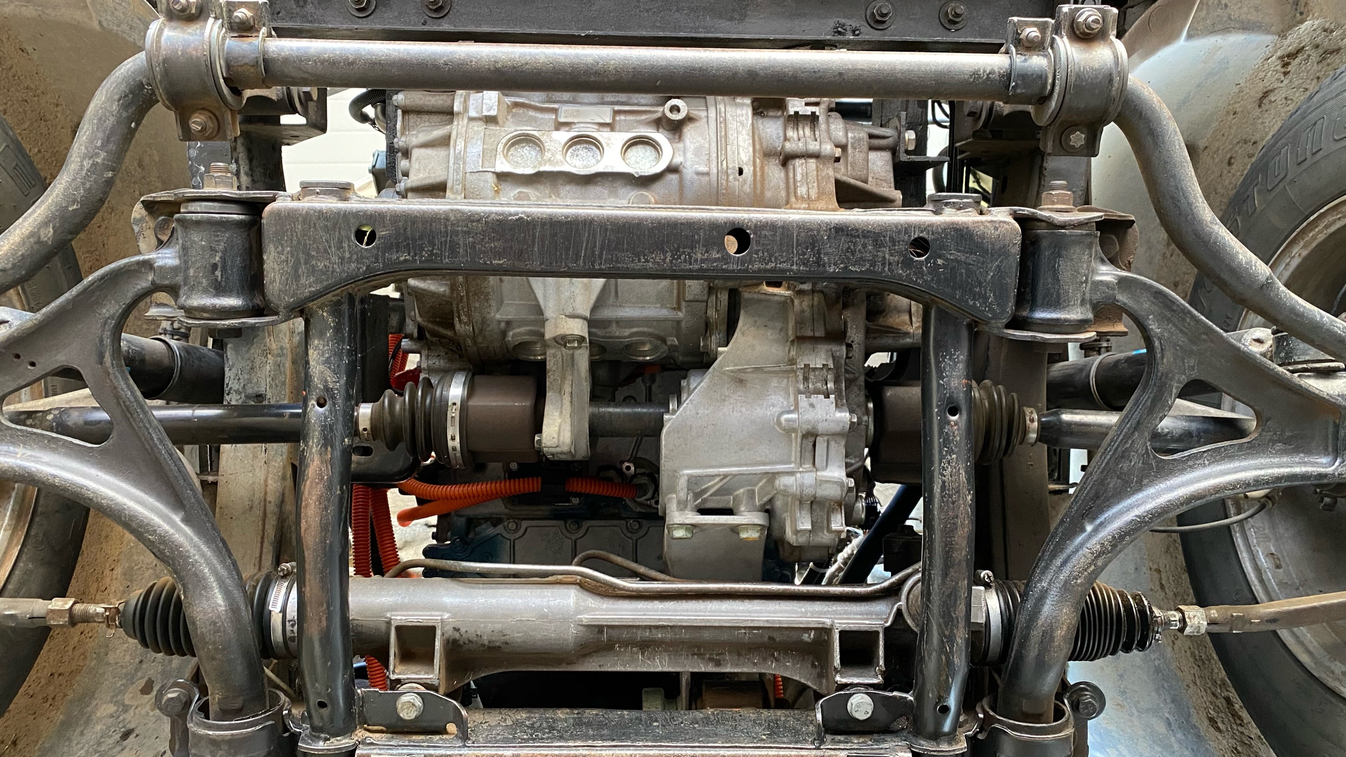

Marat
Posts: 29
Joined: Wed Nov 16, 2022 6:24 pm
Been thanked: 12 times
Re: ZombieVerter Support for Dual Motor Setup?
Post by Marat »
Front and rear EM61, Leaf Gen1, the torque targets are the same, the total power consumption from the battery is limited to 100 kW.
On a slippery surface, one of the motors tries to slide, and here the standard ABS-ETS system of the car helps, it is highly advisable to start it.
