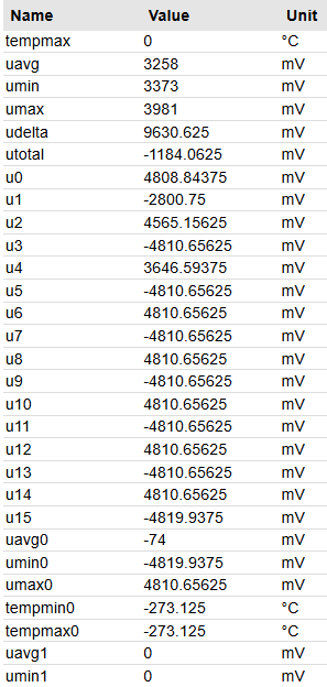

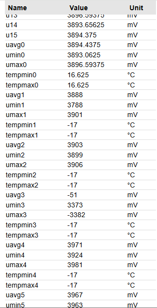

As mentioned in the main BMS topic, I've update firmware to 0.20.B and connected one NTC sensor to the first BMS board and Temp1.
Working great and showing what I think is correct temperature - around 16 Celsius degrees.
On first two boards I've managed to upload firmware using web UI and can, but on the last four it just didn't work, always stopped on the third packet from web. I think it's something with an EPS32 because I need to restart it to continue browsing web UI.
I took ST-Link again and updated all without any problems.
But after restarting boards, board 4 started to report incorrect values, here is readings from master board and board #4
What could be a reason for that? I do have +12V and enable pins connected together if that matters.

Last night, I checked the modules’ temperature by hand after powering them off (but still leaving them connected to the battery box).
Module #4 was hot - I would say: similar to what happened with module #2 back in September, which had a shorted MOSFET. I’ve now disconnected all modules from the battery.
@johu, I reviewed earlier posts and saw you reported fixing Module #4 in October, but I suspect that might have actually referred to module #5, since I only sent you #2, #3, and #5.
Any suggestions on how to proceed with #4?
Thank you!
Been thanked: 1914 times
Re: Flying ADC 16 channel BMS 96S test
Yes that is another mux failure. Did you have the battery connected while updating via SWD? Maybe some pins randomly toggled while flashing. I think I have to add pull-down resistors to the respective pins.
Remove Q1 and Q5 and see what that does. If you then get readings from the other channels replace Q1 and 5 with new FETs (any 100V N-FET)

I managed to desolder Q1 and Q5 myself using a hot air gun - new skill unlocked! :)
After reconnecting the BMS to the battery, I’m still seeing problems:
Not all channels are functioning correctly. I don't know whether this is due to the missing components or if other parts are also damaged.
Since none of the local stores has 100V N-FETs, I’ll order them online and it should be here in few days.
u1 if off because of the missing FET, but there also seems a broken PFET messing with the other values. When I fixed your modules previously I went over all FETs with a diode test mode. They should read 0.5V or so from Drain to Source. Any more or less means it is broken and needs replacement.
It is hard to tell from the values alone which FETs are affected because a broken one skews the other channels as well
If you order anyway go for the specified BSS123 (N) and PJM10H01PSA (P)

u9     3835.71875
u10    -177.34375
u11    403.46875
u12    -3.5
u13    0
u14    0
u15    0
I expected u0 to be correct but found that Q5’s source pin wasn’t making contact with the pad below it. After fixing that and verifying all MOSFET connections on all three pins, everything checked out.
The only questionable MOSFET is Q44—it measures 0.5V drain-to-source, but drain-to-gate shows nothing, whereas other MOSFETs measure around 2.5V.
After reconnecting to the battery, u0 and u1 improved, but the last seven series still appear bad:
u0     3887.6875
u1     3885.1875
u2     3885.65625
u3     3886.21875
u4     3886.21875
u5     3845.125
u6     3904.4375
u7     3879.78125
u8     3894.46875
u9     3673.03125
u10    -1934.59375
u11    4465.90625
u12    -13.5
u13    0
u14    0
u15    0
To investigate further, I measured the resistors, and several are far off from their expected 10Ω values:
R22   56Ω
R29   25Ω
R32   30Ω
R18   16Ω
R21   413Ω
R30   59kΩ
R38   700kΩ
R19   -
R20   -
R39   220kΩ
R31   -
R23   1.3MΩ
All other resistors measured correctly. Since most bad resistors are tied to the cell voltage pin trace, that likely explains the incorrect readings for u5–u8. Not sure how R23 will affect things, though.
I'm open to any other suggestions for testing. Otherwise, I’ll order replacements and swap them out.

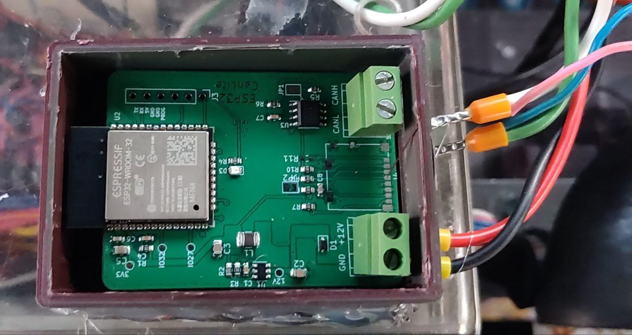

Not sure what am I doing wrong.
I connected the CANH and CANL from the inverter in parallel with the wires coming from the BMS.
on Node 1 I am getting the info from the inverter fine, but I cannot get any info from the BMS-es. on node 10 to 15 I am not getting the red banner on top that show you are not connected to anything, so that means that I am connected to the BMS?
Is node 10 the default start for the BMS?
There are red light blinking ion each BMS.
