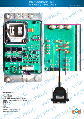

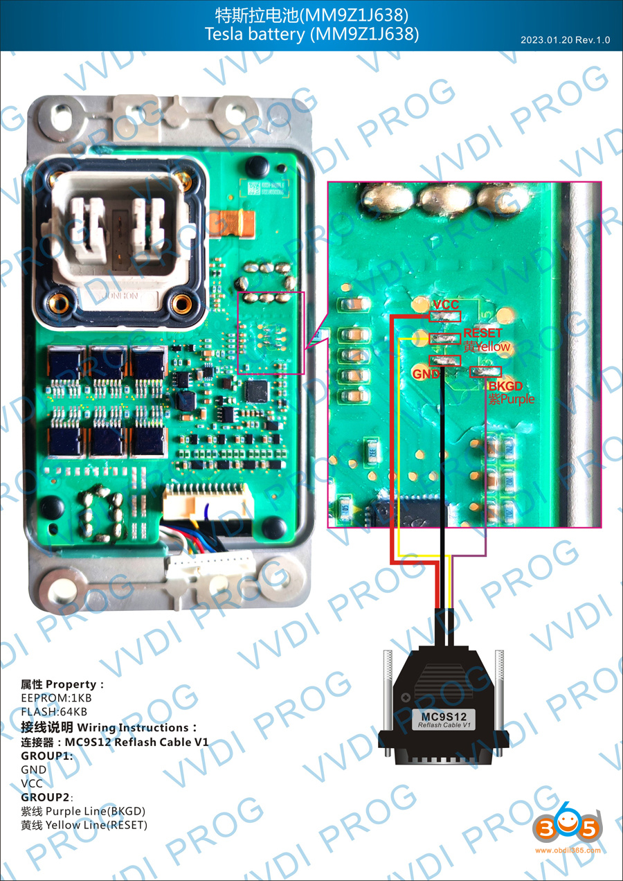

how to reflash with vvdi prog http://blog.obdii365.com/2024/07/21/rep ... vvdi-prog/
okay so we have vcc, gnd, sdc and scl connections on the board it looks like
so would be as simple as pushing "clean" firmware on the battery. dump the eeprom from a "good" battery, upload to a "bad" one?

Well as soon as my posts will be shown I think, I’ll add addresses in eeprom which should be zeroed to removeverror

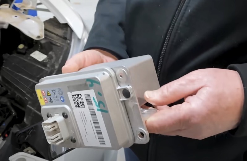

Are people finding these for cheap somewhere? I looked on some wreckers sites and the few I found were pretty expensive - perhaps more than a new off the shelf LiFe battery?

yes. online wrecks have no idea what they are posting. ones that are in good working order i have found for 150 $ online, but ones that need eeprom cleand from wreckers for cheap

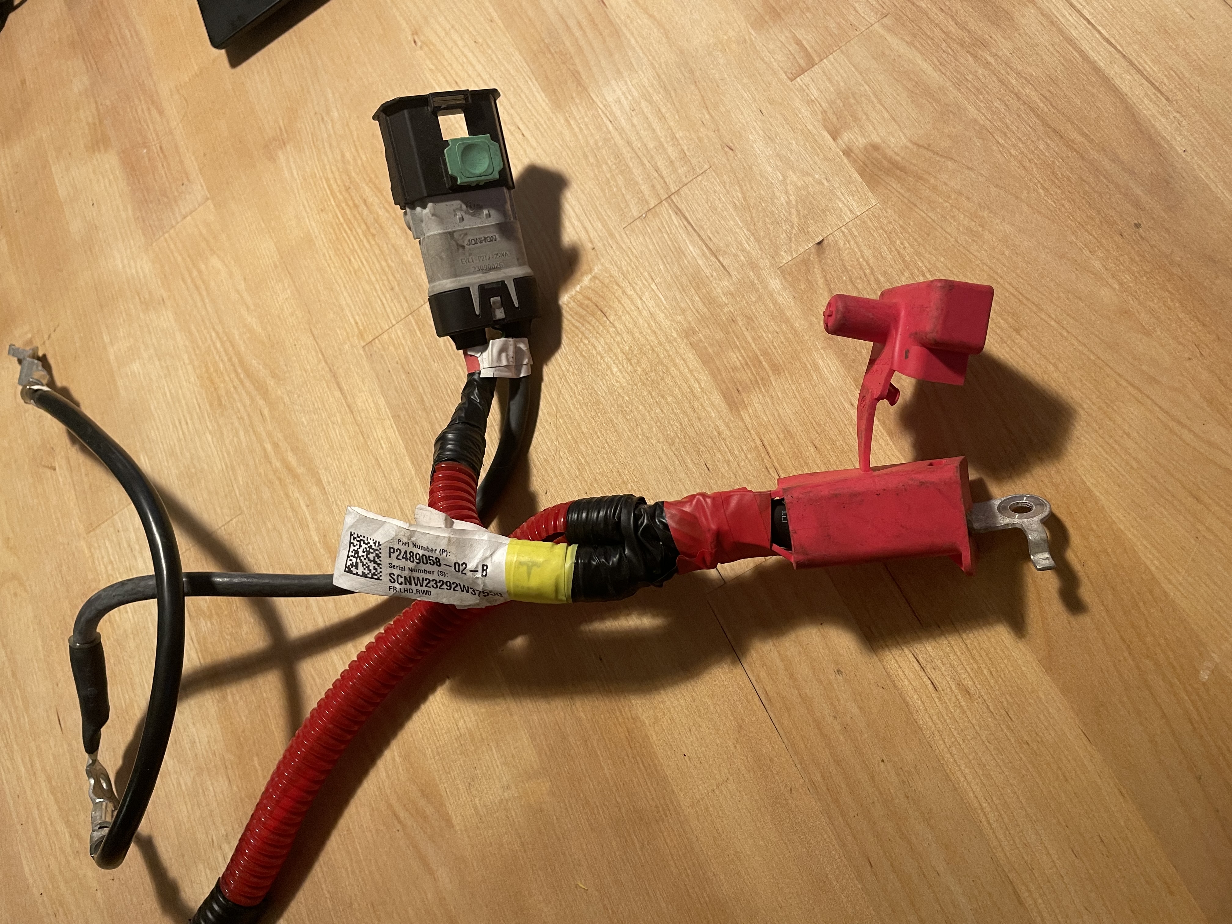

Picked up the 16v battery cable harness from a model y,
tesla service docs pleasantly have the parts numbers for the pins:
https://service.tesla.com/docs/ModelX/E ... ctor/x001/
housing:
EVL1-P2TJ-25WA
current pins:
85562302-01
signal/ linbus pin:
857111838-01
currently no lucky on sourcing them, EVL1 is not even a product line publicly shown for jonhon
the connector is a jonhon EVL1-P2TJ-25WAtesla service docs pleasantly have the parts numbers for the pins:
housing:
EVL1-P2TJ-25WA
current pins:
85562302-01
signal/ linbus pin:
857111838-01

You need external programmer, I use VVDI2. And after you read dump, I can help you clear it.

Re: Tesla 12v/16v li-ion battery
yes that is clear, seeing if there is more generic options available. i should have my hands on a battery soon.dimonlipko wrote: ↑Tue Jan 14, 2025 9:08 pm You need external programmer, I use VVDI2. And after you read dump, I can help you clear it.
cheers, right being a S12Z processor, did you use the following?:
https://www.nxp.com/products/processors ... :PROGS12ZZ
Yep. Used that... I don't have my writing still, but as i remember errors could be reset by FF'ing eeprom addresses from zero to 320, but of course you should precharge it's elements...

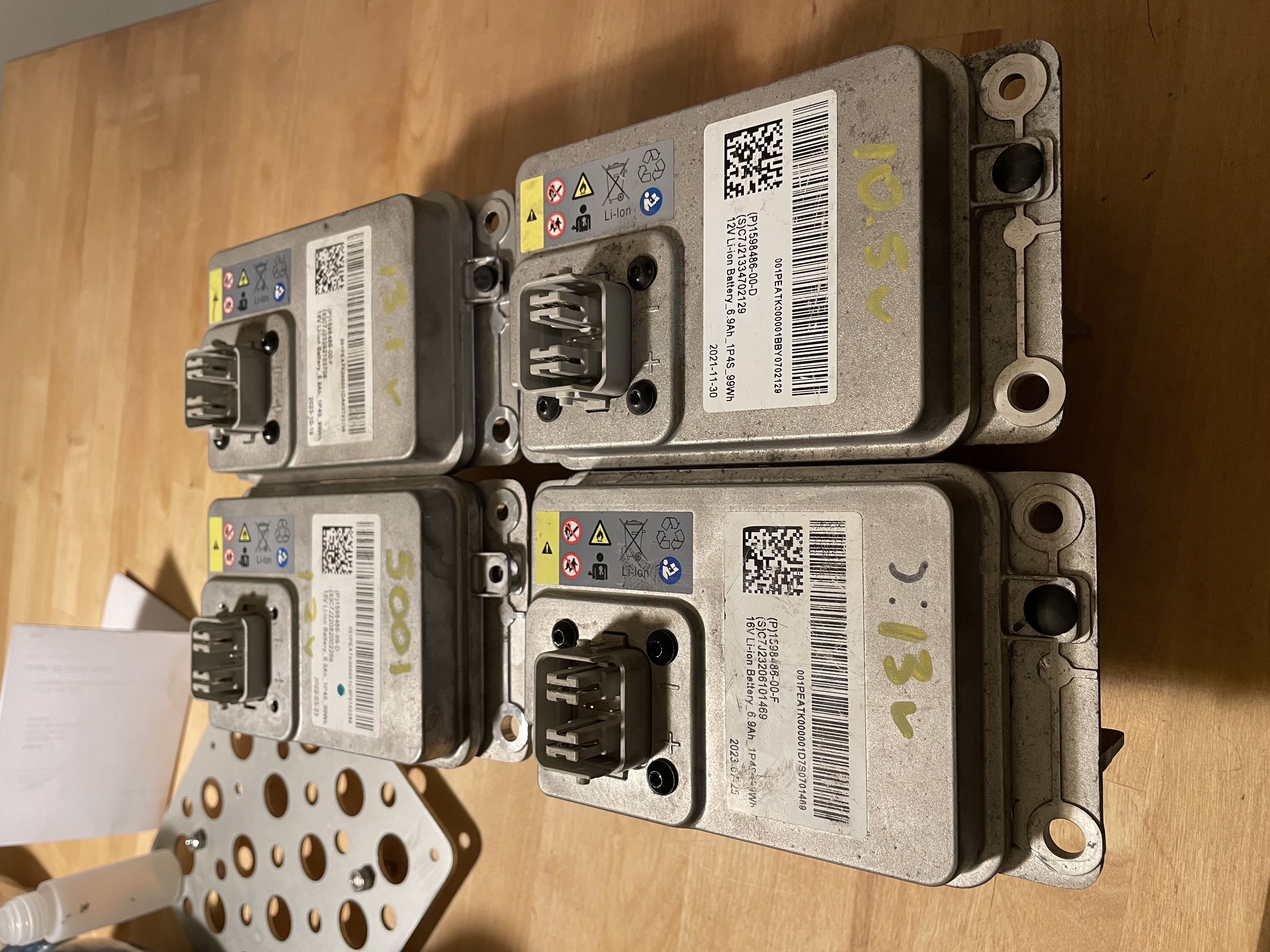

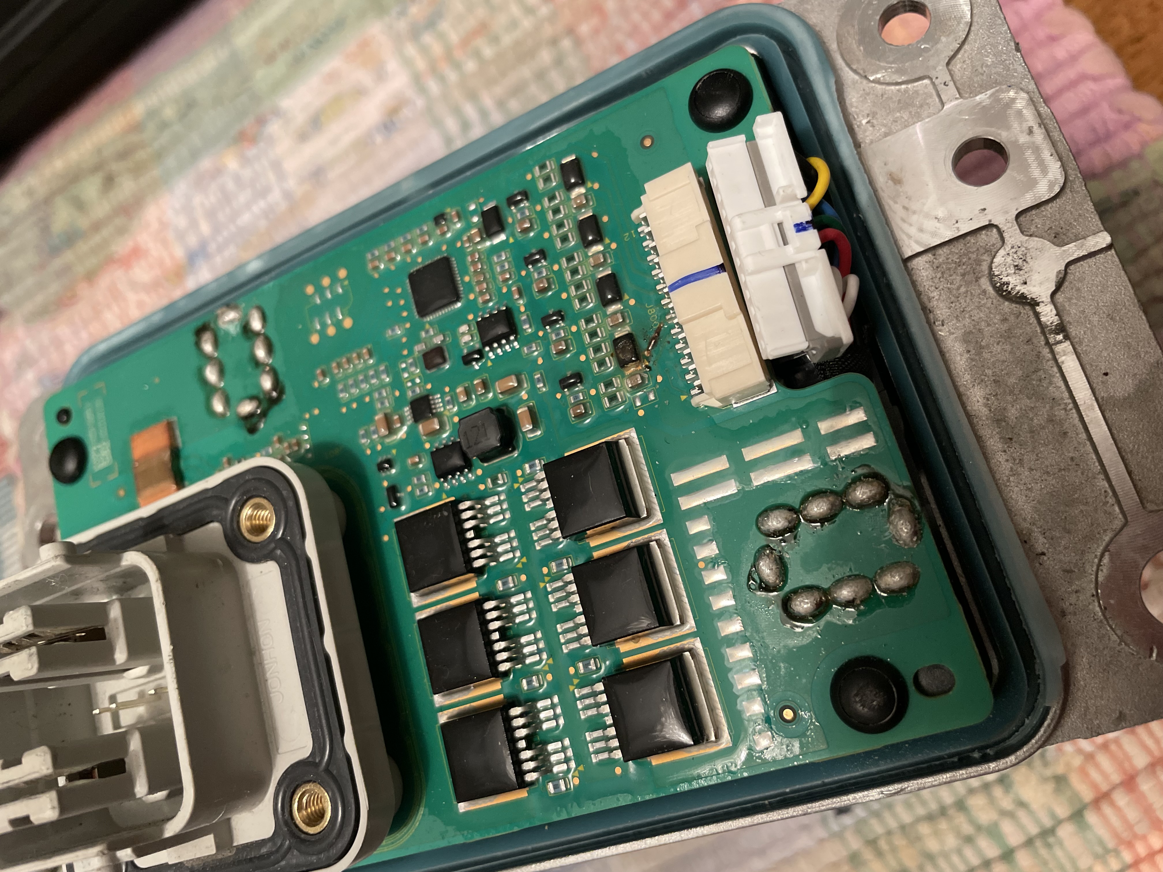

Very special eBay deal later….i have 4 sitting on my desk.
they had already opened the dead one. Looks like they burnt a trace and possibly a diod? Unpluged the bms, and trickle charged it at 0.1amp in till 9v then slowly increase current to no more than 2 amps. it been sitting for days and holding at 16v. each cell in is perfectly in balance.
I DO NOT RECOMMEND THIS, anything below 9v should be considered worthless. The cells are potentially damaged, it is not worth the risk.
But for testing and reverse engineering this should be "okay"
When the bms is plugged back in, it dosnt take long befor it starts to self drain through the bleed resistors, so this should be in a lockout, safety state.
Prefect we have some diversity in our eeprom memory
notice all the residual flux on the cell tabs? thats how them come from factory. all of them are like that
the nxp u-multilink debug probe is around 450$cad. pricey.
UBSDM flash programmers:
https://usbdm.sourceforge.io/USBDM_V4.1 ... index.html
3 read 12v or more, and 1 below 2v.they had already opened the dead one. Looks like they burnt a trace and possibly a diod? Unpluged the bms, and trickle charged it at 0.1amp in till 9v then slowly increase current to no more than 2 amps. it been sitting for days and holding at 16v. each cell in is perfectly in balance.
