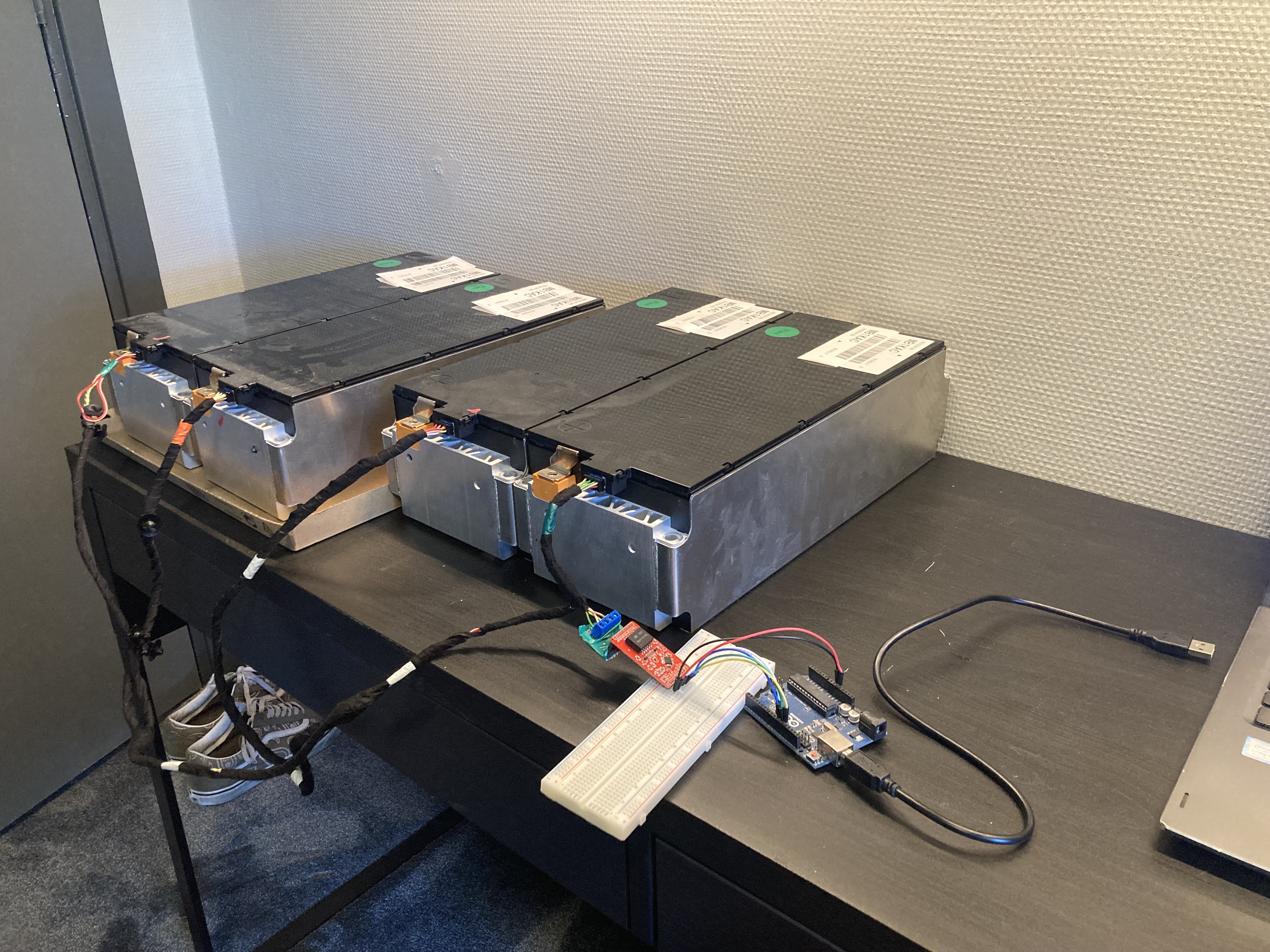

After removing all lifepo4 cells I got the car moving on 4 opel corsa modules https://youtu.be/YooQENT02AY.
I decided to remove the old diesel tank and create another battery box underneath the rear seats. I will place 4 of the 16 modules in the new box and there should be enough space left to place all contactors, bms and charger.
I'm using the existing bms boards in the modules to read out cell voltages and for balancing. I recently got the communication working with clanarn's pcb. see viewtopic.php?t=2181.

Batteries
The batteries are bolted to the battery boxes with M8 all thread. I designed some plates that go between the rods to stiffen it up.
BMS
The battery modules have built in bms functionality. I decided to design a main board for this bms system based on stm32 and max17841b.
Because the battery pack consists of four parallel strings of four modules I want to monitor the current flowing through each path. So my bms main board was designed to read out four Tamura L03S600D15. The board also has 8 drv103 contactor driving circuits on there to be able to fully isolate the four parallel packs. This board definitely needs a V2 and possibly more but it is in some sort of working state. I wrote some code for it to check if everything is safe and close the contactors.
