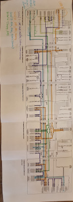

Definitely good idea to snoop the GMLAN networks. I printed and highlighted the network diagram from the 2017 manual to help me get familiar. I did a bit of work this weekend, I'll write up some more detail this week.

mobythevan wrote: Mon Feb 10, 2025 4:03 pm Definitely good idea to snoop the GMLAN networks.
yeah i dont see the bolt having any vin pairing, and based off the volt stuff i snooped through, i dont see it being overly complicated messages required. maybe some crc and timers. if you can do a can sniff with savvy can, and dump, chances are the forum will have it figured out pretty quick

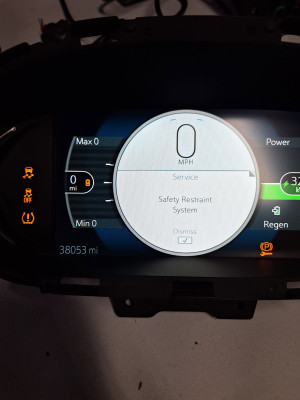

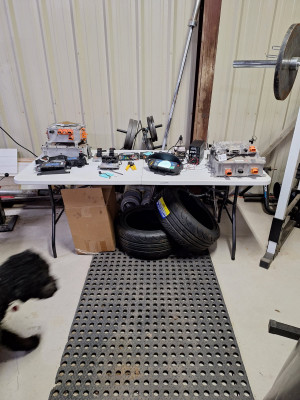

Well I went down what seems to be one dead end path, but it was good to learn. Purchased a usbjtag nt link thinking I could simply pull binaries from the ECM, VICM and PCM. Turns out that the ECM and PCM both have the MPC5676R which is well documented and easy to find the JTAG pins on the boards, but it is a password protected chip. If you look around a little you can find that side band attack can be used to bypass the password which also echoes it out so you have it( and seems to be random unique for each chip, not just one password for all). That doesn't seem worth hobby level swapping so I'm fully moved to CAN bus decoding now. It was interesting though because it taught me about Ghidra and a few other tools.
Right now I have connected the ECM and VICM CAN bus and powered up to dump the list of DTCs from HP Tuner. Its quite a long list, lol. Next step is add the motor control module and put that list up here as its the starting point of what the 3 computers need if we want to swap a bolt motor but use some other battery.
Got a Canable 2.0 and set it up on my shop laptop on the Ubuntu side with Savvy CAN. Connected it and verified it captures logs from the ECM-VICM bus. Have not set up anything to decode GM Lan yet.
