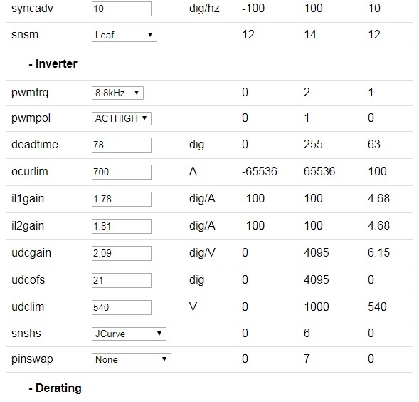

Below is a video of the results after several months work
Why the engine has only one speed ?
Why gate driver consume 0.4A ? Is the value correct ?
Resolver consume 0,04A , Is the value correct ?
Should I increase the voltage from 28 V to 52V for IGBT inputs ?
Parameters below
Parameters below

I can't really tell from the video but do you have a DC link capacitor on the igbts? Please do so if not as without this you run the risk of blowing the power stage.
kiwifiat
- Posts: 101
- Location: Vancouver, Canada
- Been thanked: 12 times
Re: Problems during starting Main Board V3
Your syncofs is set to 0. Did you go through the proceedure for determining the correct value? The motor will not run optimally if you don't.
I did not change something while connecting resolver or phase wires, only Gate Drivers began to take more current.
I have several first generation inverters after bathe in the ocean, so only: IGBT, current sensors, capacitors, power rails, housing are good.
The producer assured me that it would work, I will buy an inverter as a last resort because it's expensive, but let's go to the problem.
1. General Device Status:
- DESAT (HV) connected to 5V
- 12V, RESERVED, IN_FWD, IN_MPROT (HW), IN_START connected to 12V
- resolver connected without calibration, because I have stoped in this place
- current sensors, voltage sensor, two channel acceleration pedal calibrated
- I uploaded the parameters for Nissan Leaf from Mr. Johannes website, I changed only pwmpol = 0 = active high because I use Gate Driver from Mr. Johannes
2. Current Errors:
During Run Mode During OFF and in next step Run Mode (Current channel 1 or 2, respectively, is below 1.23 or above 2.06V when no current is flowing. Check wiring and voltage dividers)
I made measurements on Main Board V3:
IL_1 - 1,628 V
IL_2 - 1,639 V
So Why I have errors ? I don't understand.
3. I think that Gate Drivers are broken, Can you confirm my guess ?
Because:
- PWM and IGBT are ok
- The input signal to the Gate Driver does not match the output signal (Please look at the pictures of measurements below)
- The first Gate Driver take 0,6A during work - manualid 0,05
- The second Gate Driver take 0,3A during work - manualid 0,05
- The third Gate Driver take 0,6A during work - manualid 0,05
- Gate Driver at rest take 0,3A each one separately

The parameters are on the first page
When I swapped the motor wires physically, engine started working
I connected as follows:
Engine U - L3 - PWM3
Engine V - L2 - PWM2
Engine W - L1- PWM1
Why ?
Below is a photo of the readings Why the current on L1 = L2 = L3 = 80A (hot wires) is so high when the supply current = 14A ?
Maybe after calibration at 400V and high current everything will be good ?
(Of course, with the engine in the car and cooling and thick wires)
What is the rated current and max current for the leaf motor ?

Well first: congratulations
The phase order is weird, is pinswap still 0?
By "supply current" you mean DC current? Basically the inverter is a buck converter, so output current is always higher than input current.
It looks good to me now. Try to test if you can spin in both directions and it makes the same sound.
The phase order is weird, is pinswap still 0 ?
pinswap = none = 0
By "supply current" you mean DC current ?
yes
ok now I understand
yes, I can and sound is the same
