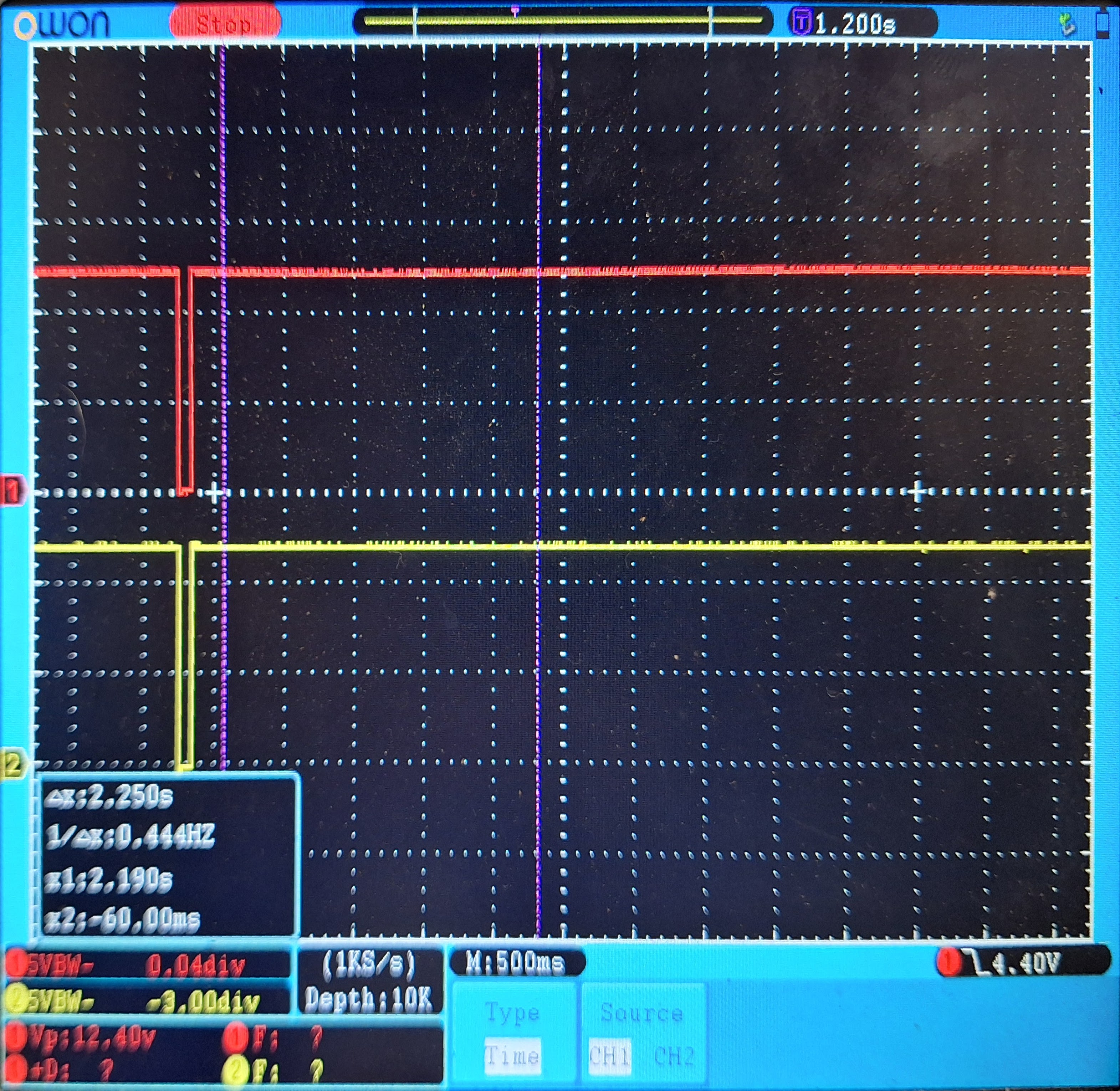

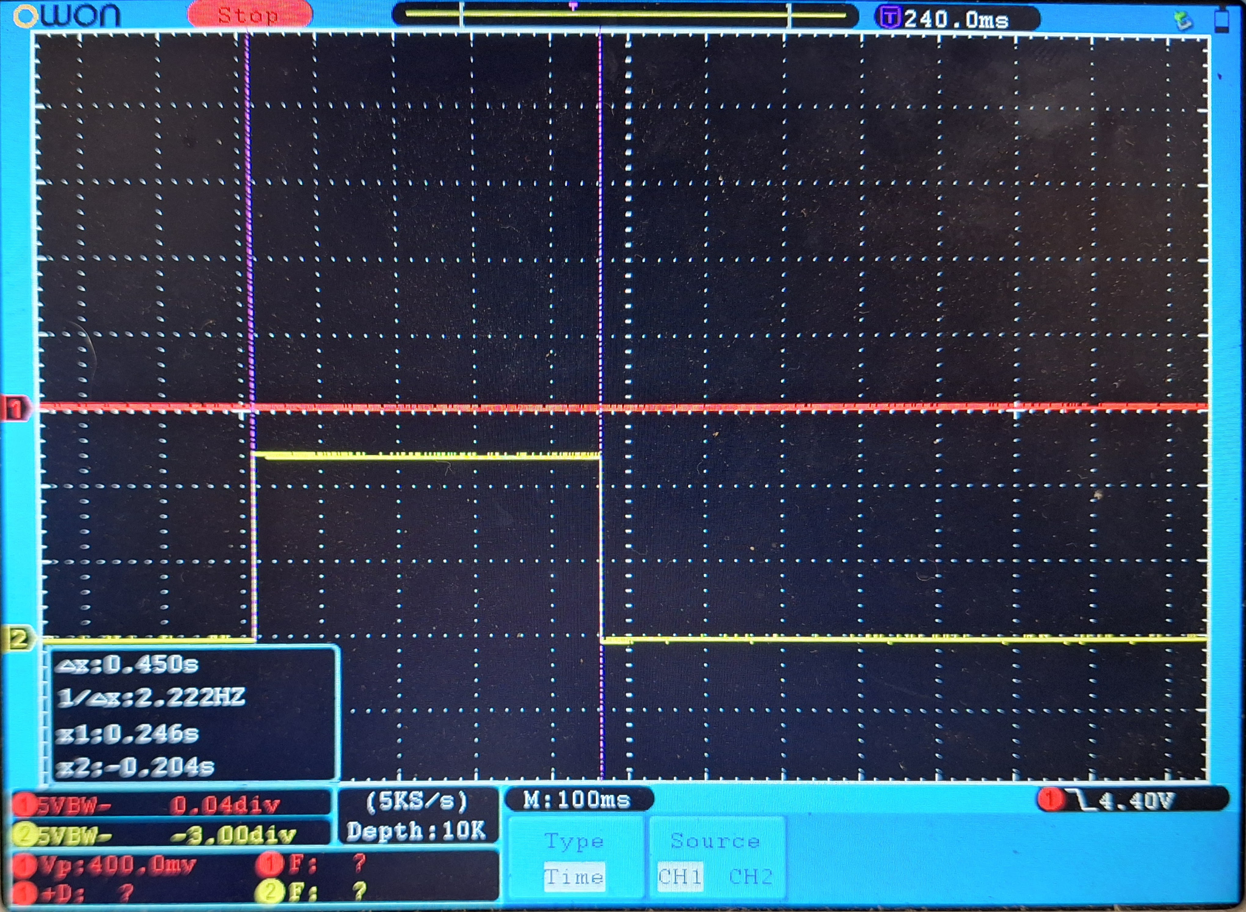

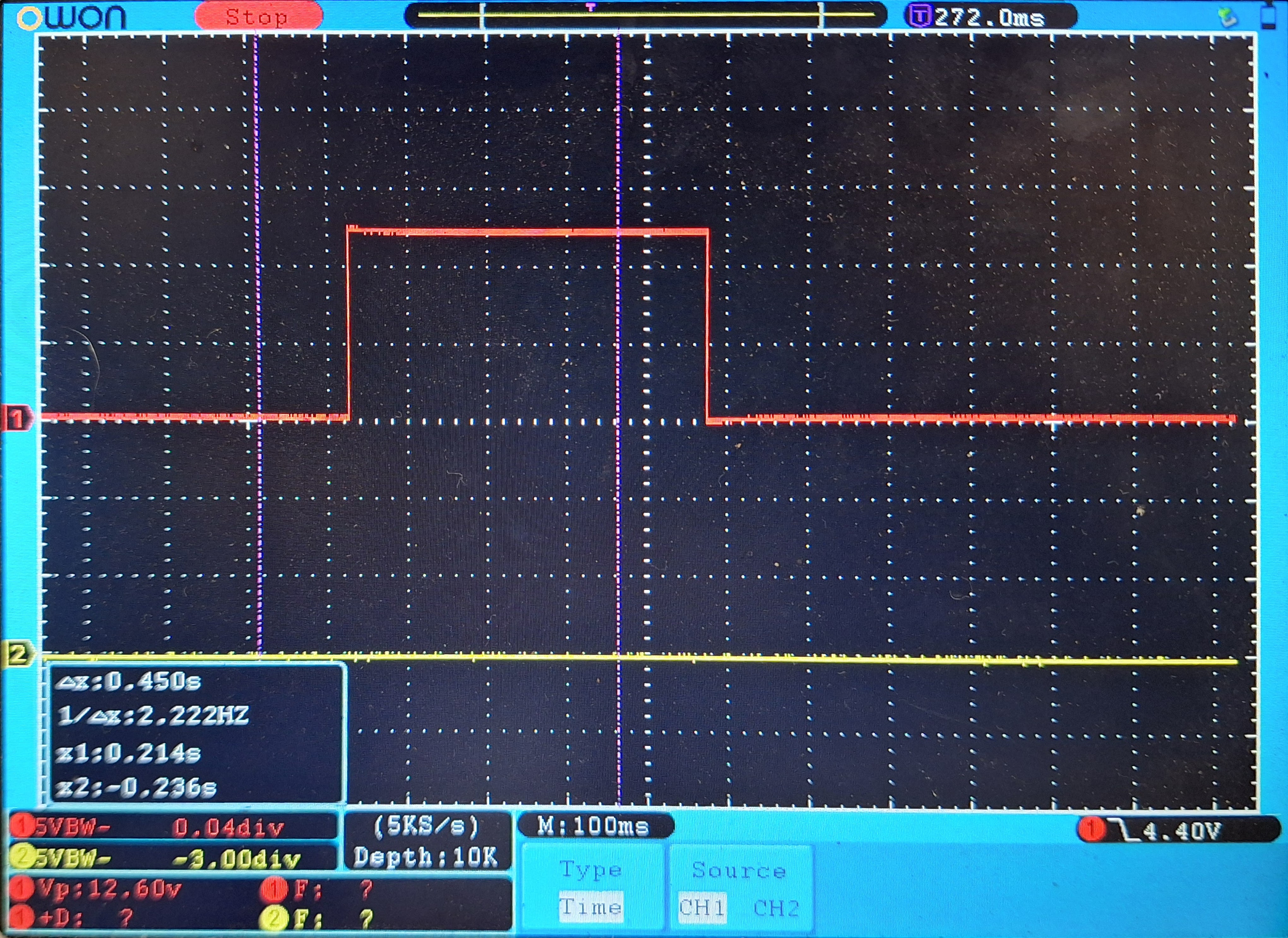

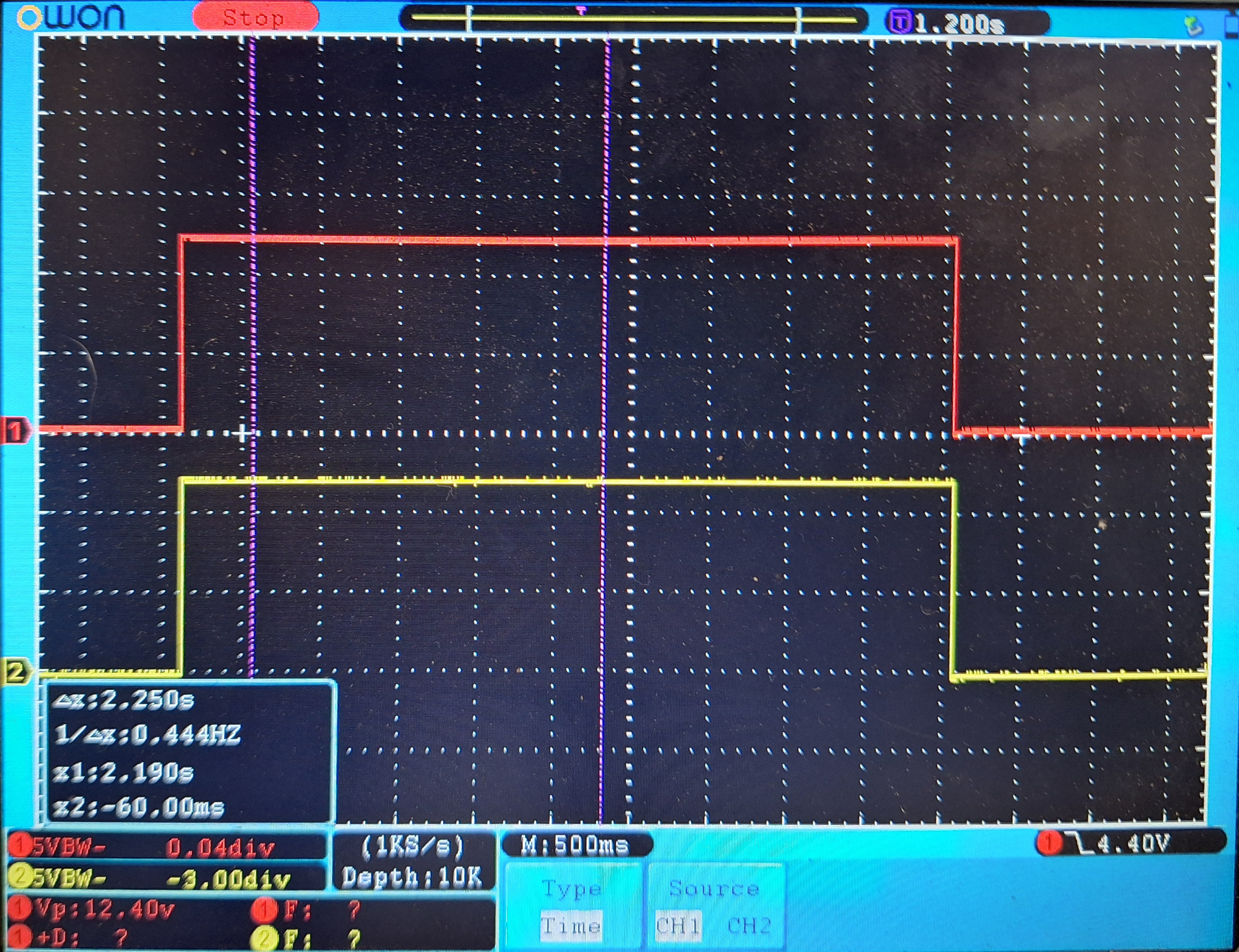

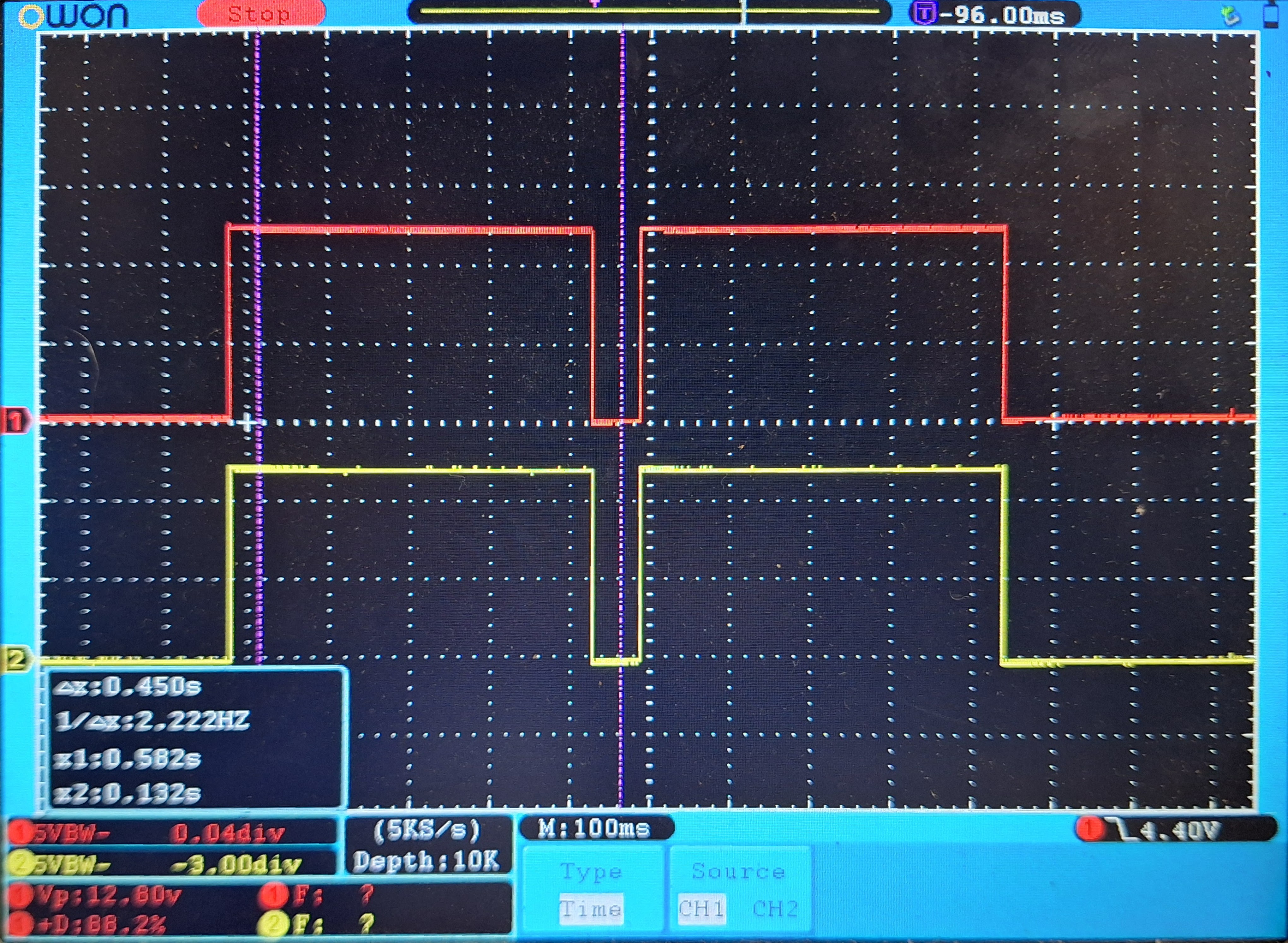

Started to replicate uhi22 steps but no lockmotor action.
Went to test the lock motor. But have some strange results.
On #90 when using the ActuatorTest motor did nothing. So removed the motor, tested it with a 12 battery it worked fine.
Hooked the scope up to the motor outputs from the Foccci and I see strange behaviour.
With LockClosedThresh and LockOpenThresh set to 0. I get this when switching to CloseLock nothing on Open
With LockClosedThresh set to 0 and LockOpenThresh set to 300. I get this Close both high Open both low
With LockClosedThresh set to 300 and LockOpenThresh set to 0. I get this when switching to Close nothing on Open
Change the firmware to #80 and get expected behaviour.

manny wrote: Thu Feb 06, 2025 7:00 pm Hooked the scope up to the motor outputs from the Foccci and I see strange behaviour.
The pictures look like one cable of the motor is not connected or not driven. So on both ends of the motor we see the same voltage. If the cable between the motor and Foccci is not the root cause, we need to check what the driver does. It it possible to hook the scope to pin 1 and pin 2 of the driver IC (IC1, DRV8874)? Normally, to drive the motor, one of the pins should be high and the other low. I see no obvious reason in the software, that this control does not work.
When LockOpenThresh and LockClosedThresh are different, then just the timing changes, because the software considers the feedback, instead of using the fix control time LockRunTime. And if the feedback says that the target position is reached, the control stops. So changing the type of motor between "without feedback" and "with feedback" does not help to fix the issue in the control path. We need to find out, why both motor lines go to high when trying to turn the motor.
We could change LockDuty from 100% to lets say 50% to get PWM control of the lock motor, this could help to see on the scope which line is driven in which way.

The scope shot where taken with the motor disconnected and a channel connected to each of the motor leeds from Foccci.
uhi22 wrote: Fri Feb 07, 2025 7:37 am When LockOpenThresh and LockClosedThresh are different, then just the timing changes, because the software considers the feedback, instead of using the fix control time LockRunTime
A yes this makes sense.
uhi22 wrote: Fri Feb 07, 2025 7:37 am It it possible to hook the scope to pin 1 and pin 2 of the driver IC (IC1, DRV8874)? Normally, to drive the motor, one of the pins should be high and the other low.
Yes will do some tests.
uhi22 wrote: Fri Feb 07, 2025 7:37 am We could change LockDuty from 100% to lets say 50% to get PWM control of the lock motor, this could help to see on the scope which line is driven in which way
Will do

Oops, found something. 50 is the new 100. I tested yesterday with LockDuty 30%, this worked perfect (always software #90). Just measured the inputs and outputs of the driver, they show PWM, with different duty cycles on both pins, and depending on the lock/unlock direction. Fine, so far, at least if not looking too much into details ;-/
Increasing the LockDuty to 100%, I see the issue: Both lines are controlled to 100% high, no matter of the intended control direction.
Setting LockDuty to 50% seems to be what we wanted with 100%.
So recommendation for the moment: Set LockDuty to something in 30% to 50% range. And we need to understand the PWM ratio calculation and fix this in Foccci.
Edit: The calculation of the pwm based on LockDuty was 50% off.
Fix: https://github.com/uhi22/ccs32clara/com ... c2d3e2d60f
New software #91: https://github.com/uhi22/ccs32clara/act ... 3195982499
