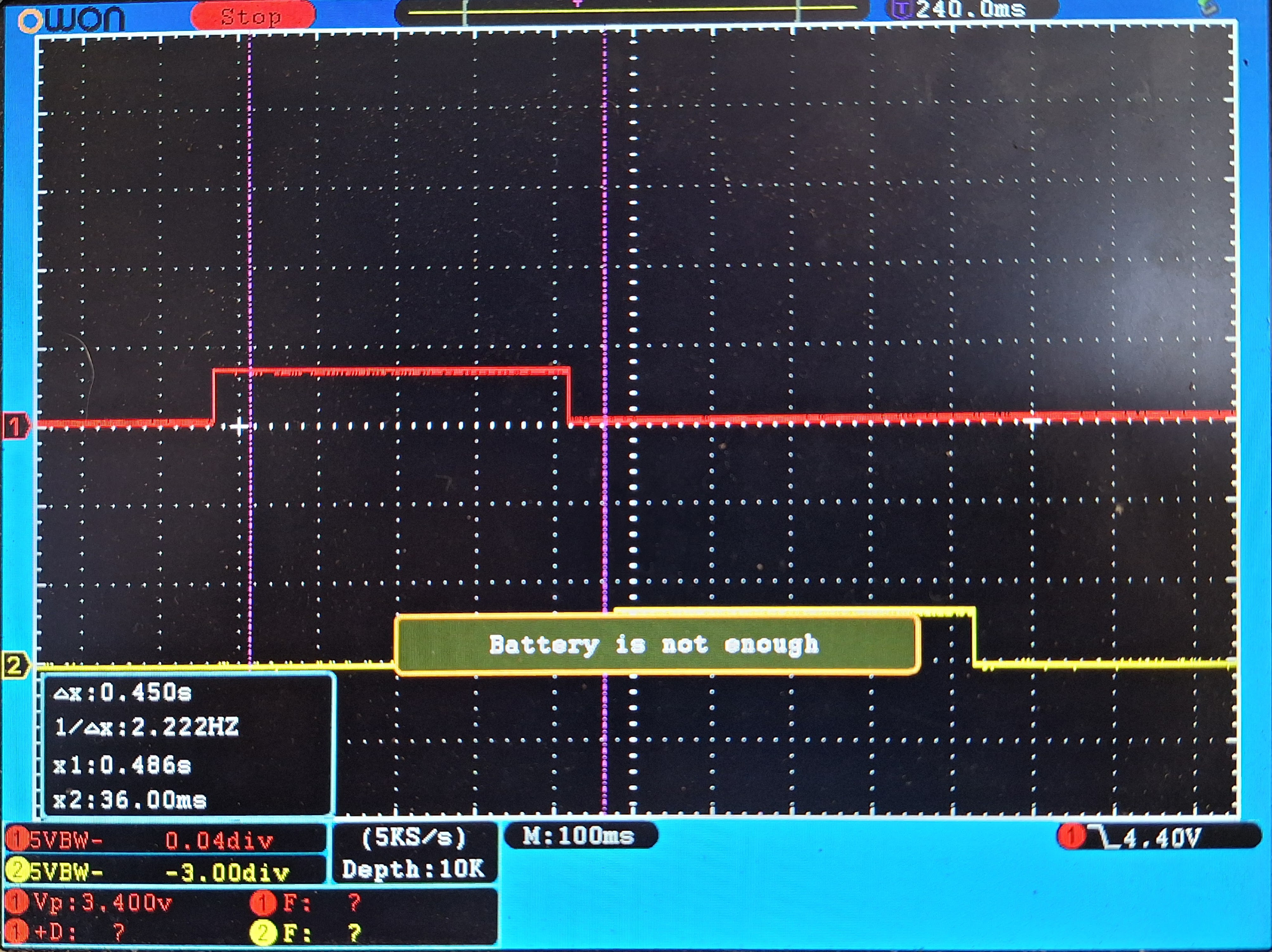

Yes can confirm this. on 50% no pwm on 30% there is pwm.
Is it normal that when selecting ActuatorTest closed the lock cycles. so lock en than unlock. and after that ActuatorTest unlock does nothing.
this is @ 50%
Sorry for the battery warning.

Well, from users perspective this is indeed strange. The reason is, that the actuator test stops itself when it triggered the locking, and then the application comes and sees "oh, it is locked, and the AcObcState demands IDLE, so let's unlock". From my point of view there is a little bit more decoupling needed between the actuator test and the application, so that the tests for locking and unlocking are performed no matter what the application wants.

The last time I tested the ActuatorTest wasn't disturbed as long as no cable is plugged in. So testing "Lock" locks it and only testing "Unlock" unlocks it. As soon as you plug in a cable the application logic takes over. Can you check that?
EDIT: nevermind, genius here added some new logic to allow charging again without power cycle:
And that always operates the lock even with nothing plugged in.
Without this code stateC can get stuck on (in standalone mode) and some chargers don't like going straight to stateC. But maybe the lock doesn't need to be unlocked again and always...
//Not Plugged in and no CCS going (just to make sure we don't interfere with CCS if PP is not connected)
else if (!Param::GetBool(Param::PlugPresent) && Param::GetInt(Param::opmode) == 0)
hardwareInterface_setStateB();
Param::SetInt(Param::PortState, PS_IDLE);
if (Param::GetInt(Param::LockState) == LOCK_CLOSED) //always unlock when nothing is plugged in
hardwareInterface_triggerConnectorUnlocking();
}Without this code stateC can get stuck on (in standalone mode) and some chargers don't like going straight to stateC. But maybe the lock doesn't need to be unlocked again and always...

I think I will change the "nothing plugged in" action to edge triggered so it fires only once when someone without lock just unplugs.
Right now it also inhbits the stateC test I guess
