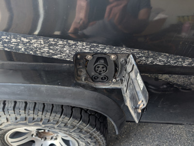

I did extend the charging connection from the PDM to that gas port but didn't permanently mount it yet since I was going to replace it. I just received a new CCS1 port that I'm going to use to add the Foccci in the future.

The OE Nissan has 2.7Kohm between Proximity and group

I replaced the old extended j1772 port with a Phoenix Contact CCS1 port at the gas fuel door. This fixed the charging issue, which seemed to be a bad pp line.
