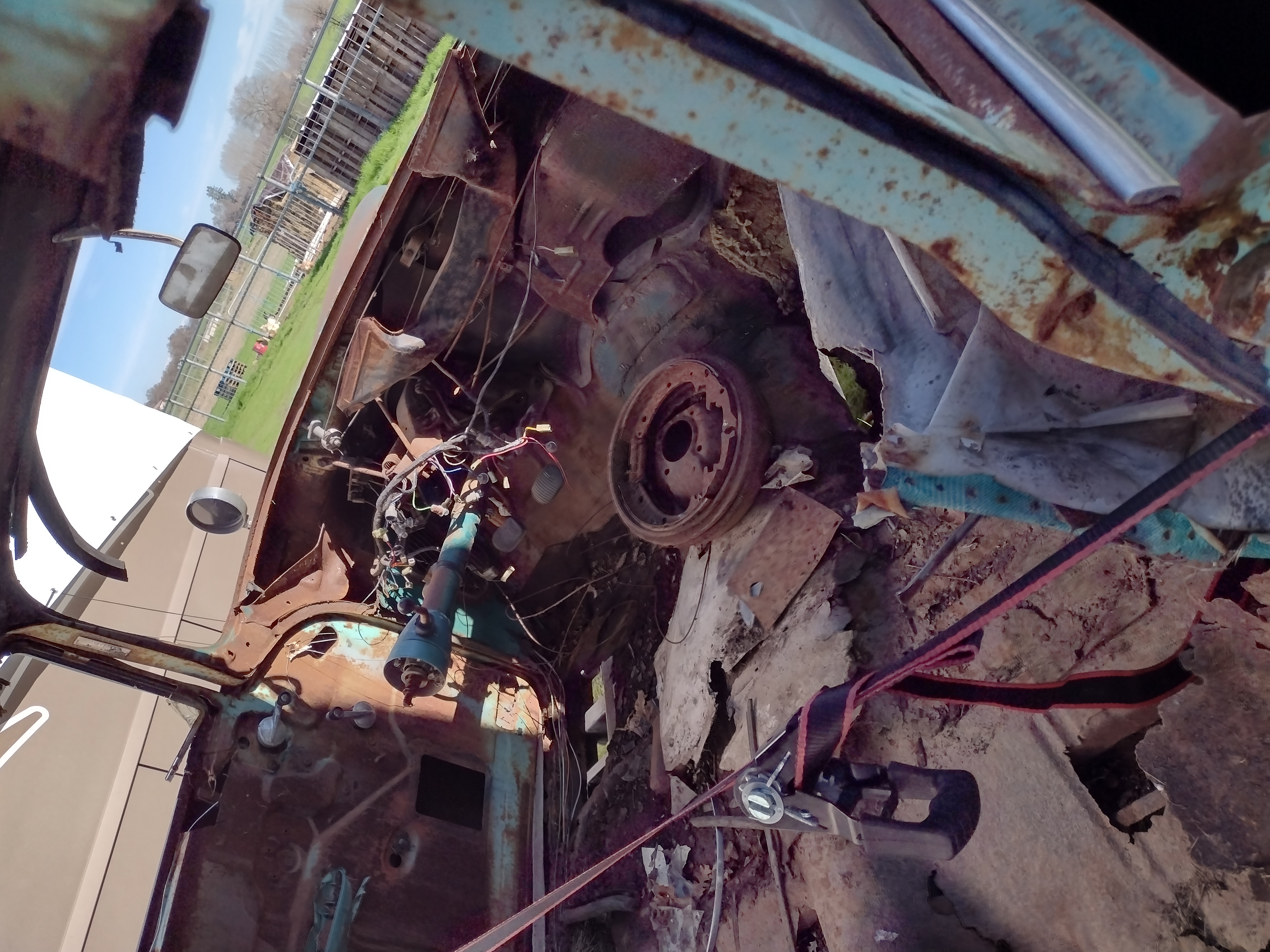

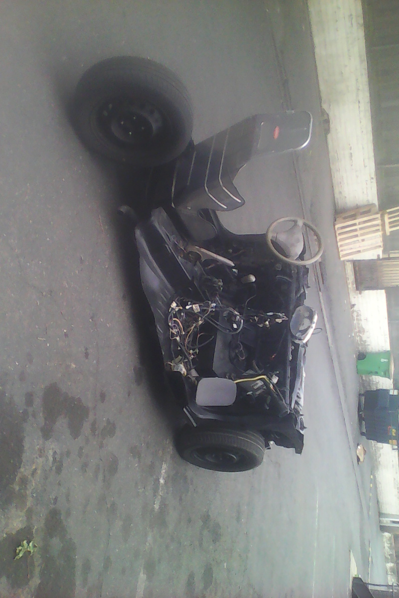

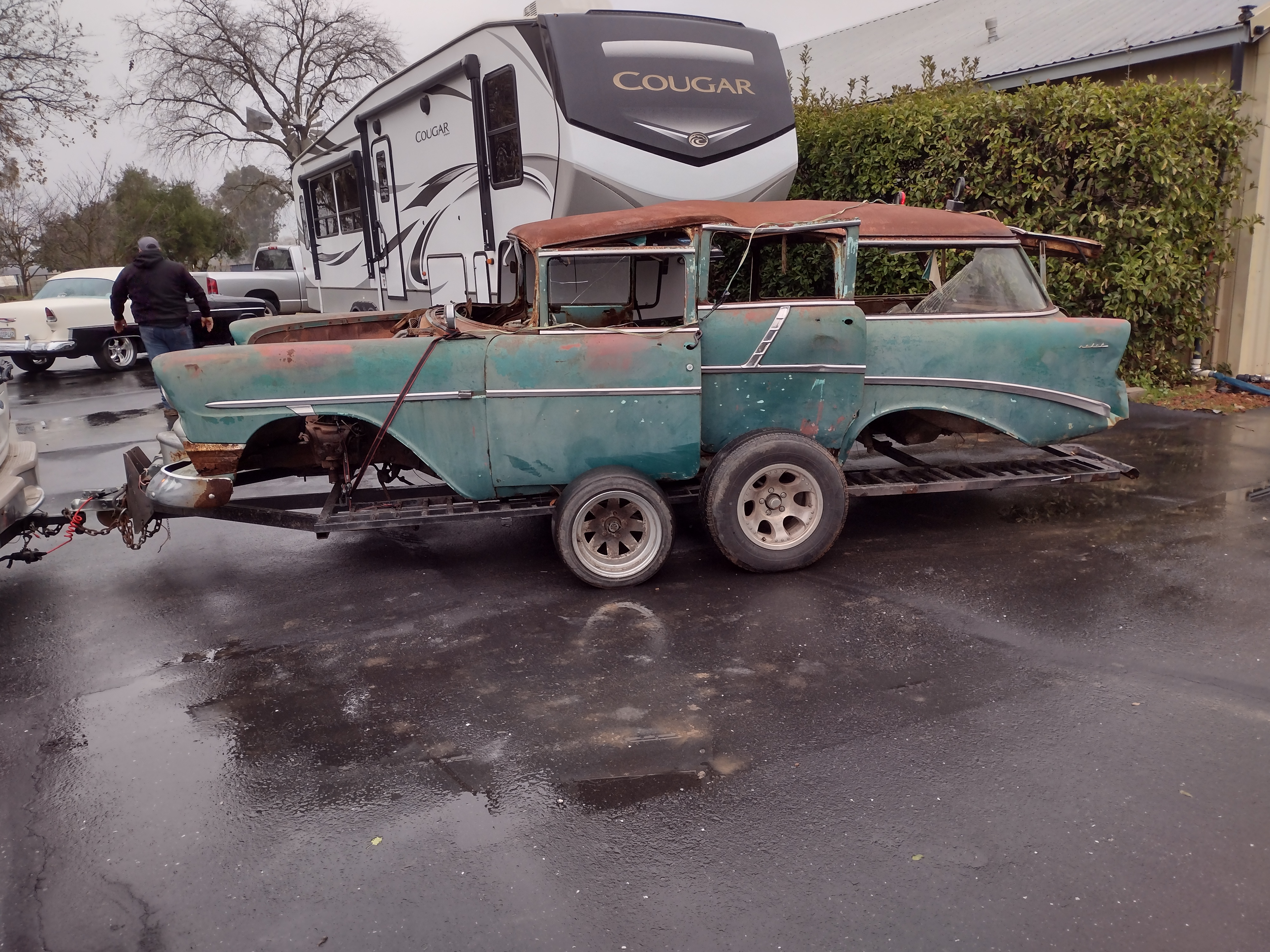

Here are some pics of what I'm starting with and what I want to end up with..note that green car is shortened and chopped and sectioned..or should say the pretty green car. The ugly green car is also somewhat chopped..lol
The car is actually starting out as a 56 4-door wagon that I am modifying to look like a Nomad, as I have a real one and will make fiberglass parts from it, the specific nomad parts are the roof and rear quarters and tailgate, but I will likely make the whole car body parts in fiberglass.

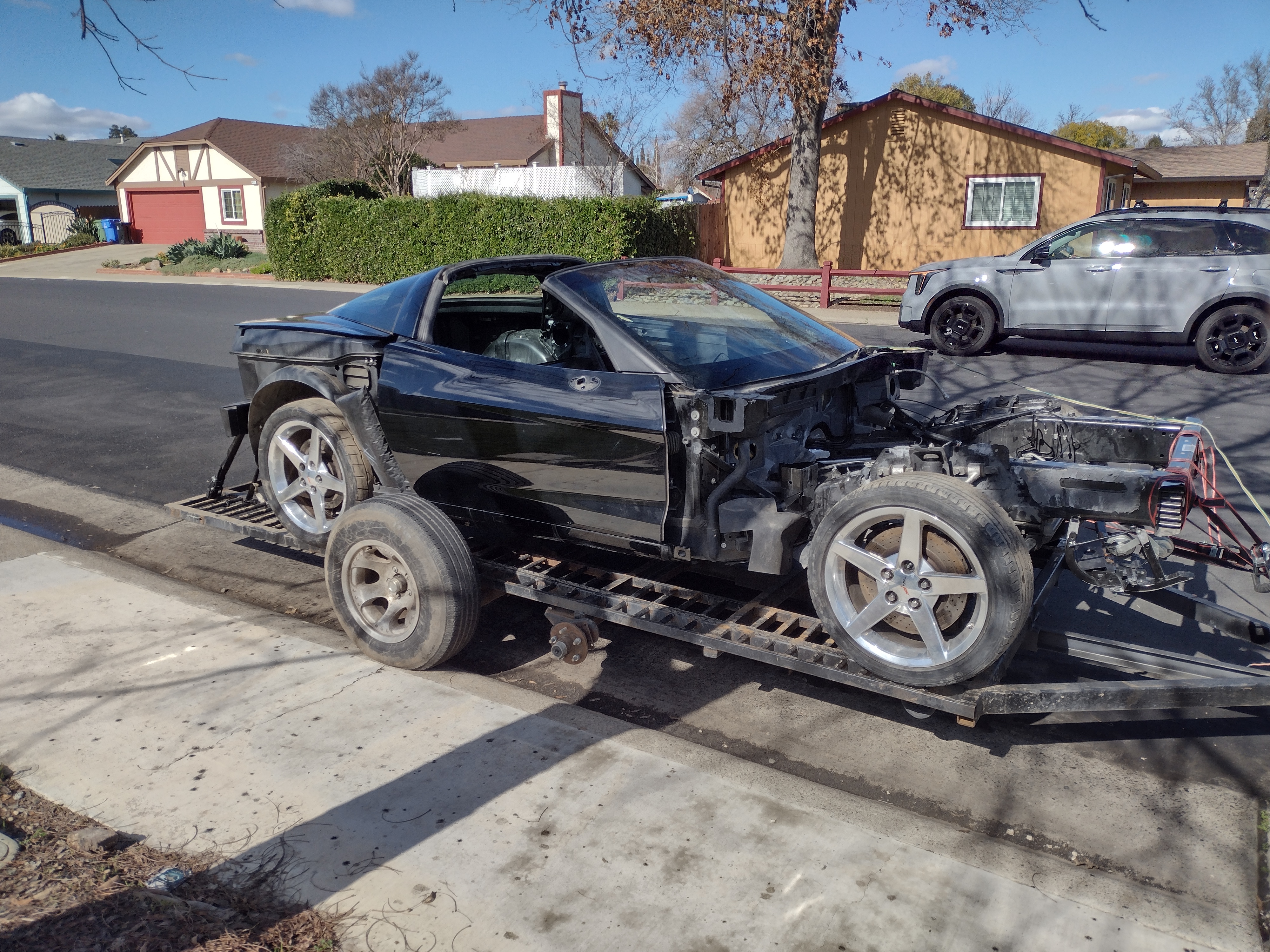

I acquired a 2008 Corvette C6 rolling chassis, could not resist at the price point of $500.

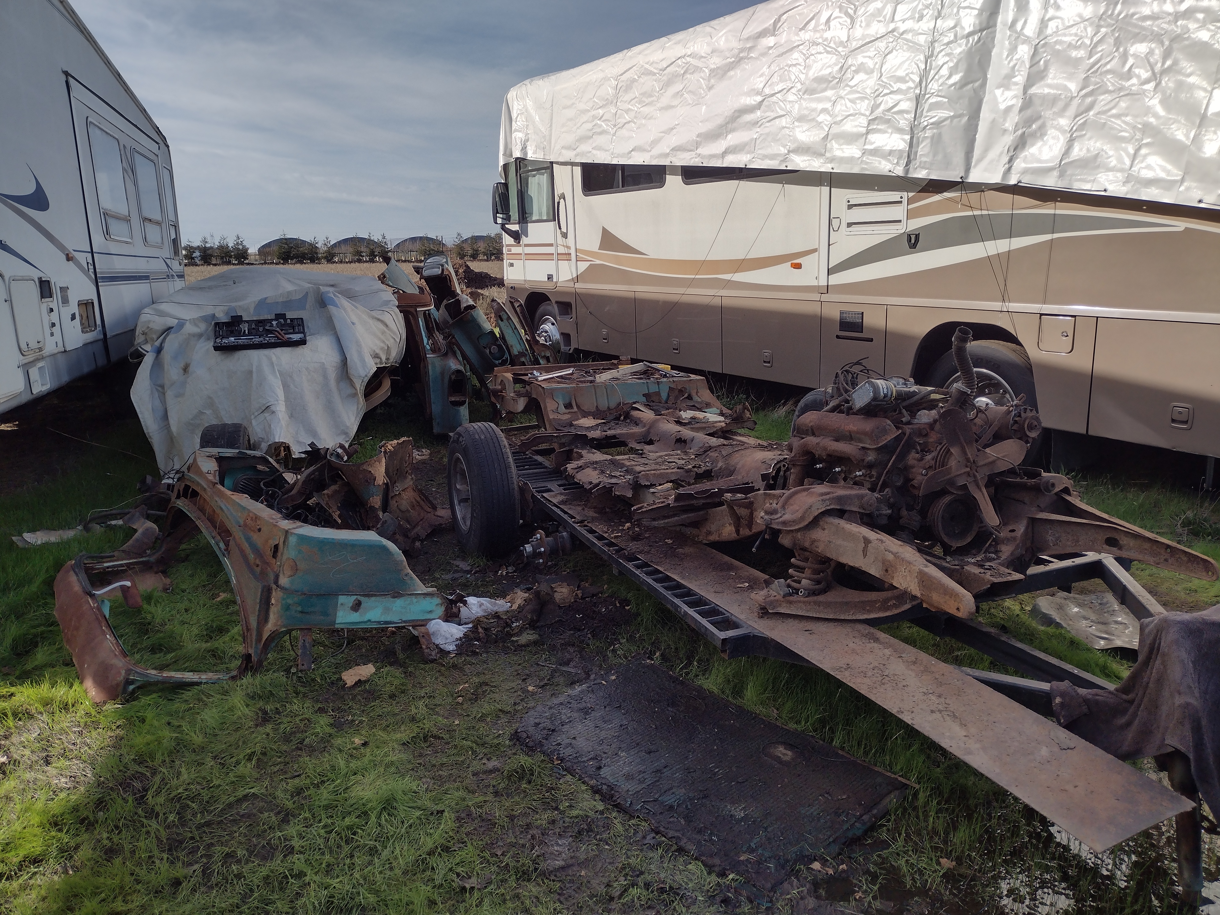

I guess I'd also add that I've chopped all the body parts off the rusted smashed 4 door, that car was about as bad as they get, but it did have a few good parts. I'm driving the 450 miles to southern california from sacramento to get a pair of 2-door hardtop fiberglass "race" doors. Shipping on anything this large is insane, I also got a 56 chevy windshield for $25, was only a 60 mile drive for that one.
