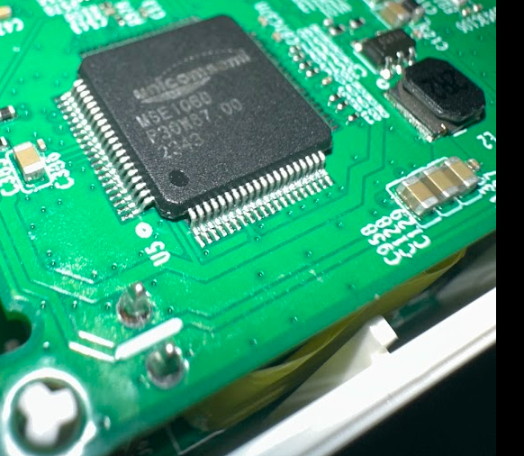

Hi All,
I have bought 2 x TL-PA4010P (UK) devices but it looks like TP link has switched IC's over to unicom semi.
Has anyone had any experience with these?
Main processor is MSE 1060 and the transformer interface is MSEX231.
Regards
Nick
Regards
Nick

Could you share a photo of the name plate, please? There was a similar finding some time ago, cannot find it at the moment.

So for the moment the conclusion is: The version 6 of the TL PA4010 does not fit our needs.
Nevertheless it would be interesting whether it still talks to the Qualcomm tool, or whether it has other possibilities to configure.

Hi all,
So I tried this on a known device with the atheros processor. and I get this.
Before this works though, I need to
sudo ip link set eth1 down
then
sudo ip link set eth1 up
then enter:
~/open-plc-utils-master $ plcstat -t -i eth1
P/L NET TEI ------ MAC ------ ------ BDA ------ TX RX CHIPSET FIRMWARE
LOC CCO 001 C0:4A:00:C6:D8:4C 3C:18:A0:0D:2A:48 n/a n/a QCA7420 MAC-QCA7420-1.1.0.844-01-20120919-FINAL
When I try this on the unicomsemi equipped plug i get nothing returned:
~/open-plc-utils-master $ sudo ip link set eth1 down
~/open-plc-utils-master $ sudo ip link set eth1 up

Summary: The version 6 of the TL-PA4010 does not fit our needs. It is not configurable via the Qualcom open-plc-utils.
Added this hint to the description on github, https://github.com/uhi22/pyPLC/blob/mas ... a4010p-v60

Wanting to join in on this experiment I bought the Australian TL-PL4010 version 4.
It appears to have the same chip set as the UK version 6.
yes, I have mentioned this problem in the issues on pyPLC github. So the EU version (V6) comes with Vertexcom (unicomsemi) MSE 1060 chip. You cannot find any information about these chip, becuse it is designed for a specific customer (maybe this is TP-Link) and NDA is required to get more information. I stopped the process here, I haven't signed any NDA.
