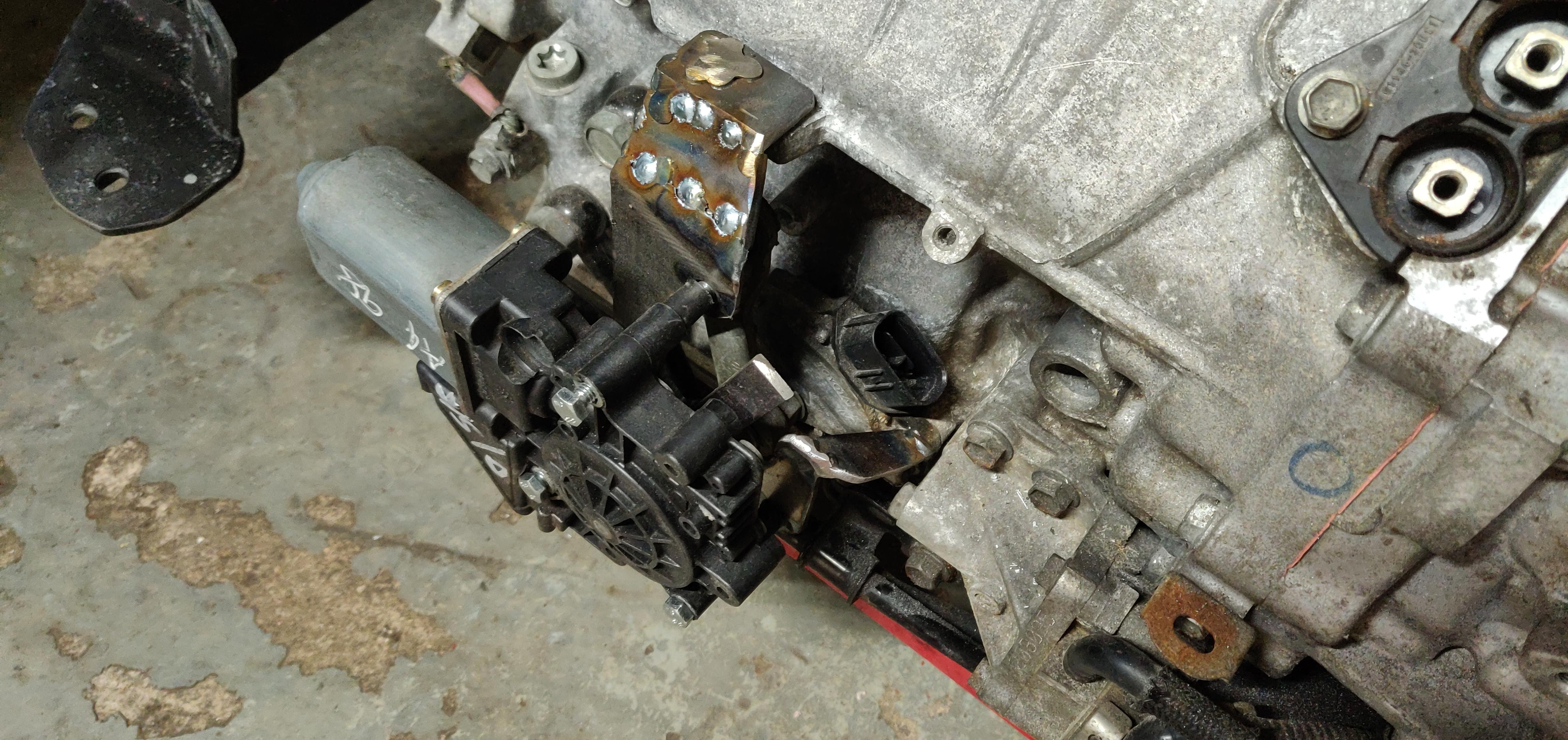

I've been running zombieverter with Gs450h and it's a beautiful setup.. Thanks to Damien,Tom and everyone else involved.. I recently changed the manual parking lever intergrated in the motor and now using BMW F30 lever.. I was wondering if theres anyone who has already intergrated the electric parking brake actuator for the Lexus.. My thoughs for engaging the parking is via a servo motor, arduino that reads F30 CAN messages for parking message and possibly reads the Zombie Vcu for motor speed and combination of the brake pedal so as to engage parking.. Wondering if there is someone who has already implemented this and eager to learn and share

I used a window motor from an Audi A4 (cheapest on eBay) connected to where the GS's shift lever used to fit. The PRNDL switch on the side of the gearbox provides feedback telling the motor when to stop turning.
The Audi A4 unit has two relays built in, one for up and one for down, cross wired to provide the two directions. There was also a PCB with various IC's on there, it's likely CAN driven. I ripped out the PCB and drive the relays diretly from digital outputs via a MOSFET and some protection.
If you use a dumb motor then you'd need a H bridge, relays, etc to handle control. Maybe a stepper motor would be a good solution. The window motor was good for me as it comes with a gearbox already and is quite compact. And cheap.
Code is from a larger function but here's what I used. Sorry.

Note that I never used the VCU or the ZombieVerter, those were both forked from my early code (just after I got the inverter working), so I doubt anything I post here would be compatible.
