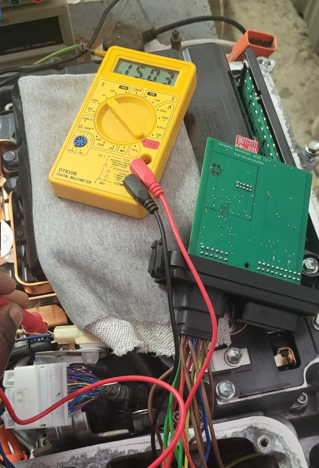

MattsAwesomeStuff wrote: Sun Feb 23, 2025 3:47 am Carefully flip the OI board over. CAREFULLY use a voltmeter or probe pin 28, 29, and 30 (small connector, the row closest to the edge of the board) when you think the inverter is on. See what you get for voltages and or waveforms. Don't slip and short something.
If you've got voltage on those pins, then it's a wiring problem. If you don't have voltage on those pins, then it's an OI hardware or software problem, or some other wires aren't hooked up correctly to allow the OI board to engage, and we'll chase those down next.

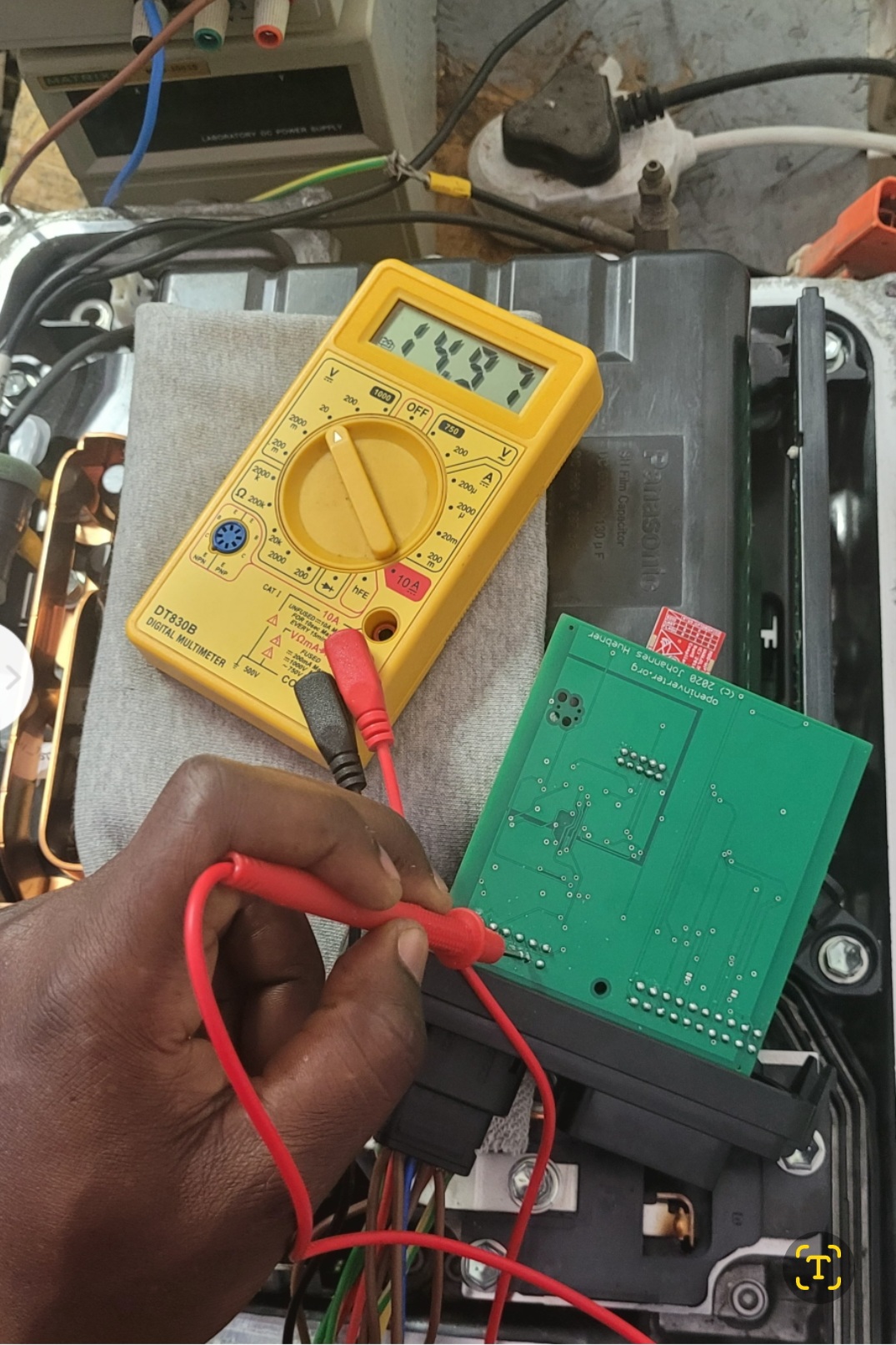

I flipped the board and tested like you said.what I did first was I set my Voltmeter to dc and and first tested pin 19 amd 20 which is "19 battery negative" and "20 battery positive" and I got 12v input and then I move my positive Voltmeter terminal to pins 28 29 amd 30 to see if I get any reading. Why negative terminal was still on pin q9 which is our battery nagative and on doing that, on pins 28,29 and 30 I didn't get any reading.
I also used the scope to check the waveform when I put in the normal settings on the vcu of boost 20000,default forward and manual start ON fslipspnt 1 and ampnom 70. The waveform didn't change, it showed the same waveform I got when I installed power the vcu.

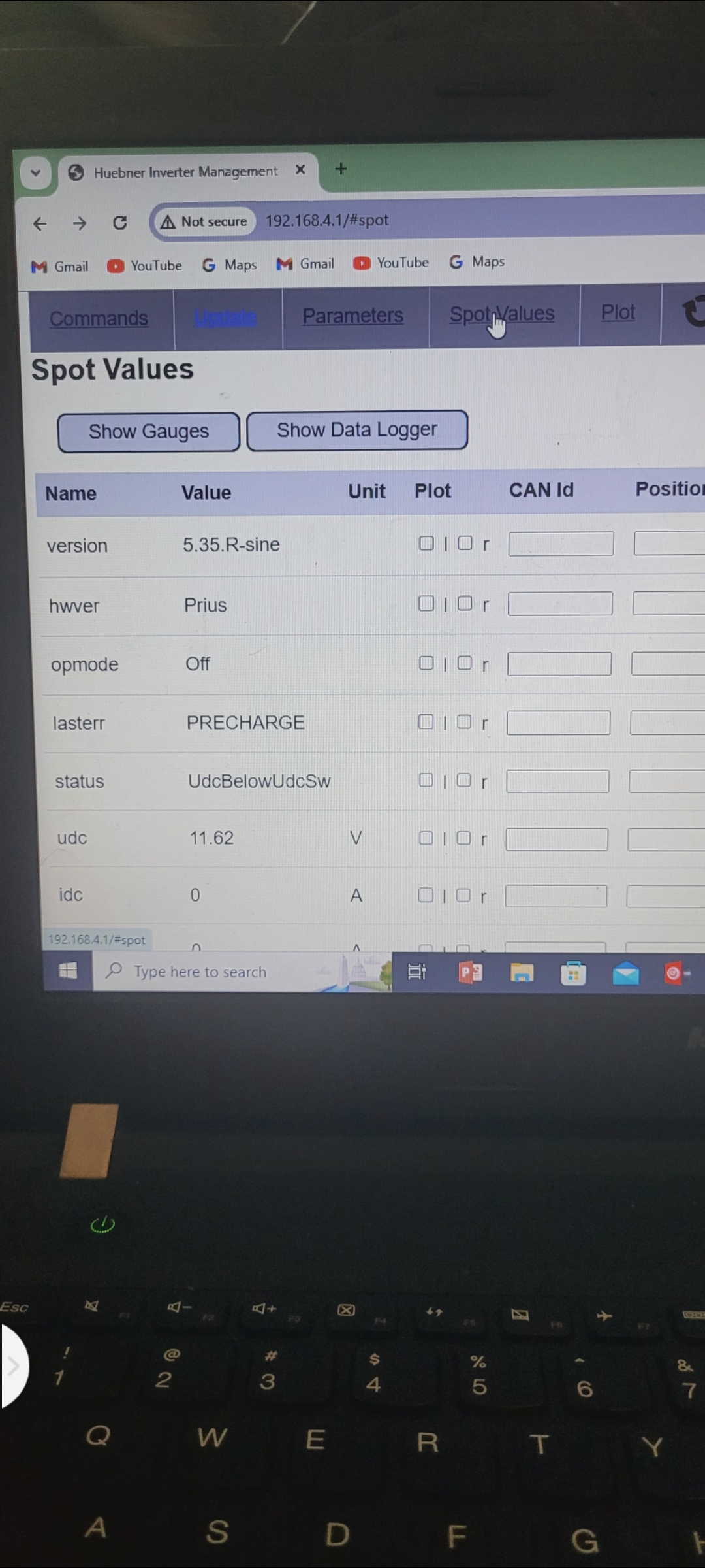

MattsAwesomeStuff wrote: Sun Feb 23, 2025 3:47 am If you can log in and get the OI interface to load, and it pulls up a list of parameters, then you have at least powered the OI controller properly.
I heard you mentioning logging in. Where do I log in for me to get this list of parameters that the OI will pull up a list of these, so I can be sure also if the OI controller is also powered correctly??
●●●●NOTE●●●●
When I flipped the board to do the tests at the back I noticed a sudden change in the "whine sound" made by the inverter and the power supply that powers the VCU showed an increase in amps drawn. It increased from 1.15A to 1.20A.
I remember Johu's Comment earlier when he asked me
"The cables you put into the white connector look like they are to thick for it. Are you sure they make good contact?
Have you pulled MSDN to 12V?
After starting the inverter and specifying fslipspnt and ampnom both >0 you should see an increase in current draw from your 12V supply by 200 mA or so. Otherwise there is no PWM going on.
Is the inverter still in some run mode after reloading?"
I changed the cables on the white connector which is the connector that connects to I9i presume.
I got lost when he asked me "have I pulled MSDN TO 12V"
DOES THE CHANGE IN WHINNG AND INCREASE IN AMPS DRAWN BY THE VCU INDICATE A FAULTY CONNECTION ON THE WIRES?

voti wrote: Mon Feb 24, 2025 10:05 amI heard you mentioning logging in. Where do I log in for me to get this list of parameters that the OI will pull up a list of these, so I can be sure also if the OI controller is also powered correctly??
Erm, just logged into the wifi that lets you pull up the OI webpage.
The parameters are on the OI interface there. If it creates that table with all the values, you've accessed it correctly and the wifi can communicate with the controller.
Well, there's no reason flipping anything should cause any change in amps, so, something happened.

So coming back to the three pins 28 29 30.
I didn't get any readings when I tested for voltage amd didn't see a change in waveform when using the oscilloscope.
I will recheck the wires since Johannes suspects a broken wire hence we are not getting15v reading on any of the pins 28, 28 and 30.

You remember we checked if pins 28, 29 amd 30 are receiving any power

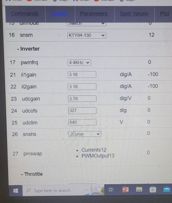

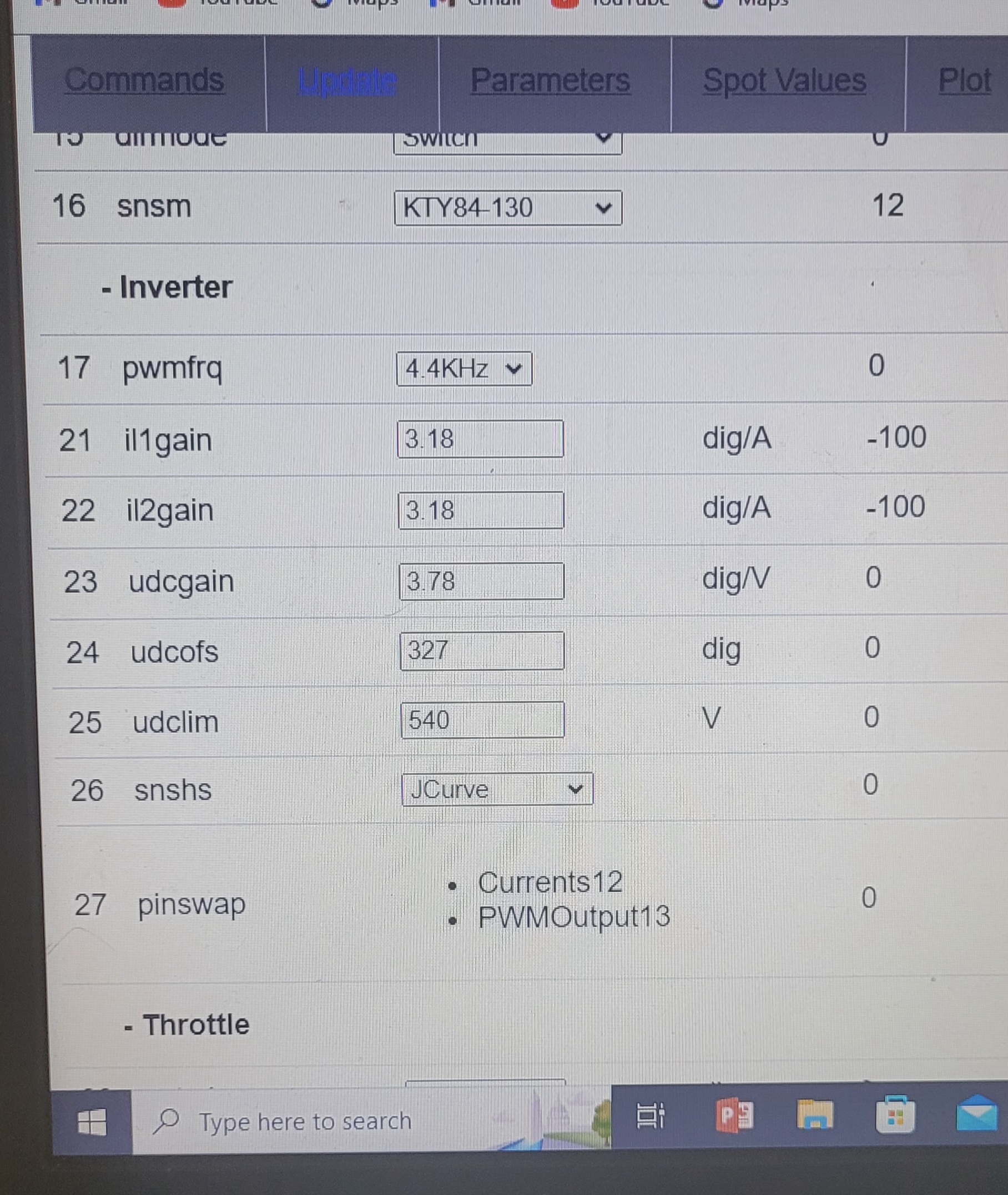

voti wrote: Mon Feb 24, 2025 10:05 am I flipped the board and tested like you said.what I did first was I set my Voltmeter to dc and and first tested pin 19 amd 20 which is "19 battery negative" and "20 battery positive" and I got 12v input and then I move my positive Voltmeter terminal to pins 28 29 amd 30 to see if I get any reading. Why negative terminal was still on pin q9 which is our battery nagative and on doing that, on pins 28,29 and 30 I didn't get any reading.
when I tested there wasn't any.
What could be the cause of that and how do we solve it?

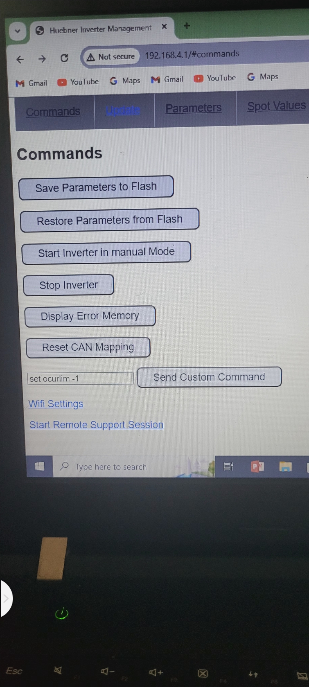

Ok, there needs to be more methodology here. I have attached the manual again.
Answer the questions asked here, do not test anything else. If any step fails you can stop there as it is pointless to continue. Fix the problem until the test succeeds, then continue.
When I say "inverter" I mean the Prius inverter. When I say "controller" I mean the openinverter controller
Three major things need to be done right for getting the inverter to pulse:
- The grounds of inverter and controller must be joined up
- MSDN must be pulled to 12V, verify this on the inverter side. That is pin 25 on the inverter connector
- All three PWM inputs must make contact to the controller. With the inverter turned on and the controller turned off make sure that Pin 28, 29 and 30 on the controller side read 15V
Good, so now we have the most important connections made. Time to power up the controller.
- Do not connect anything to the inverter phase outputs
- I suggest powering both controller, inverter logic and inverter HV DC with a current limited lab power supply (can be the same for all 3) without any fuses or resistors that can get in the way. Set the current limit to 3A, voltage to 15V
- Use most recent software 5.35 and set ocurlim to -1 (disabled)
- Put inverter in manual mode with fslipspnt=1, ampnom=1
- Verify that opmode reads ManualRun
- Connect your scope probe ground to ground of your lab supply and verify that Pin 28, 29 and 30 of the controller show a perfect rectangular wave form
- Now verify that you see the same perfect rectangular wave form on the 3 inverter phase outputs

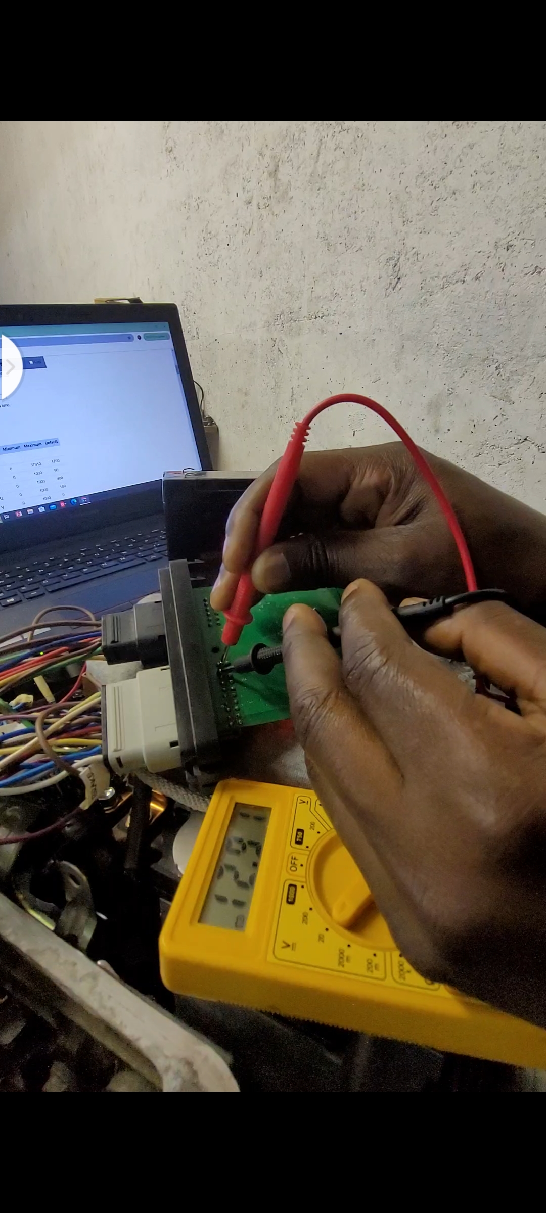

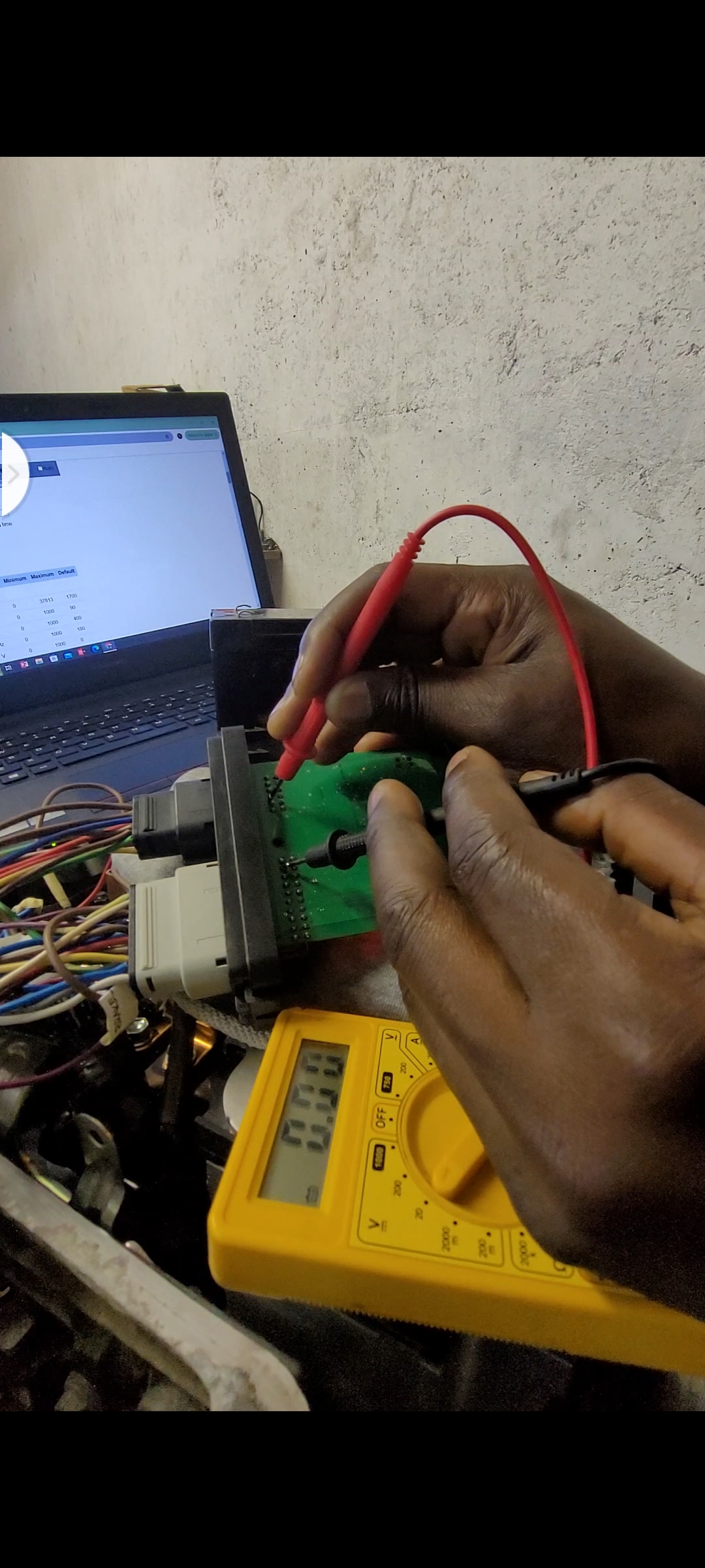

johu wrote: Sat Mar 08, 2025 10:19 am Three major things need to be done right for getting the inverter to pulse:
The inverters ground is the one on the i9 connector and the one for the MCU is pin 19?
Let me confirm if I read this right, "
With the inverter turned on and the controller turned off make sure that Pin 28, 29 and 30 on the controller side read 15V"
Does this mean that I should disconnect the car interface on the control board and only leave the inverter interface connected.
Next I should flip the board and check for 15v on Pins 28,29 and 30 ?
I did that and please see the attached pictures. I first tested the input voltage input on the i9 and it read 15 then I tested the pins 28 29 and 30 against the negative terminal of the i9 since I disconnected the car interface which has ground.
Please confirm if I did this corrct so I can move on

voti wrote: Sat Mar 08, 2025 11:29 am The inverters ground is the one on the i9 connector and the one for the MCU is pin 19?
inverter pin 16, controller pin 32
voti wrote: Sat Mar 08, 2025 11:29 am With the inverter turned on and the controller turned off make sure that Pin 28, 29 and 30 on the controller side read 15V
yes
voti wrote: Sat Mar 08, 2025 11:29 am Does this mean that I should disconnect the car interface on the control board and only leave the inverter interface connected.
yes

johu wrote: Sat Mar 08, 2025 1:08 pm inverter pin 16, controller pin 32
My inverter pin 16 and 32 are both connected to controller pin 32 just like on the PDF that you sent me.

johu wrote: Sat Mar 08, 2025 10:19 am Use most recent software 5.35 and set ocurlim to -1 (disabled)
Please help me locate ocurlim to -1 (disabled).
On Matt's parameters ocurlim appears to be under inverter options but when I check on my web Interface I can't find it. Check attached picture
And also where do I find opmode?
Been thanked: 1918 times
Re: EV Conversion using prius gen 2 inverter/transaxle
Ok, so far it looks good. It seems I have hidden ocurlim. In "custom command" enter
set ocurlim -1
To set it anyway

Post by MattsAwesomeStuff »
voti wrote: Sat Mar 08, 2025 3:57 pm Please guide as to what I should do next because at this stage I'm confused
There is a place in the openinverter interface, near the top, to type in manual commands (and then hit enter). This is an alternative way to changing parameters or starting and stopping the inverter.
What Johannes is asking you to do is to type into that interface:
set ocurlim -1
And hit enter.
"set" is the command to change a parameter, "ocurlim" is the name of a parameter" and "-1" is a value that ocurlim can have that will disable it from limiting your current.
Also, this is the first time you've had voltage appear on 28, 29, and 30! I'm not sure how that happened, but, that's great news.

OK. I typed in "set ocurlim -1 " on the input field next to send custom command, And I hit enter. Then I put in your parameters and started the inverter in manual mode. I stopped it and checked spot values and I found opmode value to be Off. I started the inverter again but nothing changed.
I closed everything and reopened the web Interface. I first set the ocurlim -1 then on to fslipspnt to 1 and ampnom 1 like Johannes said.
I started the inverter in manual mode and checked the spot values. Opmode was off. Even when the inverter was started it was still off. Please see attached.
Ill advise there. Don't hit enter but hit button "Send custom command"

And what about opmode. How do I turn it on ?
