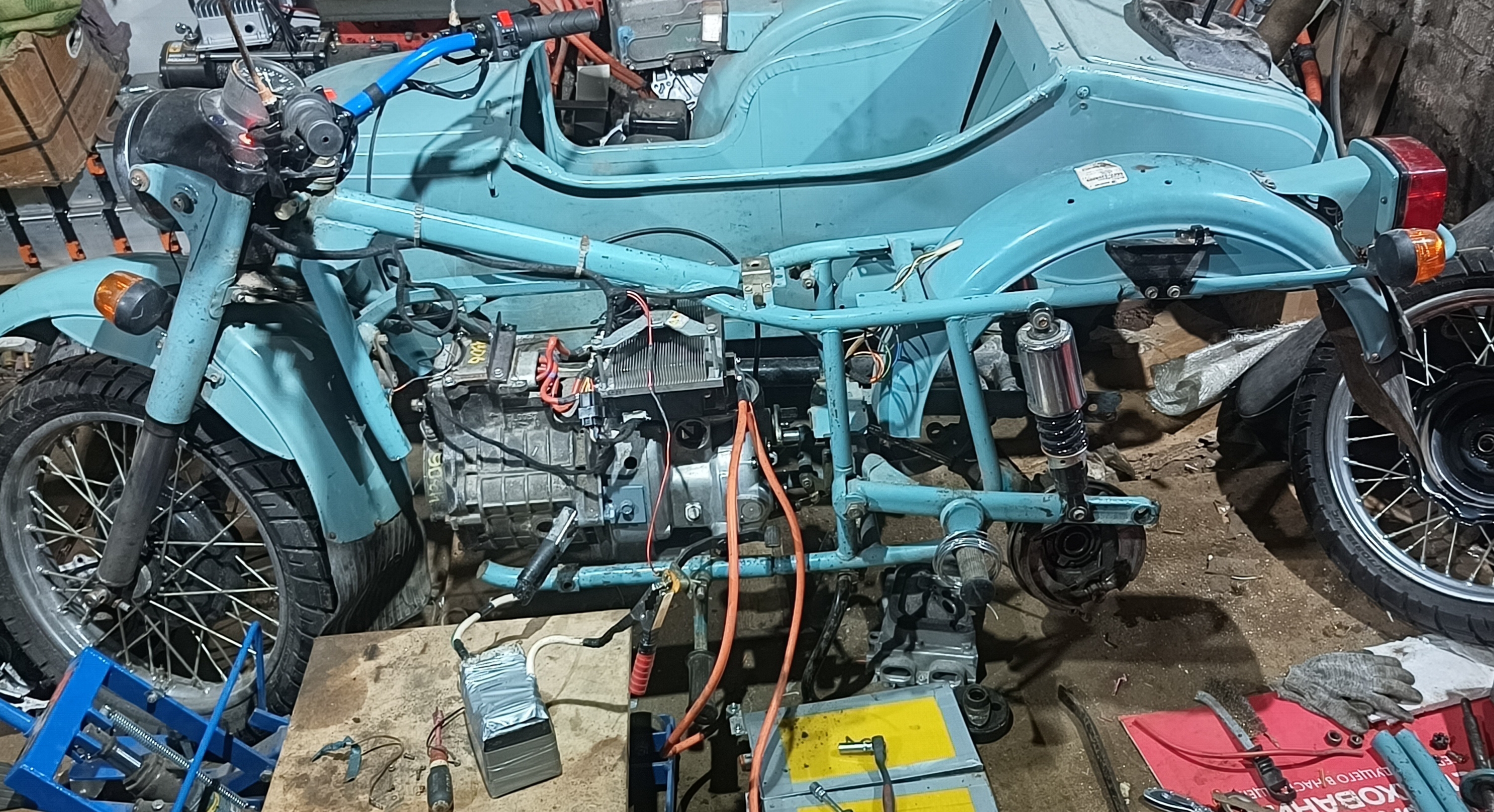

so. the correct syncofs was 600.
when the fwcurmax is -210, the motor does not stop (syncadv = 10), setting the syncofs to 1100 stops the motor perfectly at syncadv 10
. next, I returned the syncofs to the correct 600 units, and syncadv = 15. the motor did not stop. I increased by 5 and then by 10 units, and only at syncadv = 100 did the motor start to stop!!! this is probably a very big offset.
for understanding: the battery voltage in this experiment is 45 volts, the load on the motor shaft is 0 (gearbox only)
. I conducted the experiments on an electric motorcycle that I am currently building with a rear Outlander motor and a Honda ima inverter.

I think it's worth checking the change in the syncadv parameter in the countryside on a forest road without people and cars, under load.
but it won't be soon. The weather doesn't allow it yet.
When I check it, I will definitely give you feedback.
