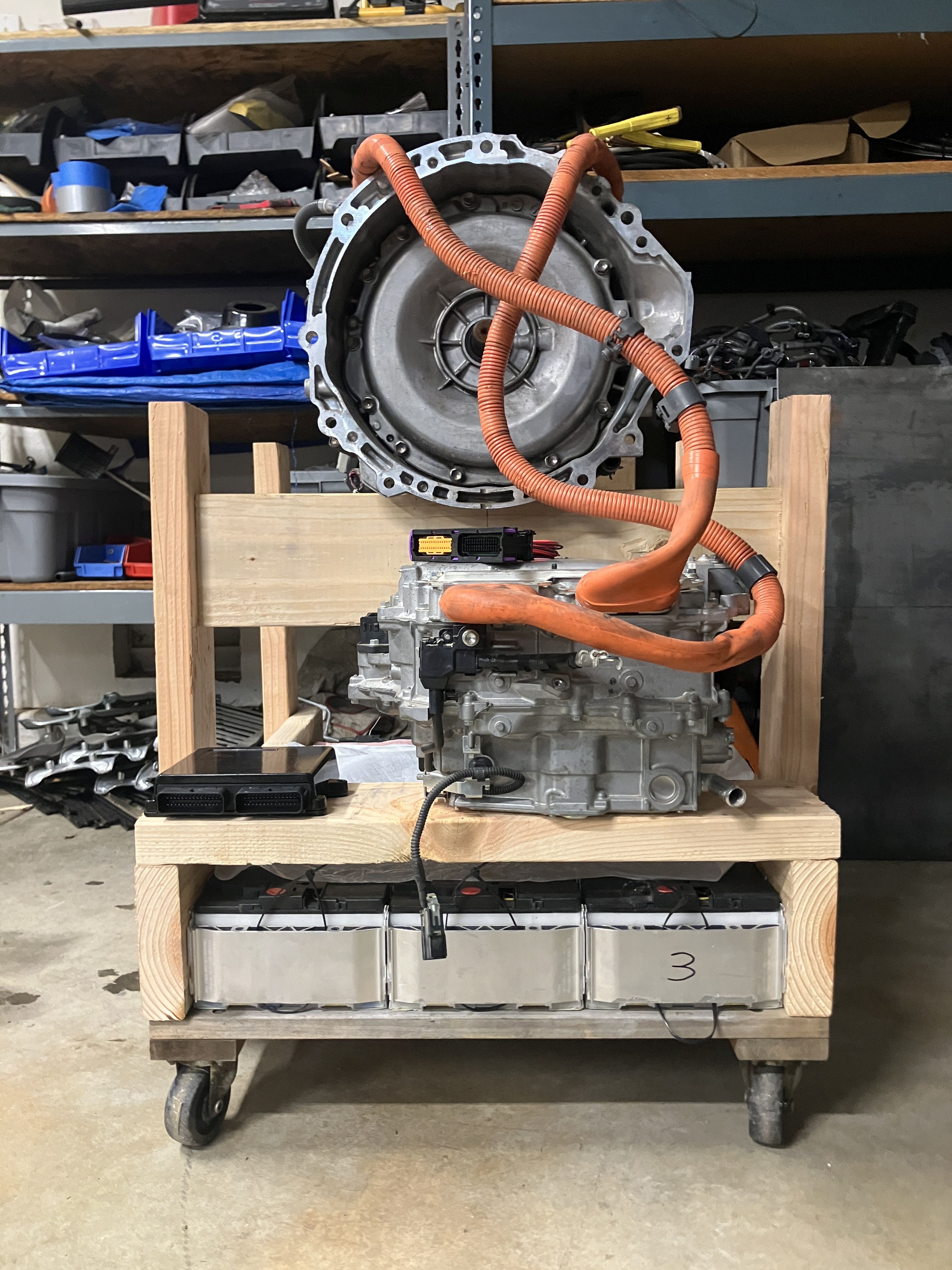

INTRODUCTION
from the guy who's brought you way too many "Now What" Series threads already, comes one more
How it all began? Well I simply wanted to know if the "Resolver Cables" were interchangeable between the 3rd Gen (2007-2011) and the 4th Gen (2013-2018) Lexuseses GS450 heitchers. So I made a low ball offer on eBay for one of the technically called Engine Wire 4th Gen harnesses and it was accepted. Wow, this is way too easy I thought so I did the same for a 4th Gen inverter, and that was accepted. Then I spied with my little eye that the seller was located 2.8 miles away from my house and I could save $400 bones on shipping by picking up a transmission [pronounced: "gearbox'] myself so I made a low ball offer on that, hoping deep inside they would decline the offer. A few minutes later: "Thanks, Greg! Your order is confirmed. We’ll send an update when it’s on the way." and here we are

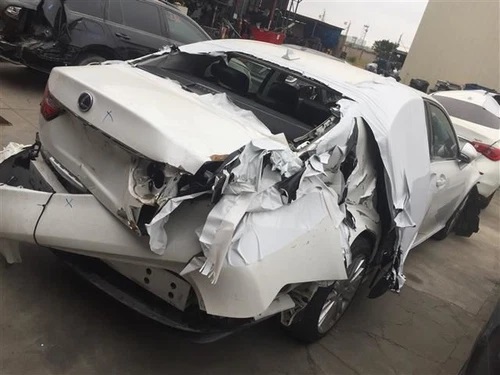

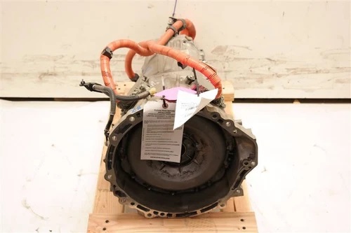

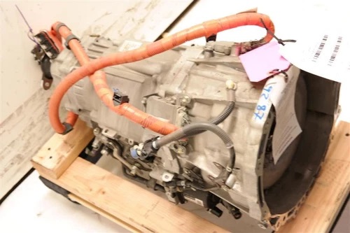

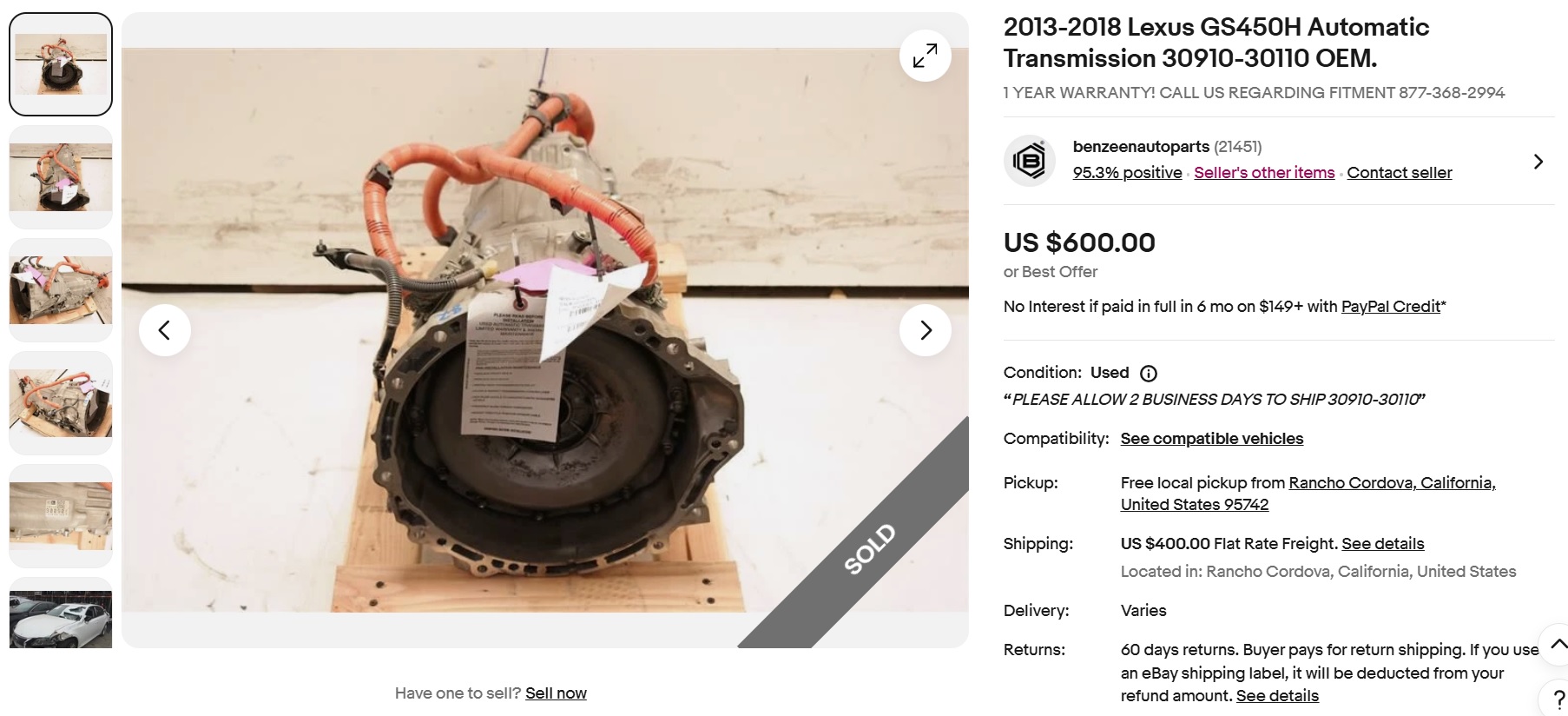

transmission listing as seen on eBay
Orange Cables - ✔
Electric Oil Pump - ✔
It's always nice to see the vehicle it came out of, and seeing it being immobilized because it was wrecked, otherwise it may have mechanical issues
Orange Cables - ✔

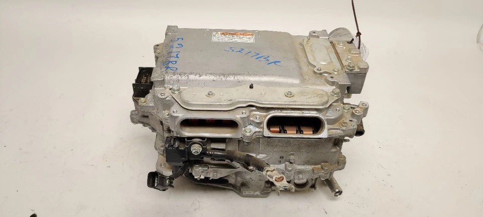

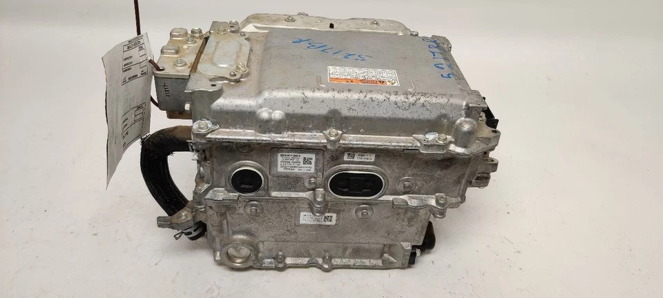

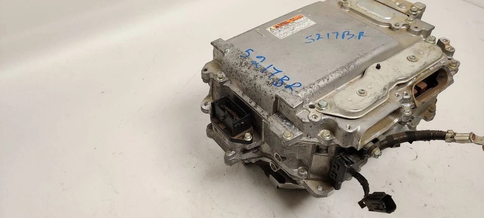

inverter listing as seen on eBay

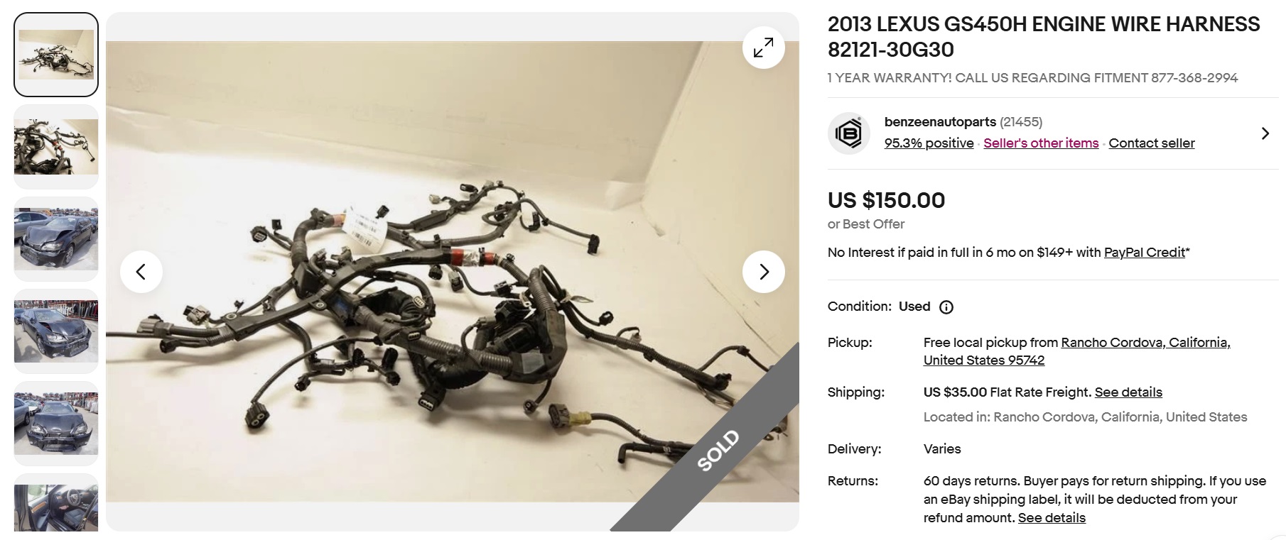

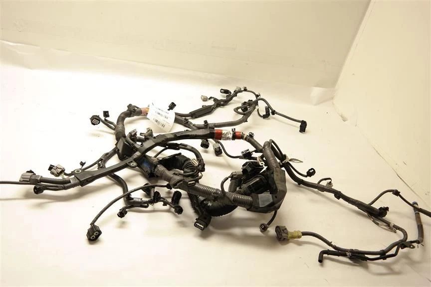

Re: I just bought a 4th Gen Lexus GS450h Powertrain. - Now What?

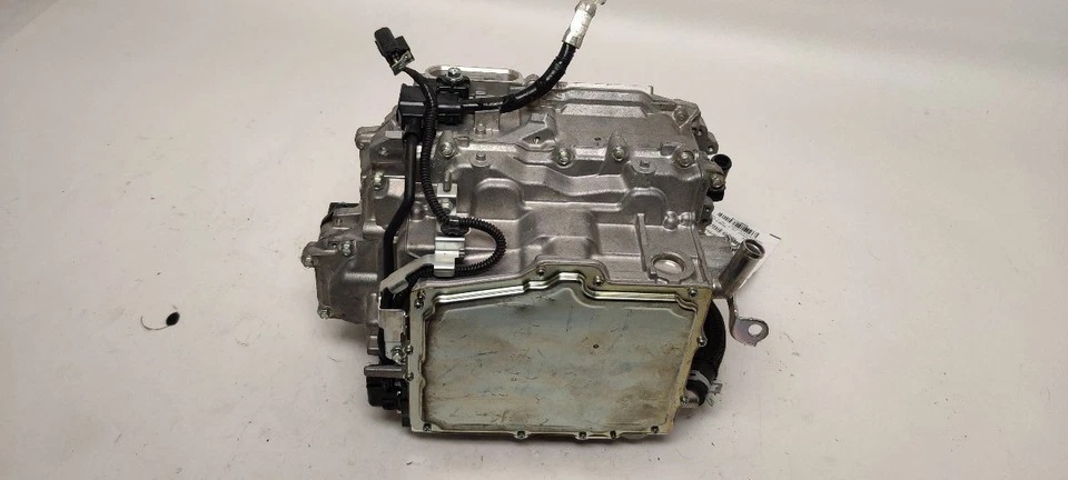

transmission wire harness as seen on eBay
4th Gen transmission wire harness Part # 82121-30G30 is for 2013-2016 this one has the resolver cables but not the inverter connector/plug

and so it begins...

scored an inverter and wire harness from the Fourth Generation 2013 Toyota Avalon Hybrid (model years: 2013-18) which looks awfully the sameish as the Lexus one, let's hope the inverter plug is interchangeable
looks like somebody already snagged the fuselator
here I am attempting to remove the already severed orange high voltage motor cables (but I end up giving up on removing them as it appears 6 bolts need to be undone and I have a strict 3 bolts or less per component policy, ha ha )

and here she is all extracted an hour and fifteen minutes later
snagged all the wire harnai
note the handsum carrying handle (hey it's the pants or the inverter, you decide)
I can take apart 92% of all imports with what's in that Pick N Pull tool bag!

and back in the lair
Lexus gearbox tethered to the Lexus inverter, and the Toyota inverter on the floor
