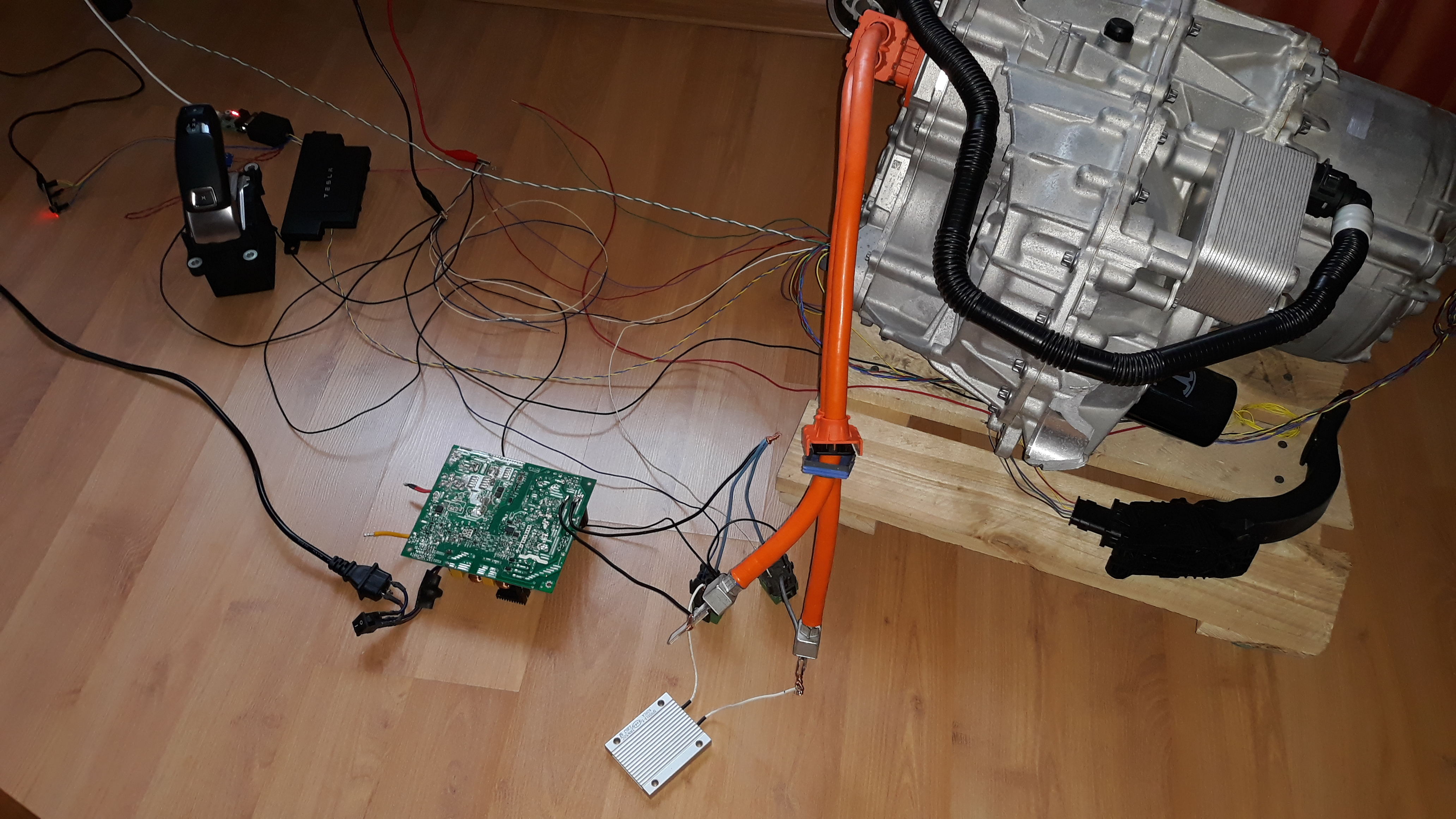

Post by AMP3R »
The new power supply didn't help, which means the problem is somewhere in the can messages.

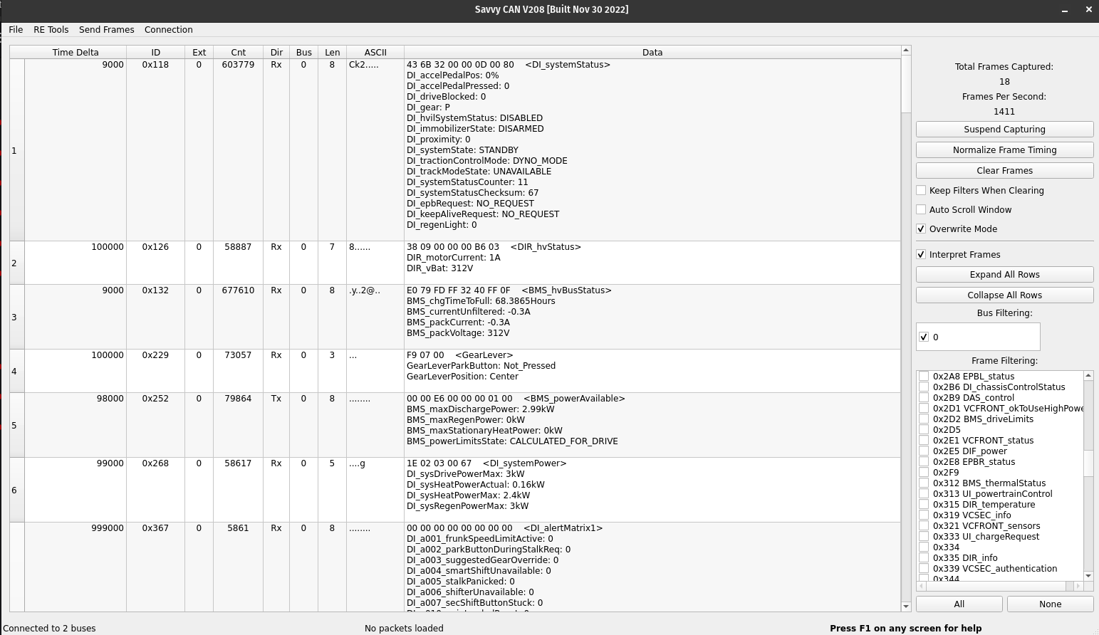

Post by AMP3R »
It works. Switches to D and R, but for some reason immediately returns to P. Also, a new alert DI_a125_noBatteryPower appeared.

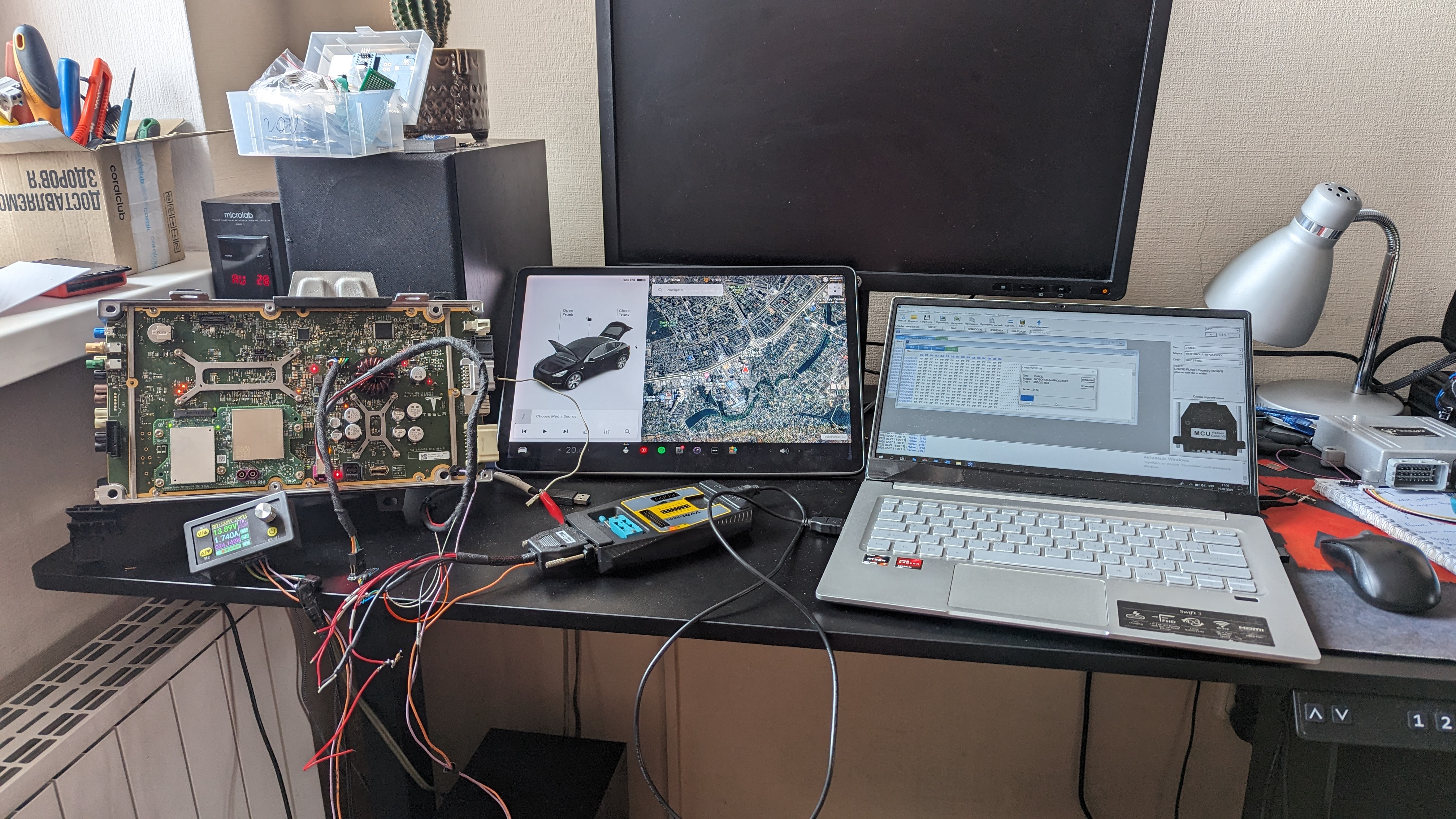

I very slowly but work on this way to run M3 inverter. I make some research on MY and change rear drive inverter from 990 to 980 version. I make new IMMO pair with VCSEC and DIR with Tesla Toolbox. But then I change back stock inverter, VCSEC forgot it, so VCSEC can make pair only with one inverter.
I buy MCU with old software , display, motor, VCSEC, pedal and wiring for bench test. MCU help me rewrite software in inverter for more old version, when I start redeploy. And MCU help me make IMMO pair.
Next step emulate CAN frame to make motor spin)))
