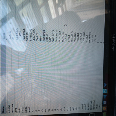

I took the next board, but not sure if random muxshort is solved with the latest rev.

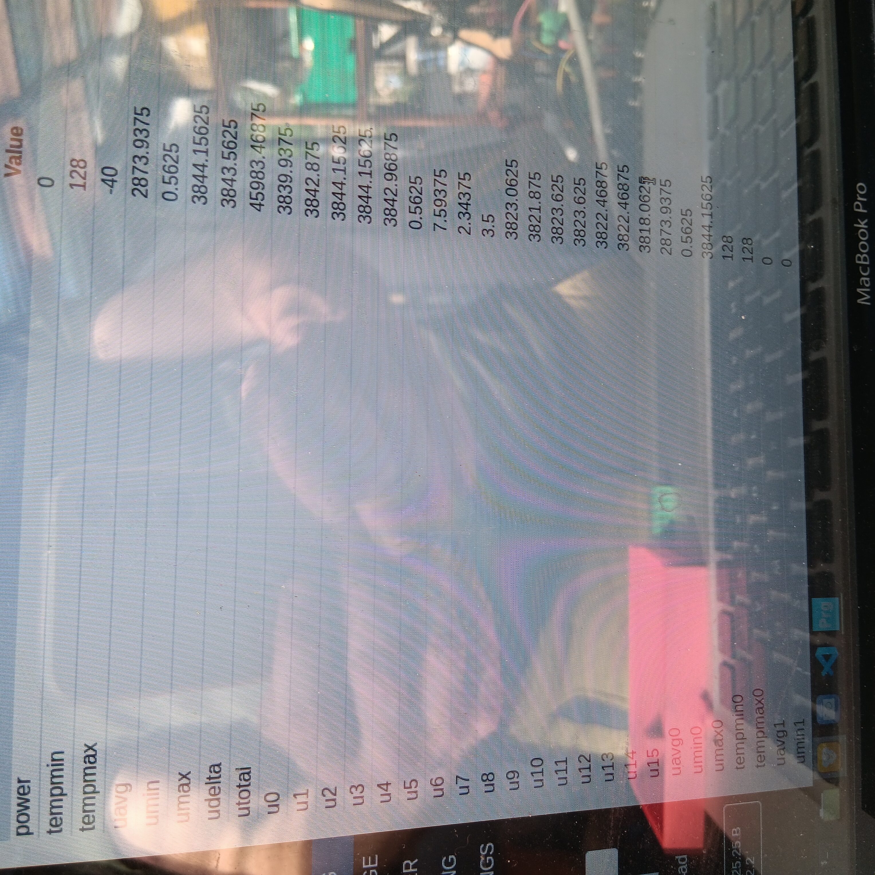

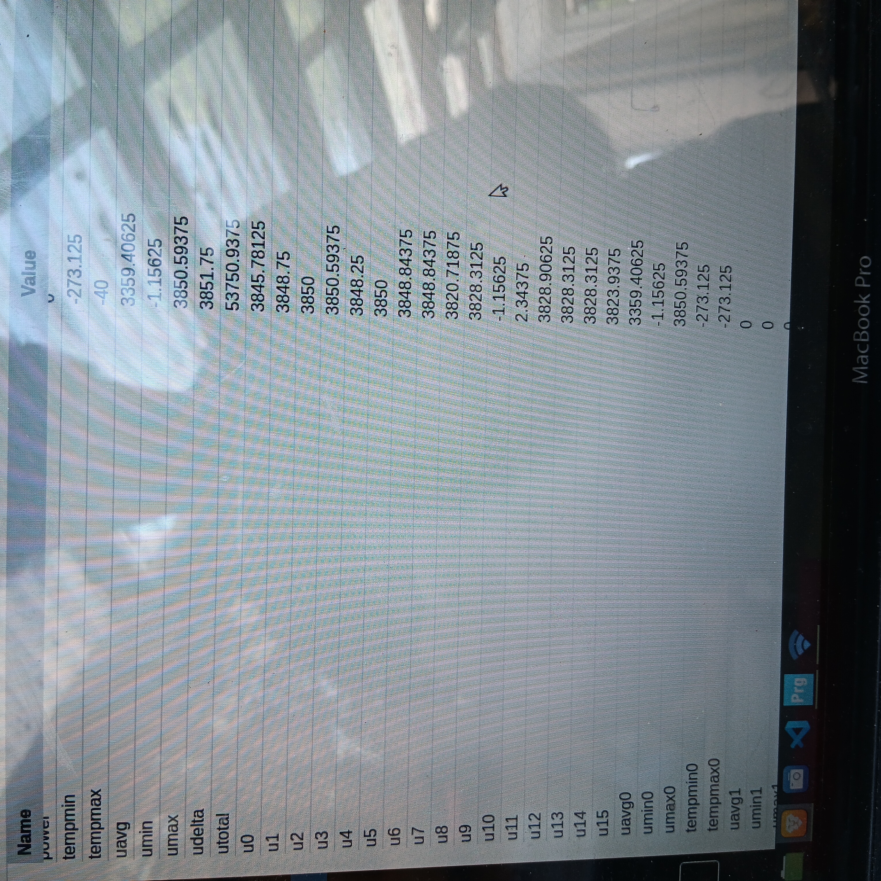

i had 6 boards working just fine. after upgrading to .25.25B two of them randomly got the muxshort.
so far not sure why the random muxshort. i upgraded all the other boards, they are working fine. some i unplugged the battery before updating, some i left the batteries connected. all where fine.

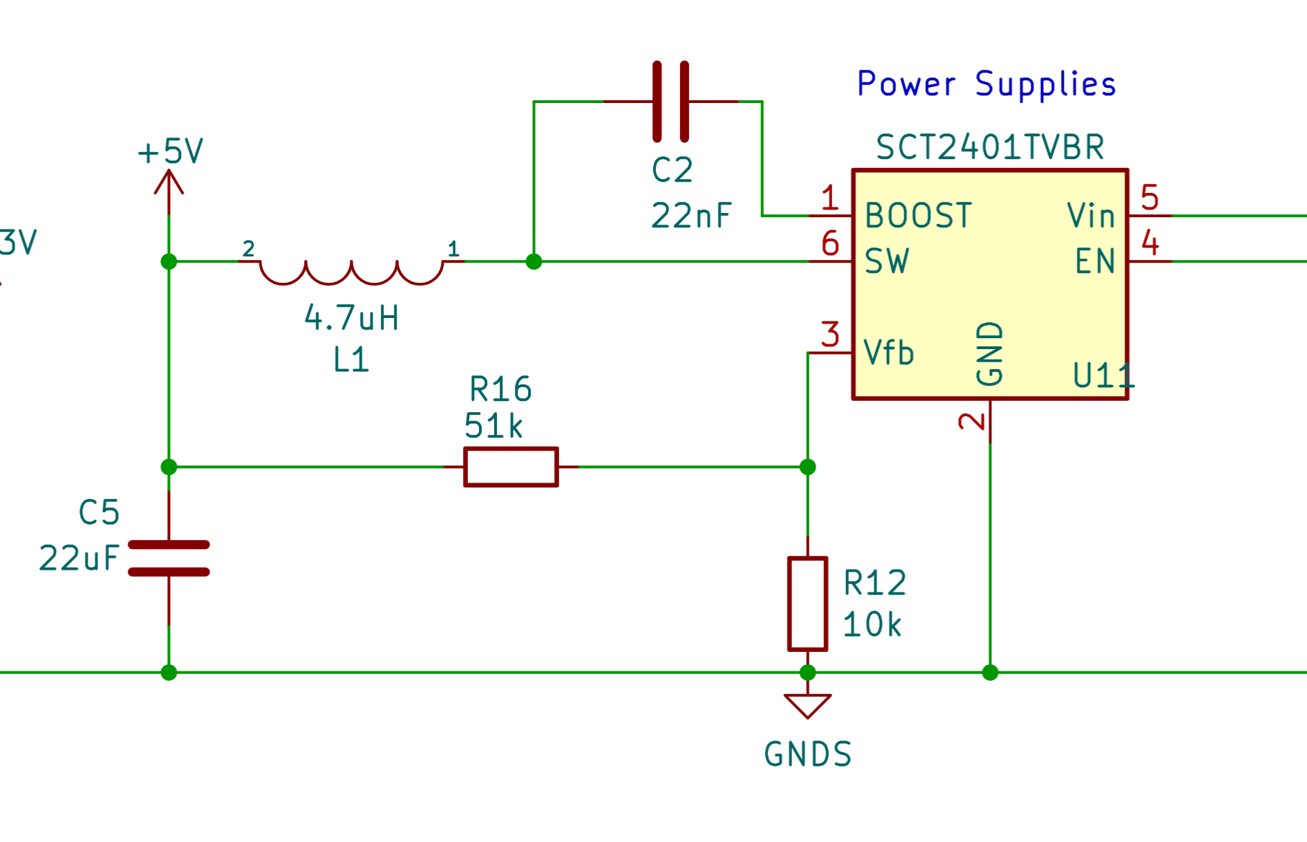

i found 5 fets not giving the 0.5 when i did the diode test with a multimeter. i removed them from the on board and put it on the other one.
couldnt test it cause my 5v regulator got damaged. (dumb of me for swapping 12+ and ground).
is there a replacement regulator of mouser maybe?

lm2734 (LM2734YMK/NOPB) or other PNs in same package could maybe work. Please compare LM2734 12V->5V bom and the above BMS switcher bom if actually compatible, pins seem to be compatbile.

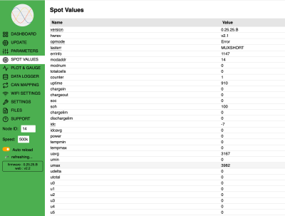

i did not see that coming...
i ve been running 5 bms boards, for 3 days, no issue, just balancing away.
to my surprise, randomly got a MUXSHORT error today.
the car was charging at the time.

I am now at the point where I should connect them to my LG MEB modules, but seeing the random muxshort current destroying polyfuses by BMS taps, I am not very keen on angle grinding all of the modules open at a rate one per day. Probly going a different route for the time being. :/
Posts: 6739
Has thanked: 380 times
Been thanked: 1562 times
Re: Flying ADC 16 channel BMS 96S test
That sucks. Even modules that worked fine for days go bad and even the v2.3 ones with various precautions don't last and even at only 12S, i.e. half the blocking voltage of the FETs.
