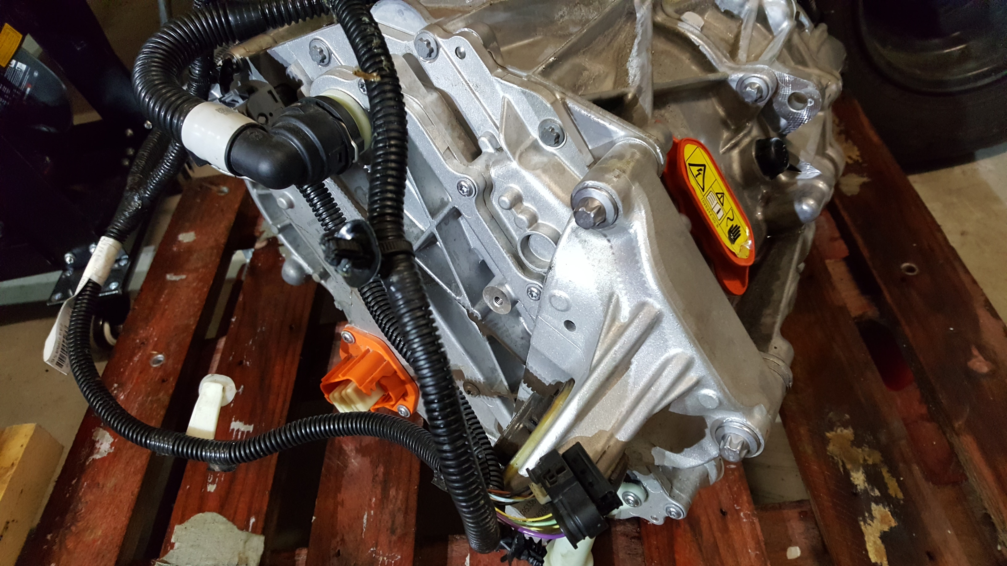

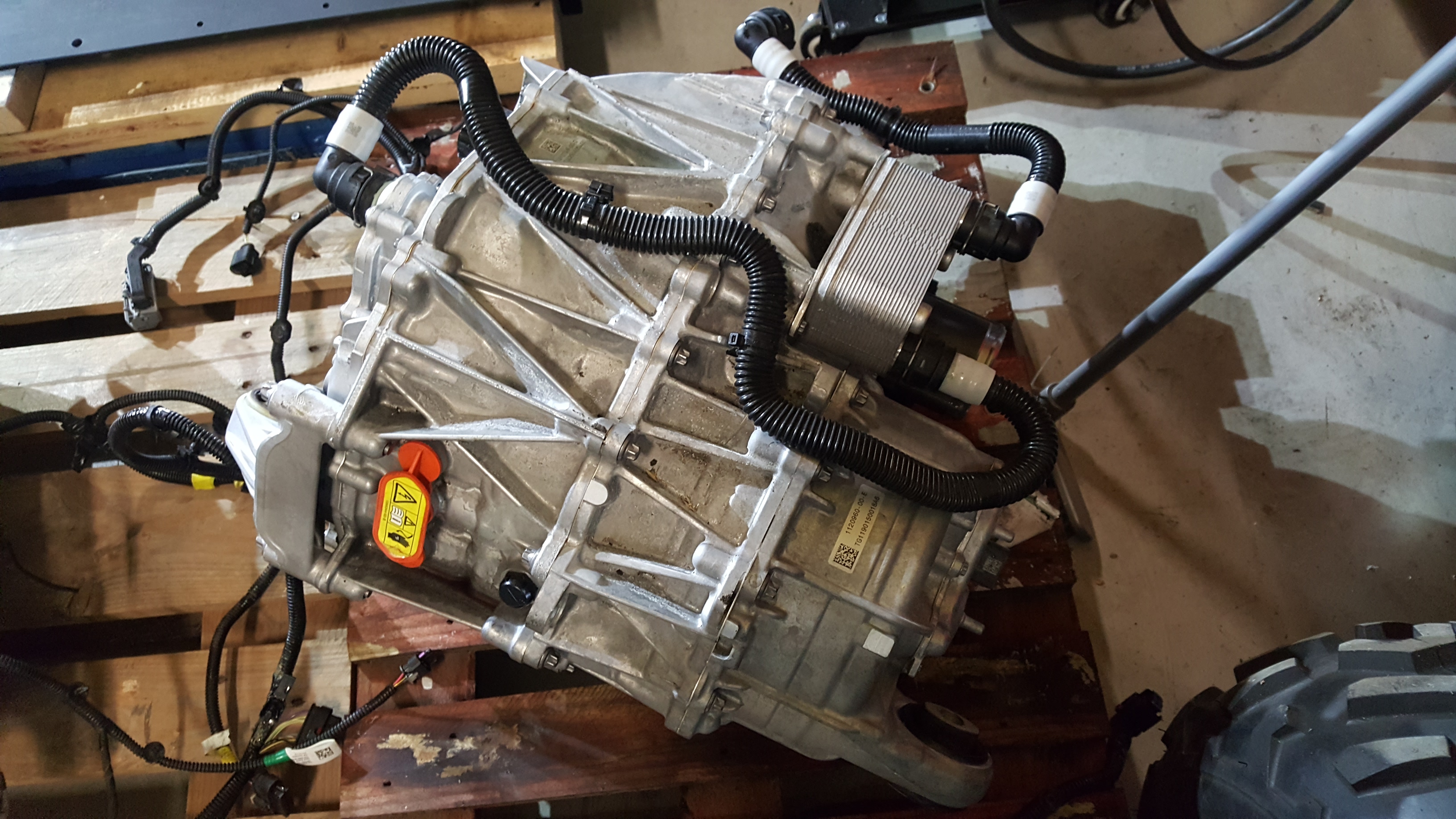

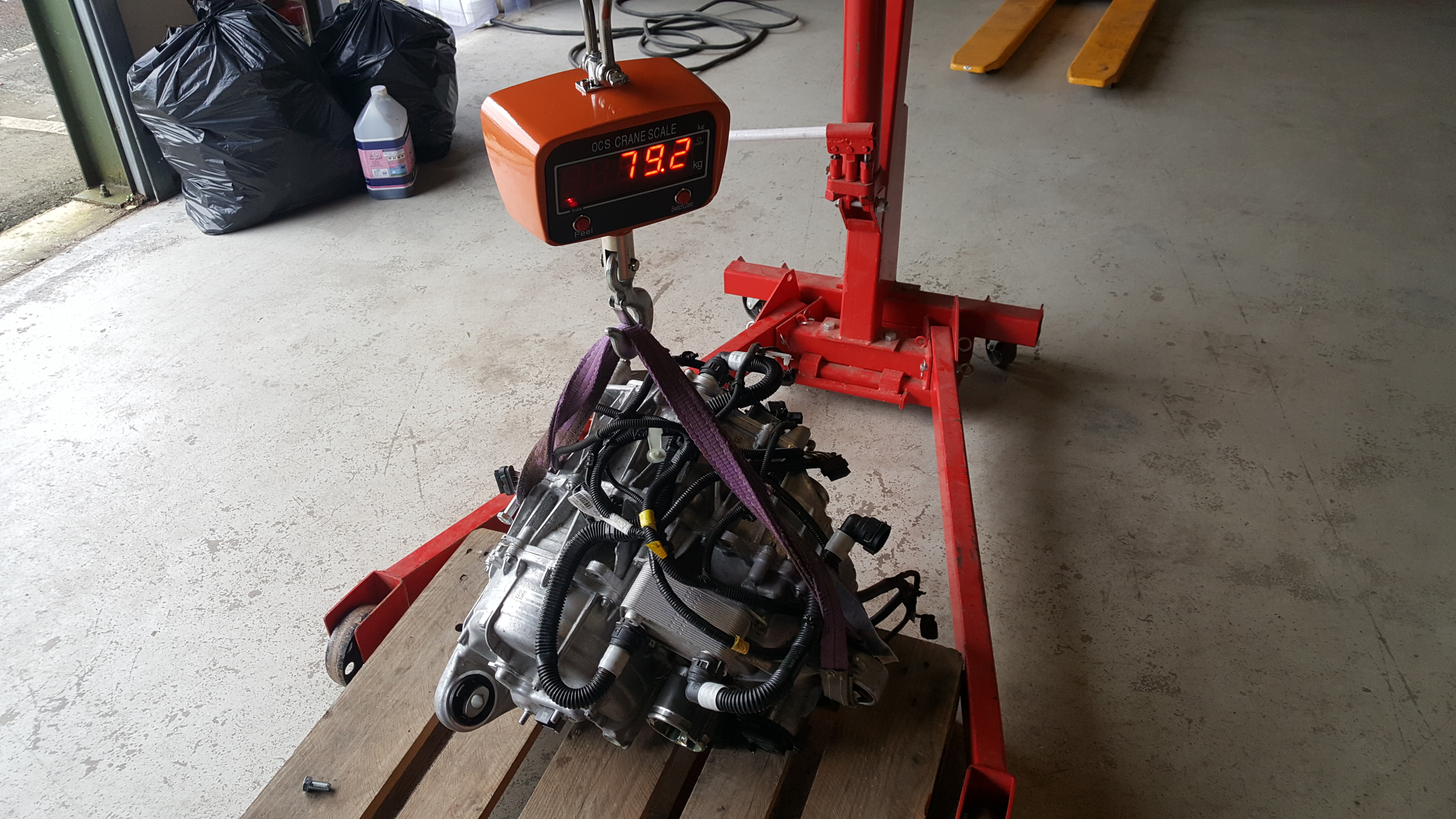

Setting up a thread to document the reverse engineering of the Model 3 front drive unit. The specimen is from a European 2019 car with just over 20k km on the clock.
Initial observation is the motor exhibits no cogging whatsoever while turning via the drive shafts. The plan will be in two parts :
1)Remove inverter and run the motor with a prius inverter so we can learn how to control it with the Openinverter system.
2)Reverse engineering the Tesla inverter to allow use with an open source logic board.
