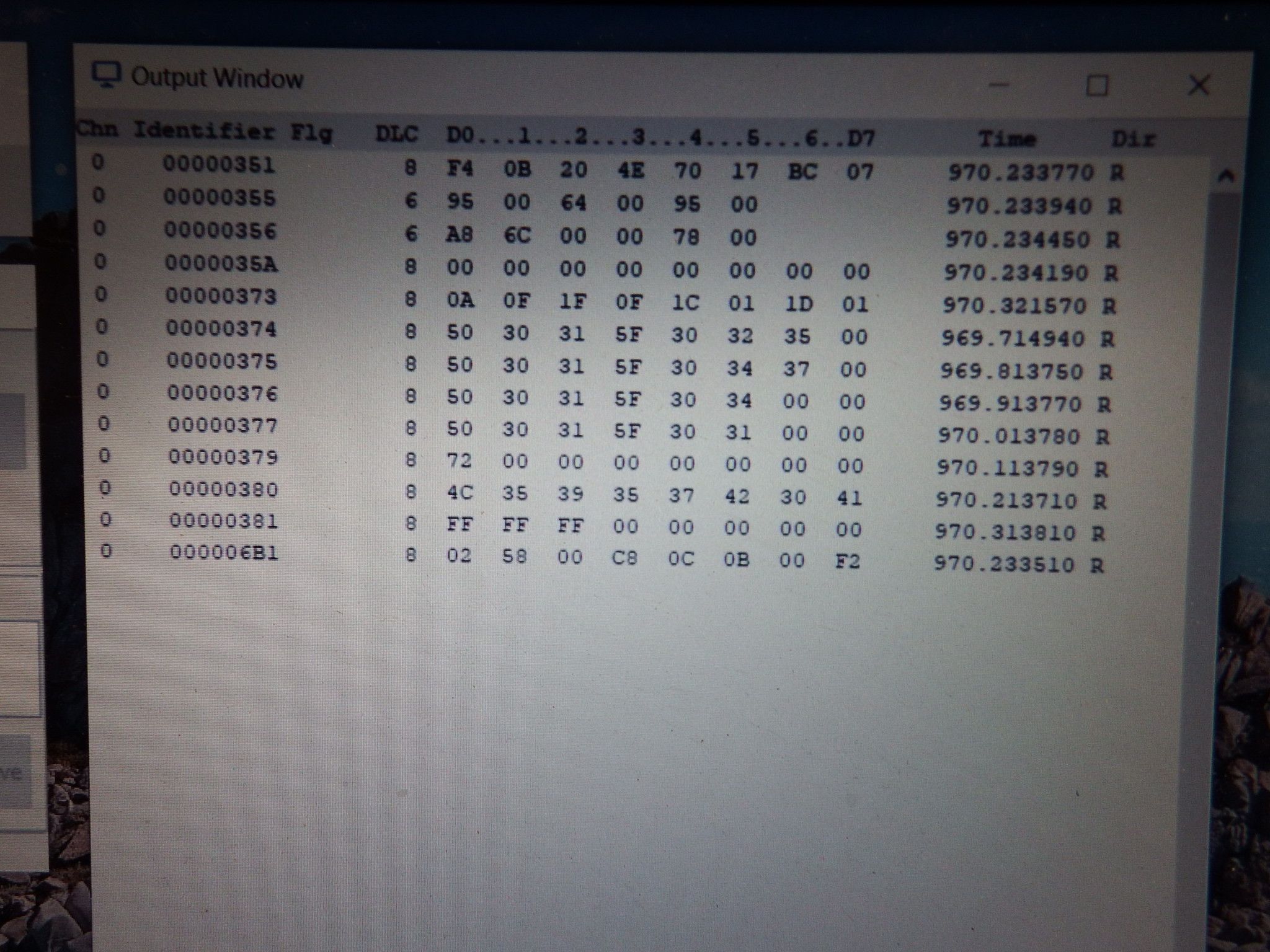

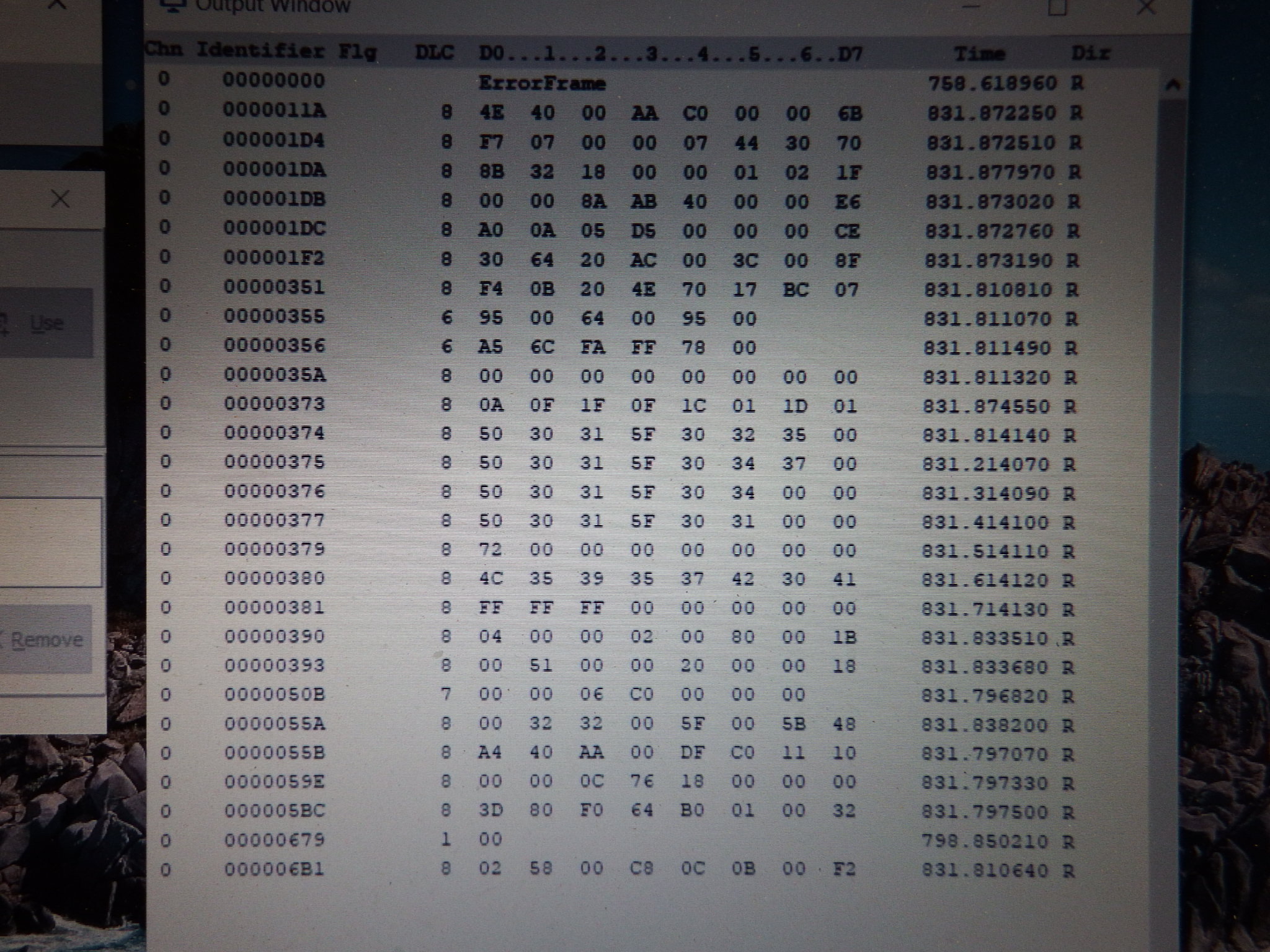

Edit:- Tab and blank spaces not allowed so messed up my table below.
CAN logs and fixed position screen pics attached.
Current measurements only taken on permanent supply wires as ign on supply to inverter and PDM have been ignored for the test.
Inverter PDM
1. Off 12v permanent on 12v always on ign off 574mA 294mA
2. Zombie going in to drive 12v always on ign on 580mA 351mA
3. Zombie going off 12v always on ign off 2 575mA 294mA
4. Wait for CAN traffic to stop 12v always on ign off sleeping 575mA 294mA Messaging doesn't stop.
CAN traffic were already running after the car was left overnight. Does the Zombie ever stop sending CAN messages when its left permanently powered on pin 56 as required?
12v_always_on_ign_on.txt
(276.88 KiB) Downloaded 847 times
12v_always_on_ign_off_sleep_time.txt
(68.57 KiB) Downloaded 917 times
12v_always_on_ign_off_2.txt
(62.5 KiB) Downloaded 869 times
12v_always_on_ign_off.txt
(64.47 KiB) Downloaded 835 times

It should do. That will be your problem, will dig into it when I have time. This was working for others and myself on the bench.
Provide your params. What else is wired up right now? As those are not Zombie frames for the leaf stack.
My guess is your BMS does not stop sending CAN frames and this upsets the Leaf stack. Frame IDs look like SimpBMS

Ok great, might be getting somewhere.
It is an Orion BMS and will be sending CAN messages as it is left running (140mA) to allow charging with ignition off as there doesn't seem to be an output from Zombie to wake up the BMS when the charge plug is sensed.
Will stop the BMS and see what happens.
Edit:- the PDM drops to zero quickly and all CAN traffic stops when the BMS goes to sleep but the Inverter permanent supply still sits at 580mA.
This isn't a major issue as the inverter permanent supply can be switched using the ignition relay. Only the PDM is needed to operate without the ignition on.
