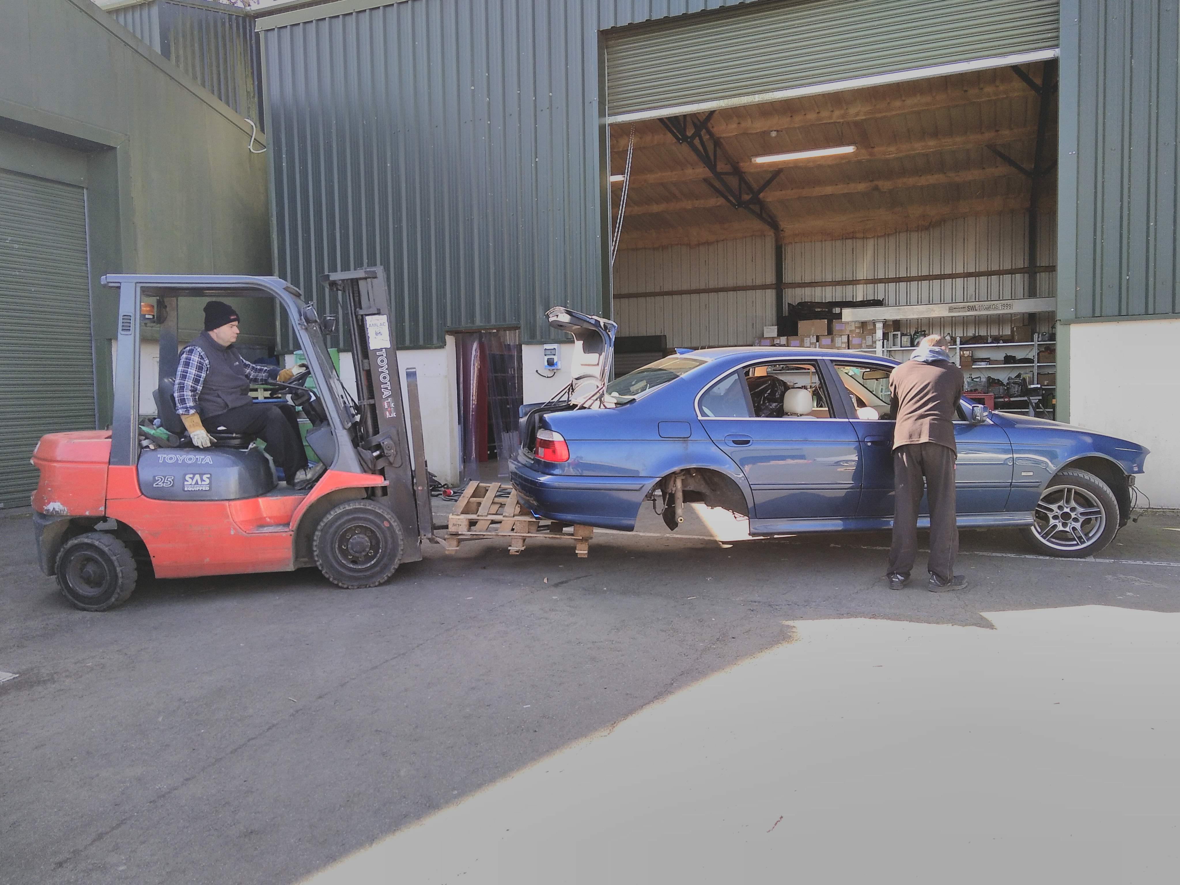

I'm at the easy stage of my project at the moment: ripping the crappy old ICE out of my car ;-)
https://imgur.com/gallery/l4ckLr4
I'm planning to put in its place the MGR unit from a Lexus RX450h. I have a feeling that it's not going to fit very well in its usual orientation (motor forward of axle line). What would happen if I mounted this thing the other way around and ran it in reverse?
Alternatively, if I mount the unit in the correct direction, how much of an angle can I get away with on the CV joints?
Thanks!

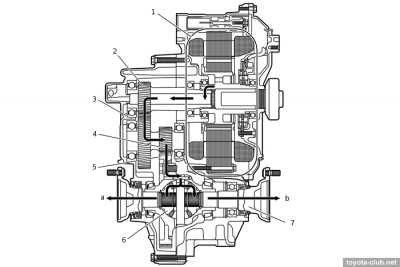

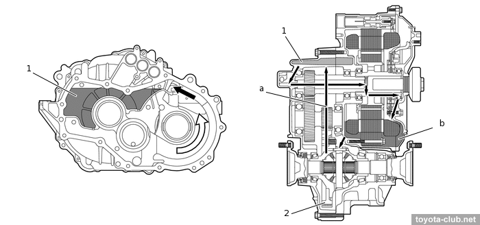

The MGR depends on running forward for lubrication. The differential "slings" fluid from the lower pool up into a distribution reservoir where it trickles down through various passages back to the bottom. Running it in reverse or not horizontal will prevent lubrication.
The CV joints will tolerate some displacement. Less is better obviously.

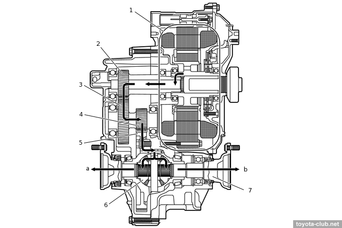

Yes you could probably make it run in reverse if you put a port near the bottom, an oil pump and then probably a cooler (the MGR isn't intended to run constantly, just add rear traction when needed) and then a port near the top to fill that reservoir.
I assume you have a Q211 MGR trans
Q211
· Layout - 3-shaft type
· Electric motor - 2FM (50 kW / 130 Nm or 139 Nm), with permanent magnets
· Gear ratio - 6.859 (1st stage - 23:40, final gear - 18:71)
· Capacity - 1.8 l (ATF WS)
· Module weight - 41.8 kg
1 - fluid catch tank, 2 - differential ring gear. a - fluid slung, b - MGR lubrication
1 - motor generator (MGR), 2 - counter drive gear, 3 - counter driven gear, 4 - differential drive pinion gear, 5 - differential ring gear, 6 - differential gear unit, 7 - differential side gear shaft. a - to left rear wheel, b - to right rear wheel
