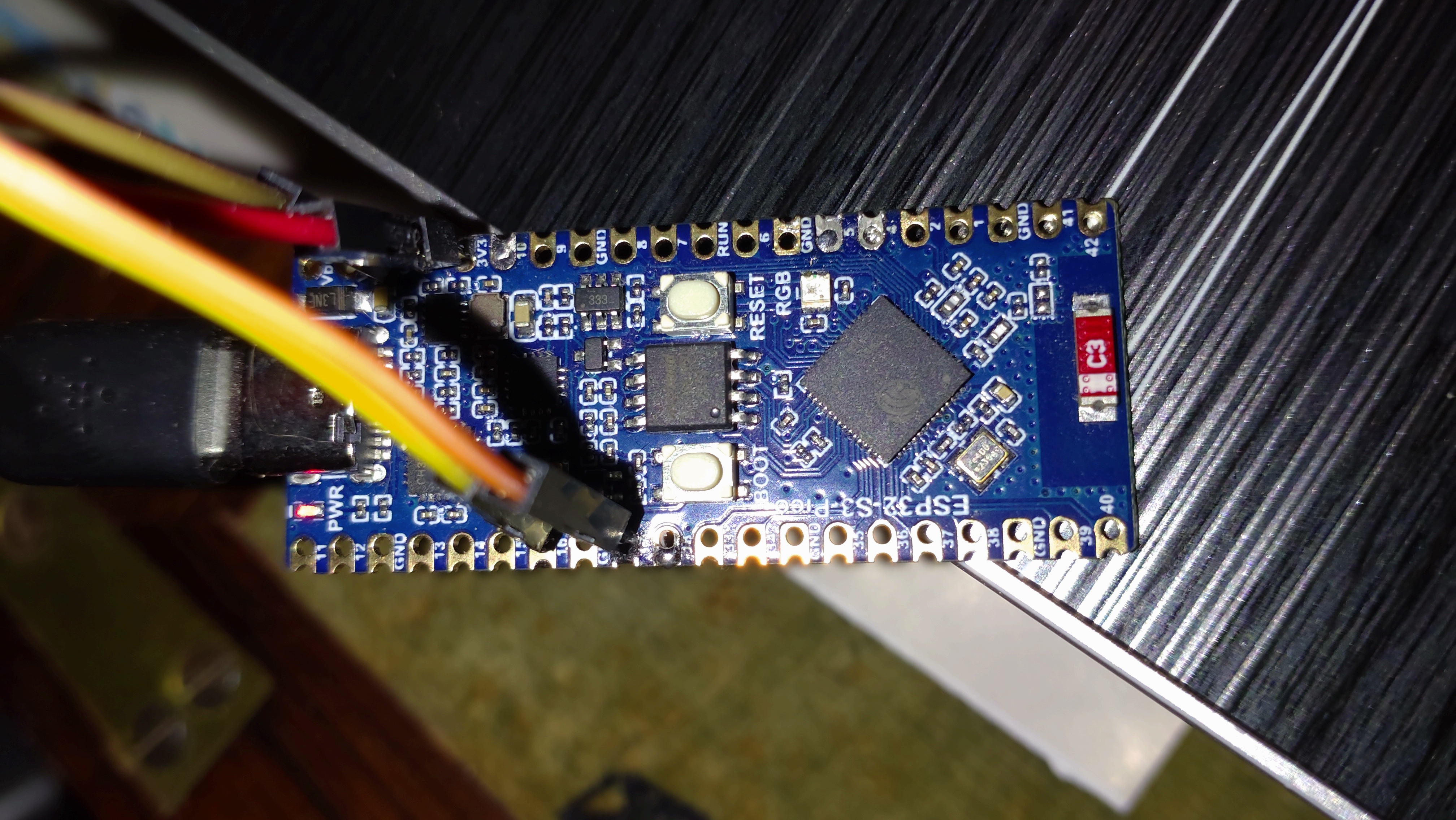

Re: what am I doing wrong ??? ESP32 flashing
For the moment, I am using the output USB port of my computer for power directly to my ESP32S3 USB C programme port.
I have Pins 16 and 17 as TX & RX. For the moment I am not even connected to my Adapter Board.
I can Upload/Delete files through the update Buttons, so I started uplaoding all the DATA files again. For now, I still keep getting the USB message of device not recognised each time the UI refreshes. The files seem to replace the previous ones that were initially downloaded, and adds them at the bottom of the list- don't know if that really helps.
If I try to upload a firmware (foc.bin), the UI says Download Complete, but is frozen in this state.
Edit - I also noticed he ESP is not connecting to my WIfI Network, I have to connect manually. Don't know if this helps iether.

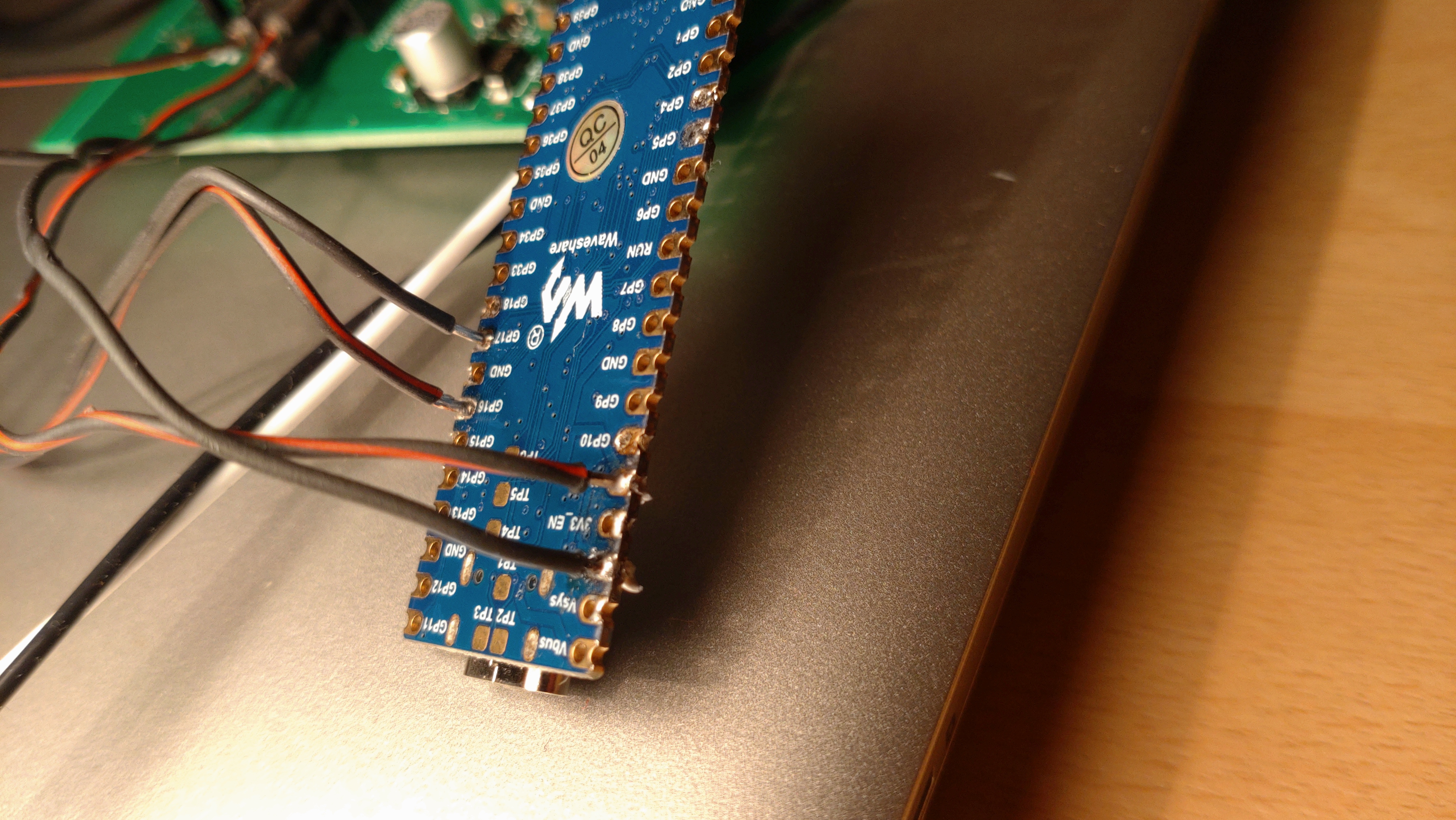

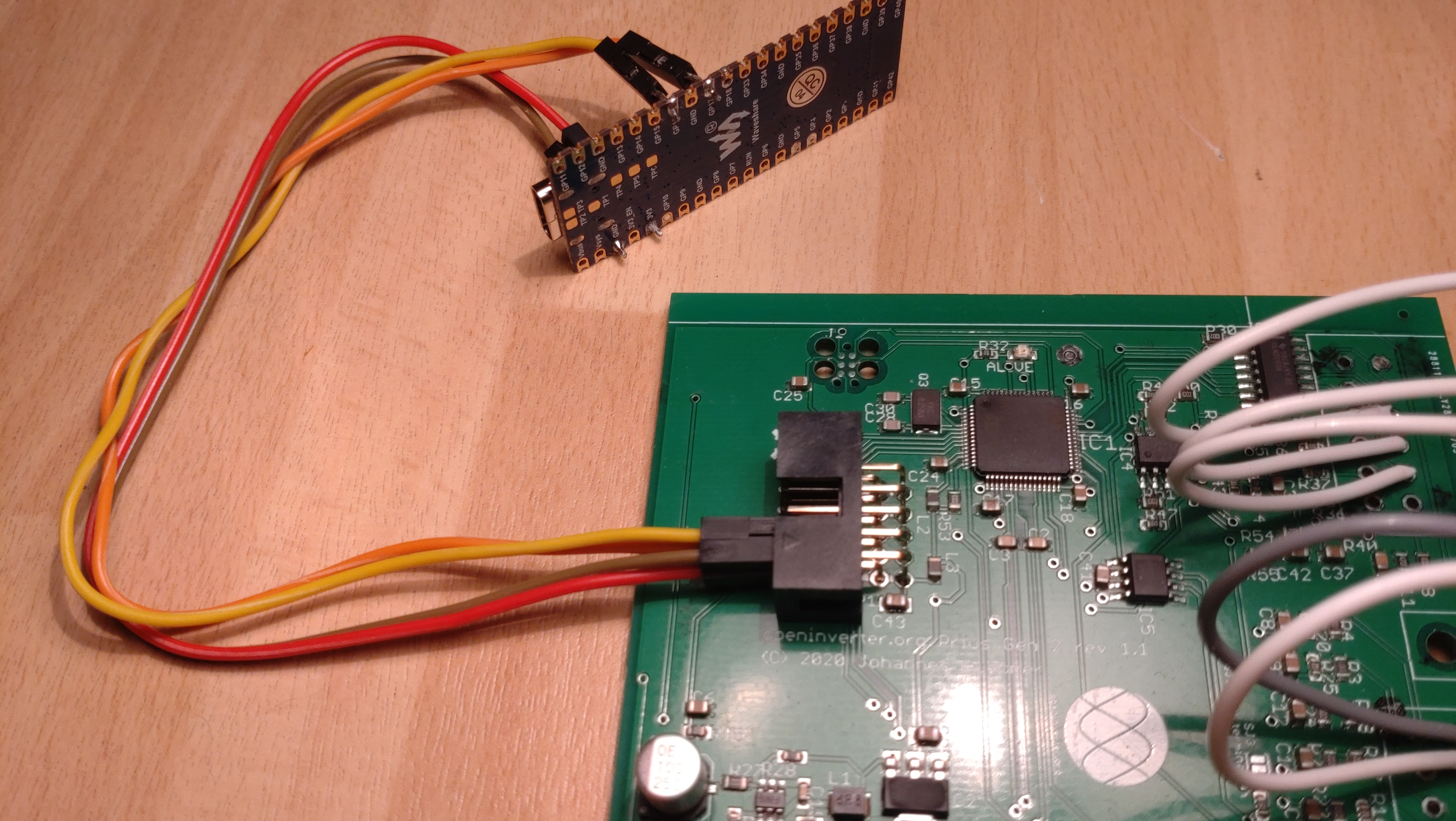

I tried python & commands through windows , but that is also not an easy beginner setup.
I connected the Esp32 to the 3.3v pins for the original ESP8266 on prius adapter board. The connection does not reboot doing it this way, however I still get the Red warning message.
I have tried to connect the TX\RX (pins 16 &17l on the ESP32 to the TX|RX (pins 2 & 4) on ESP8266 breakout on the adapter board, but no difference.
I'm thinking of going the hardwire way, but that again is another deep dive plunging down rabbit holes scénario.....
Frustration, because I feel I'm close to solving this issue, and would like to document so we have a concise up to date solution that can go into the wiki.

I had some frustrating experiences with such jumper wires and in the meanwhile I'm back to soldering. Sure with good quality connectors there is no issue, but the cheap jumpers which I got were best placed into the trash bin.

The jumpers are soldered into the board, but I could replace them if there's a doubt.
My issue at the moment is around connection between Esp & STM.
If there is doubt about the ESP board, is there a "simple" way to say put the web interface on my arduino due and connect that to my adapter board?
The soldering on the waveshare board pins doesn't look great. Id start there. GP16 and GP17 you can see around the pins
Oh well. I went to unsolder and replace the wires with proper automotive pins. Looks like I cooked one of the pinouts on the board! The 3.3V. I'll just bin it for all the time spent. Will order a new one
- Posts: 875
- Location: France
- Has thanked: 539 times
- Been thanked: 52 times
I went over the pins again, as it was really bugging me. There seems to have been goo splashes, and the circuit board looks to not be damaged. So replaced all 4 wires with proper automotive cables and pins. Connected up with the same Esp-Stm coms message. Could the fact that the adapter board has a very old firmware as apposed to the Esp be causing adaptability issues?

17. Connect ESP32S3 Pins to Initial Connector for ESP8266 on Adapter board: NOTE - Pinouts are inversed when looking at Adapter Board
1: 3.3v on ESP32 to Pin 1
2: Ground on ESP32 to Pin 2
3: GPIO 16 on ESP32 to Pin 3
4: GPIO☺7 on ESP32 to PIN 4
18. Apply 12v to adapter board & User Interface should be visible.
