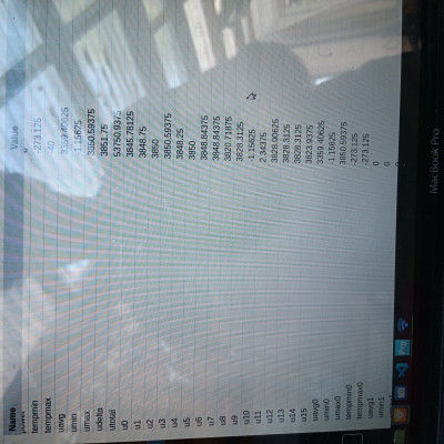

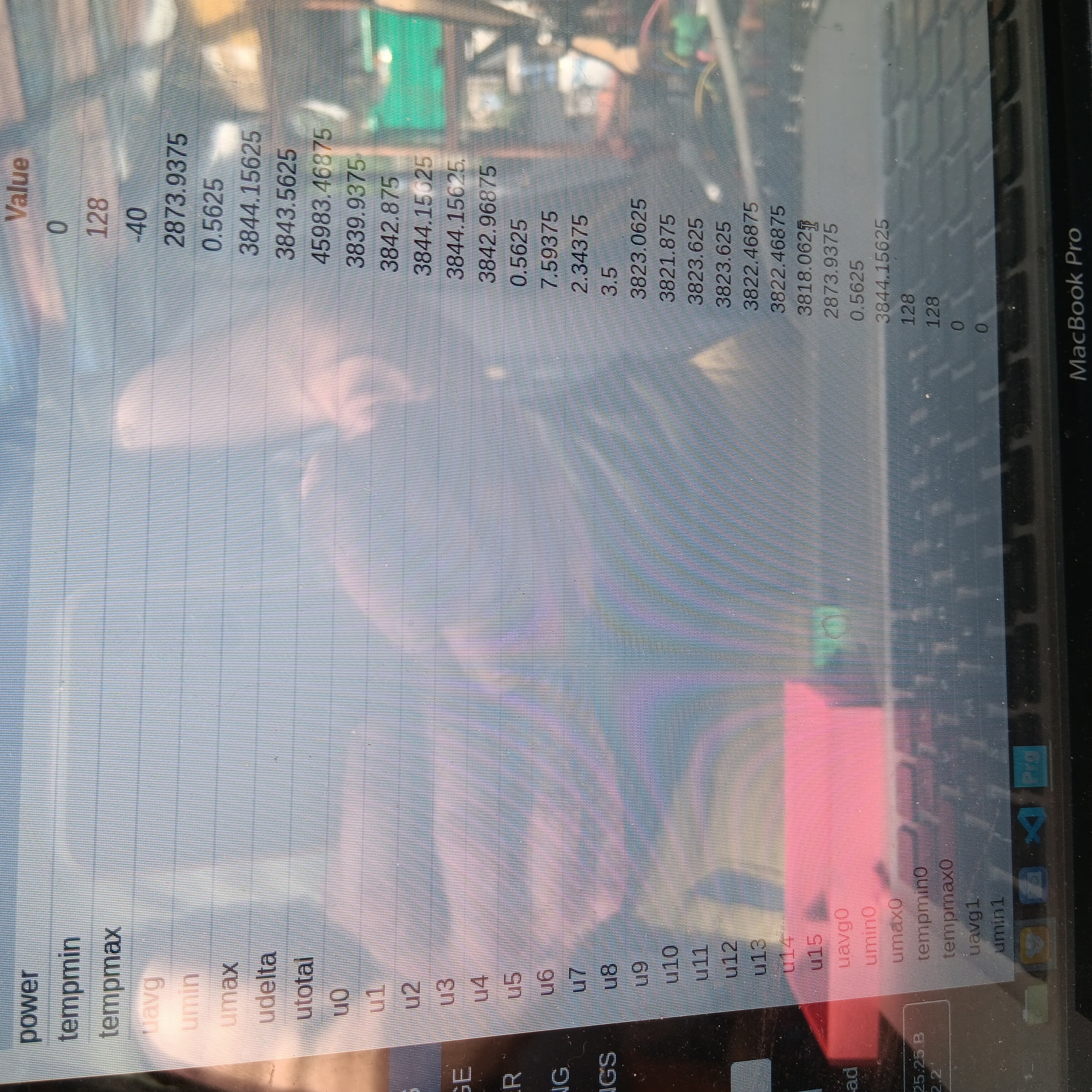

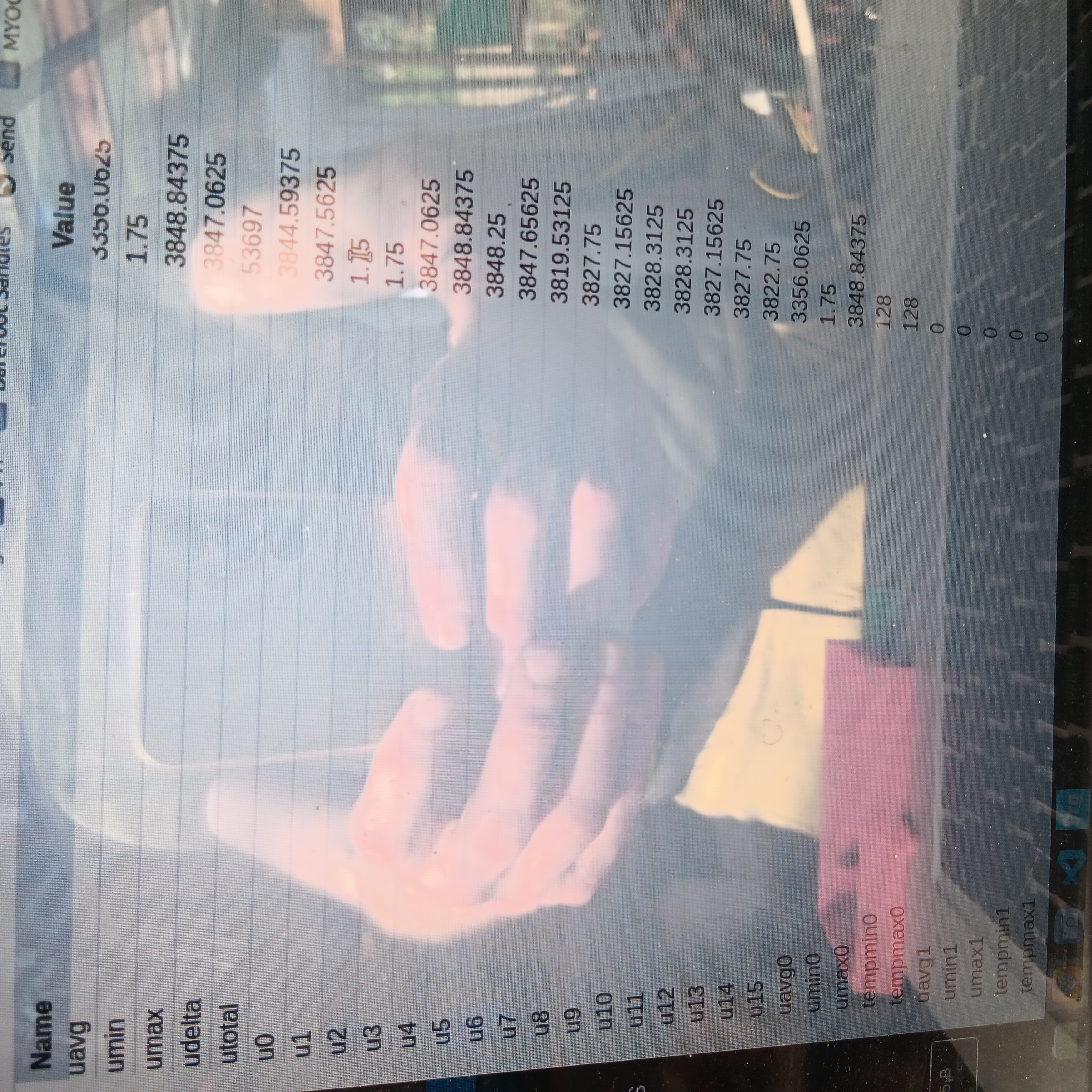

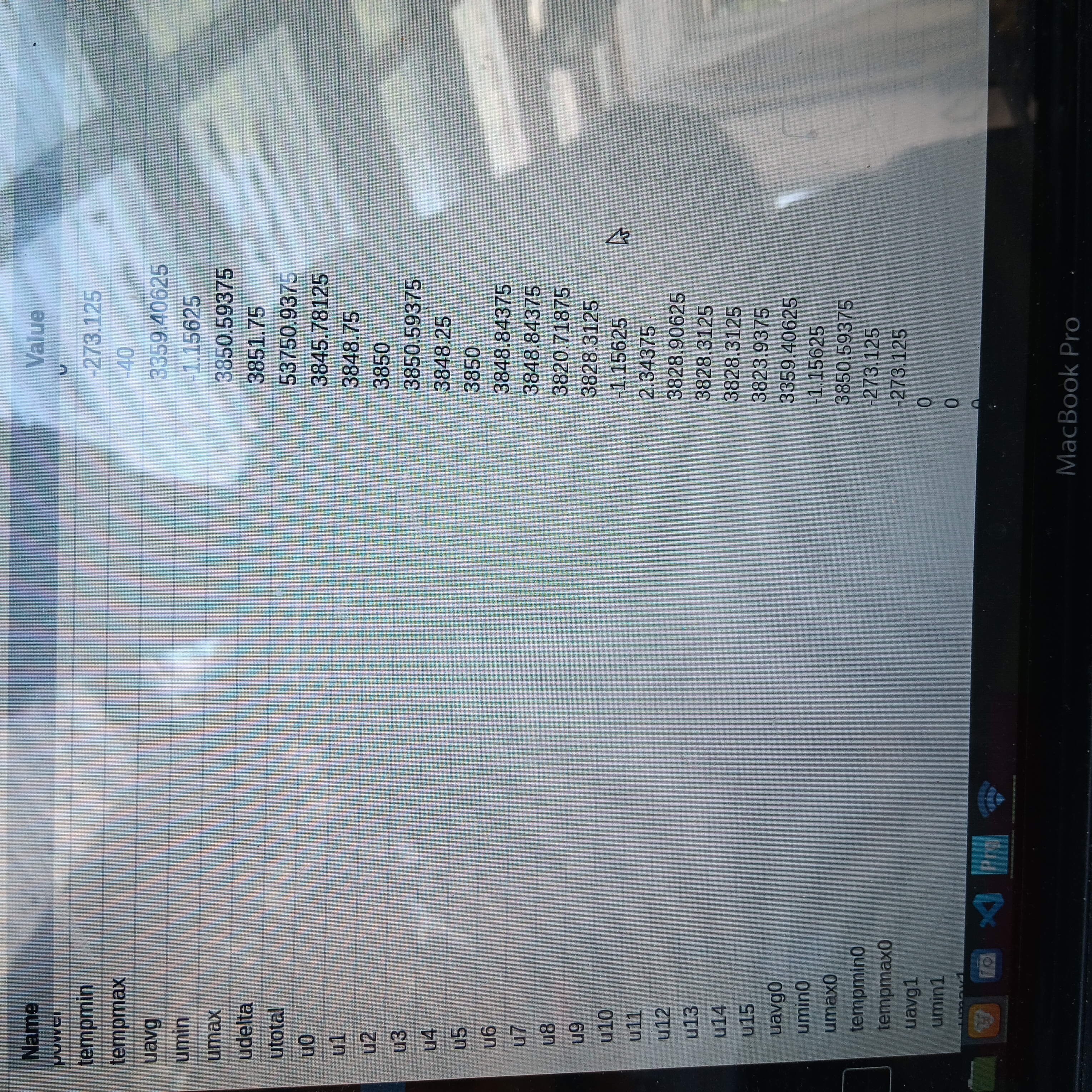

Images of 3 of the boards spot values that are presenting incorrect voltages....
U5-U8
U2-U3
U2, U5, U10-U11
